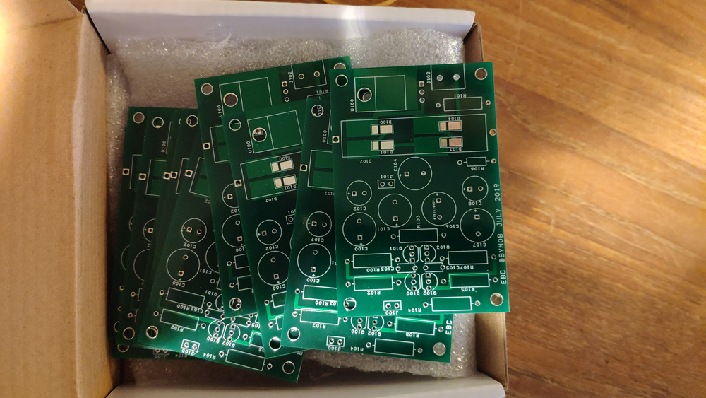

Heyyy SYN08..... Result of your gracious sharing of gerbers 🙂
One question though, where do you source those 3900uF polymer cap´s??
I´m having a really hard time finding anything larger than 1500uF (if that big) over here.
Nice PCB’s. Where did you have them produced.
I always used Beta LAYOUT, but they are becoming almost prohibitive expensive.
< PLG0E392MDO1 Nichicon | Kondensatoren | DigiKey >
Air transport is free for parts value > €50. Less than 2 days usually to my doorstep.
They use UPS.
