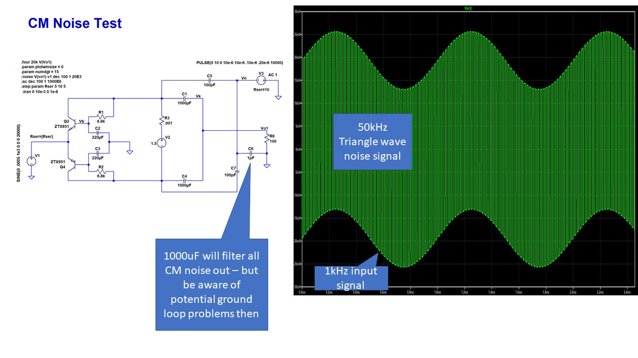

A quick sim shows that any common mode noise on the supply rails (i.e. the collectors of the transistors) feeds directly into the output*. If you connect the LED + or - to the Duraglit 0V with a large capacitor (1000uF for example) you can remove the noise, but of course you trade that for 50Hz ground loop problems so you would have to manage the wiring very carefully.
The powered version is looking more attractive by the minute to my view.
* I used a 10V pk~pk 50 kHz triangular waveform and fed it to each transistor collector with a 100 pF capacitor. Source impedance of the noise generator was 10 Ohms.

I think you have to just go with the battery - you cannot avoid the CM noise issue or potentially a ground loop issue if you decide to couple the LED supply to the Duraglit ground.
Anyway, a very interesting learning exercise.

The whole Duraglit supply is being dragged up an down by the common mode voltage that is arising between the mains 0V and the circuit. Te wall-wart switching mosfet drain is swinging probably to 500 or 600 Volts peak wrt ground and its capacitively coupled through the transformer to the secondary side. The result will be some Volts of HF noise with 100/120 Hz ripple superimposed on it. In the sim I used 100pF to each side of the solar cell, but even with just 10pF to each side, 10V pk-pk common mode noise still gives you 3-5 mV of noise at Vout. You can connect the LED supply + or - directly to the Duraglit ground and it blocks the CM noise problem, but you then have ground loops to worry about.
So, it seems the operating requirements
1. maintain very low non-signal related CM noise across the battery (solar cell)
2. keep any extraneous capacitive coupled noise to the transistor collectors to a minimum (low single digit pF)
3. keep the power supply and the circuit compact and of course shield it (same comment as Andreas made)
4. absolutely make sure there is no common mode noise between the amplifier ground and the floating power supply
(NB - One option to try might be a suitable ferrite CM clamp core around wire from the wall-wart to the LED's)
