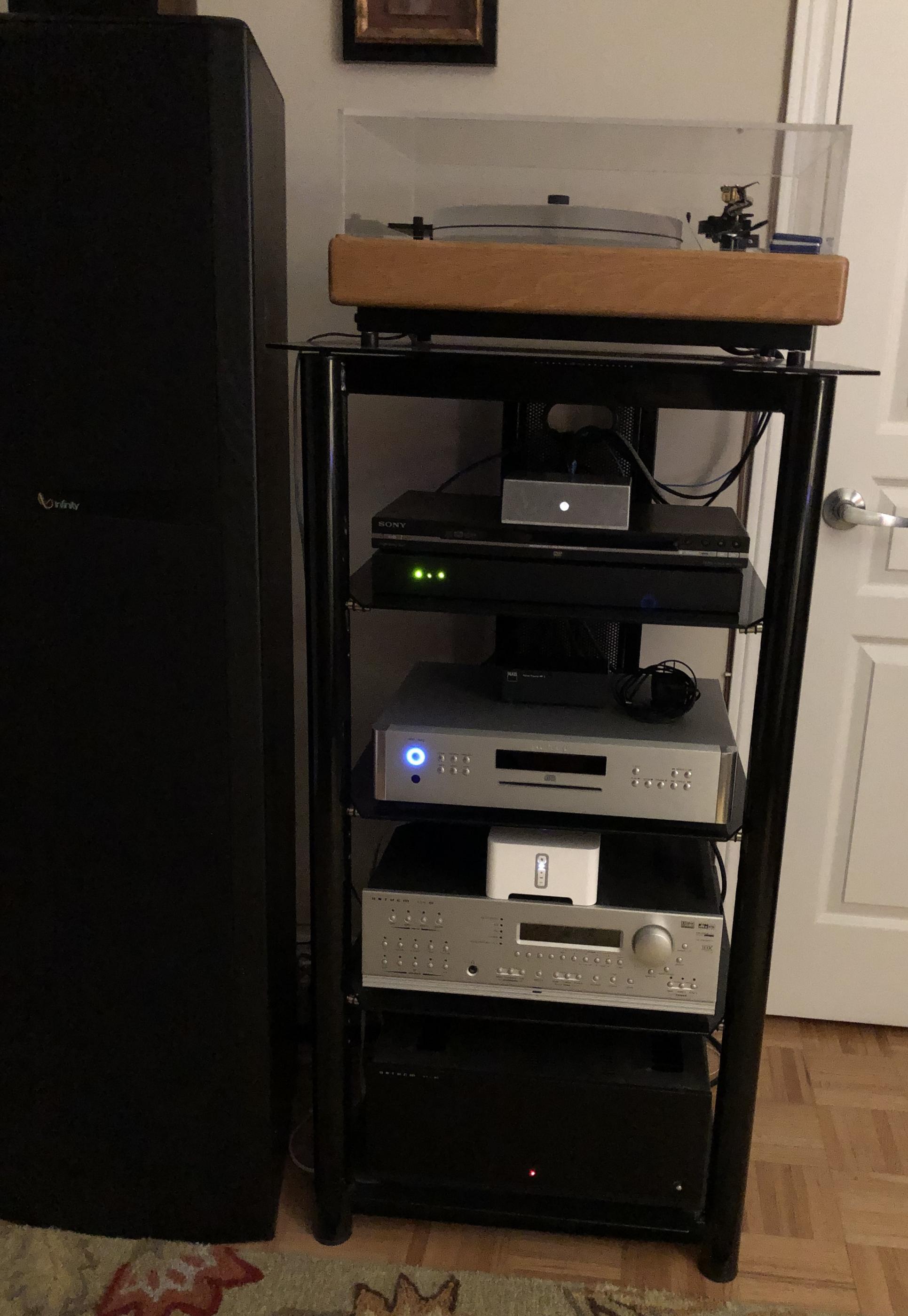

I did some measurements and the best input referred hum I can get with a wall wart is around 100nV (or about 700uV at the head amp output). It takes only a few pF of asymmetric capacitance to create such. The total system gain is 104dB to drive my speakers at full power, which renders a speaker hum of 16mV, clearly audible during the pauses. At the same time, the input referred noise of 300pV/rtHz has a RMS value of (gross approximation) 0.3*SQRT(10000)=30nV which is 10dB lower than the hum. What's the point of building a 300pV/rtHz head amp if you have to live with 10dB higher hum?
But it can be argued that nobody listens a vinyl at >200W/channel. Indeed, if I listen to reasonable levels, I can't hear any hiss or hum, ears on the speakers.
What worries me is that I replaced my HPS6.2 (on low gain, 60dB) with another MM preamp I have around (a NAD PP2, also powered from a 24V wall wart, with a gain of only 35dB).
Compensated the lack of gain by adding 25dB of gain from the main preamp to bring the system gain to the same 104dB value. I verified that the output hum with the PP2 input shorted is almost inaudible, the connected the head amp. This time the input referred hum increased to almost 600nV, rendering
a speaker hum level of 100mV at full power, which I can hear even at moderate power levels. Then I replaced my own power amp with an Anthem P2 (same 28dB gain). This time the hum decreased to 400nV, no idea exactly why.
So the problem I see here is that this head amp configuration is overly sensitive to system configuration, regarding hum injection, depending on how/where/what it is connected to, namely depending on the parasitic capacitances between the system ground and the floating supply.
While in a regular head amp screening is enough to bring the hum to acceptable levels (my measurement x1000 amp is housed in a 12mm thick walls of aluminum, to avoid magnetic fields and hum is indeed around the amp 1/f noise @60Hz) here I don't think shielding solves much of the problem, simply because there is nowhere that I can see to connect safely this shield; at the head amp ground, only exacerbates any asymmetries between the floating power supply and the ground, plus noise pickup could be a problem...
On a bright side, look at the photo; since light is already inside, all it takes to implement a power on indicator is to drill a nice hole and add from the inside a little nice acrylic window. Done!
