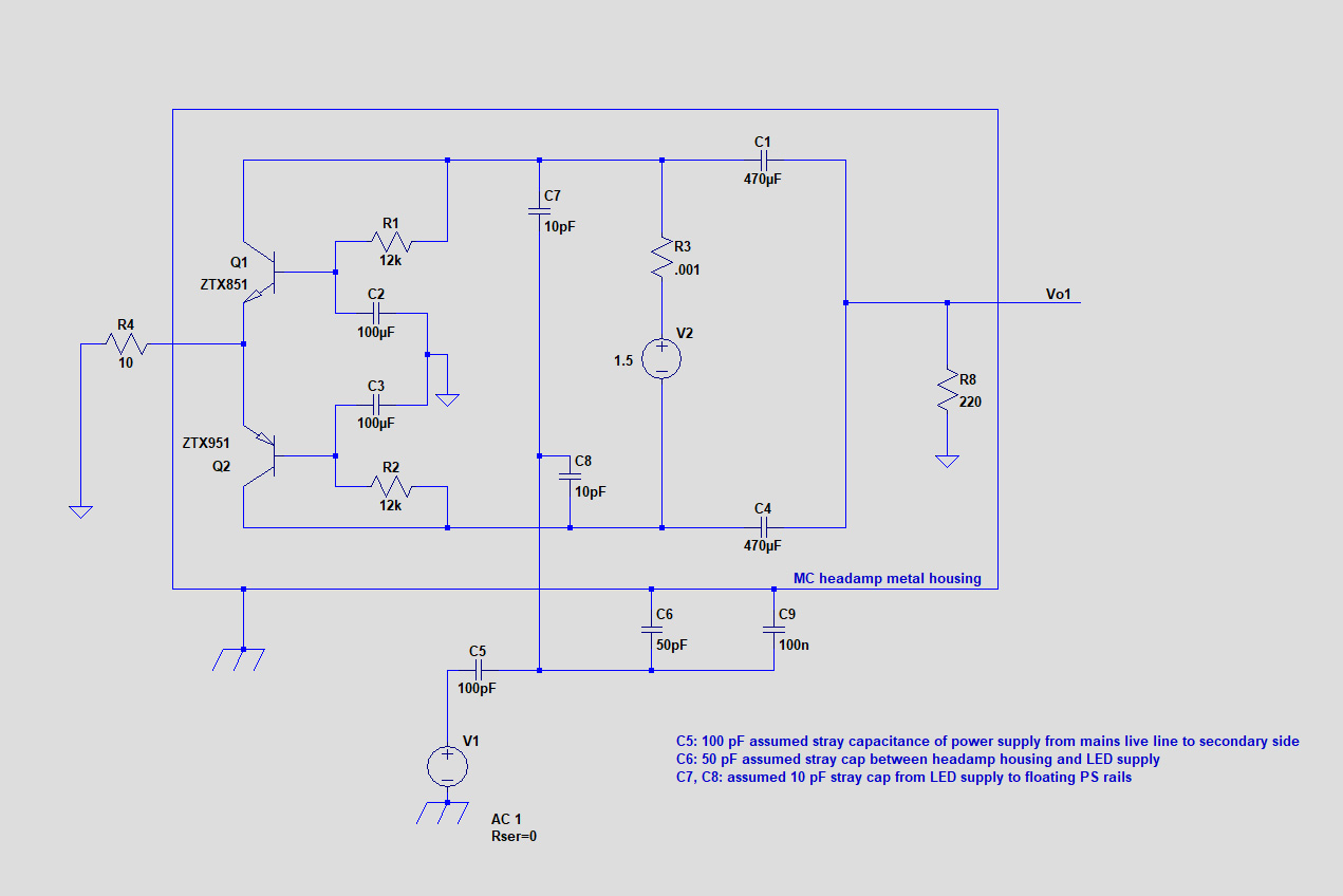

Andreas,
Obviously the trouble in your Sim is caused by the 100pF cap from the PS.
Now placing 100nF to gnd attenuates the signal from said 100pF by 60dB max depending on the value of C6 (here 50pF) , so amplitude to the Duraglit through the 10pF caps goes also down by the same amount.
But in your Sim file, the Signal Gnd is connected to the metal housing, where you seem to assume a very low impedance between signal gnd and mains gnd, so whereto is this current flowing and doesn't this cause other problems elsewhere ?
What if you connected the metal housing to the mains gnd and not to interconnect this housing with the signal gnd ?
Would this not have a better effect in attenuating the signal coming from the 100pF, because the mains gnd has a very low impedance to this 100pF signal.

yes, I assume that the signal ground is connected via a certain impedance to mains earth via the downstream amplifiers following the MC headamp (RIAA amp, linelevel preamp, powramp) which is much lower than the impedance from the stray caps. If these are mains powered there is usually a connection beteen signal ground and mains earth. Even if it is not a direct short, there are very often small resistors between signal ground and amp housing or at least some capacitors in the 100nF range or larger. Yes the resulting 50 Hz current through the ground line has the potential to create trouble somewhere else. If you connect the housing directly to mains earth, then the amp can not have any direct connection to signal ground - otherwise a major ground loop can be created. Finally it all depends on the real impedances and one must test in a setup what connection is best. Same as with your turntable - connect the tonearm to signal ground or to mains earth? If you are going fully balanced, ground does not carry any signal current and you are safe.Andreas,
Could you please explain why this could happen.

You just replaced my 100 nF cap from supply line to housing with a dead short. In reality, the 100nF and the internal strays form a simple current divider - the current through the strays ends up in the output resistor creating an output voltage and the current through the 100nF bypass cap flows directly to ground (and not through the output resistor to ground). The suppression ratio is simply the ratio between the sum of all strays into the amp circuit vs. the bypass cap value. That's all - no magic🙂
Yes - agree. As long as the connection impedance from the Duraglit gnd to the metal housing shield is a few orders of magnitude lower than the other coupling paths you would be good to go.

Nothing is wrong with your circuit. I said if you now also connect the housing to signal ground, then we will have the potential to create a classic ground loop via the signal ground to the downstream amplifiers.Could you please explain why this could happen.
So this means the best solution in case of using a wall wart is:
1) Metal housing connected to mains gnd but no further connection to the signal gnd to prevent gnd loops
2) At the entry of the PS lines two 100nF caps to the metal housing to attenuate the CM pollution from the Wall Wart.
3) Possibly as an extra suppression of diff pollution a 100nF cap between both PS lines at the entry of the metal box and/or ferrite chokes in the wall wart line
Is this a correct recap of the above discussion ?
Hans
Full agreement... my sim was not intended to show the one and only way to eliminate the hum but to demonstrate the basics and the way the hum is introduced into the system.

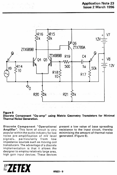

those zetex transistors are more like MJ15031,32 stuffed into a TO92 package.
200v 5A continuous 20A peak. this thing should be in a TO-220 package and used for outputs.
You may not realize that Zetex's competitive advantage is that they allow you to run their plastic packaged "E Line" transistors at 200 deg C junction temperature. So they can permit greater current and greater power than, oh shall we say, unaggressive competitors.
