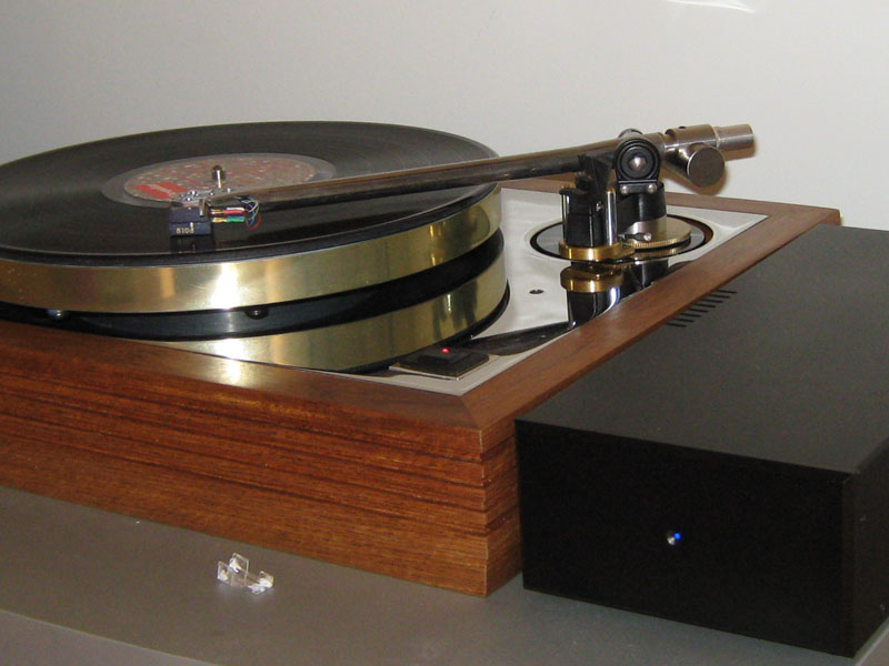

Well after first starting this project back in October 2007 at the start of this post i've just about finished reviving my old/new Ariston RD11s.
What started out as a few tweaks has ended up costing me about $3000.What i've ended up with is an excellent sounding turntable,but at a relatively high price.
Like a lot of projects one thing led to another until i found myself with only the main bearing and top plate remaining from my original turntable.
I found a guy by the name of Rod Childs who is a wood working craftsman, and i commissioned him to make me a new plinth out of a piece of New Guinea Rosewood.I always liked the fluted design on the Linn so i asked Rod to router that design into the plinth.
The end result is just beautiful,unfortunately i'm not good enough at taking photos and so the ones i've posted in the gallery dont do it justice as it looks absolutely stunning in the flesh.
Earlier i had bought a Hercules power suppy,similiar to the Linn Valhalla and had fitted it under the Ariston in the same position as on the Linn LP12.
Since then i have now purchased the external power supply unit(called a MOSE) that allows the Hercules to be housed in a external box similiar to the Lingo along with its own discrete power module.An amazing improvement,and an absolute bargain.The workmanship and quality of componentry in these units has to be seen to be appreciated.

It was time for some improvements to my tonearm.First up was a new armboard made from smoky grey acrylic...looks good.
I had read about the benefits of the Origin counterweight modification,but then i read a review of the Michell Technoweight and so ordered one of these as the idea of the lower centre of gravity appealed to the old mechanic in me.It was a great choice.Bass was immediately a quantum leap better.
It always annoyed me that you couldnt adjust the VTA on the standard Rega.When i saw Pete Riggles adjustable VTAF i immediately ordered one and he worked with me via email and photos to modify one so that it would fit on to the Ariston RD11s.This is fantastic being able to adjust the VTA on the fly.Had some other audible benefits too.
There was one thing that was still bugging me....the pressed steel flexible subchassis.
I decided to bite the bullet and set about making a Linn Keel copy.This is not as easy as it first seems.The Keel is actually a aluminium casting and i was working with 8mm thick sheet aluminium.
I had two aims for the new subchassis.
1) To make it stiffer and less prone to resonances
2) To make it better balanced about the main bearing when the arm was attached.The steel version is so heavily biased near the arm that the springs have to be wound up too much particularly on one side to get the armboard level.The bounce was always a bit 'dodgy'.
First problem surfaced when i went to get the honeycomb pattern like the the keel, machined out of the 8mm sheet of soild aluminium.When material is removed only from one side the metal is relieved and starts to bend up on the side where the material is removed.Back to the drawing board.
A compromise was all i could do without trying to get a new sub chassis cast.
I decided to make weight measurements of the old and new subchassis and determined that without removing any material from the new aluminium subchassis it weighed almost exactly the same as the old pressed steel unit. This was good as it meant that i could now lighten the subchassis and achieve a better balance at the tonearm end.
After drilling 5 x 32mm holes in the subchassis at the arm end i set up the arm on the subchassis sitting on its springs and bushes on the workbench and outside of the plinth.Now the weight of the arm didnt tip over the subchassis as it had done when attached to the steel subchassis.These holes also presented the opportunity to deaden the new subchassis by allowing me to pop in tight fitting rubber bungs,which works a treat.

While i was waiting for the arm to come back i decide to work on the top plate.Earlier i had a little accident where i dropped the platter across the top plate and scratched the black decal that ran under the arm similiar to the look of the long armboard on a Linn.I pulled the decal off and decided to get the stainless steel top plate polished to a mirror finish.This looks awesome with my gold edged platter.
I previously had an acrylic bottom plate made up to suit my old plinth ,but as my new plinth is considerably bigger i had to get another acrylic bottom plate made.All that needs doing now is my new turntable top cover in clear 4mm perspex.That is being made as i write.
Yes it cost me way too much money and No i would not do it again.But the DIYer in me just loved this little project.It kept my little mind occupied for over a year, and part of me is sad its over.
In retrospect,I should have just spent the $3000 on that lovely shiny new Thorens TD2030 i was lusting after,but it wouldnt have been anywhere near as much fun.
How does it sound?After several hours its sounding better.
