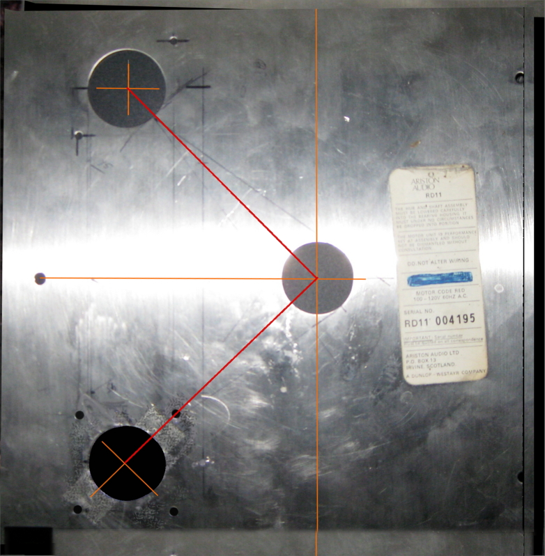

and...
moved the motor mounting location to approximately the 7 o'clock position.
This location was actually calculated, taking the tracking error of a 9" arm into consideration. As it turned out, it was symmetrical to the existing motor mount location about the "x" axis.

I always just assumed (without actually thinking about it)that moving to the 7 o'clock position woud be symmetrical in relation to the old position.This should be an interesting conversion when you're finished.Nice to see a pic...more soon pleease.
the 7 O'clock position...
well the stock location is actually at the 10:30 position. So the modified position is at the 7:30 position.
I had done an analysis of the two locations some time ago and the modified position reduces lateral torque about the stylus by a significant amount. I need to do a more rigorous analysis and actually post it.
yup, he did...
regarding the yellow snow...from Frank Zappa's anti sealing song "Don't eat the yellow snow". Do a search, the lyrics are online 🙂
Look for "the funk firm" online. They have a pretty fair explanation of the 7 O'clock position on their website. Basically the torque applied to the stylus tip due to the location of the motor, drops a significant amount (to 1/20th of that of the original 10:30 position, and to 1/5th in the worst case scenario) between the 10:30 position and the 7:30 position. This can be significant when a motor is mounted to a rigid structure whilst the platter is suspended as found in the Ariston, Heybrook and Linn types. Pretty much non existent when both the platter and the motor are mounted rigidly.

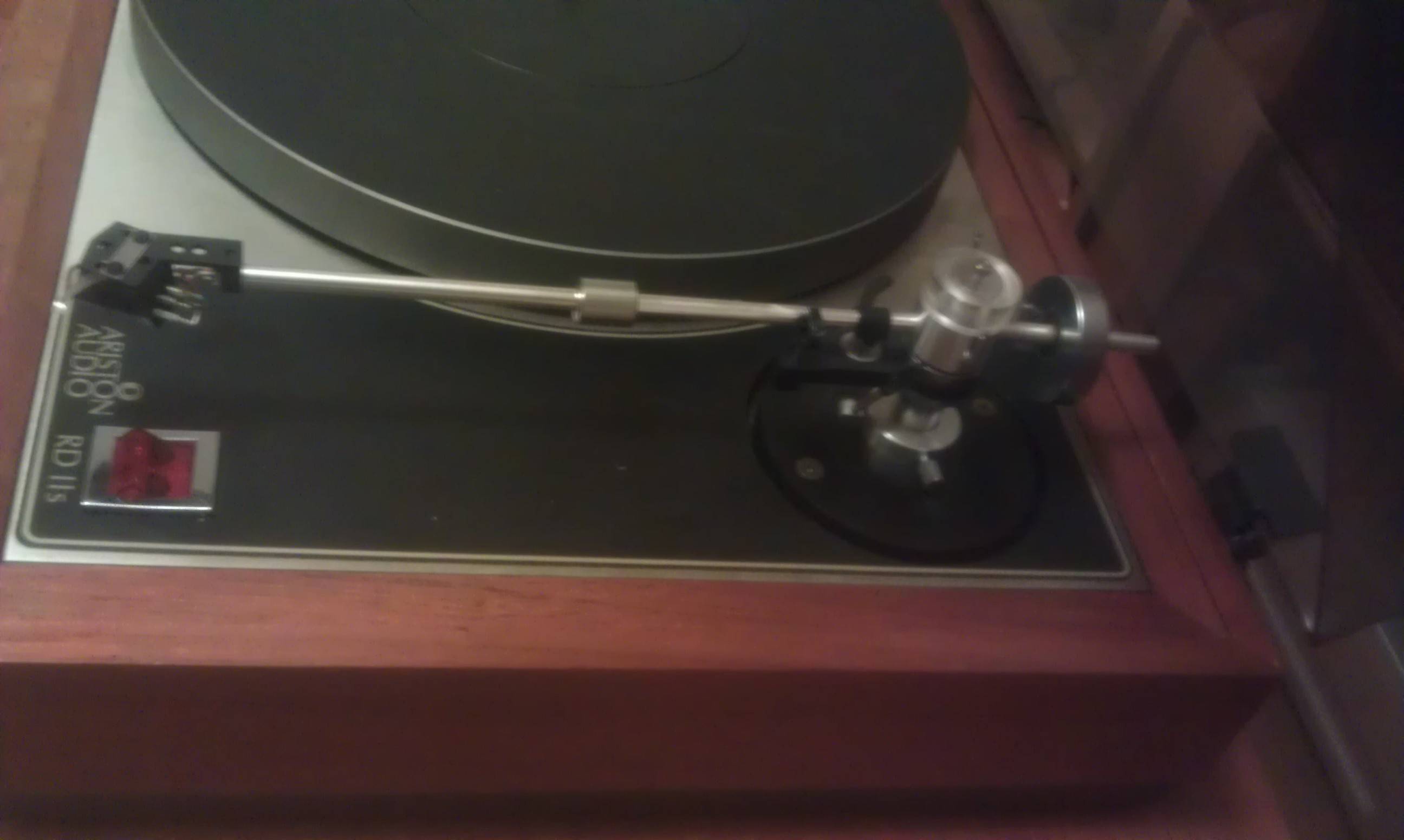

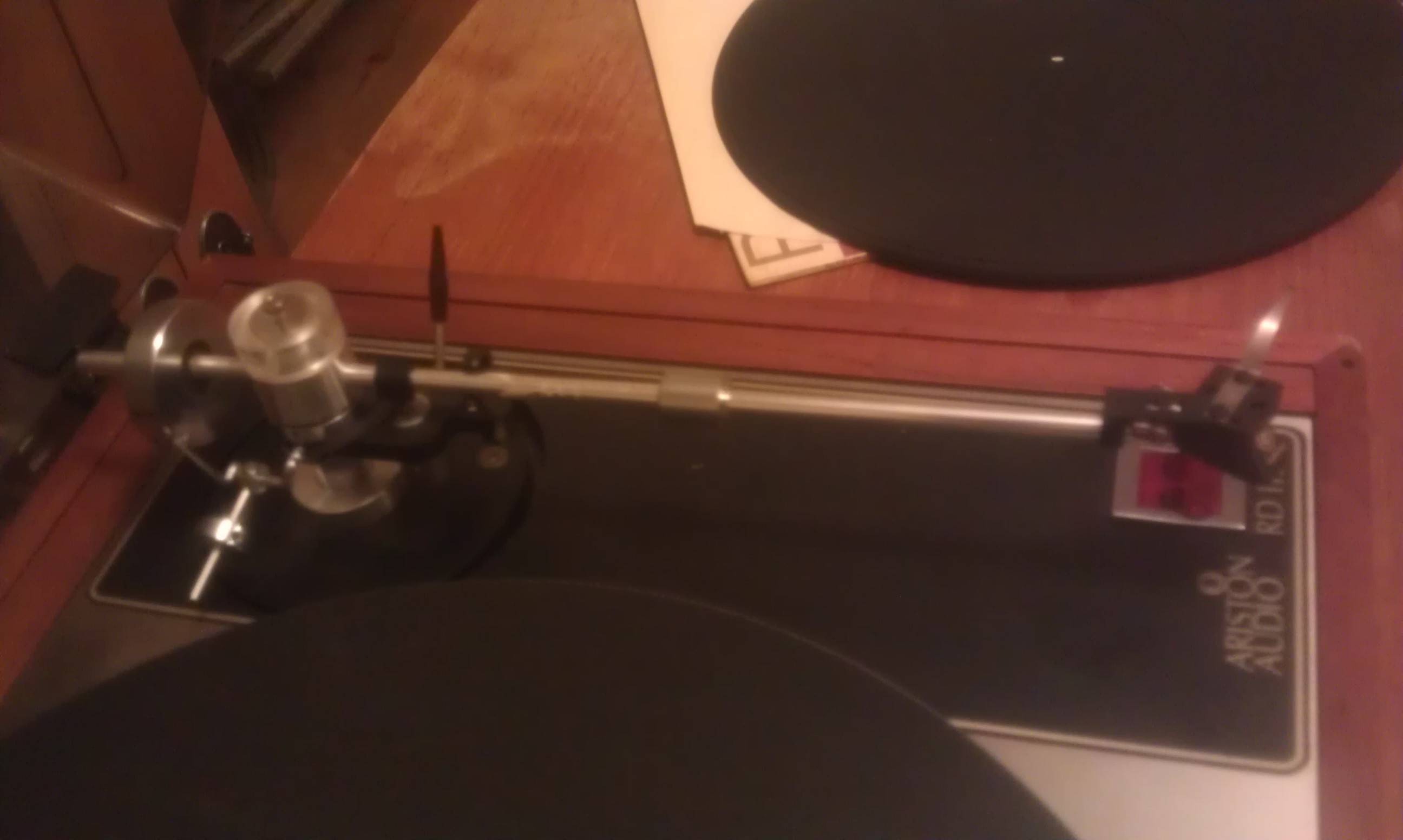

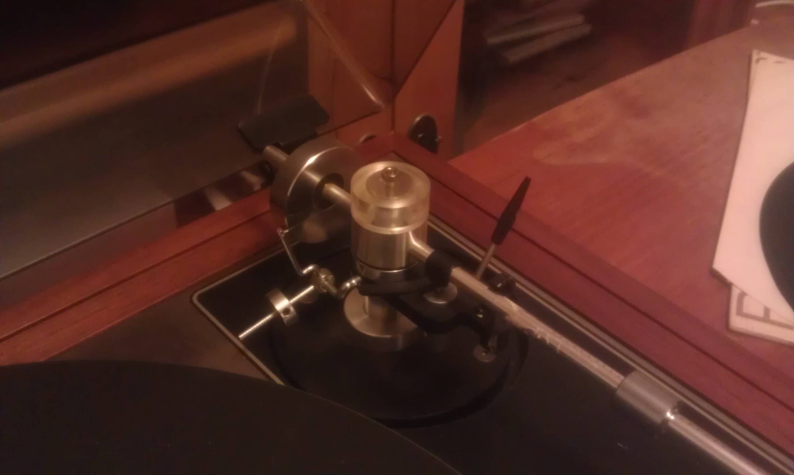

Before I set off on my quest to revive an Ariston RD11s, I was wondering if anyone here could identify this arm? It seems to be a unipivot design, but I don't have any idea what make or model it might be.
Any help would be appreciated 🙂
Mayware Formula IV Manual - Professional Laboratory Variable Mass Silicone-Damped Pick-up Arm - Vinyl Engine
Twist the suspension grommets until the arm board is centered. Adjust the nuts on the suspension until it floats horizontally and freely.
Clean and replace the bearing oil with Linn LP12 oil.
