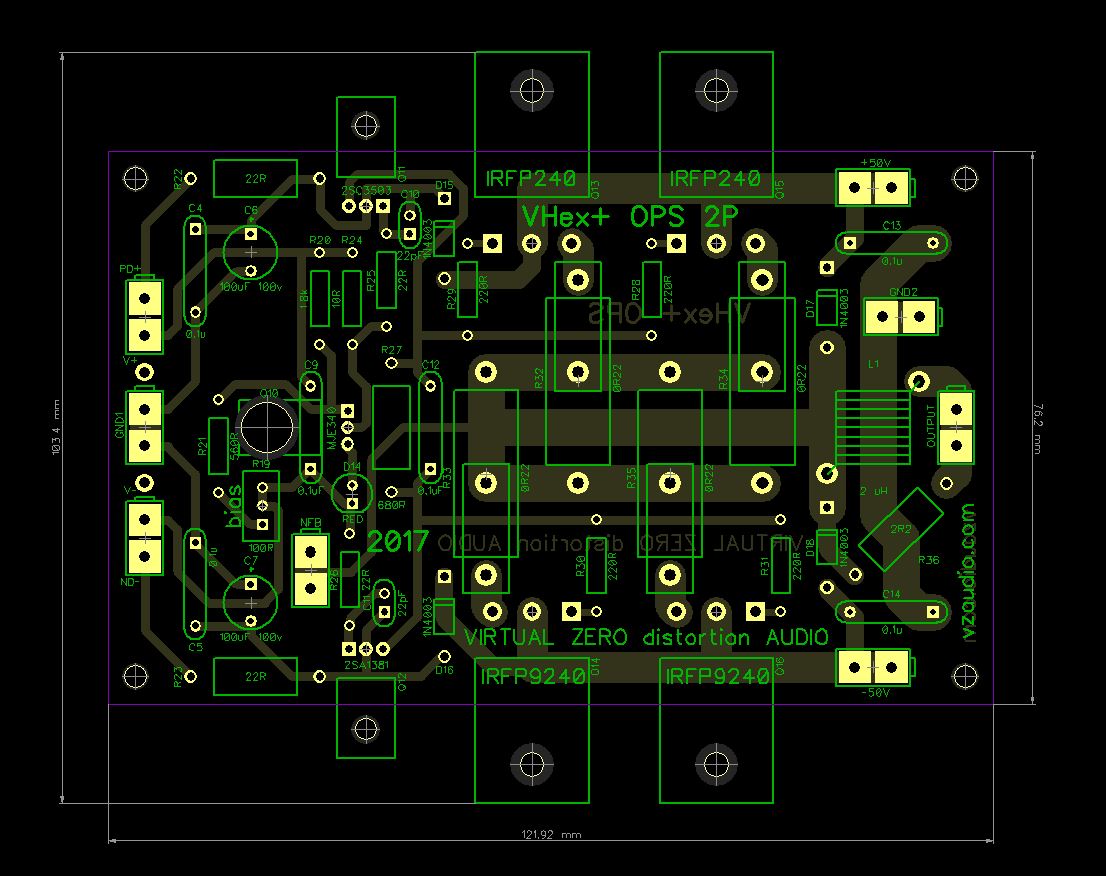

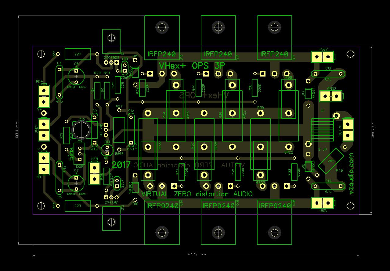

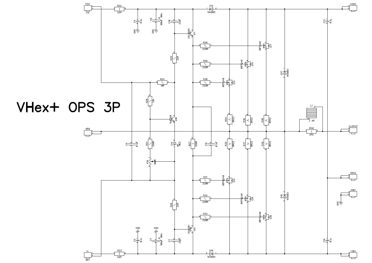

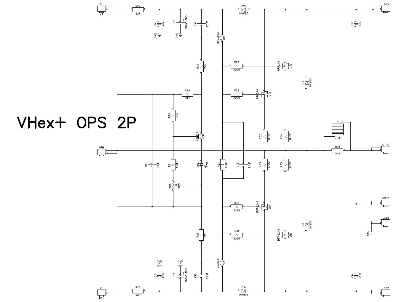

VHex+ 2P OPS and VHex+ 3P OPS modules
Hi Andrew and All,
Please see the good-matching OPS section documents attaches - 2-pairs and 3-pairs OPS options.
Optimal rails for 2-pairs OPS = +/-50...60V DC
Optimal rails for 3-pairs OPS = +/-65...75V DC
NOTE! Different rails require some resistors'value adjustment in Lichtstark front-end module!!! Let me know the rails you are going to use - I will let you know the values.
No changes in the OPS though.
Also note! Connectors on Lichtstark IPS and VHex OPS modules are mirrored with regards to each other! If they are placed one next to the other, IPS module has to be mounted either upside-down, or 90 degrees.

Hi Valery,
with these output FETs, Q10, the Vbe multiplier transistor, doesn't need to be attached to the heat sink?

Hi Valery,
versions for etching would be interesting for me.
I have another question about the supply voltage.
You wrote for 2 Pairs 60V DC is the max.
How can I calculate this?
My consideration about this:
The max. current of the IRFP240 is 12A at 100°C.
R=U/I=60V/(2*12A)=2,5Ohm
So the mimum load will be 2,5Ohm.
The complex load of a 4Ohm speaker can be smaller than 4 Ohm, but 2,5 Ohm should be ok.
Are my considerations right?

Hi Kay,
You would not need to attach Q10 to the heatsink if those FETs would be laterals.
However, IRFP240/9240 are HexFETs - their temperature coefficient is close to BJTs' one - slightly lower, but still - Q10 must be placed on the heatsink under the board (there's a hole in the board for a screw). Otherwise, thermal runaway will be the case.
Valery
Hi Valery,
I loaded those gerbers/drills, for the VHEX designs, they look fine to me upon a first glance.
In the schematic I see R symbols, some "<" and some ">" 🙂 I assume that they are rotated 180, you did not have them in your legend that you supplied the other day, what are those wattages? I assume Russia has an equivalent of ANSI or IEC?
