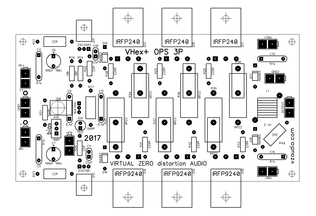

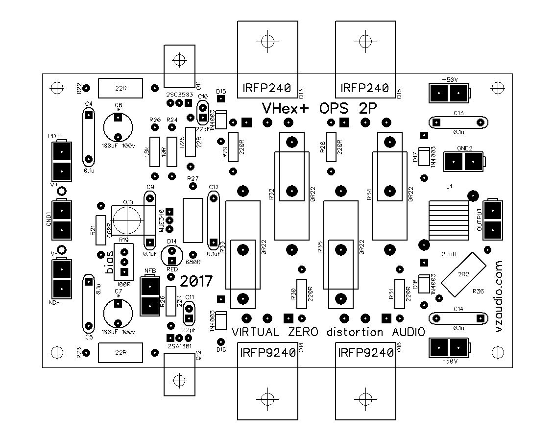

Hi Andrew and All,
Please see the good-matching OPS section documents attaches - 2-pairs and 3-pairs OPS options.
Optimal rails for 2-pairs OPS = +/-50...60V DC
Optimal rails for 3-pairs OPS = +/-65...75V DC
NOTE! Different rails require some resistors'value adjustment in Lichtstark front-end module!!! Let me know the rails you are going to use - I will let you know the values.
No changes in the OPS though.
Also note! Connectors on Lichtstark IPS and VHex OPS modules are mirrored with regards to each other! If they are placed one next to the other, IPS module has to be mounted either upside-down, or 90 degrees.

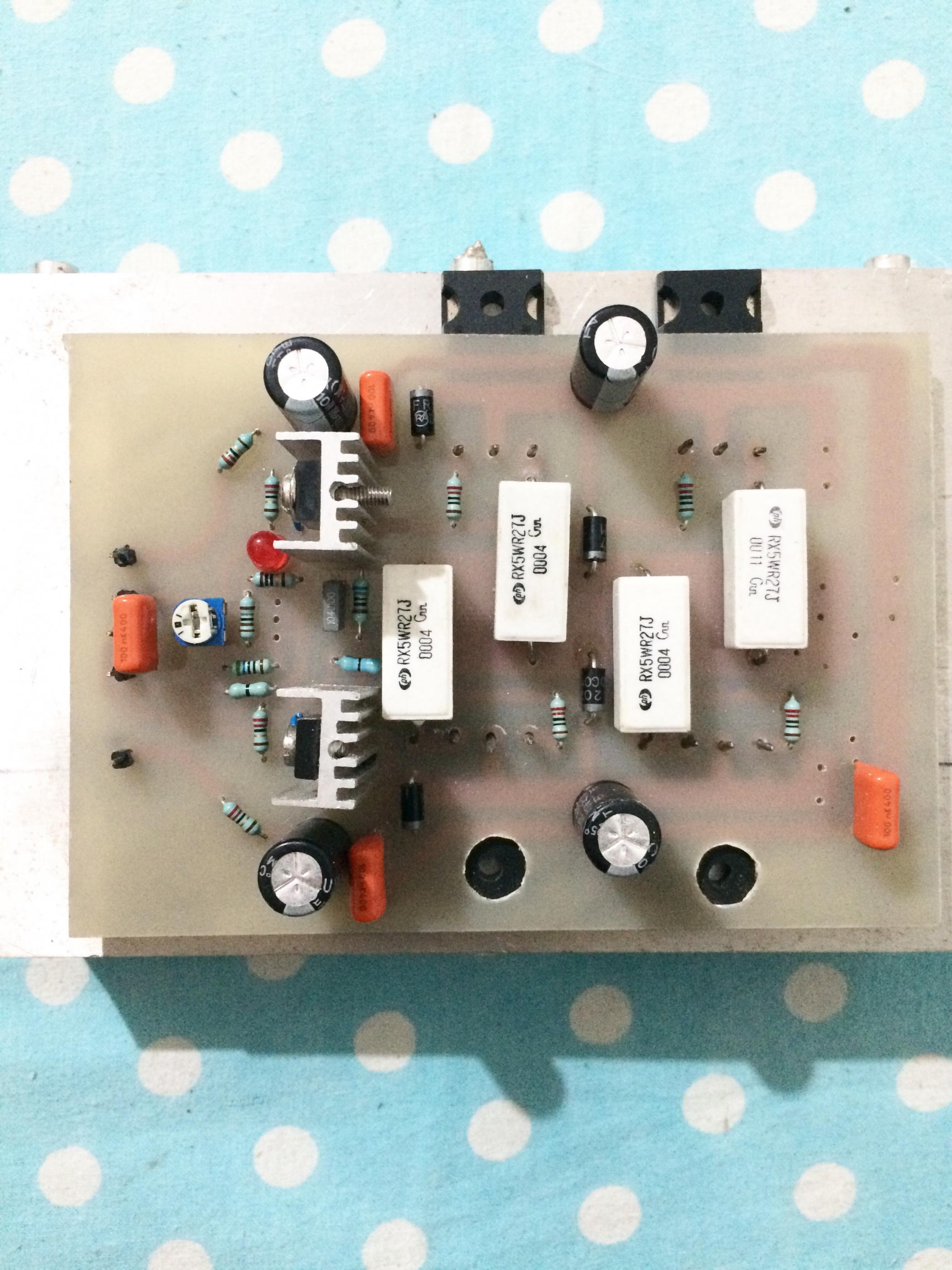

Just a rough output stage for test😉
Not bad 🙂
Will you place the bias multiplier transistor under the board?
Hello vaizchenko
greetings yes mje340 will be under the pcb its just a test pcb if
everything goes ok a new pcb can be designed IPS / OPS on one pcb
warm regards
Andrew

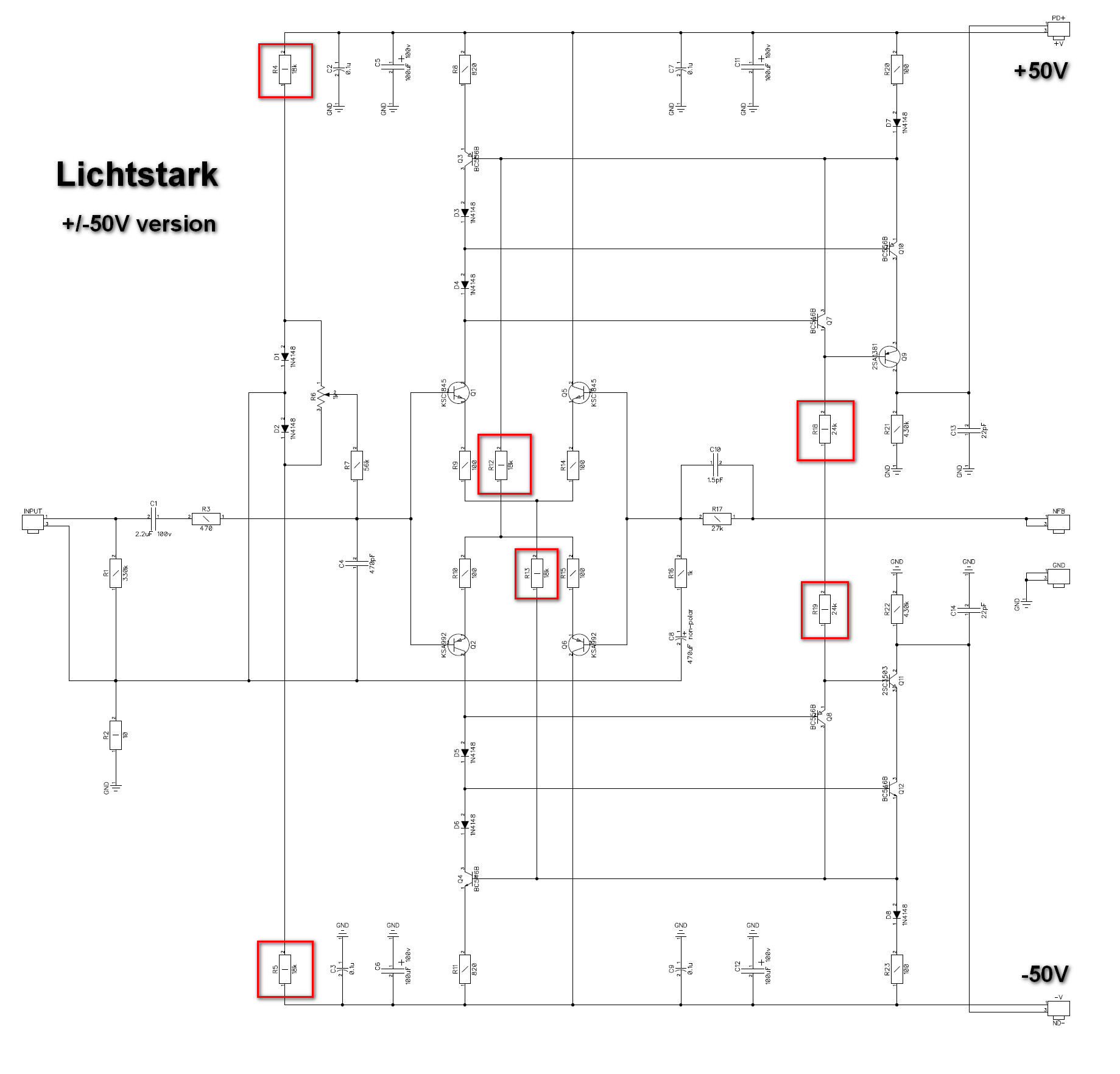

+/-50V adjustments
Hi Marc!
Please see attached - adjusted values are marked with the red frame.
Total - 6 resistors, all of them are 1W.
OPS does not require any changes.
Valery
Hi Valery could you provide value for +/-50VDC for both LS-IPS and VHex-OPS....
Marc
Hi Marc!
Valery

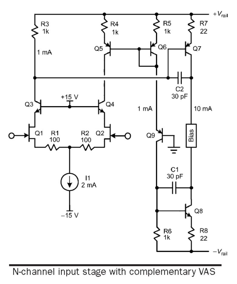

Nice!
Are there other options suggested for the IPS stage, perhaps something "Goldmund like" in LTP and VAS?

greetings will be using 57 volts dc +/- do i have to change the 6 resistors
to 1 watt as described in post #1992 y have all the values 1 watt
warm regards
Andrew
warm regards
Andrew
Nice!
Hi Carlos,
Then I would recommend VHex+ design - see these posts >HERE< and >HERE<
Current-driven VAS is excellent performer. Here is the schematic and information on PCBs ordering (shipping is $15): VHex+ amplifier
Let me know if you will have questions 😉
Valery
Hello vaizchenko
warm regards
Andrew
Hi Andrew,
For +/-57V better use those 1W resistors' values from post#1884.
Valery
Not exactly. I was referring to something like this.
OK, how do you like this one?
- Revisiting some "old" ideas from 1970's - IPS, OPS
