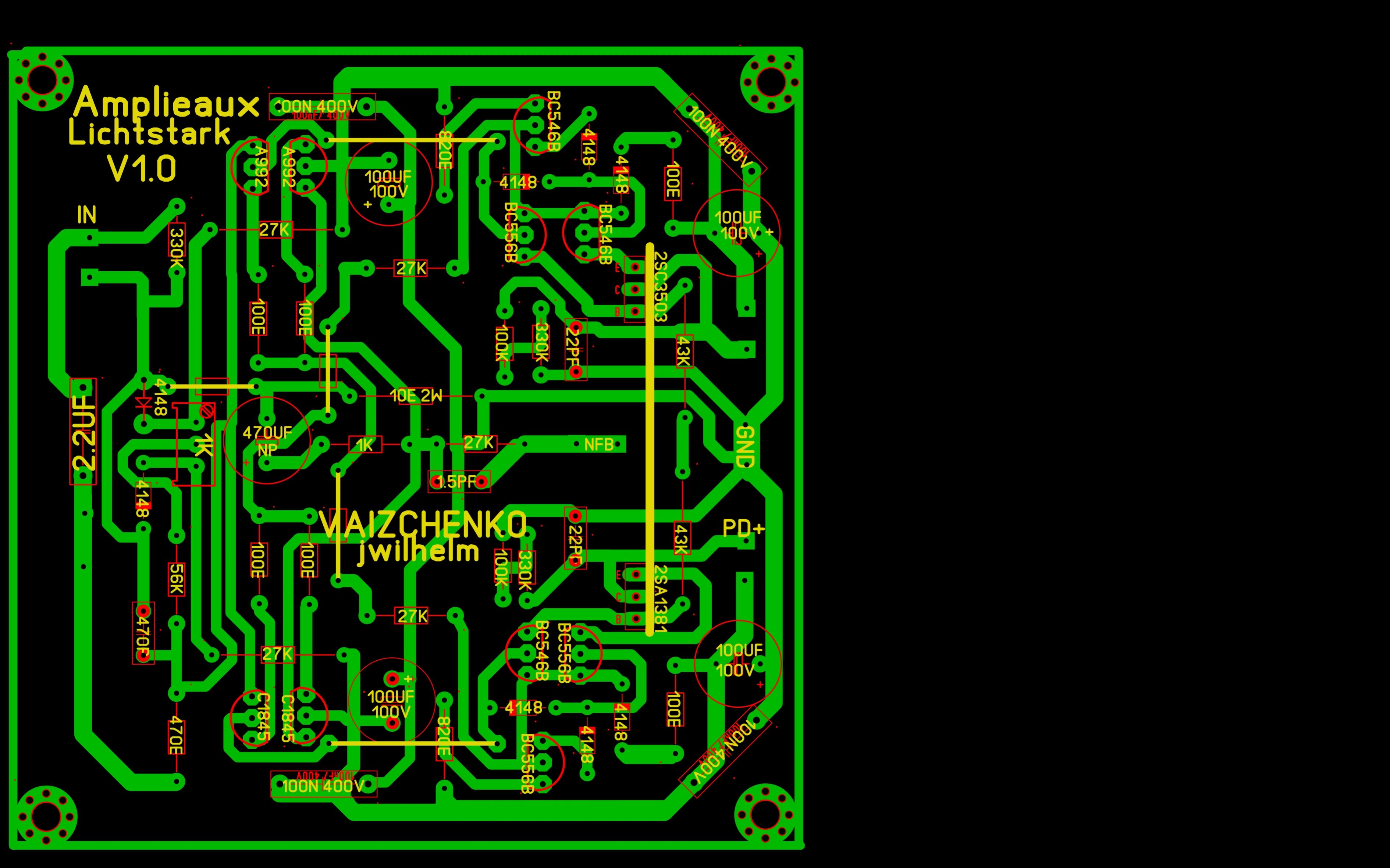

Hello Vaizchenko
greetings just want to confirm some resitance values
33K or 43 K and 430k or 470 K can 3 pair mosfets be
used in output stage
warm regards
Andrew
Hi Andrew,
Depends on the rails you're going to use. What voltages do you have in mind?
3 pairs are fine, just one correction in this case - resistor value between the emitters of the drivers will be 620R (instead of 680R).
Valery

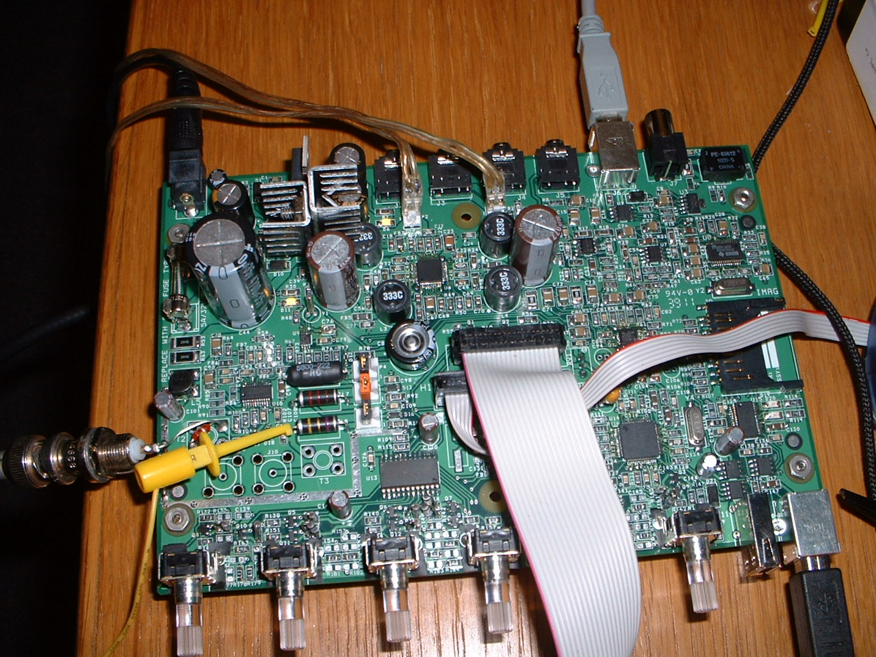

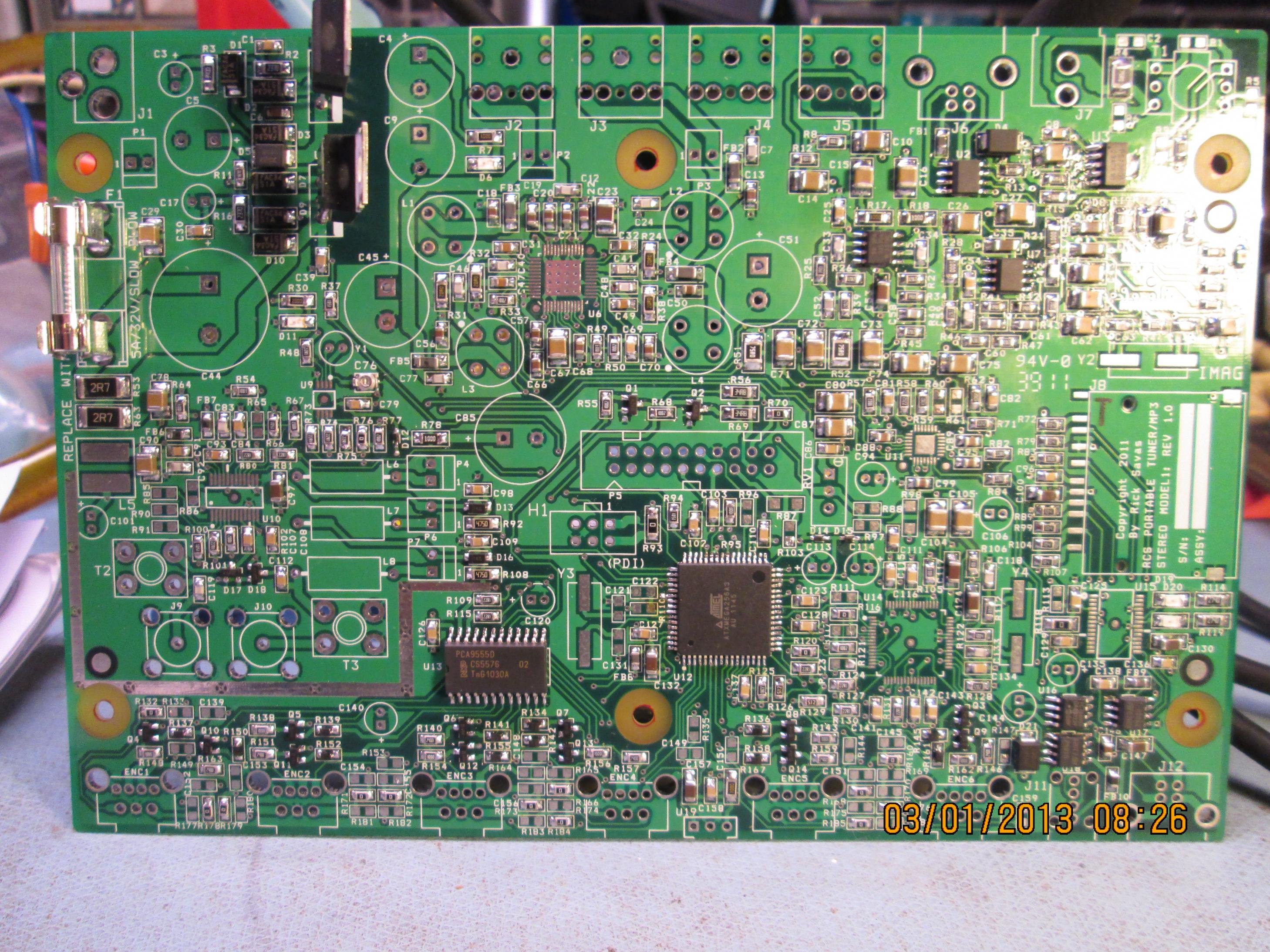

I atatched a pic of a media player I design and built a few years back, it was all hand soldered as I describe above. It took a good part of a day to solder it up.
Great layout job by the way 😉

Thanks Valery, it worked first rev, one minor schematic error. It is 4 layers, here is the finished assembly up and running.
Maybe I should say what it is, it is media/radio player using Si4735C40(AM/FM/SW radio),atmega192a3(MCU),PCM2902B(USB CODEC),TPA3100D2(Class D amp), Rohm BU9458 (USB host/SDRAM CODEC),MAX9729(pre-amp/volume/channel_select/headphone amp),PCA8565(RTC), Bourns encoders,4x40 LCD
