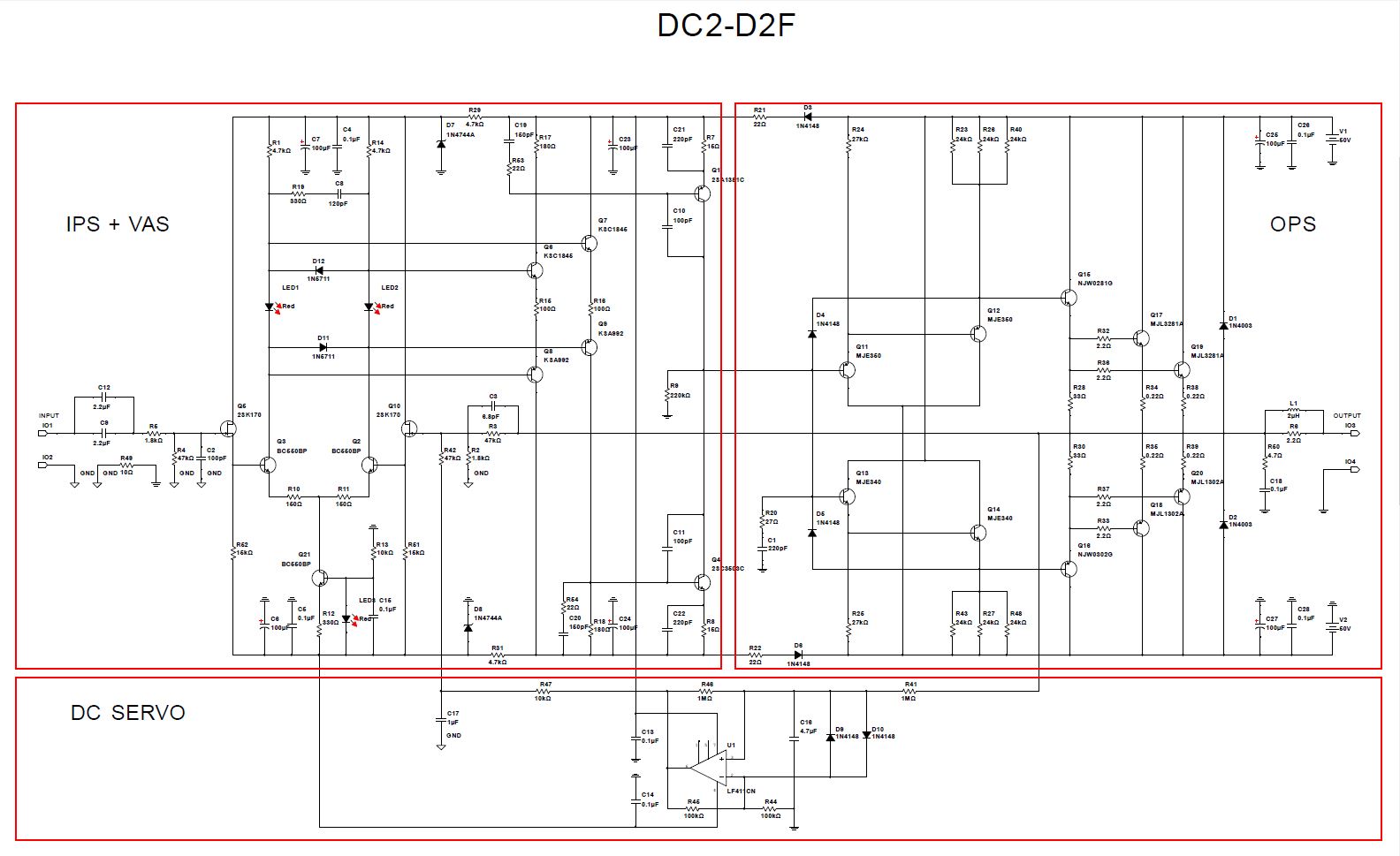

Hi All,

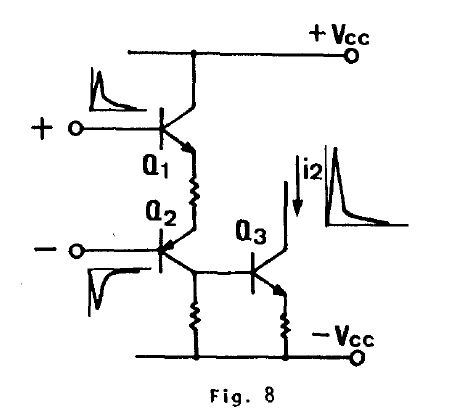

Came across an interesting article in AES library, published in 1978 by Sansui engineers, describing the vertical differential cascade as a good way of driving VAS - higher slew rate, lower TIM, good stability (see the small picture attached).
So, I thought - why not giving it a try, using the modern active devices.
The whole thing is called Double Complementary Differential Circuit - I call it DC2.

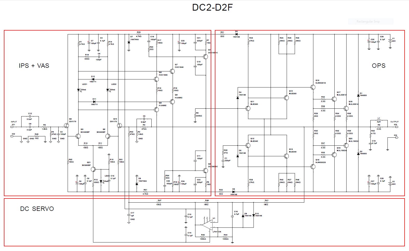

One more thing - an OPS topology, used in a couple of Nakamichi power amps (420, 620) - I consider it great. I have simplified it a bit, still performing very good. In order to have a thermal feedback, Nakamichi places all transistors on the same main heatsink. I think, having the first pair together with the drivers on a separate one could be a good option as well - needs some testing. I call this arrangement Double Diamond Follower - D2F.
Simulation shows rather lower THD and narrower crossower region, comparing to conventional EF2/EF3 topology. No bias spreader required - the left side of a diamond keeps the bias of the right side regulated properly.

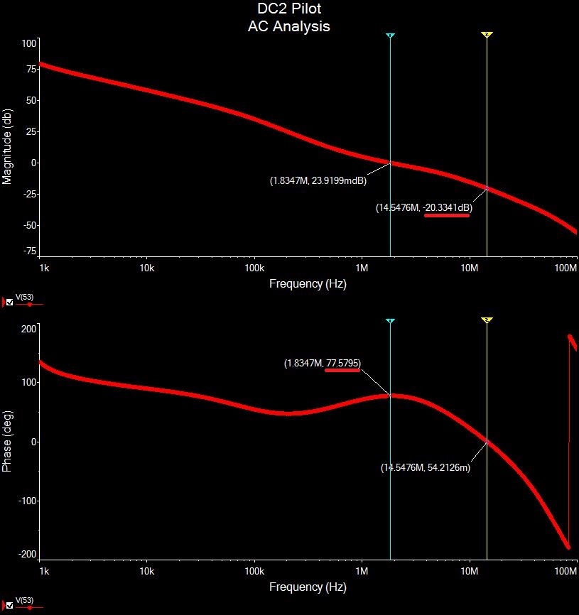

Attached is an experimental full power amp schematic (jpg and pdf), combining both cool topologies, along with stability analysis for the whole thing. I have also simulated the D2F OPS with my CF-FET V2.0 front-end - showing an outstanding performance.
Most likely, I'm going to test the OPS first. The whole thing may be built on a single PCB or as two separate modules (servo should be located on the IPS board). Number of output devices may be increased, although, with 2-3 pairs of MT200 Sankens it's already pretty much ok ;)
I did not have time to come up with any PCBs as yet.
So, what do you think? Comments/suggestions are welcome.
Brother Pete, if you'd like to simulate/check/amend/improve something - just go ahead ;)
Val

Interesting OPS. Much like the plain diamond buffer, it affords you more buffer stages with the voltage drop of merely an EF2. I don't see why XO region would be lower than for an EF2 though - I suppose being able to run the drivers fairly hot would have something to do with that.
But MJE340/350 at only ~2 mA? Won't that be a tad slow?
these (and other) designs were popular during the "slew rate" wars some years ago.
some designs were so hung up on speed they forgot about things like overload & rail-sticking, common mode conduction in the output stage, latch-up, etc.
be careful or have a stock of spare devices ...
Actually, after closer digging into EF2 and D2F, comparing performance with different loads / frequencies at the same quiescent currents - the crossover region difference is barely noticeable, but THD is very slightly lower with the latter one. Well, certain advantage is expected in terms of the bias regulation accuracy, I also like low voltage drop and ability to have the bias fully independent from the VAS current.
Simulation does not show any slow-down, comparing to EF2/3...
mlloyd1
Well, CF-FET V2.0 front-end is even faster, but you-re right, this is already close to the OPS speed capabilities. Clipping looks good though - controlled by IPS. D11, D12 prevent sticking in overload conditions.
Anyway, thanks for "heads up" ;)

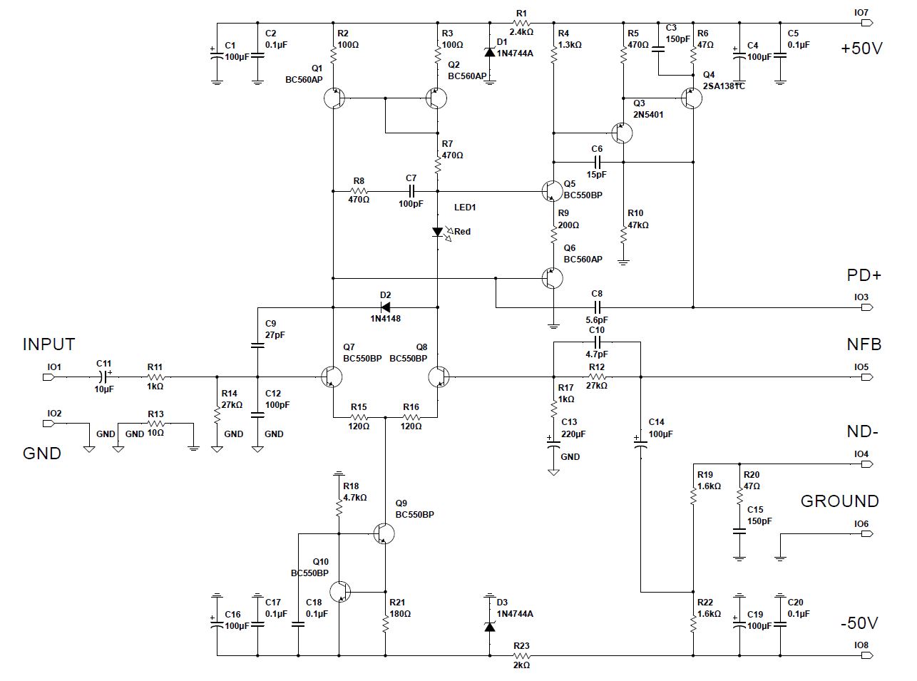

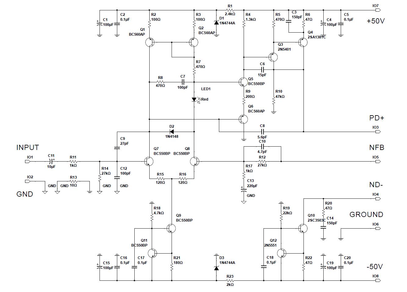

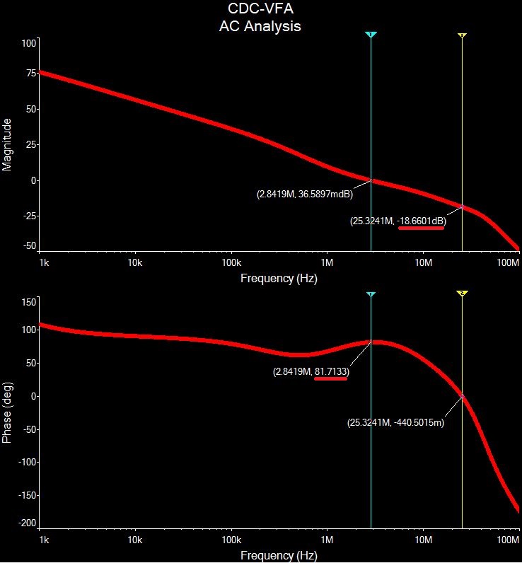

Tried to simplify the front-end, sticking to the same principle and preserving the quality.
These two options - having single end VAS with CCS (1) and bootstrapped R (2) loads - utilize just one Complementary Differential Circuit (CDC) and use BJT transistors only, nothing difficult to find.
Choose the one you like :)
Both offer harmonics at -100db level in audio bandwidth, low TIM and rather high speed. Distributed compensation is pretty light. Local feedbacks keep the circuit rather linear even open-loop - around 0.1% THD @ 20KHz, 20V RMS, 80db gain.
Attached AC analysis is done with a simple EF3 OPS attached. I keep VAS rather warm (15mA), so MOSFETS (Lateral or Hex-FET) can be driven directly from it with no problem.
If somebody wants to "practice" PCB development - you are welcome ;)
Can be SMD or TH or a combination of both.
Valery
P.S. This circuit can be also used as a high-end pre-amp line gain stage (rails can be lowered for that purpose, like +/- 24V, with couple of resistor values amended), or an excellent amp for the headphones - with optional addition of a single push-pull EF (MJE340/350) - at the same +/-24V rails.

You have 5 comp. caps ? Lead /lag , miller , and a shunt ! How did you arrive at these ?
BTW , a very interesting "blameless" -mutant. I like the decoupled low voltage input and overload clamp.
