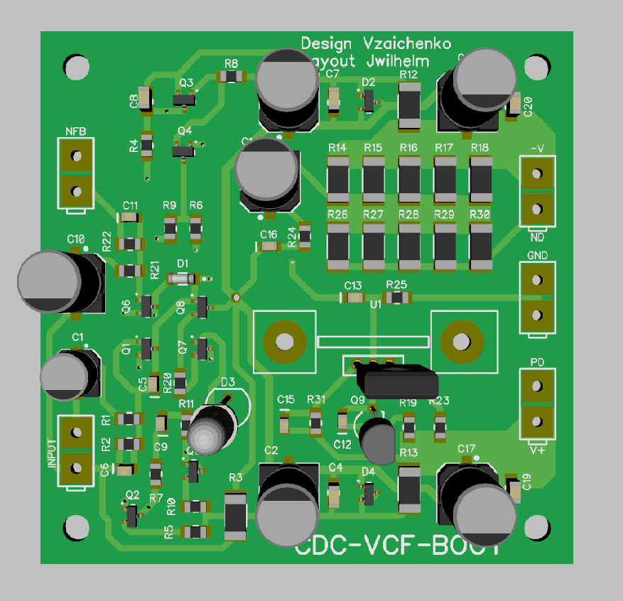

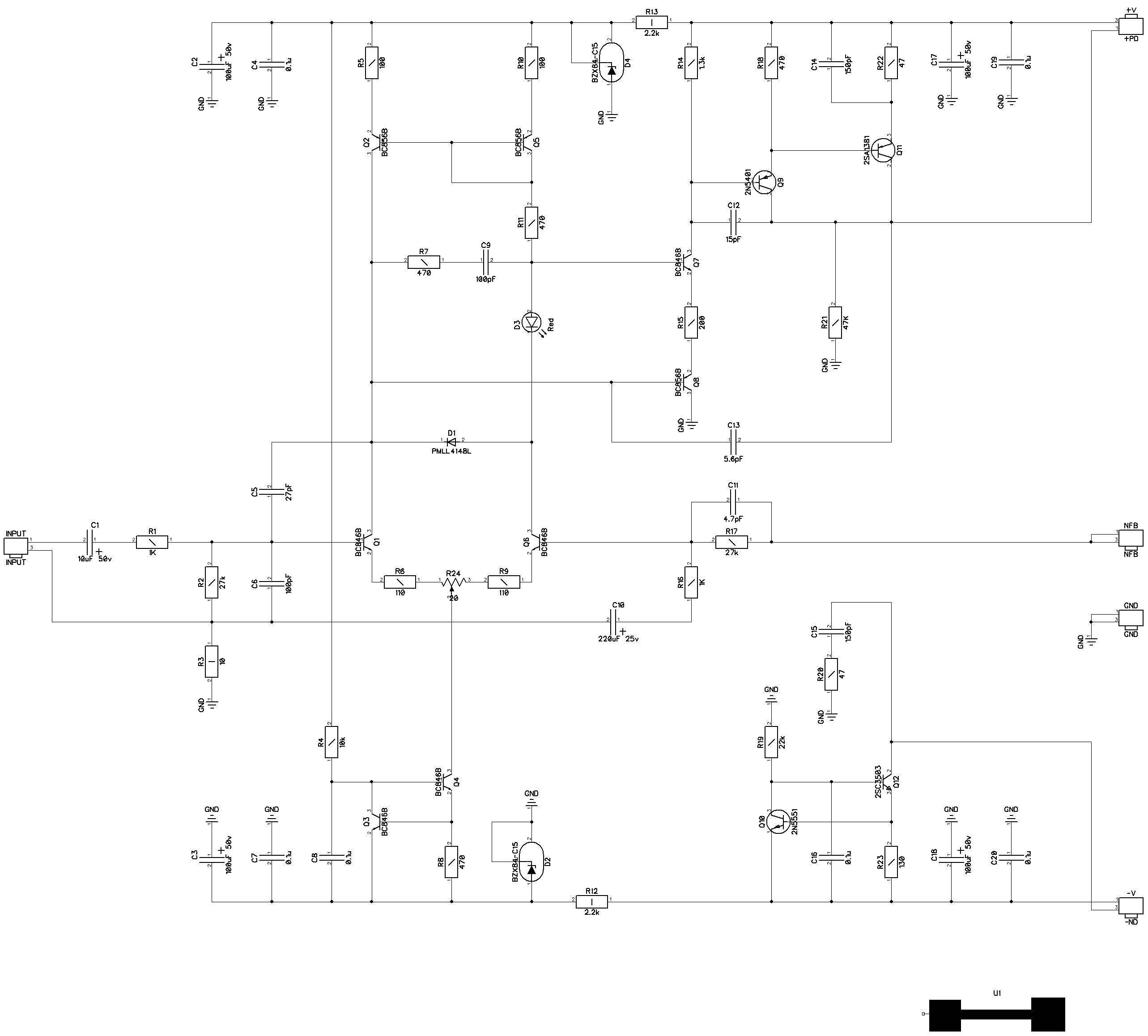

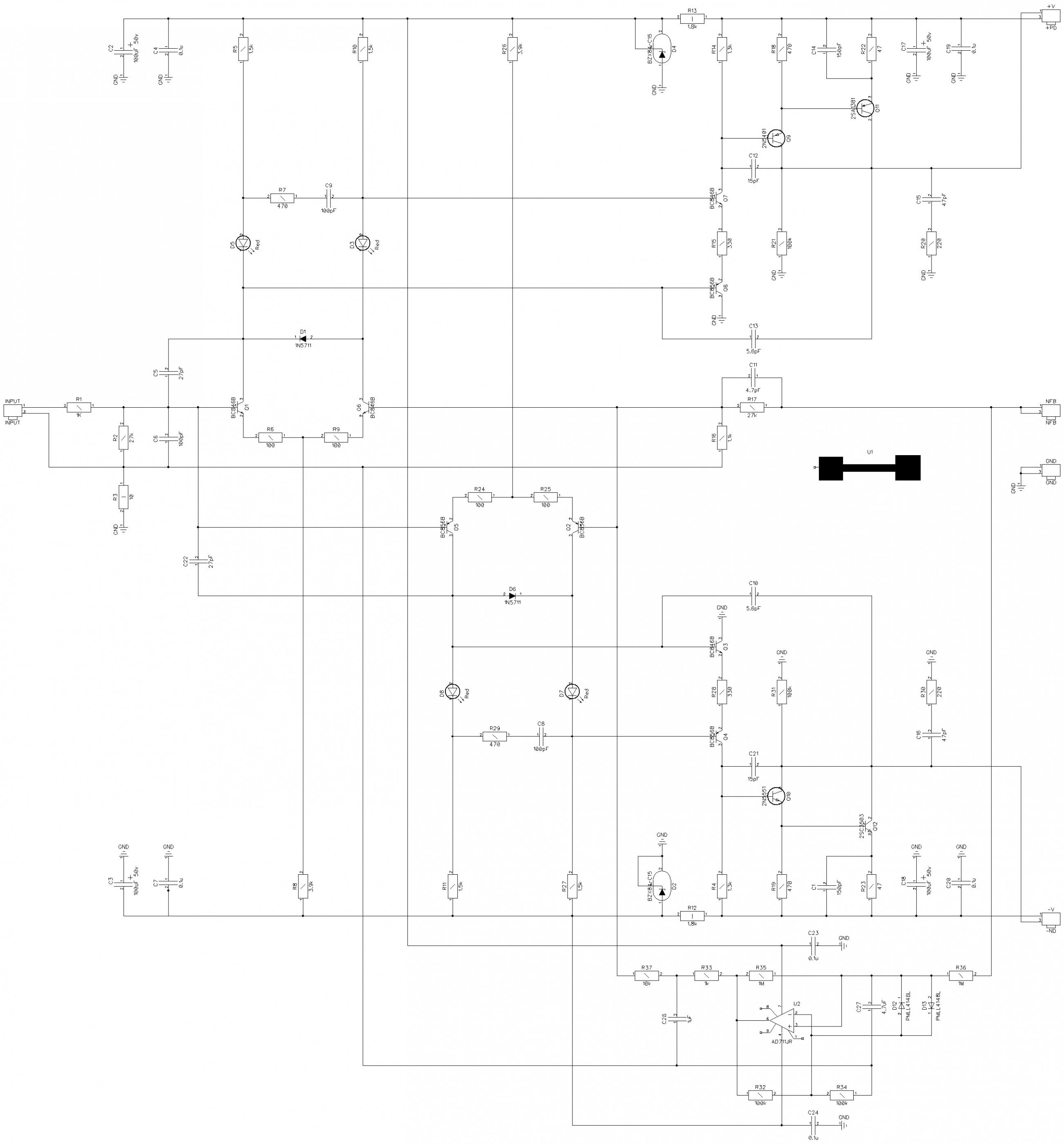

I have slightly updated the schematic and Jeff has designed a great layout for the beast. There is a trimmer for DC offset adjustment now.
R23 = 130R, VAS current = 5.5 mA, good for Slewmasters.
R23 = 47R, VAS current = 15mA, good for driving the MOSFETs directly (e.g. Tubsumo).
You have 5 comp. caps ? Lead /lag , miller , and a shunt ! How did you arrive at these ?
BTW , a very interesting "blameless" -mutant. I like the decoupled low voltage input and overload clamp.
OS
Each comp cap is responsible for particular part of the curve 🙂 At the same time - most of them are rather small.
Key topology specialty - a "vertical" differential cascade, doing a lot of good things at once. The whole thing is going to be pretty fast for VFA 😉

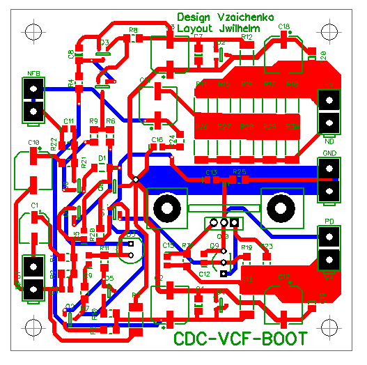

Are you only planning to do a SMD version? I was hoping for a single sided "etchable" version.
There are more coming. I'm going to do smd and through hole versions of both designs.

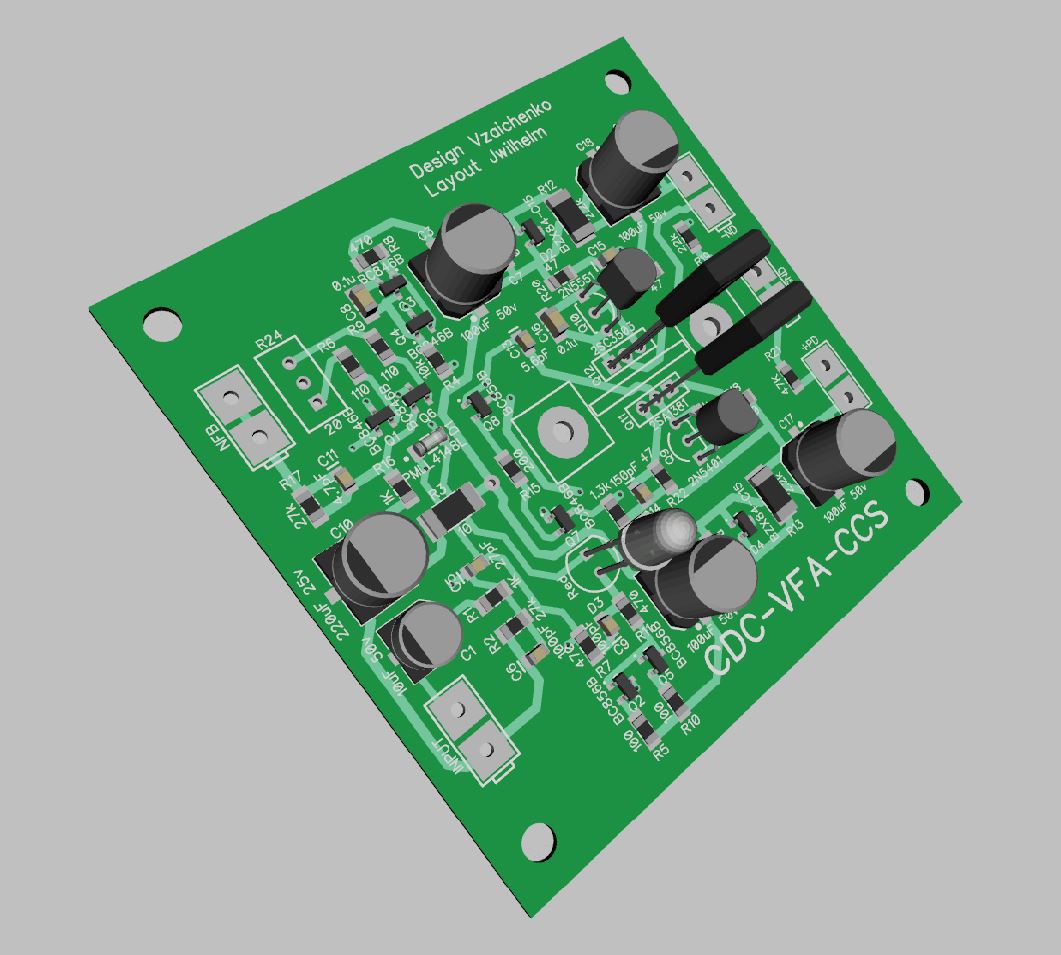

Can you double check the orientation of the VAS transistors? I think the 3D model is backwards in Diptrace. I think I have them installed correctly(ECB) but Diptrace is showing the metal side out.
Yes, I have noticed that - 3D model is wrong. Your orientation is good.
One can aditionally shape the frequency response by shunting the resistor between the emitters of the serial cascade with a RLC dipole network.
Exactly! I experimented with that when worked on compensation. Left it blank now, but it's a good way of shaping the frequency/phase response

Should R22/23 be 1W resistors for 15mA VAS current?
Not really - the voltage drop is low, so power dissipation is low as well.

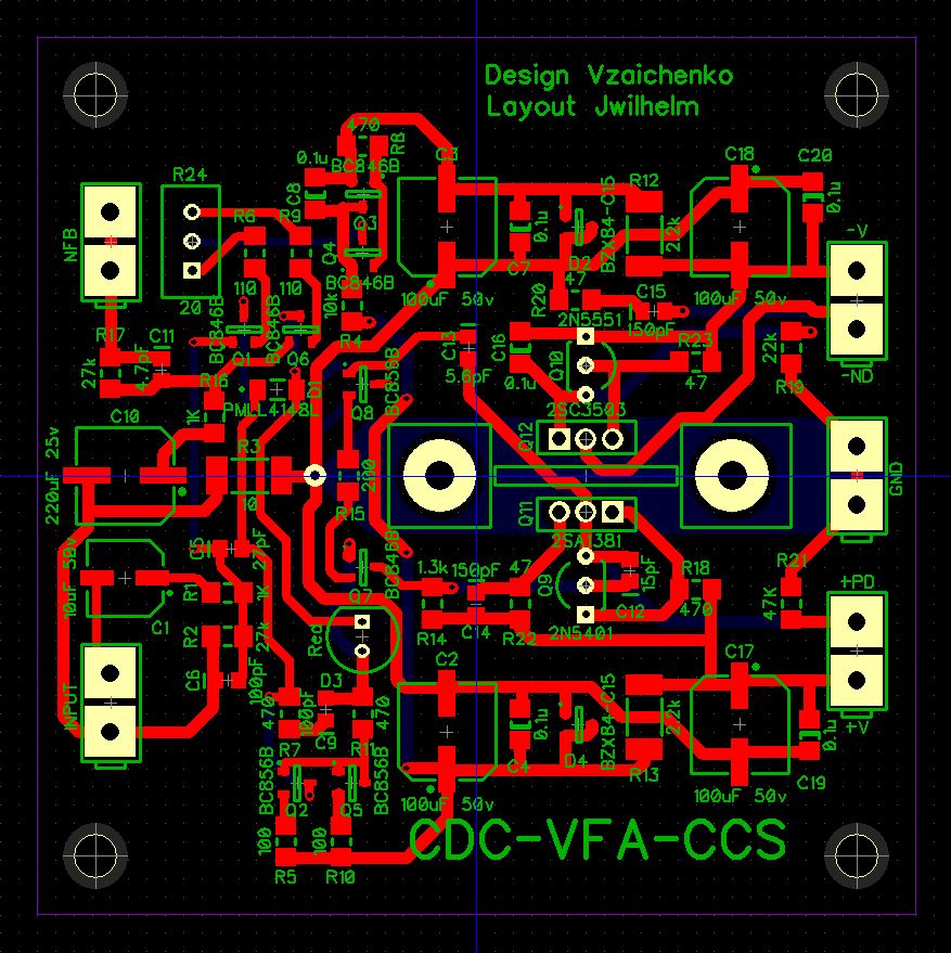

Symmetric design - the last one in this series (I believe 😉)
One more implementation - for those, who likes symmetry 😉
Symmetric slew and clipping by design, rather high speed, very low distortion.
I made it DC-coupled. If someone wants to add a cap at the input - a good way to do it is to have 2 pairs of input RCA's (DC and AC coupled) and solder the cap right on their pins.
Worth testing.
Jeff, are you up to one more layout? 😉
I'm sure it can be kept within 3"x3" as well 🙂

I would love to test it. Single side, through hole works best for DIY.
Hopefully I'll have all three ready for you tomorrow night
Sounds good

Hi Valery,
I have often wondered about DC coupling. I know a couple of your earlier designs provided for both. Can you please explain to me the advantage/disadvantage to DC vs AC coupling?
Thanks, Terry
Hi Valery,
Thanks, Terry
Hi Terry,
The key advantages of having the power amp DC coupled:
- there is virtually no bandwidth limitation at the low end - the amp works starting from DC. The only limitation is DC servo, but its time constant is more than 2 seconds, so it does not really influence the audio bandwidth at its low end;
- there are no large capacitors anywhere throughout the signal path - more long-lasting amp characteristics. All the small compensation ceramics work far above the audio bandwidth and they are rather stable in a long run.
Disadvantage - you need to make sure there is no offset at the output of the preamp or other source, connected to your power amp, or the offset is low enough to be handled by the servo (couple of hundred mV is ok).
In many cases, there is a decoupling cap at the preamp output already, or it is also servo-ed, or just well-balanced, so the whole thing will work fine. Preamp, having an offset at the output is not a good design preamp.
