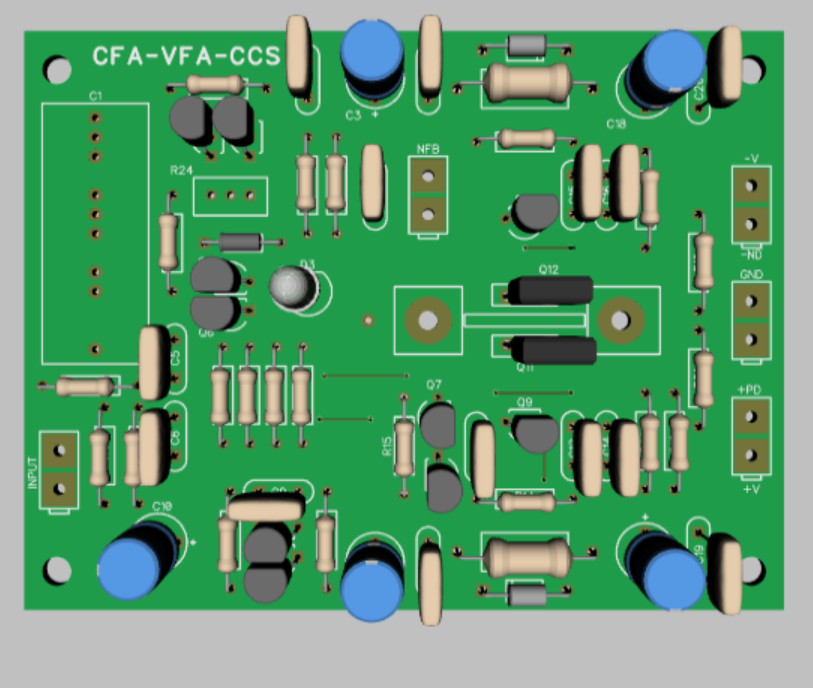

Here's a single sided through hole version of CDC-VFA-SSC
  • CDC-VFA-CCS-2 TH Bottom.pdf
  • CDC-VFA-CCS-2 TH silk mirrored.pdf

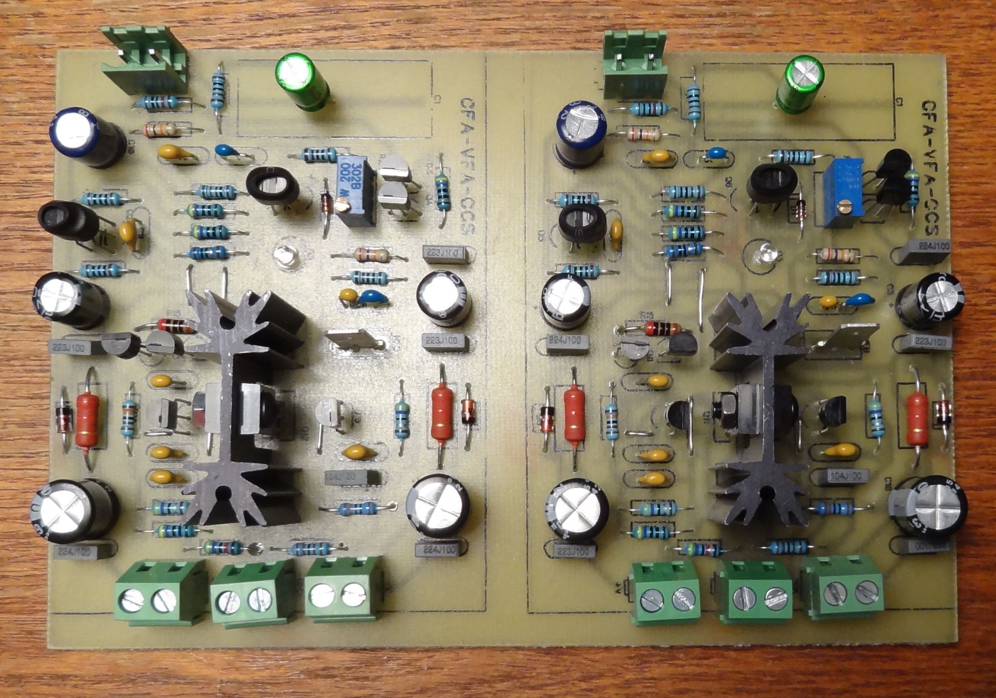

Hi Guys,
Hopefully you see this sometime in the morning. Seems I need a little nudge in the right direction. Is the schematic in post 21 the correct one? If so are D2/D4 15v? Should I use BC550/560 or BC546/556 for the small transistors?
Thanks, Terry
Hi Guys,
Thanks, Terry
D2/4 are 15V. I drew it up wit BC550/560 but either choice would likely be fine at 15V. The two TO-92 in the VAS section are 2n5401/5551 for the higher voltage.

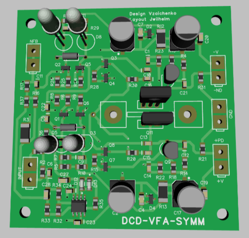

Hi Antonio,
Thank you for the info, but 2SA1360/2SC3423 are rather rare in my area, and 2SC1775/2SA872 are nice low noise Hitachi devices, but simply impossible to get here (even Mouser doesn't sell them).
However, in case you've got the SPICE models for 2SA1360/2SC3423 - could you please share them? It would be interesting to try some simulations.
Valery
Valery, how good is thermal stability of the circuit, especially thermal stability of VAS idle current?
Very valid question. I did not test this particular one, but I have heavily tested my other symmetric circuit - >THIS ONE<
It took some tens of seconds to settle, but then it stayed constant (keeping the OPS bias stable) - no problem.
We have provided a local heatsink for the VAS TO-126's. At 5-7mA VAS current it's not going to be a problem anyway, if someone is going to run it at, say, 15mA (e.g. for driving the MOSFETs directly) - it will take a bit longer to settle and it will run warmer for sure, but I don't expect any thermo stability issues.
