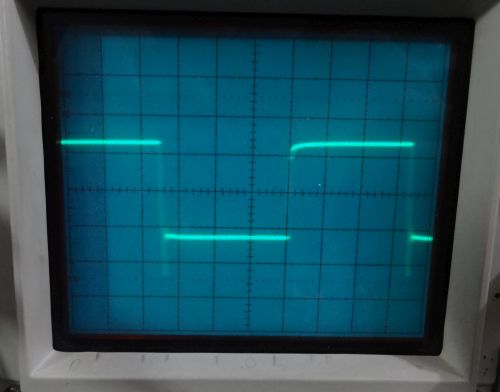

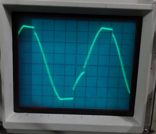

OK I have it playing. Sounds fine but it clips funny and has some "stuff" on the square wave. One note is that I didn't have a couple of the exact values for the small caps. C11 is a 6.8p and a 2p in series, (measures 4.8p on my meter) and C13 is a 5.8p. All others are what is called for. I am using my Mini Slew OPS 1P latfet. Scope shots taken at 7.5khz

Terry, thanks a lot for the info - I will analyze it. Probably, I need to "slow it down" a bit.
Hi Terry, please remove C15, R20. You can also optionally increase C13 up to 22pF.
Spikes at the bottom should be gone. Referring to schematic from Post #48.
It is also recommended that there are no shunt capacitors at the input of the OPS (sitting between b-c of the pre-drivers in some OPS modules).

Is the first sqw the test signal, or the output signal?
It helps interpret the signals if both test and output are displayed on the same screen.

I haven't tried any modifications yet. I wanted to report on some findings trying other OPS first. The Tubsumo OPS looks better. I still see the slight overshoot on the square waves but they are top and bottom equally. However, I still see latching on clip. The Slewmaster 5P OPS will not work at all. Big surging on my light bulb tester and it will not come up on power.. With the big slew OPS I'm seeing 3.4V on PD+ and 100mV on ND- but as I said is surging badly and pulling way too much current.
With the Tubsumo OPS attached, I read .633V across R23 so about 4.8mA for the VAS. Next I will try lifting a leg on R20 an see what that does to the overshoot and latching.
Right now the Slewmaster OPS is a no-go.
Blessings, Terry
EDIT: I reattached the Tubsumo OPS and retested at 7.5khz and I actually see exactly the same thing as with the little Mini OPS. I then lifted R20 and there is no change at all. I will try raising C13 to 22p and see if that helps.

Did some more testing. 22p in C13 made the square wave sides sloped, especially the leading leg. Top of the wave is flat but the bottom still has the overshoot. Clipping looks as bad as before. R20 in or out makes no difference. Adding an 8ohm load causes the bias to shoot up. Actually blew fuses first time I tried it so I went back to using the light bulb. It acts like there is too much gain?
