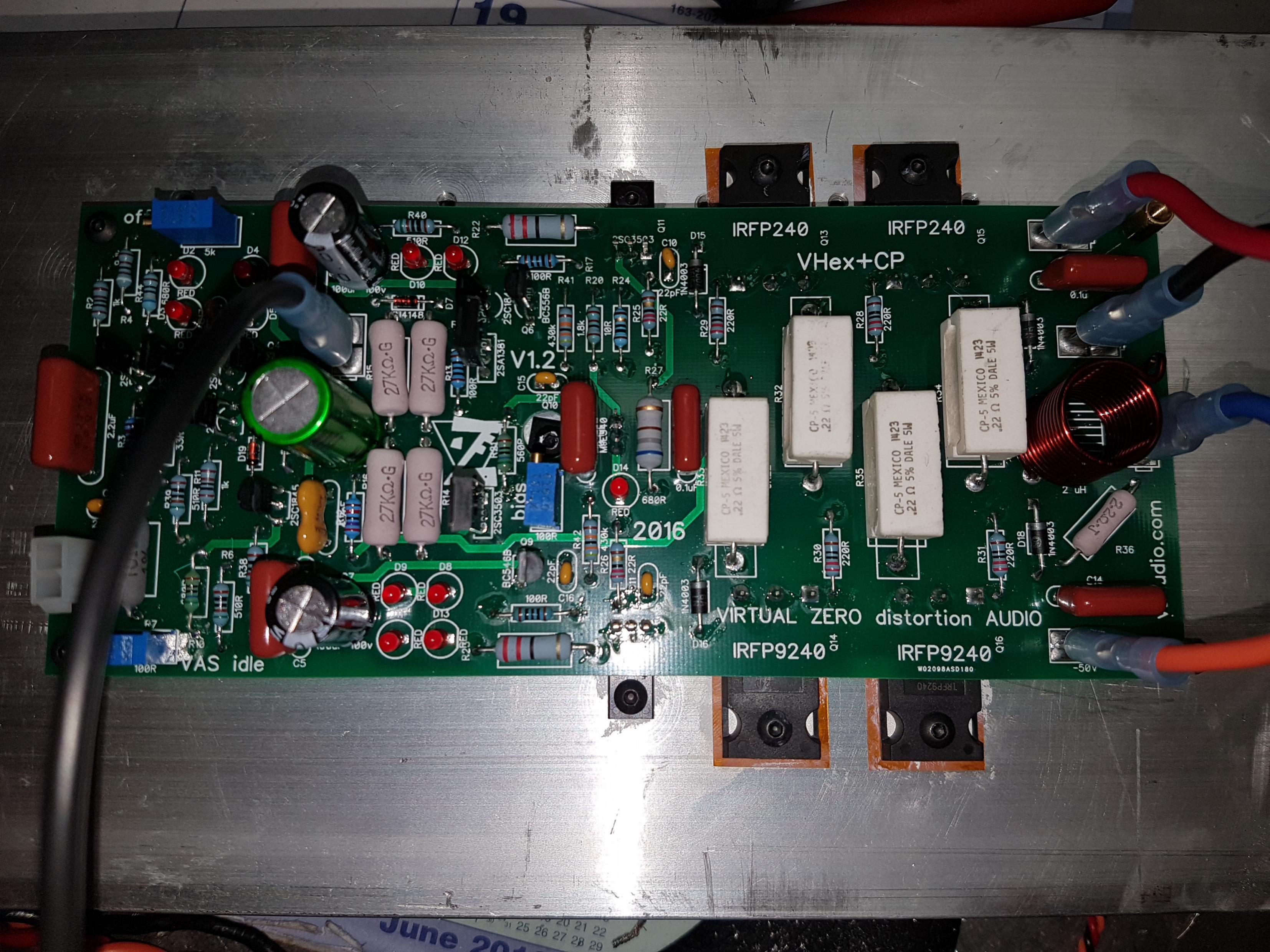

Here are the prototype tests, performed by Thimios: VHex+CP measurements

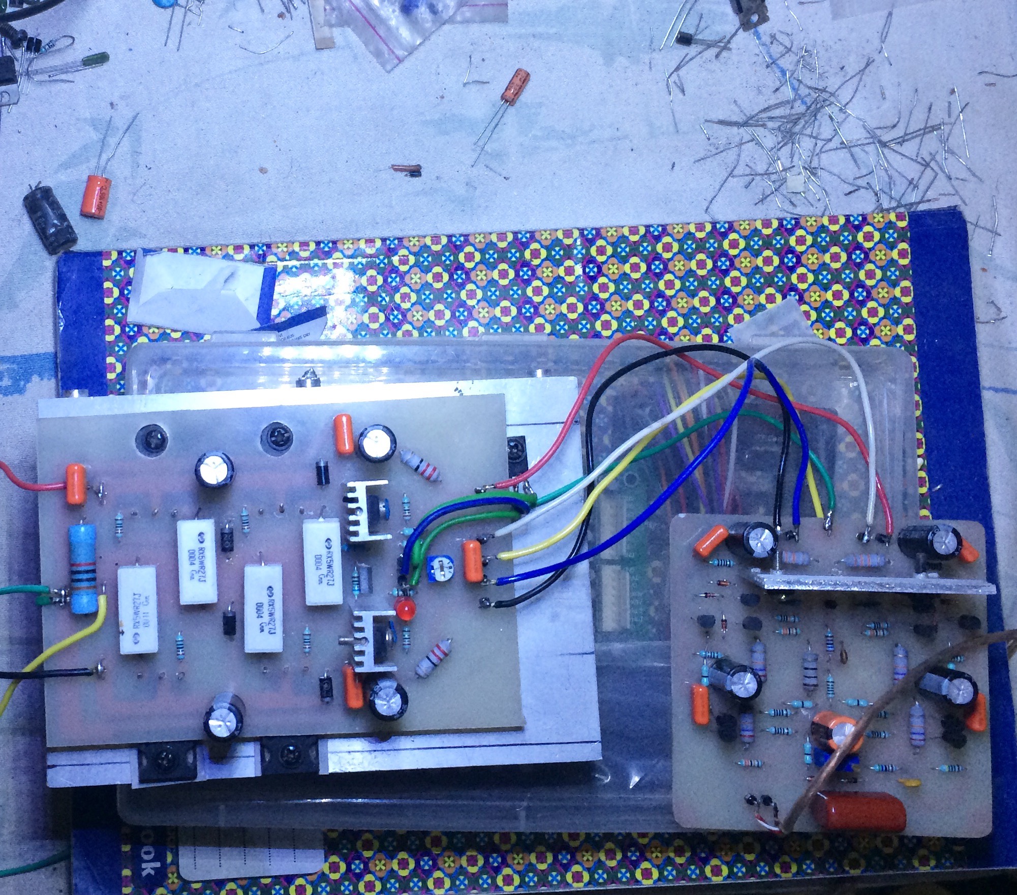

Hello vzaichenko
greetings i just did a test with 30 volts dc +/- amp came on
without any problems but t😉 he led did not come on feeding it
with signal from cd player sound clarity is very detailed can
you help me with biasing it with 57 volts dc +/-
warm regards
Andrew

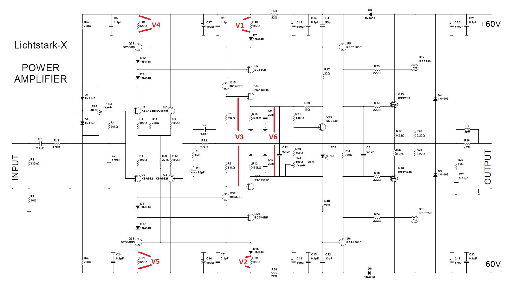

Hi Andrew,
Let's check the currents in the IPS module first.
Can you please measure the voltages as shown on the schematic.
Then just put them in the post like:
V1 = ...
V2 = ...
etc.
Valery

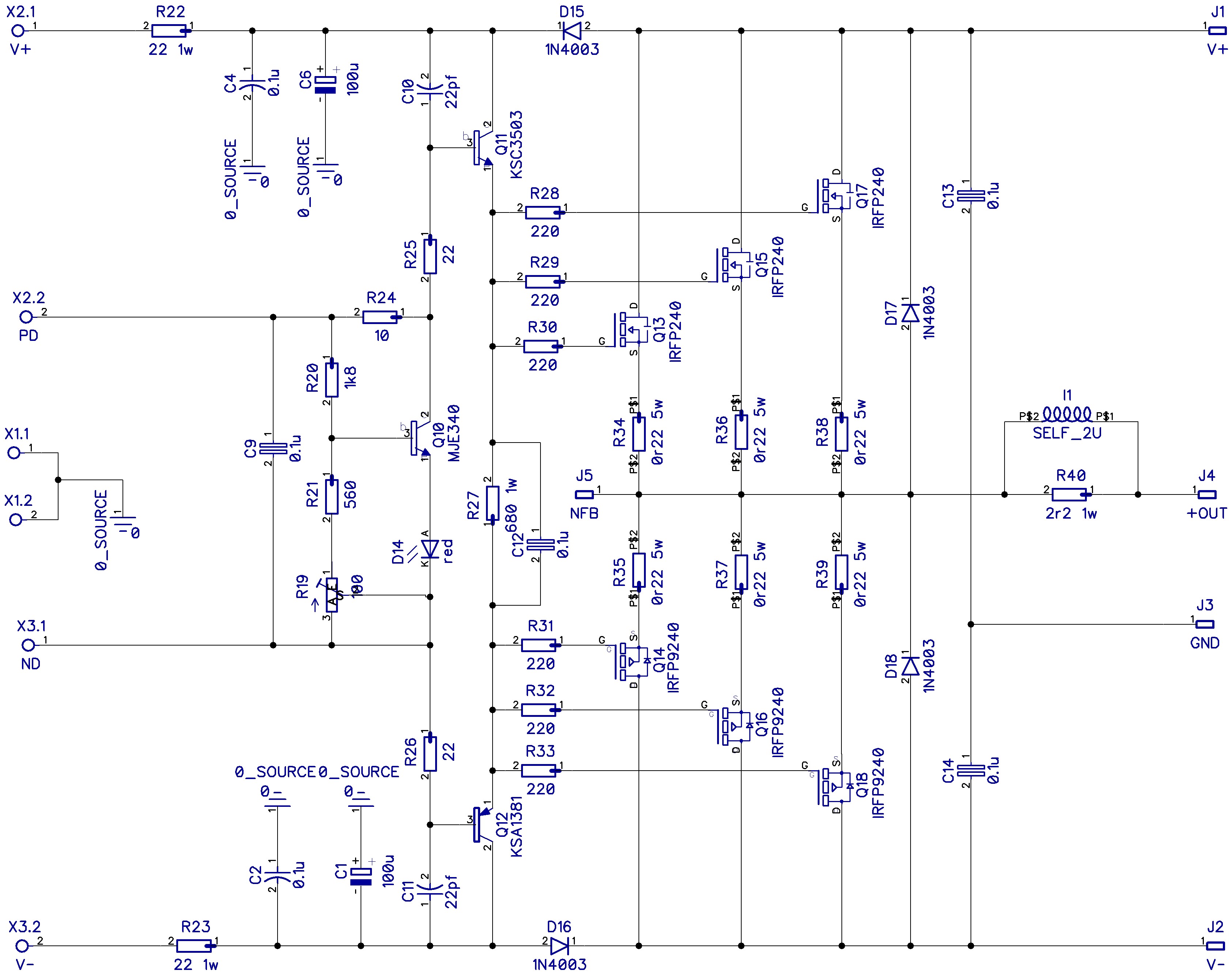

Valery, if you reverse D15 and R20 as well as their conterparts and then connect the collector of Q32 the anode of D15, is there a difference. The layout becomes easier if this connection is made. this wil bypass the 100 ohm resistor in the path of Q32 ( and Q15)
It also seems possible to omit C1 and use the offset trim to compensate for it

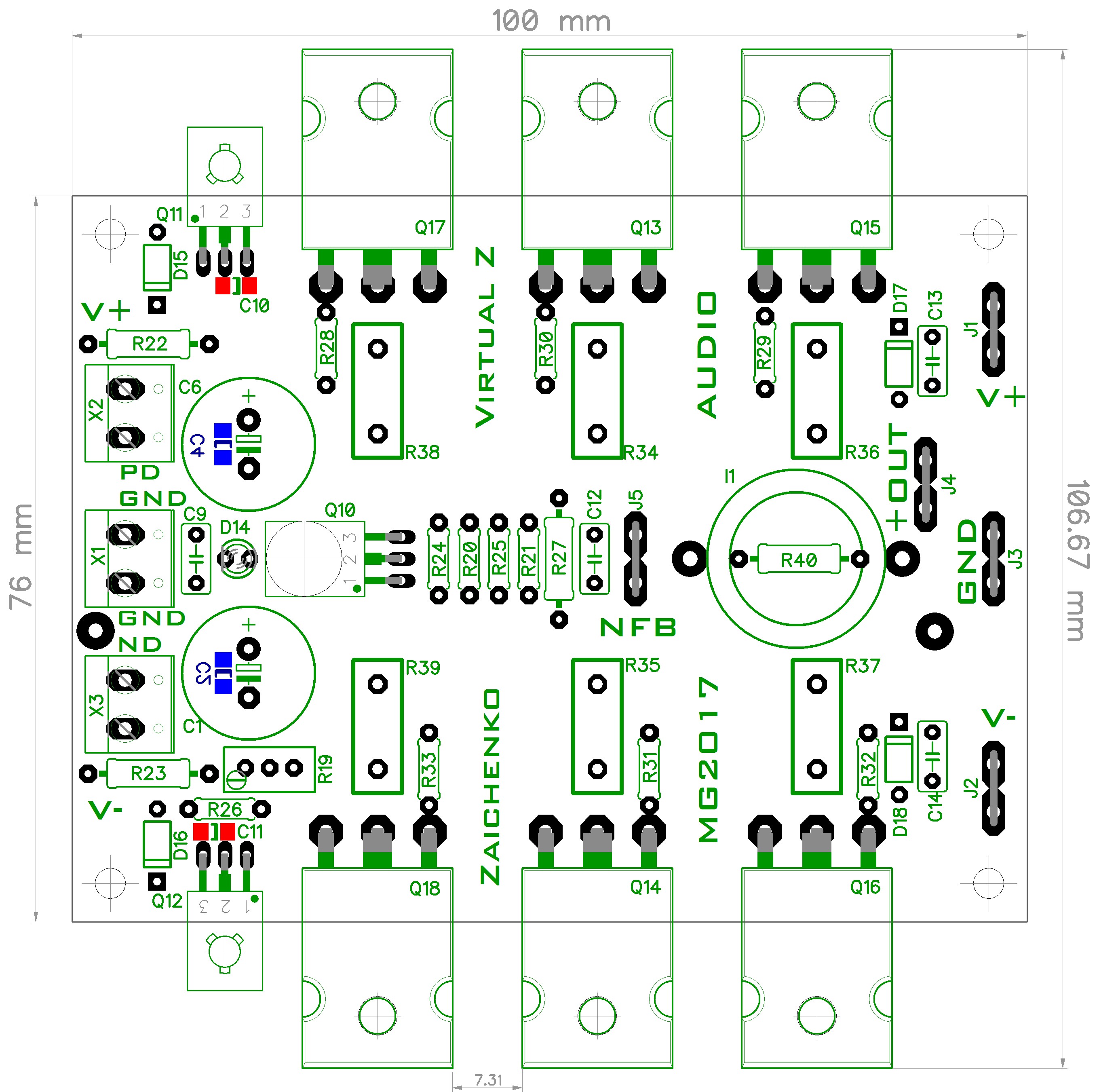

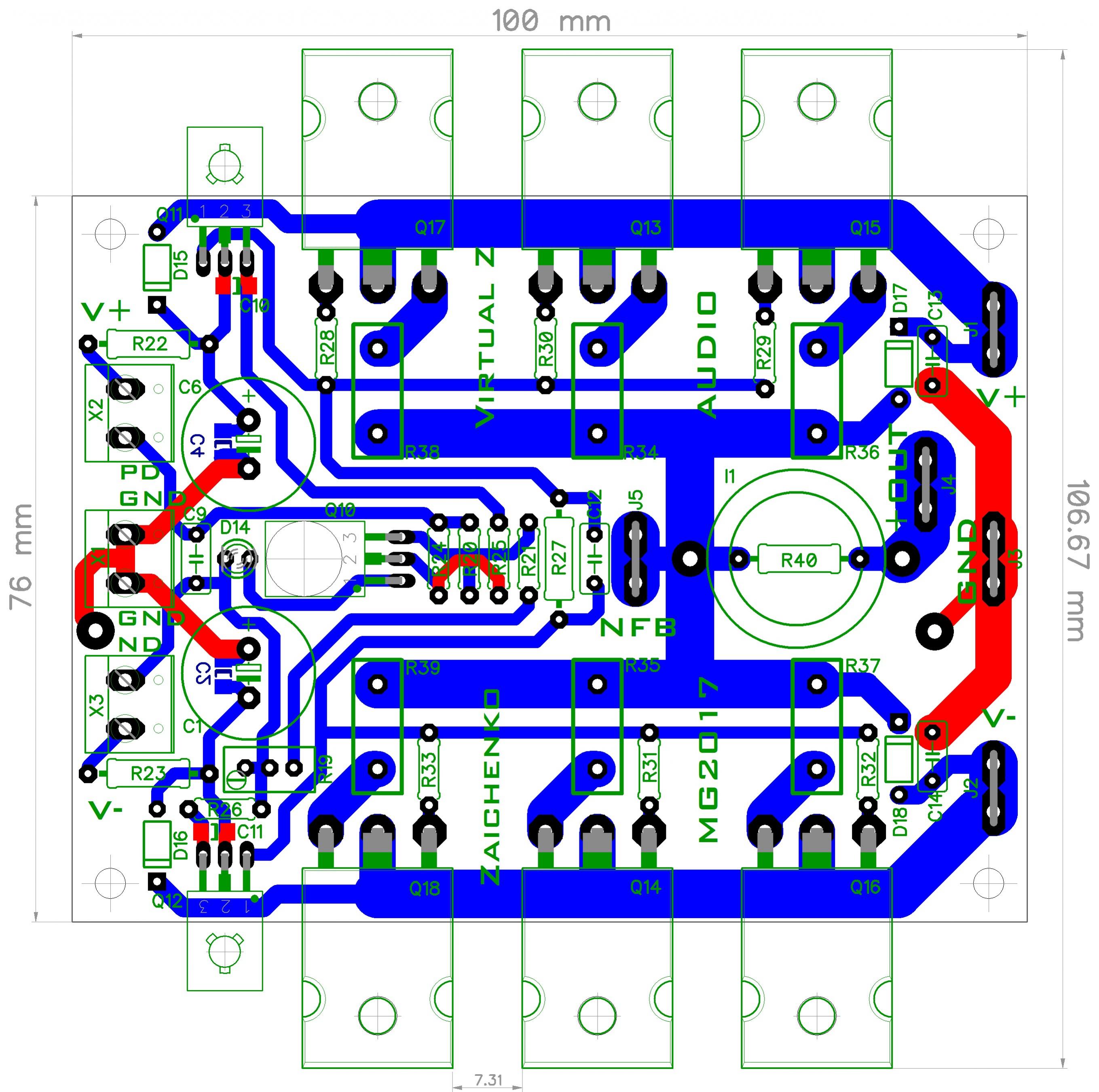

Layout tryout on Valery VHex_OPS. The board mesure 100x76mm with 3P. So it has some 1P/2P/3P universal layout as there is no gain to go for 2P or 1P layout. Price will be the same. board house will coast you under 30$ (shipping included) for 10u
Marc
Unfortunately - there is a difference.
C1 - yes, possible. I leave a placeholder in place anyway - then one can use the cap or jumper the placeholder 😉
Valery - Thanks for the response.
I breadboarded it and found the difference as well. Dumb Mistake
the current from Q32 (~2ma ) causes an extra .2v across the 100 ohm resistor greatly effecting current through the diff stage. I am changing my layout.
Cheers
Marc
Kewl job, Marc :cheers:!
My personal favourite were a board that combines both the Lichtstark IPS and the VHEX OPS, though. Maybe in the format of the Honey Badger board? I surely prefer this in-line arrangement of the driver and power devices, as this allows for slim enclosures.
Best regards!
