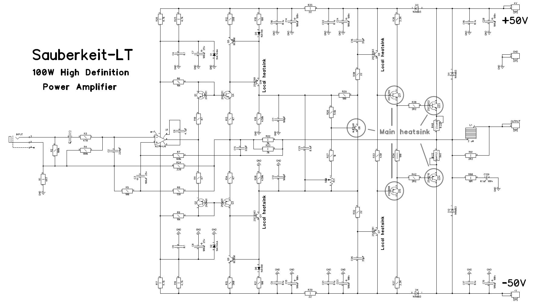

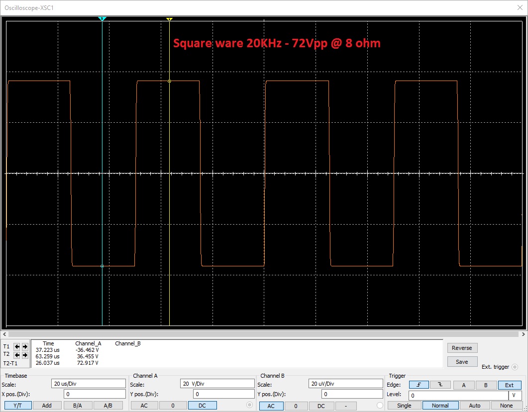

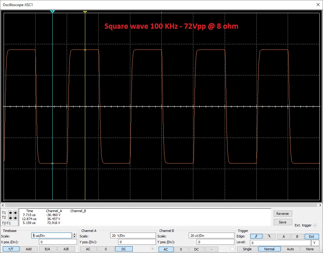

Hi All,
I decided to make a rather compact and relatively simple DIY-friendly 100W version of the amplifier, based on slightly simplified topology of top-performance Sauberkeit front-end.
I'm not a big fan of the OpAmps in power amplifiers, however - there are always exceptions for a good reason 😉
I'm sure it will be possible to squeeze a single layer PCB into 100x100mm square with just one pair of MT-200 outputs. 2 pairs of 3281/1302 may be used as well, different drivers, like MJE15032/33, are also an option.
It also simulates nicely with HexFET OPS from VHex series - 2 pairs of IRFP240/9240 with KSC3503/A1382 as the drivers.

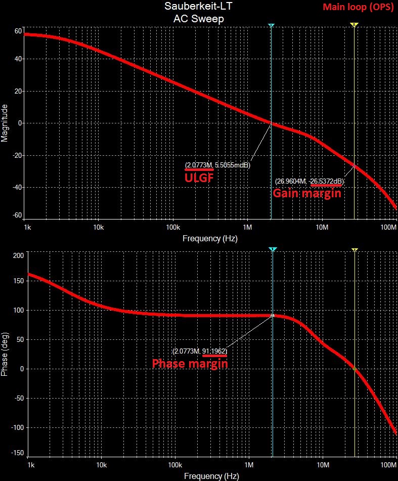

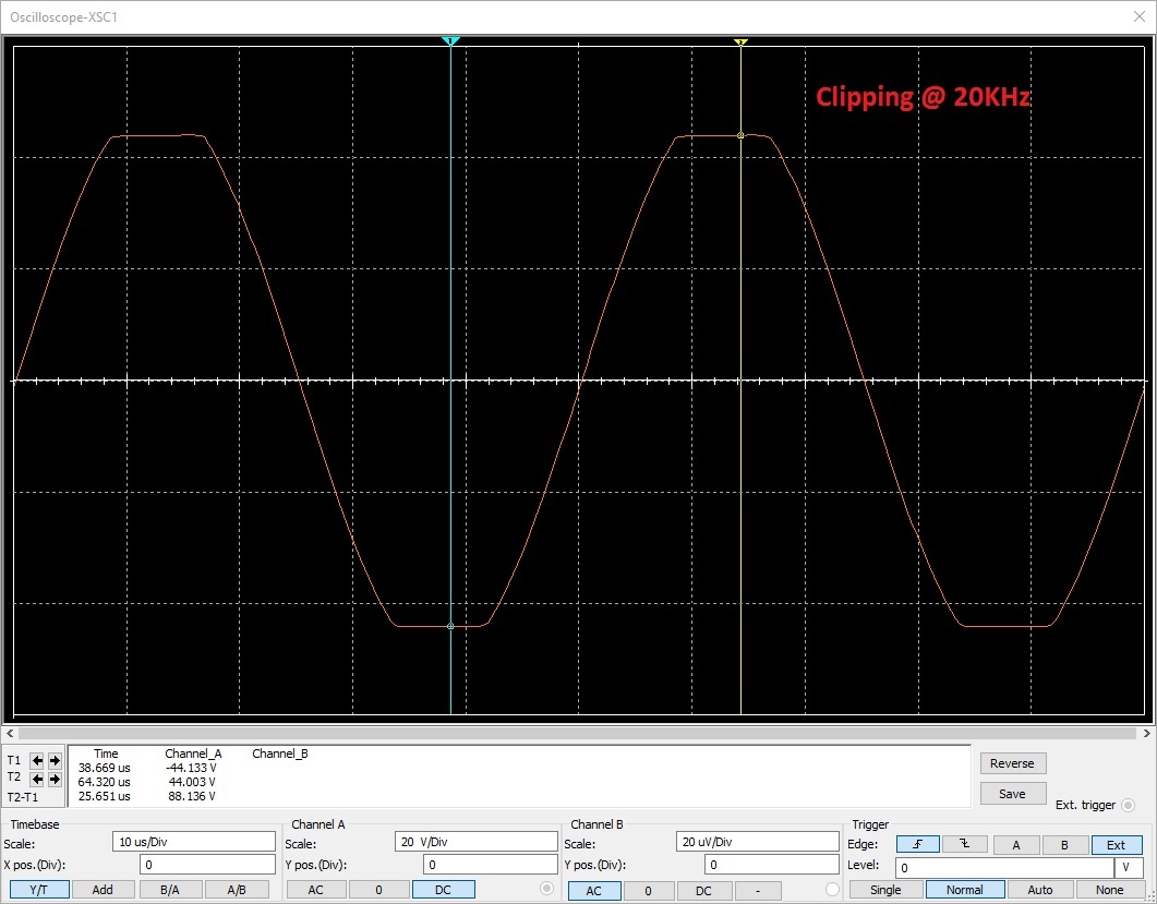

Key advantages of the topology - low distortion and high - 250...280V/uS - slew rate (depending on particular devices used as the drivers and outputs).
Note multiple feedback loops, current-driven VAS and some other cool nuances.
I will try to come up with my version of the layout, however any other versions are welcome (Marc? 🙂)...
Valery
P.S. It takes the best things from both CFA and VFA "worlds" in combination 😎

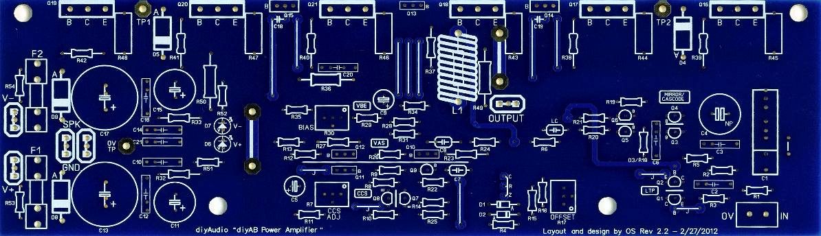

Hi Valery,
For a long time now I have been meaning to build the Mark Alexander CFA design from years ago. I bought the parts, I got as far as designing it, just need to fab and test it out.
Find attached my version of it, done to fit 100x100mm pcb. Let me know what you think?

Valery;
Thanks for sharing. Have you looked at the" op amp driving grounded source mosfets" approach?
mlloyd1
mlloyd1

Hi Rick,
I like the overall layout, having one concern though - this kind of board width is fine for 1 pair of the output devices, with 2 pairs it looks somewhat "busy". On the other hand, if the heatsink is good and you're not going to drive those FETs to the limit - it's going to be ok.
Please let me know how it goes - interesting project.
Valery

Hi Rick,
Valery
This is roughly what I have in mind with regards to the space between the outputs and corresponding board proportions - assuming all outputs are located on one side of the board) - this is a "Honey budger" board by Ostripper.
One pair - it would look like a square, two pairs - almost twice as wide, etc 😉

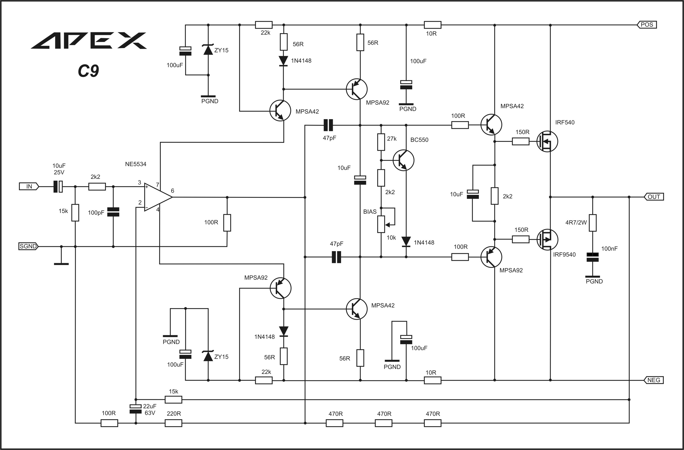

There is C9 if you like simple stuff
Regards
Thanks Mile, You bet I will try it. Maybe I will just change the current mirror, just in case of use a differed OP-amp I can balance the VAS current. The less components the better.
Regards
Peter

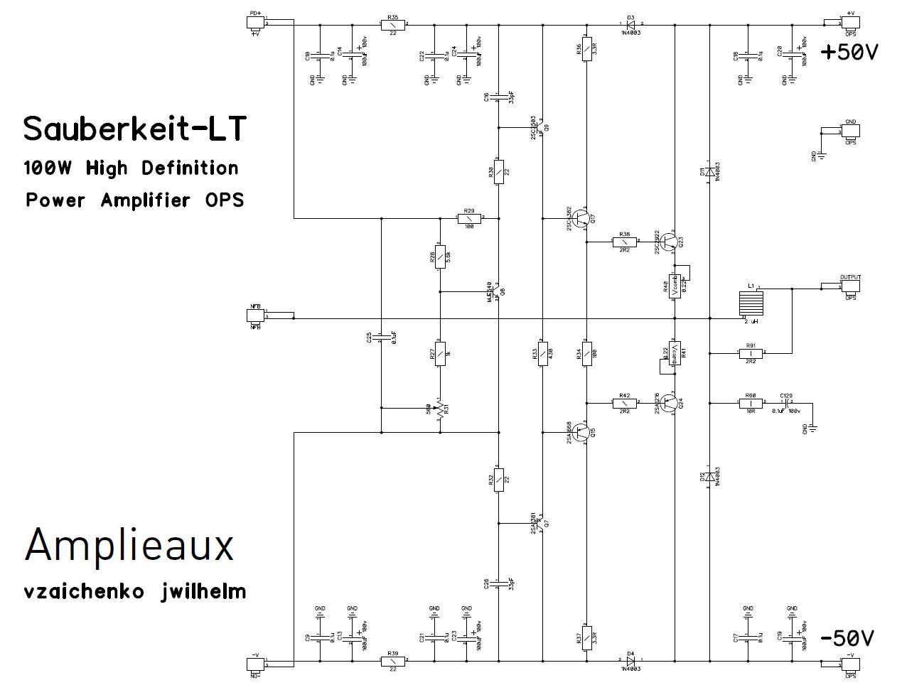

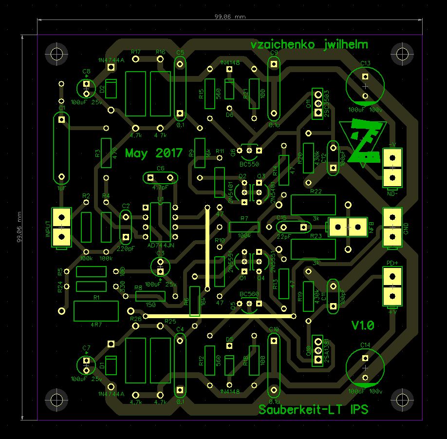

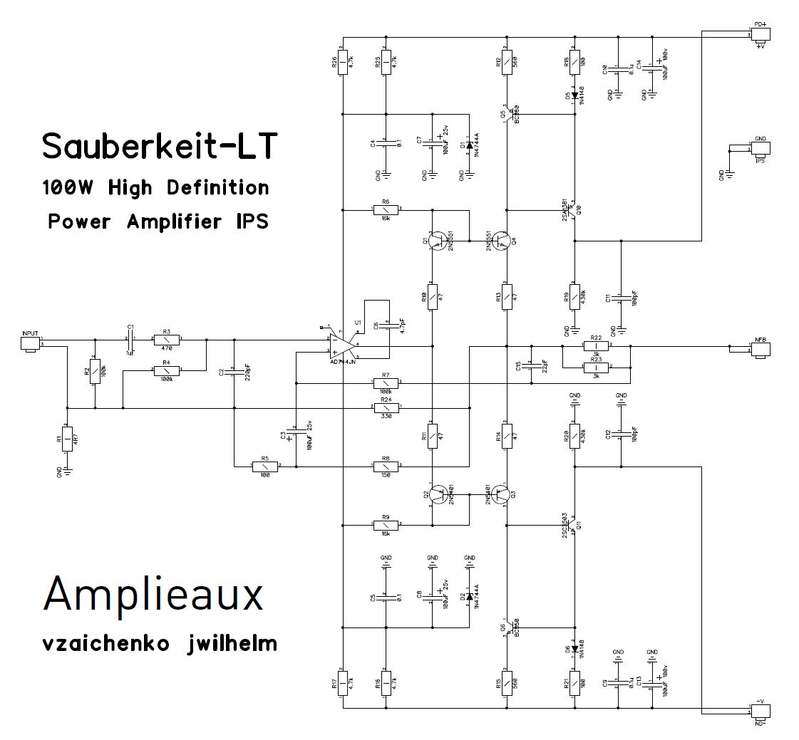

Sauberkeit-LT layouts, including etching-friendly version

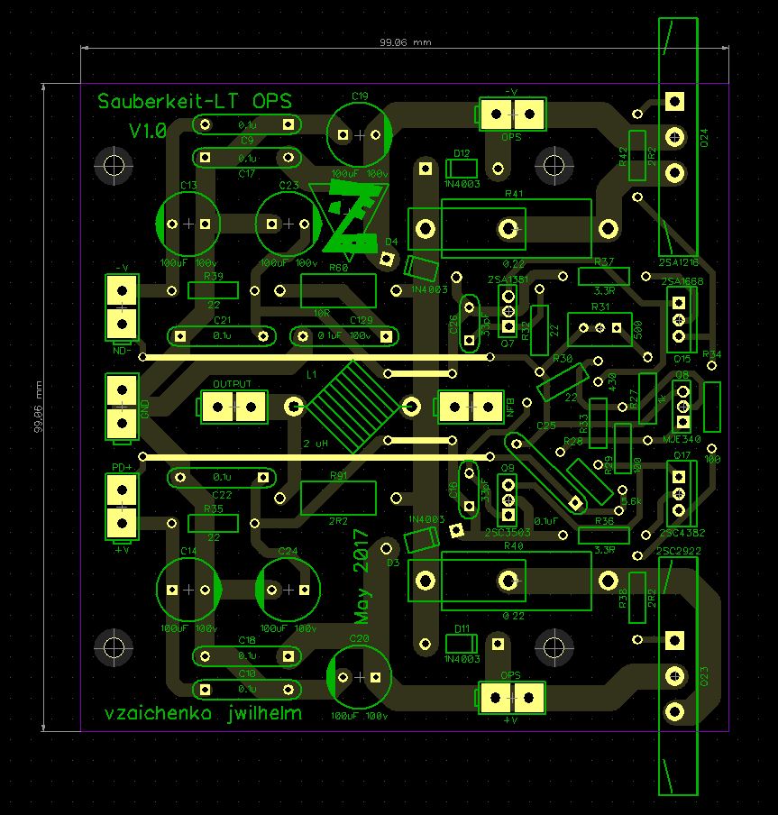

Hi All,
I have finally done the layouts for both IPS and OPS modules (TH).
Both boards are 99mm x 99mm, Gerbers for the board house and PDFs for etching are included.
Our compact control boards can be used for soft-start and protection - see my signature below.
Let me know if you will have questions.
Valery

R29 seems unusually high @ 100r.
How did you arrive at this value?
Hi Andrew,
You're right - the optimum value is around 10-15R - used to compensate possible VAS current fluctuation. I took the spreader from one of my previous designs without too much thinking about it.
Although it will work as is, the values, closer to optimum: R29 = 10R, R28 = 4.7k
