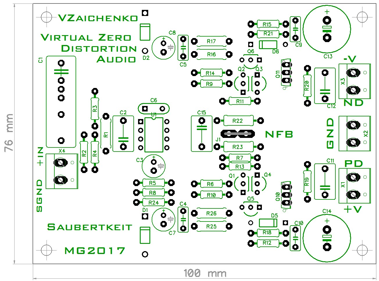

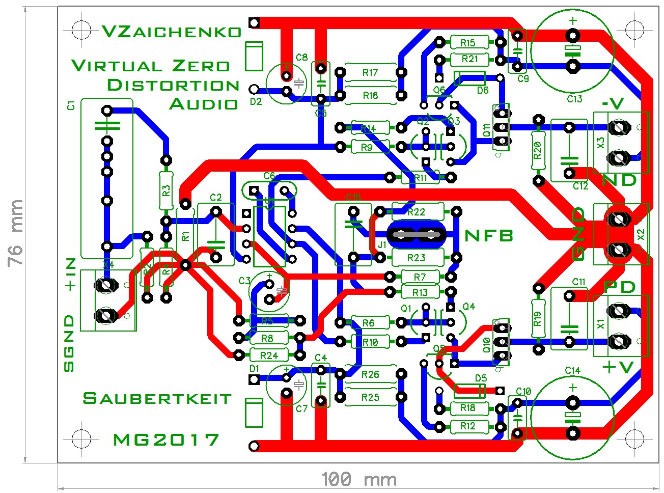

I must prepare my <<test bed>>
Some tryout on Valery Sauberkeit line. I try to do it the more versatil i could for OPS as you can use either 1 pair Sanken MT200, nor 1 ou 2 pairs MJL (3281/1302 or 4381/4302). Both OPS and IPS have same size : 100x76mm, same as Lichstark-IPS and VHex-OPS
Marc
Marc

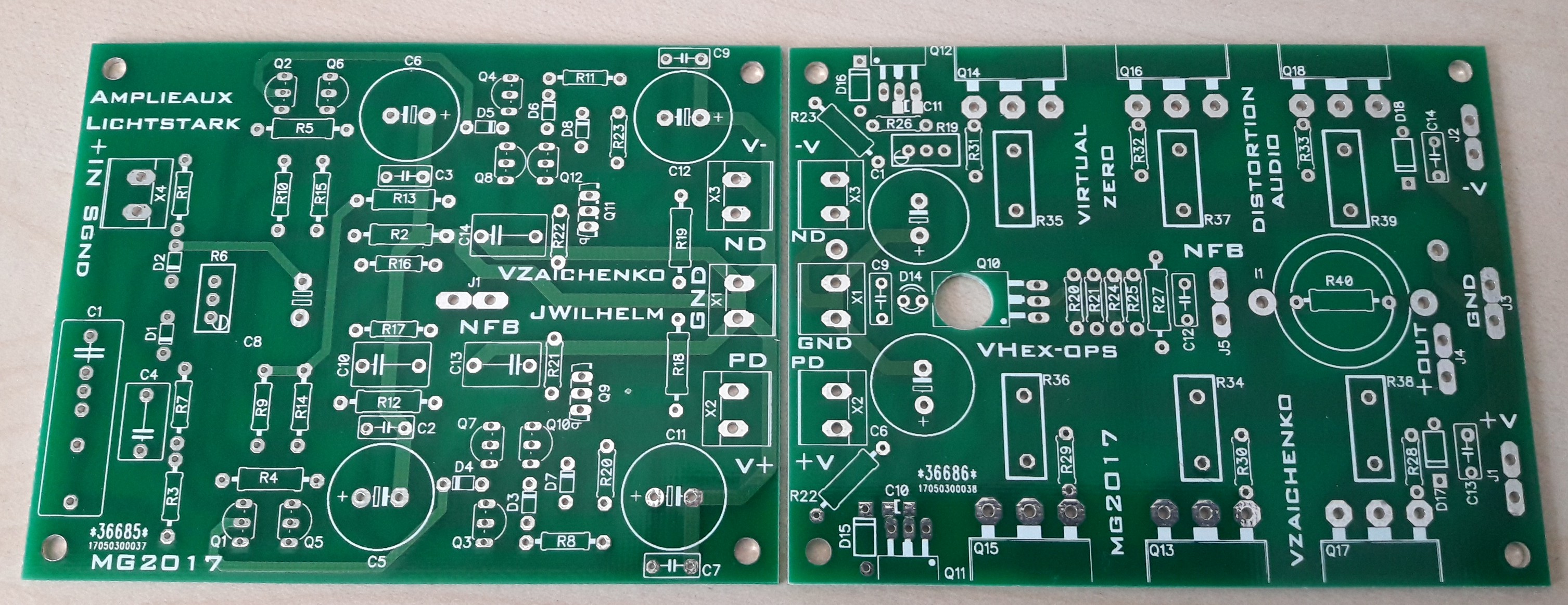

Hi thimios,
fortunatly, these board are not compatible with NS-Modular, i wanted something more simple even if i have NS board. These latest range of board has the same size : 100x76mm so even something more compact than NS-Modular.
Marc

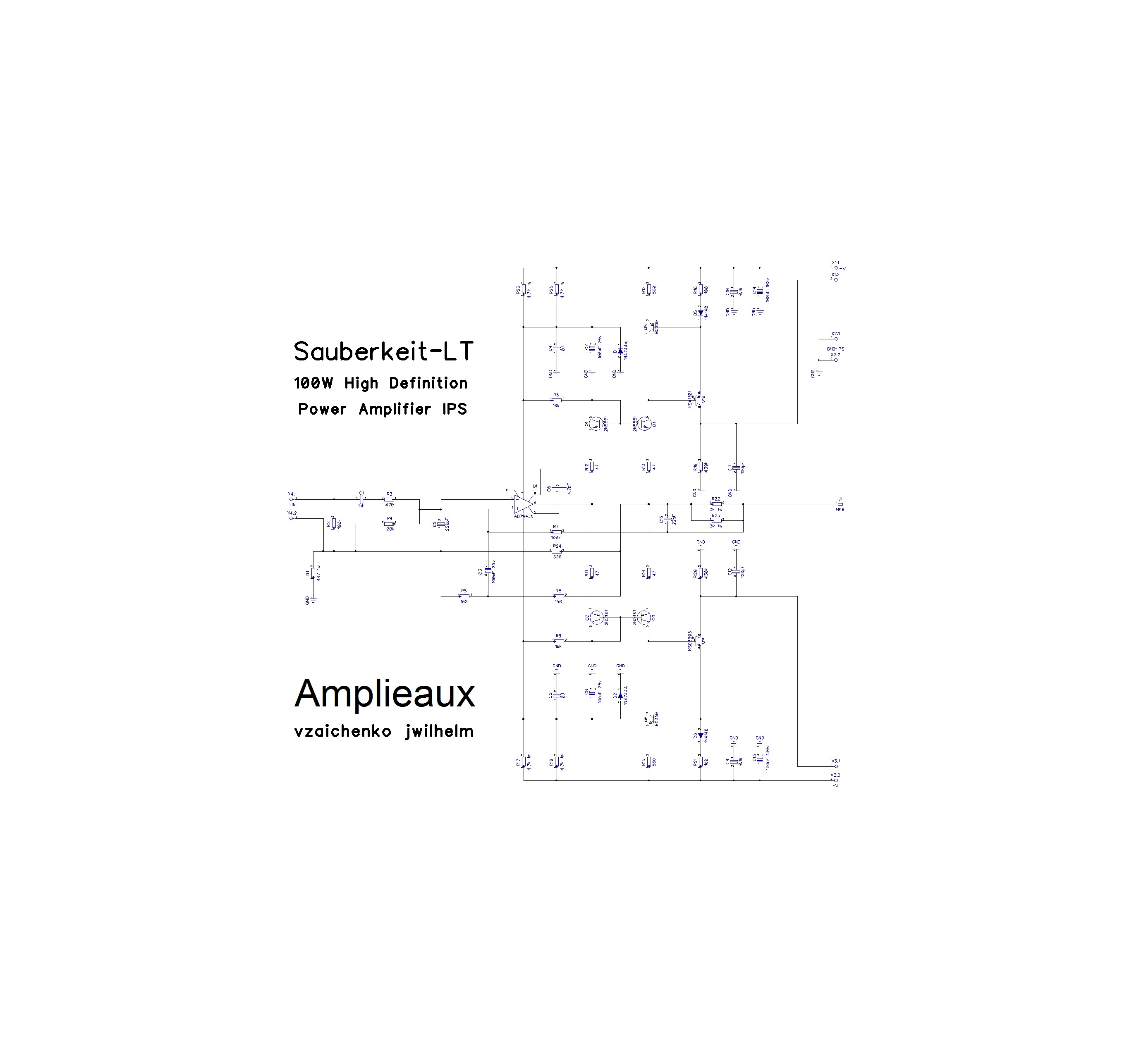

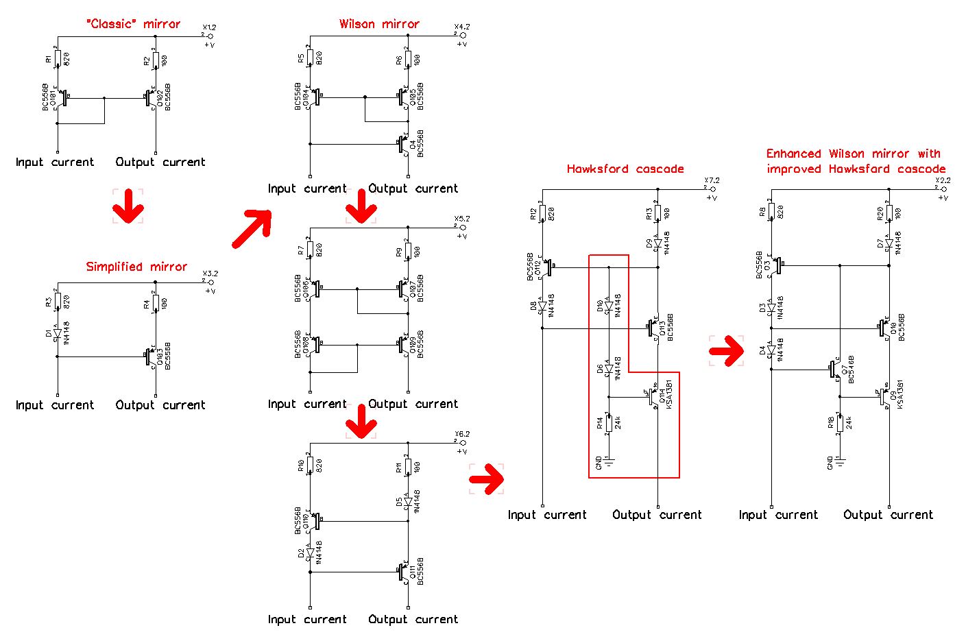

I have a question about the Lichtstark IPS, for what the transistors Q3, Q7, Q9 and Q10 are used for:
http://www.diyaudio.com/forums/soli...eas-1970s-ips-ops-204.html#post5066318http://
Those transistors, together with D3, D4, D7 diodes, form a high-precision cascoded current mirror with gain, playing a role of one half of the current-driven VAS.
Hello,
can you explain this configuration more precise:
I recognized that Q1 and Q5 are forming a difference amplifier. But wich transistors are forming the current mirror and the cascode. So far I know a current mirror consits of to transistors with Basis Emitter in parallel and a cascode are two transistors one above the other with basis of the top transistor on ground.
Hello,
You mentioned the simplest implementations of the current mirror and the cascode.
OK - I have tried to illustrate the evolution of the current mirror in this design.
A few hints for better understanding:
- different values of the resistors in the mirror -> mirror with gain;
- transistor with the base and collector shorted can be replaced with a diode in certain conditions;
- my implementation of Hawksford cascode improves precision (the base of the cascode not necessarily has to be connected to ground, although it's still a common base circuit);
- D4 in the final schematic is level shifter; all the other diodes are parts of the Wilson mirror.
Valery

Lichtstark-X live testing - initial observations
Marc and all,
With reference to post#2039 IPS board schematic:
Lichtstark-X layouts designed by Marc
Based on live tests, performed by Jeff, with +/-48V rails, for having 6.9mA VAS idle current, R12 and R13 have to be 13K each.
Adjusting those values, you can adjust the VAS current - slightly higher values will result in lower VAS current and vice versa.
You can test IPS board standalone, connecting PD+ and ND- with 2 x 100R resistors in series, connecting NFB to their middle point and using it as output.
Check the VAS idle current by measuring the voltage drop over those resistors.
Jeff is assembling the OPS section of the amplifier, so expect some real test results pretty soon 😉
Valery
Marc and all,
Valery

Hi Valery,
thank you for the explainations with graphics - it will help me to understand the schematic 😉.

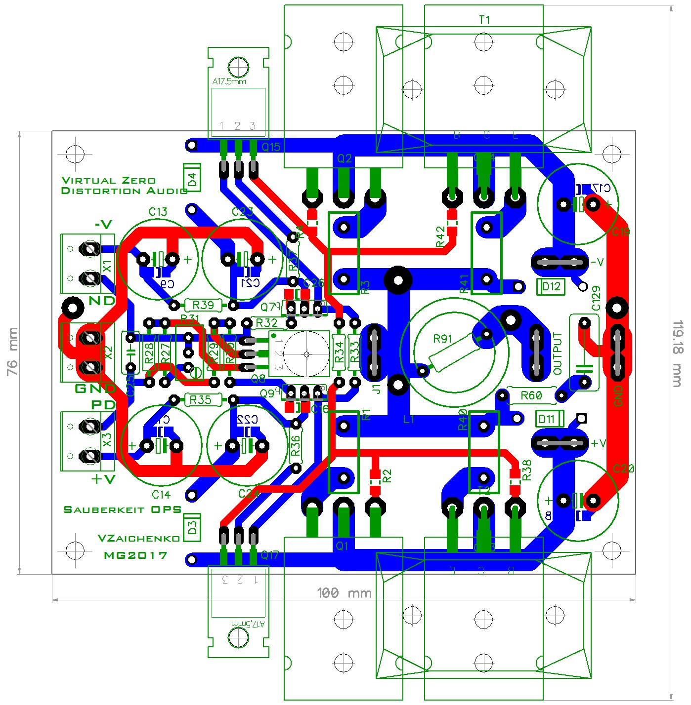

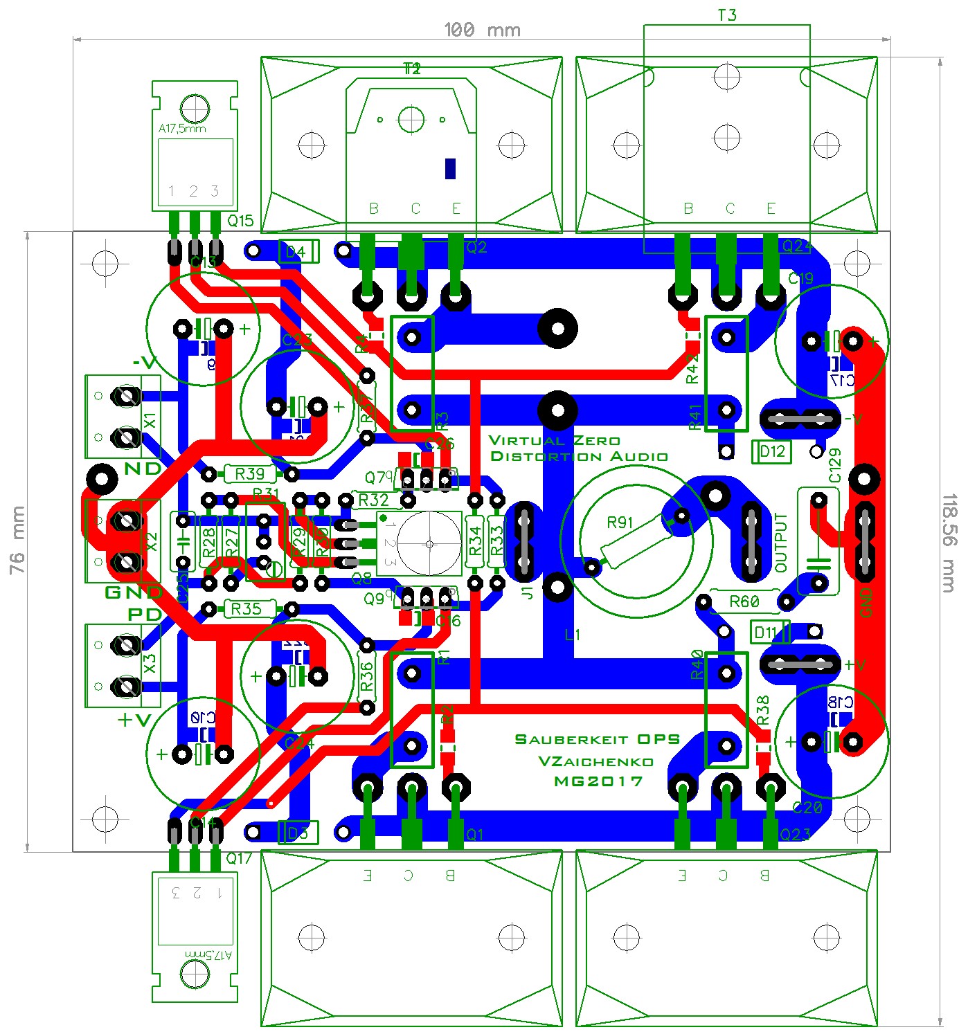

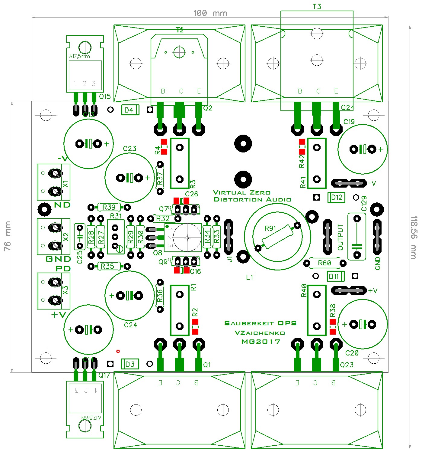

Some revision on Saubertkeit OPS....something more universal as it can use ON semi NJW or MJL and even 2 pairs sanken MT200 in small form factory as 100x76mm....
Great layout job, Marc! 😎

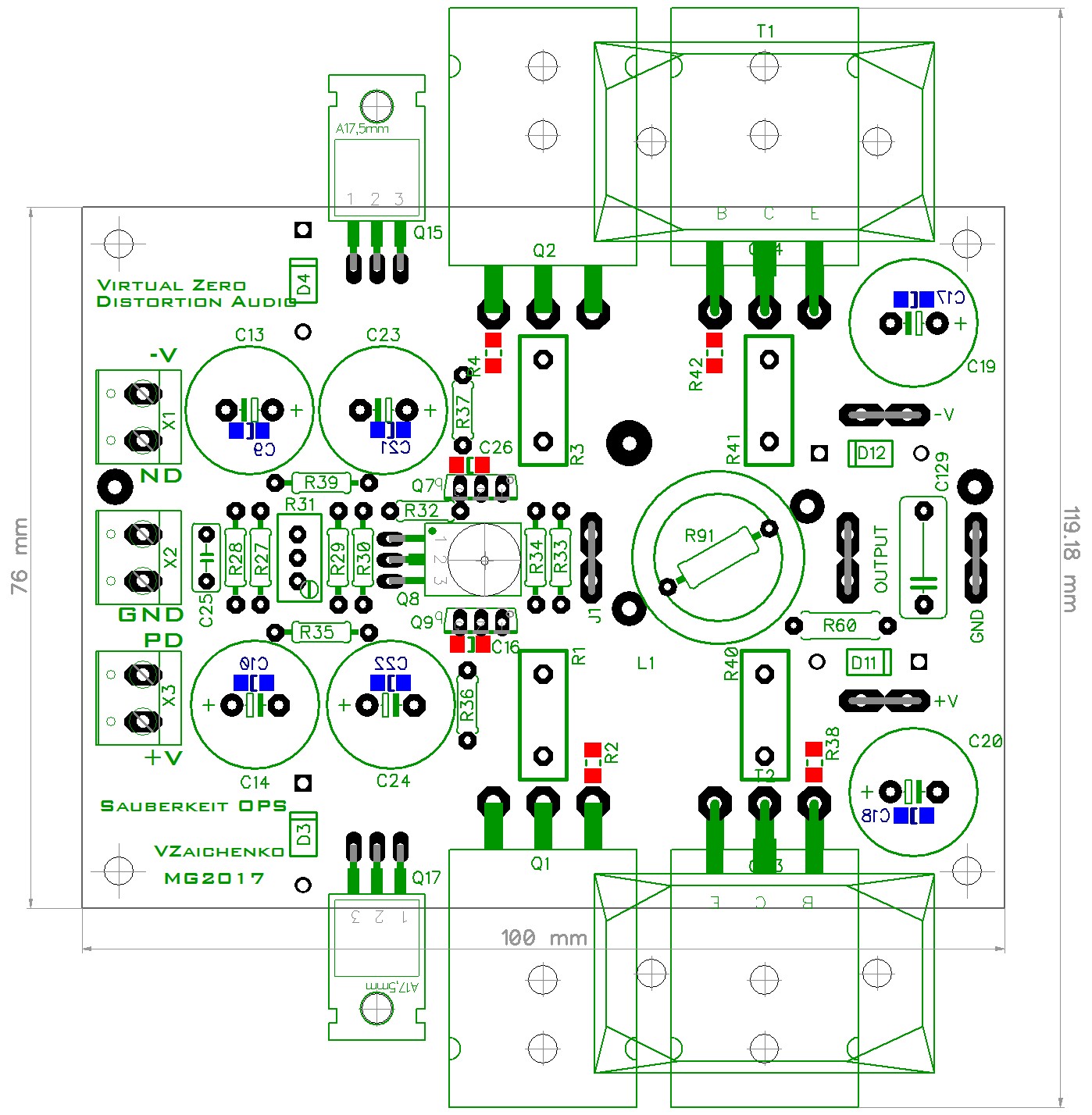

Something like a Swiss knife.Some revision on Saubertkeit OPS....something more universal as it can use ON semi NJW or MJL and even 2 pairs sanken MT200 in small form factory as 100x76mm....
Good Marc!😉
