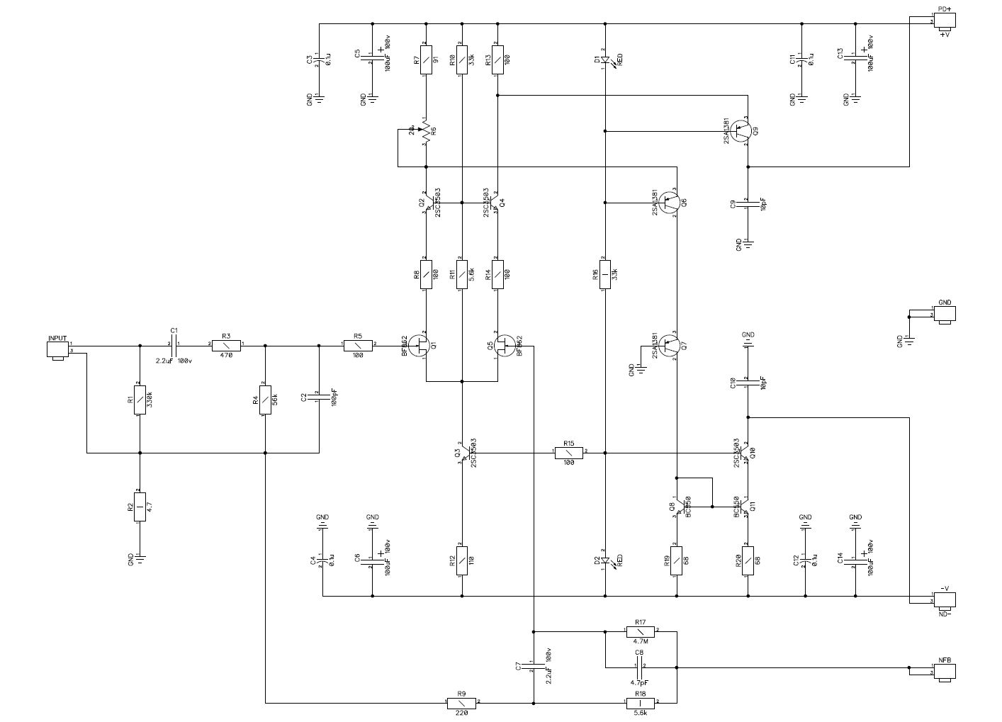

Sorry - one more pretty cool IPS module 😛

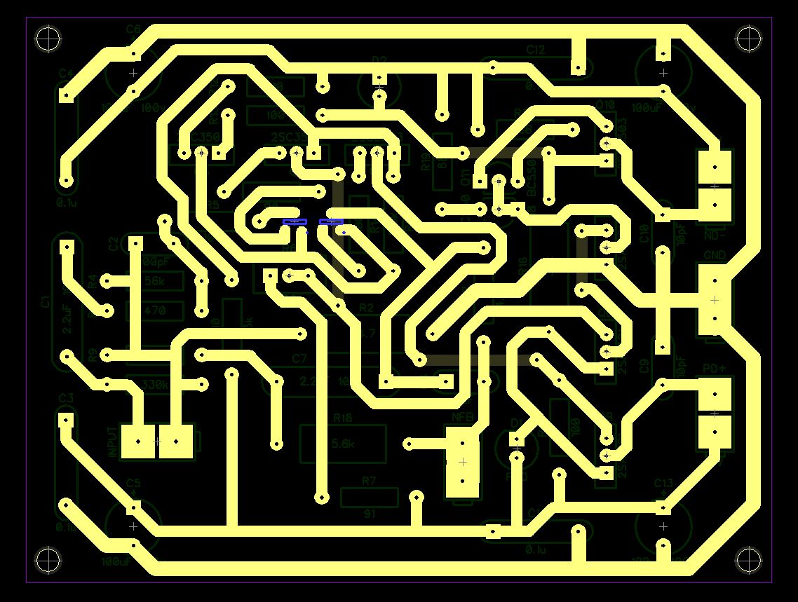

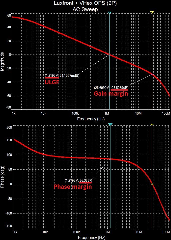

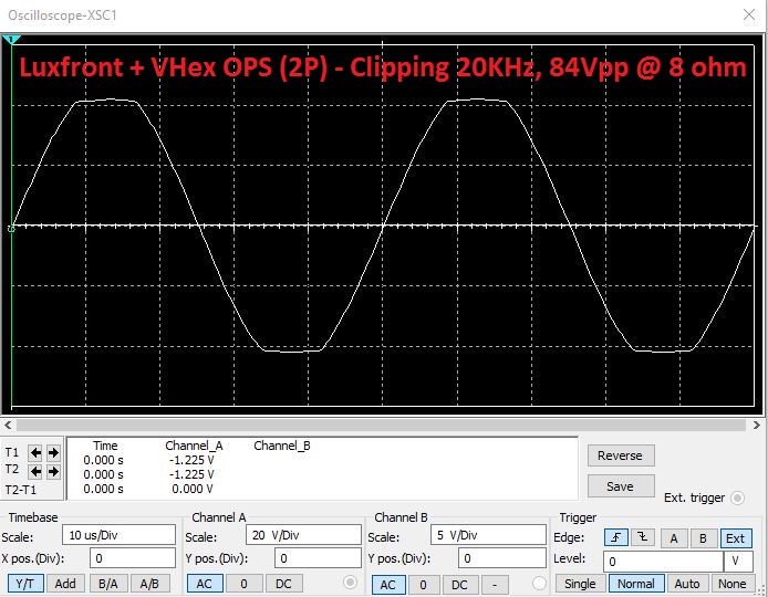

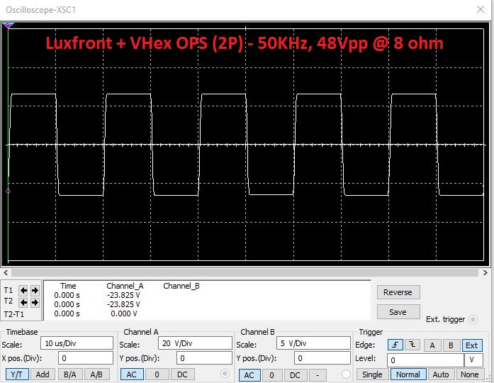

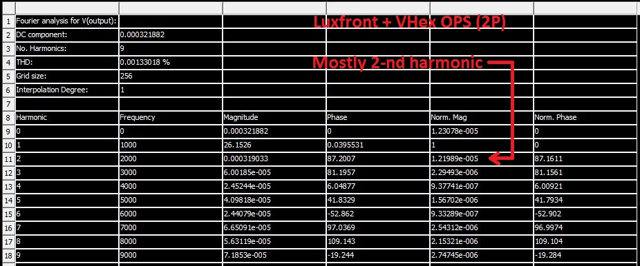

I just came across M-02 / MX-100 front-end and realized it's designed based on the same principles I like to use these days ("Bravo Luxman engineers!"). Besides the jFET input pair (transconductance stage), all the rest of the circuit is controlled purely by current, resulting in rather high slew rate (around 100V/uS with OPS in place), low distortion with excellent profile, low phase shift at 20KHz and excellent stability margins with very light compensation. As a cool bonus - perfect clipping.
My version of the topology uses mostly TO-126 devices - most of them dissipate 150...170mW, except LTP's tail (Q3) - it runs at 450mW.
Besides BF862, 2SK170 jFETs can be used in the input pair (layout needs to be updated in this case).
Luxfront can be used with any OPS, published in this thread.
It's also compatible with Slewmaster OPS boards.
Diy-friendly layout for etching is attached (PDF).
Valery

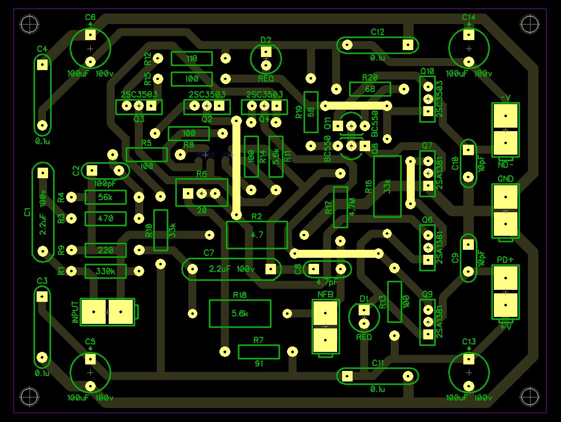

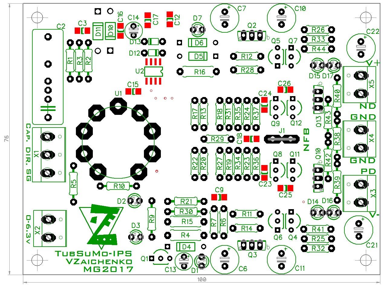

I can see any jfet on your board.....
Marc
Two small blue boxes on picture 3 (bottom traces).
As the board is single-sided and BF862 are SMD, I had to place them on the bottom side 🙂

Hi Mile - good one, I like it a lot - based on the right principles. You're using additional mirrors-with-gain stage.
Elegance of a-la Luxman topology - VAS output (transimpedance stage) is driven directly from the folded cascode, assuming both LTP and VAS stage work at the same idle currents (in my case - around 5.3mA). Just a variant - but isn't it cool in its simplicity 😎

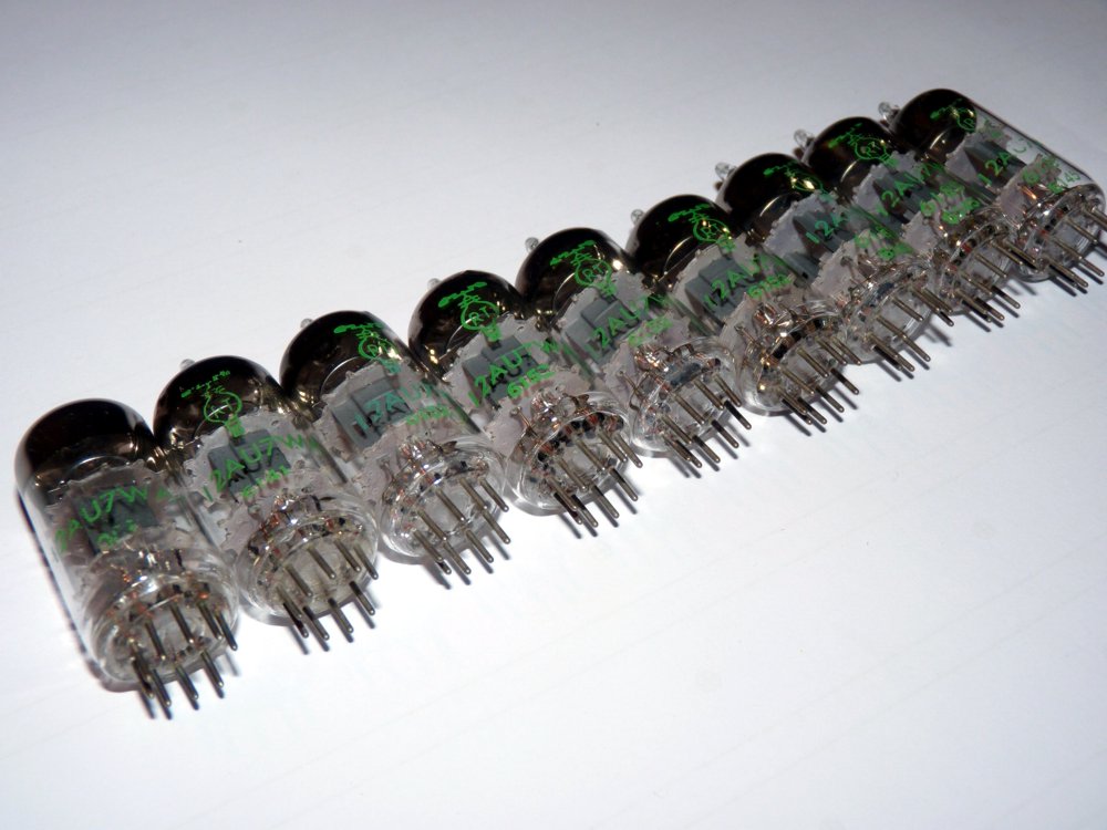

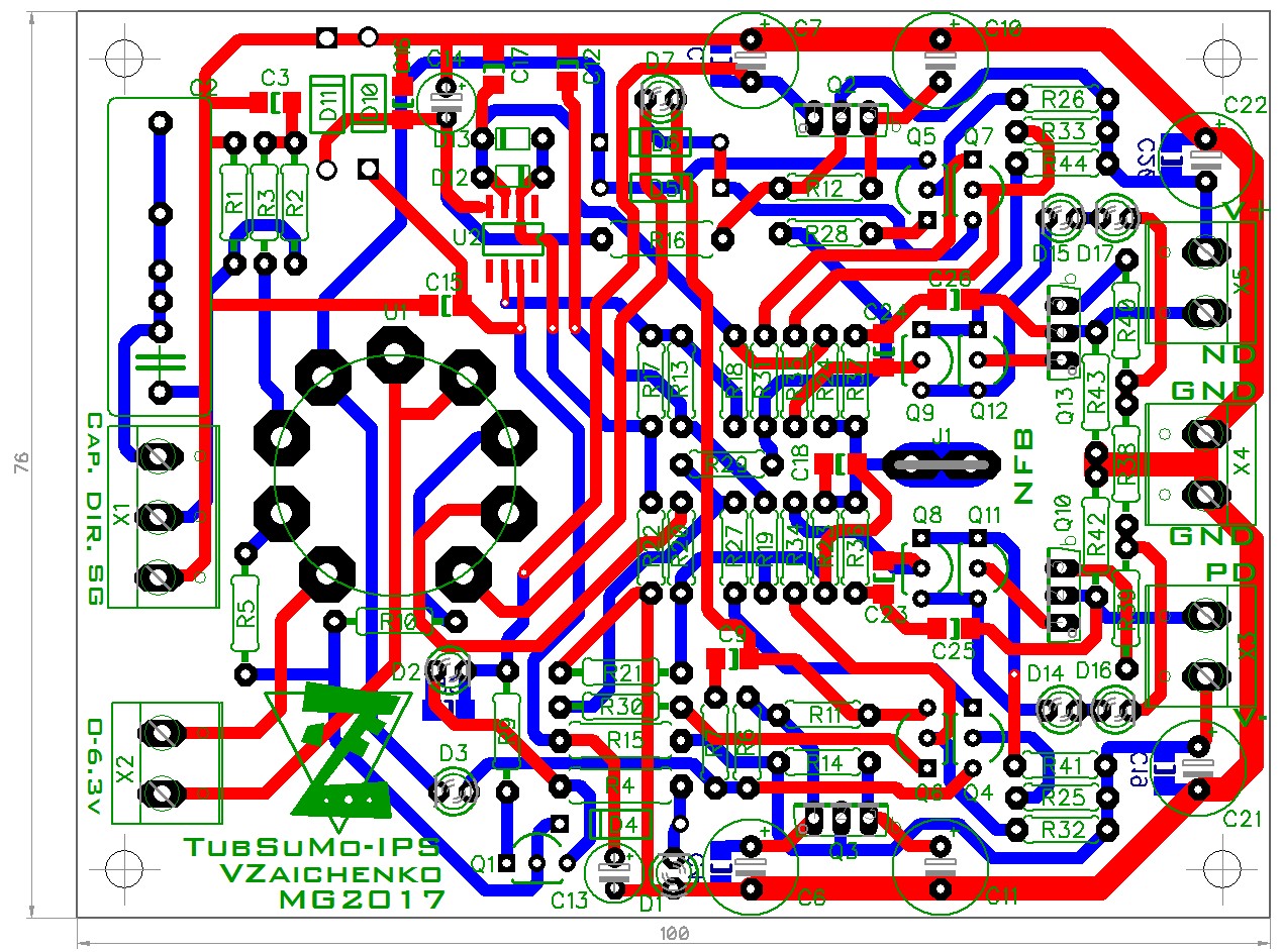

After discussing with gentleman Valery, i decided to give a try to TubSuMo-IPS but actual size is not compatible with other IPS to direct swap.... So i decided to give a try to a new layout. It was not easy to "compress" all in 76x100mm so some smd parts and 2 layer couldn't be take to side....Here is my try to join TubSuMo-IPS to 76x100mm family...

In order to save some space, you could use subminiature double triodes, such as 6111, 6112 or something like that.

In order to save some space, you could use subminiature double triodes, such as 6201, 6211 or something like that.
Best regards!
Yes could but i have this stock......
