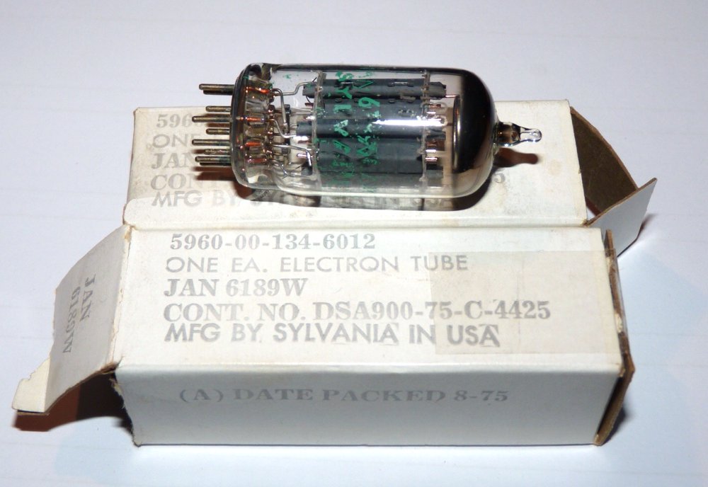

Oh and forgot this pair (JAN 6189 W) i have too....

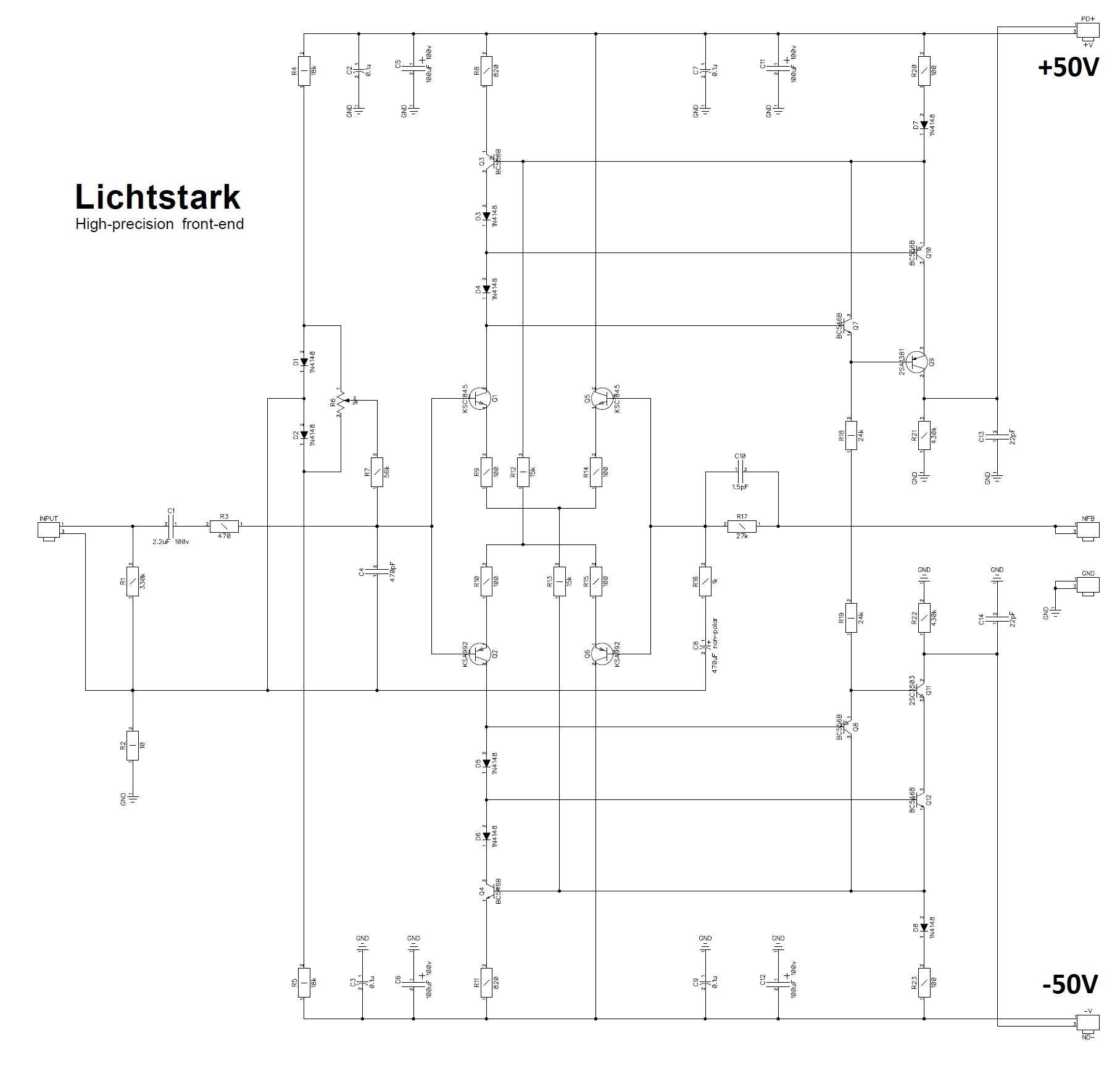

I would like to know that is there anything in the Lichtstark to set the VAS to OPS stage current of 5.5ma? or is it fixed automatically? as I dont see any pot or variable value to set it.
Hi rhythmsandy,
Attached is the "as built" version of Lichtstark front-end.
VAS idle current is set by R12, R13. The values shown are valid for +/-50V rails, resulting in 5.5-5.7mA at VAS output.
It's never required to set the VAS idle current precisely, so most front-end designs don't have any trimmers for adjusting it. You set it during initial testing - that's it, then it will be roughly the same in all future builds.
Note - the right values depend on the rails voltage.
Valery

What is the advantage of Lichtstark over Bipsumo or Tubsumo or kypton?
Thank you..
The other ones you've mentioned are very fine ones, however, even though they utilize some cool ideas, they represent a more "traditional" multi-stage voltage-driven amplification topologies.
As Jeff just mentioned, Lichtstark is based on a simple "current drive" principle. Basically, two stages - transconductance stage, converting the input voltage into current, and then immediately transimpedance stage (high-precision current mirror with gain), converting that current back to voltage with higher swing.
Key advantages of "current drive" based front-ends family (and Lichtstark in particular):
- High immunity to external noises, especially EMF-induced ones;
- Low distortion open-loop - i-to-v (transimpedance) stage is highly linear;
- Low phase shifts throughout the whole audio bandwidth, requiring very low compensation for demonstrating high stability margins and resulting in very good - accurate, natural - sound reproduction;
- High enough slew rate by design - "current drive" front-ends easily achieve 150-400V/uS, providing high dynamic characteristics;
- In overall, very short "signal path", low parasitic phase shifts and combination of high "speed" and high linearity nature of the circuit, provide high-precision operation, resulting in excellent sound, very low noise, and ease of use with virtually any OPS, maintaining high overall stability of the amplifier.

How do you take care of taming DC offset? DC Servo?
I do not mean zeroing DC offset, which is easy to do, but keeping it within a few millivolts.
If you say otherwise you would be misguiding many people here in the forum who have little or no experience with amplifiers.
Keeping an amp close to zero DC is very difficult, and thermal runaway is very difficult to control.
Either you need a NFB capacitor or DC servo. Or you will need a protection circuit to watch for DC and control the output with a relay.
On my prototype board I did an initial burn in heat cycle of a couple hours, then readjusted DC offset. I let it cool overnight and powered it up again. On power up offset was -3mV. After a couple minutes to warm up it settled to ~300uV and stayed there all day. It's steadier than most servoed amplifiers I've played with so far. Valery's current drive designs are different that the million Blameless designs out there. They are very stable.

I'm sort of confused now - are we discussing particular circuit or possible approaches in general?
There is a number of ways to keep the offset within a few millivolts - depends on overall topology, input stage devices, feedback network arrangement, layout features (like input pair and possibly other pairs thermal coupling).
For some topologies servo is a must, some others are thermally stable by design (so, manual trimmer, or even no trimmer is enough).
Zero DC and thermal runaway are different things, so different control loops are used for dealing with them.
Soft-start / protection board is a must for any DC-coupled amplifier - we use comprehensive MCU-based control boards, providing all required functionality.
See the link in my signature for more details (21-st century control boards).
Valery

What schematic are you talking about? I'm lost completely.
All my amplifiers keep the offset within +/-2-3mV, some of them keep it within +/-1mV. Built and tested.
Yes, sometimes it's servo, sometimes it's capacitor.
Where do you see the problem?
Protection is a separate story. It's involved only if something goes wrong. In normal operation - offset is within a few mV - it's not involved, although it's always there.
To start with, there is no problem that I am pointing at. Let's be clear of that.
I asked how the speakers were being protected from DC with the Lichtstark, that did not show any DC servo or cap.
The answer I got seemed to imply that none of them were being used, because the amp was stable. So I said you could that if you had a reliable DC protection at the output.
If the amp is really stable you won't have any interruptions, and time would say if the amp is DC stable in the long run.

If you refer to schematic from the post #2124 - I have attached it here again - isn't C8 a cap you're looking for? 😉
