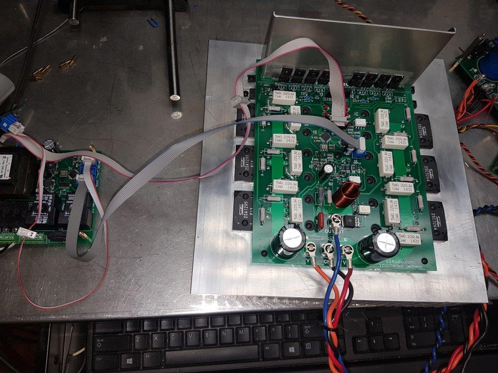

I've added an on board processor to this one and designed a softstart board with it's own processor. There's a rear panel connector with a USB port and processor selector. Just a couple ribbon cable making everything talk now.
This is designed to be a plate amp for an active speaker but I have a neat vertical chassis monoblock in mind for this one. Lots of mill work ahead.😀

Great job! This is a solid module for driving some monster woofer section with top quality - 500W @ 4 ohm - no problem 😉
