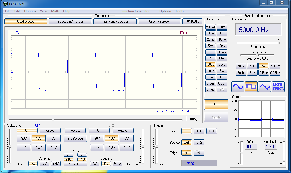

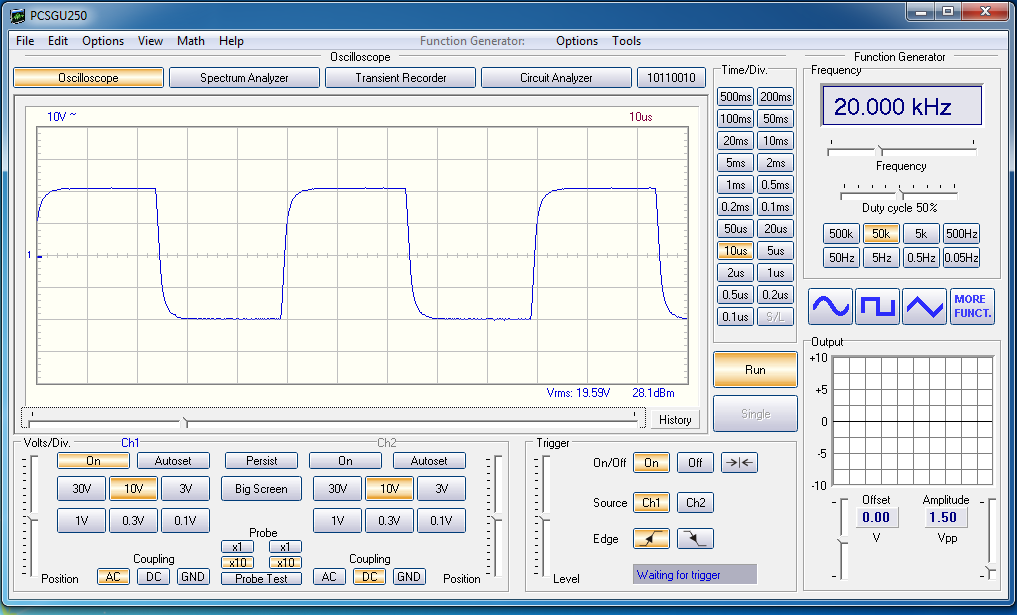

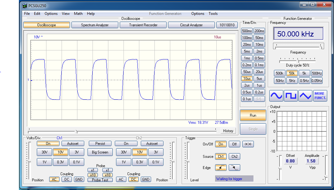

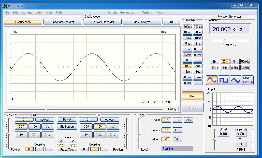

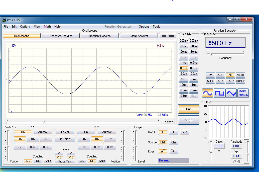

This amp is pretty impressive so far! I'm testing it with a Vertical VFA input. Sine and square waves are nice. The protection system is working flawlessly. It sounds great on my crappy little test speaker. I need to build a twin and get them in boxes with some proper supplies. My test supply is +/-63V but is sagging down to 55V at clipping. These screenshots were with a 4 ohm dummy load.

Getting 378W from your target of 350W amplifier is an achievement.
Your target of 350W from a 220W into 8 is set a bit low. That would be -1dBV into the halved resistance load.
Your 378W from 220W is improved to -0.65dBv
And if you get even better with the improved PSU then you are doing well.
I have this idea that current delivery into halved impedance is a good clue to the apparent bass from the amplifier.
-0.6dBv is very good.
-0.5dBv or better is excellent.
I think there are many here who criticise the bass performance of their amplifier and don't realise that it is probably lack of current capability that is the cause of what they hear. If they tested into lower resistance loads we would have some data to compare the audible effects that are reported.
350W is my goal for the intended application. I think this will exceed that by a bit. Valery's design target for the amp module itself is 500W + at 4R. I have some higher voltage transformers I plan to test the module with to make sure it's able to produce that reliably.
I agree current available determines bass qualities. In a subwoofer application it is what determines weather you will have a box making booming noises or a subwoofer you feel.

Looking good :up:
Clean, symmetric, fast enough step response, even with VFA front-end.
Seems to be a good solution for the cases where you need some extra power and/or you drive rather low, "difficult" impedance.
Great output current capability makes it possible to drive 2 ohm with no problem (some "difficult" speakers) - just take care of the swing in this case, driving 2 ohm all the way to the rails will be too much even for those 12 x MT-200 outputs 😱
