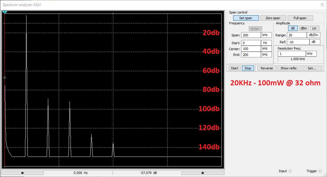

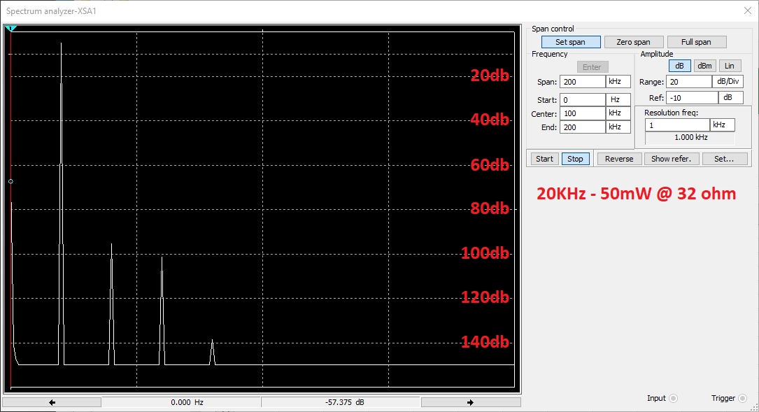

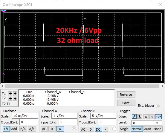

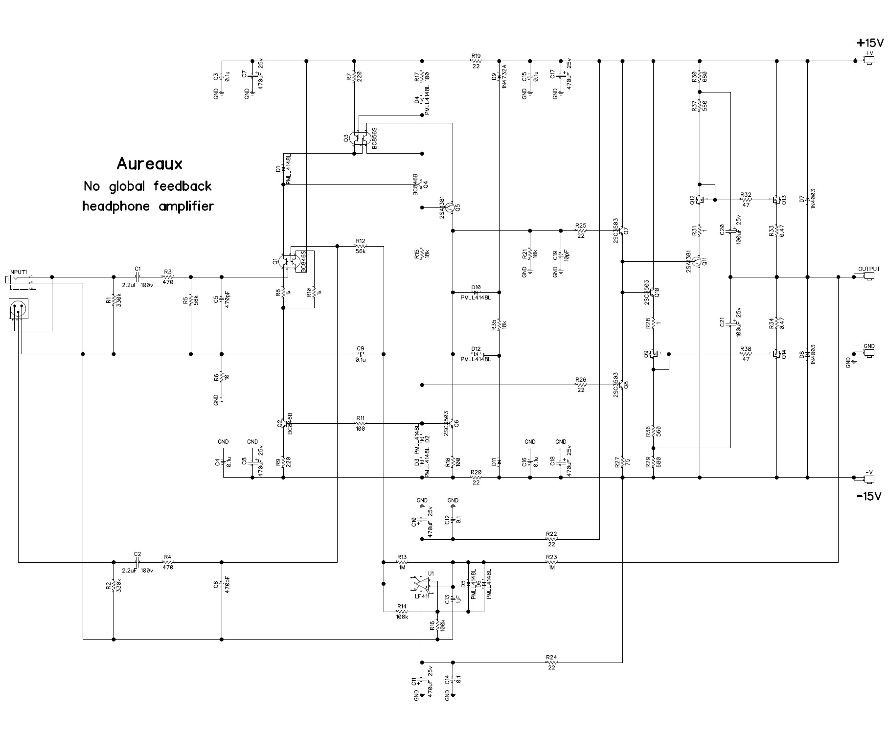

Aureaux high-quality no-global-loop headphone amp design

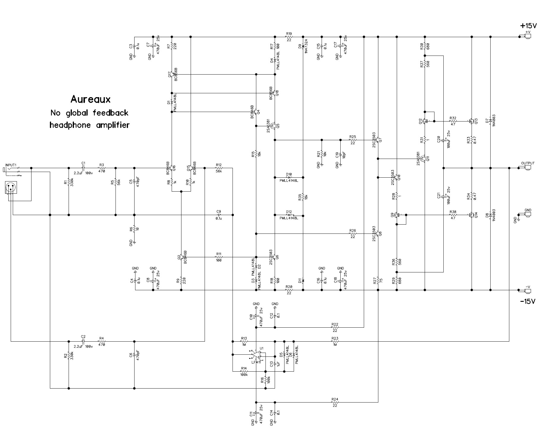

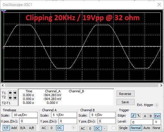

Hi All,
Being focused on low-loop-gain / no global loop power amps this year, I have designed a few circuits, utilizing only local feedback loops, maintaining high linearity and wide bandwidth, providing excellent “short” harmonic profiles (only 2-nd and 3-rd harmonics are noticeable) for top quality sound reproduction.
Here is the “younger brother” of those amps – headphone amplifier with current-driven VAS (partially re-using some ideas from Lichtstark front-end), class A output stage and no global feedback loop. Interesting specialty of no-global-loop designs – there must be a sufficient buffer between the VAS and OPS for impedance matching and preventing the OPS’s input impedance modulation from influencing the open-loop front-end’s performance. It's a pity mid-power lateral MOSFETs are not really available these days - perfect devices for the purpose.
Key observations:
THD20 < 0.003% @ 50mW / < 0.005% @ 100mW (32 ohm load – simulated spectrums).
Fast enough step response with no overshoot, clean clipping.
Output HexFETs’ quiescent current is 180…200mA.
Both RCA (unbalanced) and XLR (Balanced) inputs are supported.
I recommend to use some simple soft-start / protection board for keeping the precious headphones safe.
It’s not tested live as yes, I have also got no layout for it right now, although schematic is available in Diptrace. Thoughts, ideas, possible help with layout design and testing – welcome 😉
Valery
P.S. Left schematic shows the IPS/VAS with separate transistors for better view on topology, the right one - same thing, but using the dual pairs.

Forgot to mention - voltage gain is set to 10db.
It can be adjusted by changing the value of R21 (i-to-V conversion, lower value -> lower gain and vice versa).

Nice circuit, is the circuit unity gain stable? (since so many headphones will blow you out of the room on 100 mV signal)
Hi Daniel,
The whole idea of the circuit is to utilize only the local feedbacks, refusing from global or multi-stage loops. It is unity gain stable by design - no multi-stage loops ensure there are no stability issues. However, for unity gain the circuit can be significantly simplified - you can replace the front-end with a diamond buffer, for example.
However some commercial headphone amplifiers are produced with 2 gain settings (low/high switch), providing the gain of 2.5 (8db) for "low" and 6.5 (16db) for "high". In this circuit, those gain values can be set by the trans-impedance conversion resistor (R21) value:
8db -> R21 = 2.7K
16db -> R21 = 6.8K
I'm showing distortion figures and profiles at 100mW of output power just for showing some "extreme" values - at the normal listening levels, distortion is just negligible - it's comparable to noise level, which is also very low here 😉

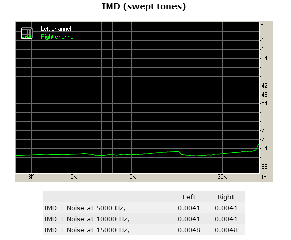

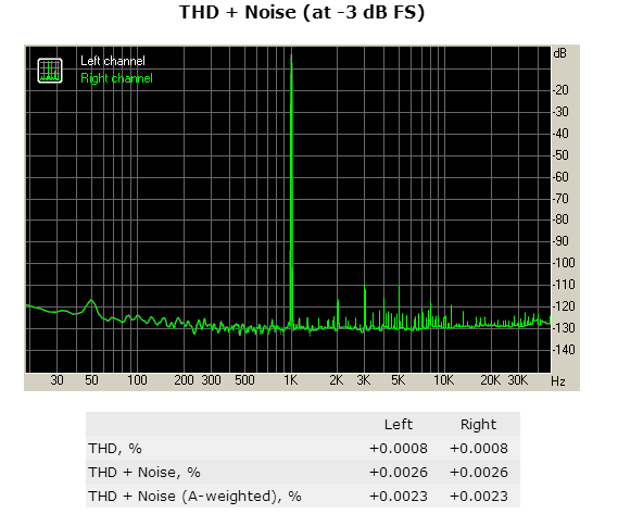

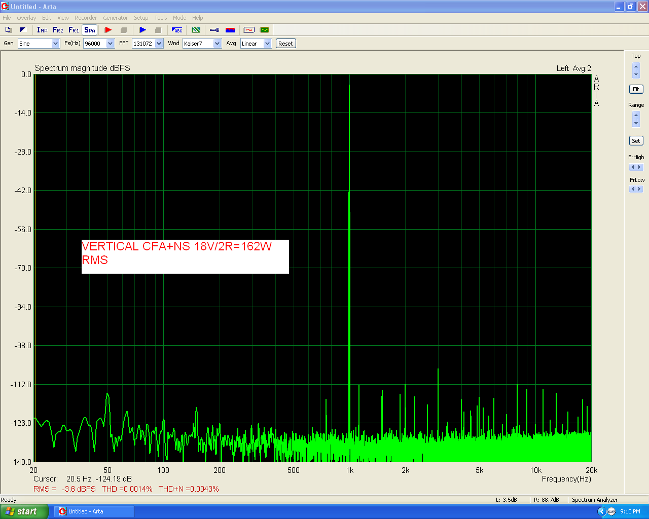

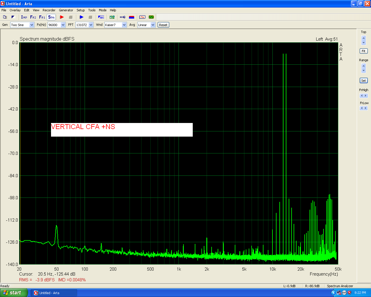

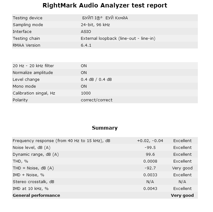

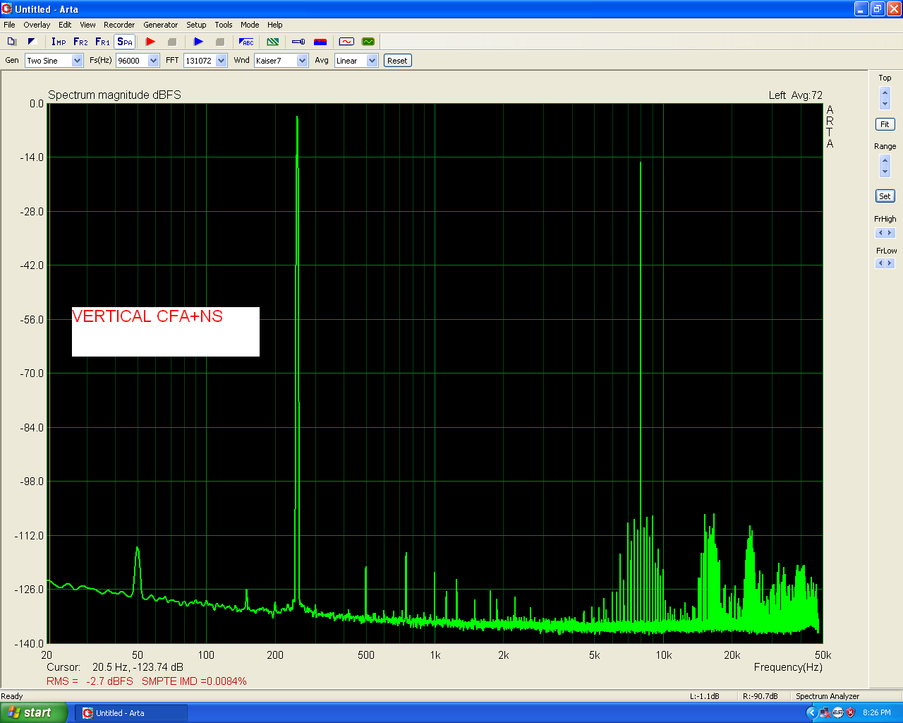

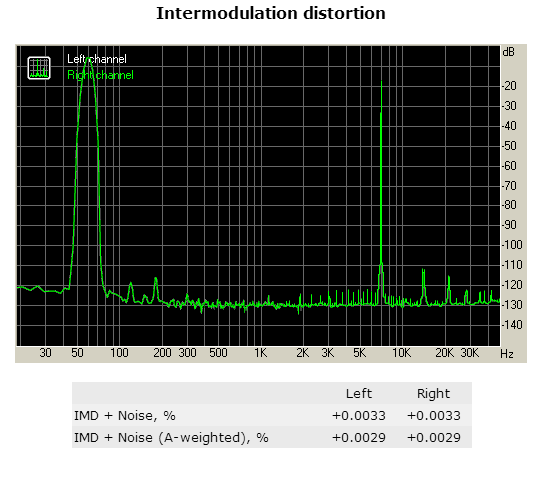

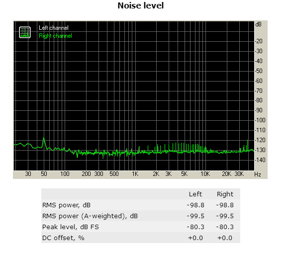

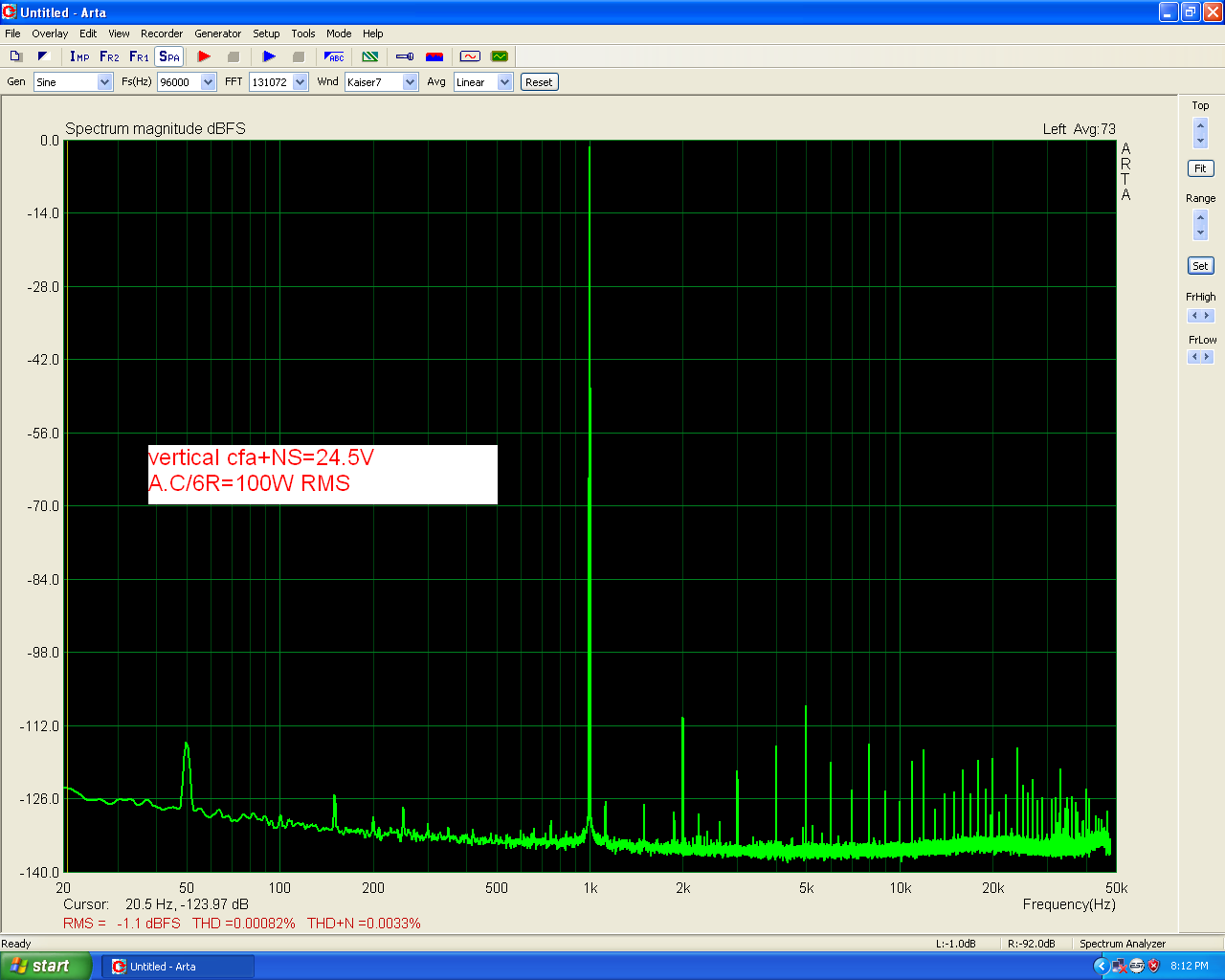

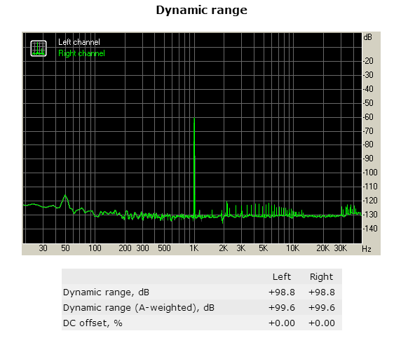

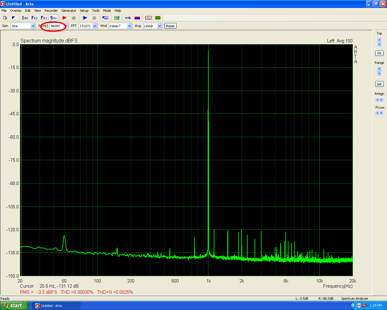

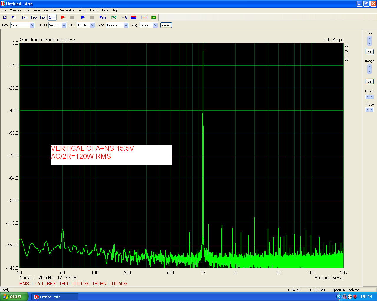

Hi guys ,i want to share a new test for this Vertical CFA as input board and Non Switching as output.
Please have a look.
In the first photo is the sound card loop test as reference.
Power supply +/-50v
74000uf/rail
Idle=40mA/Pair
Please have a look.
Power supply +/-50v
74000uf/rail
Idle=40mA/Pair
Using RightMark Audio Analyzer, RMAA
