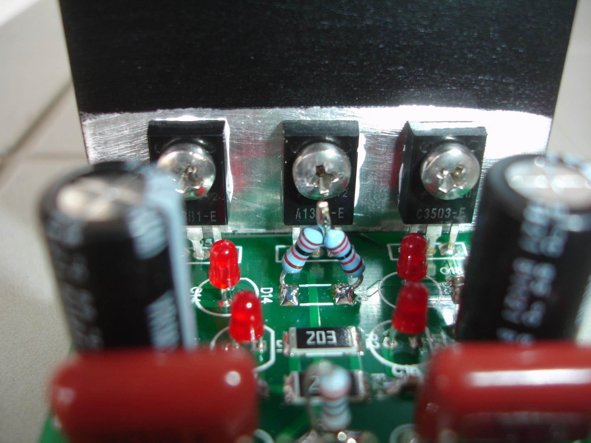

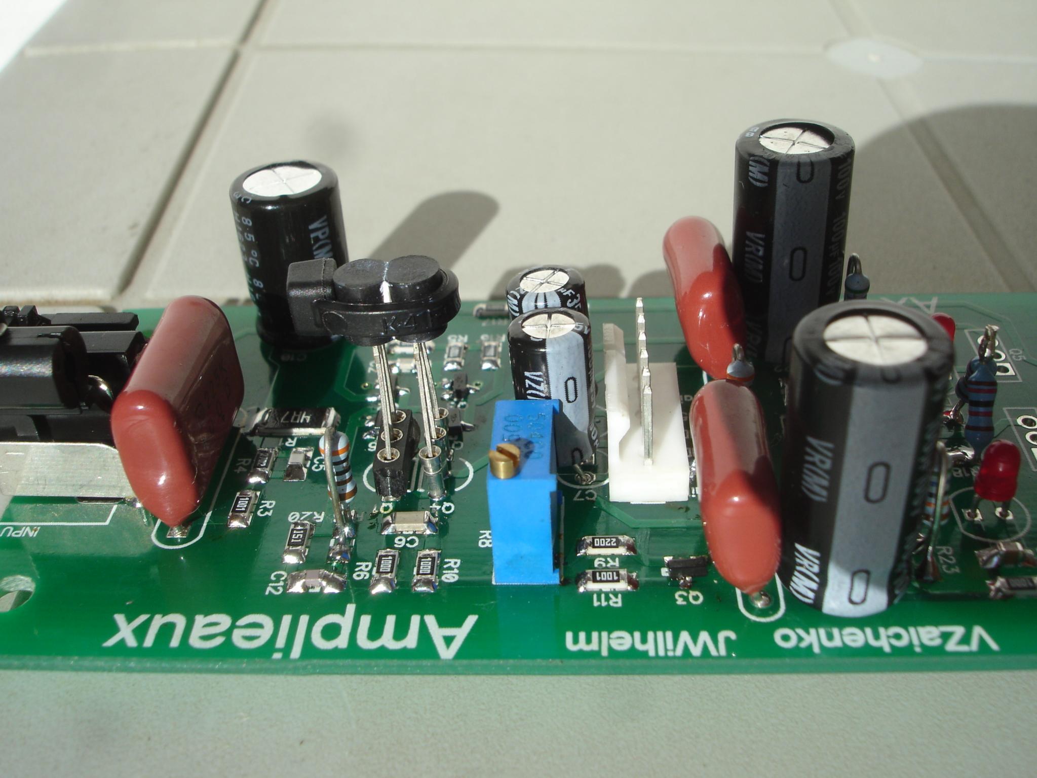

Thank you very much, jwilhelm and vzaichenko. I read through that whole thread again. Such an inspiring read.
I want to use the Shuntie to power a front end which draws 32mA with rails of +-32 to 35 volts DC. I will try without changing any values. Thanks again.
No problem - with 32mA draw it's going to run just fine.
You have to reserve some voltage to drop at the series resistors.
In my case, I had 70V DC in -> 50V DC out.
Valery
You need to have the current through the MOSFET to be at least the same, as the one, drawn by your circuit, loading it.
In this case:
Iinput = Imosfet + Iload -> 64mA = 32mA + 32mA;
Series resistor value:
R = Vdrop / Iinput;
Series resistor power rating:
P = Vdrop * Iinput;
