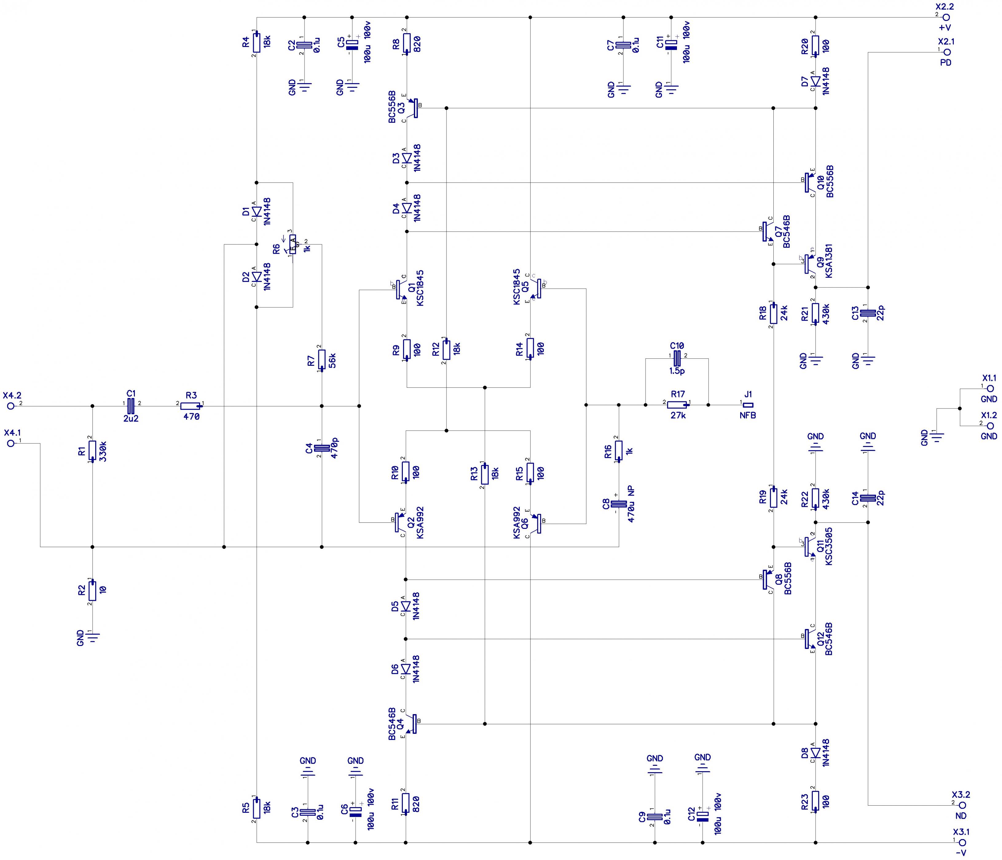

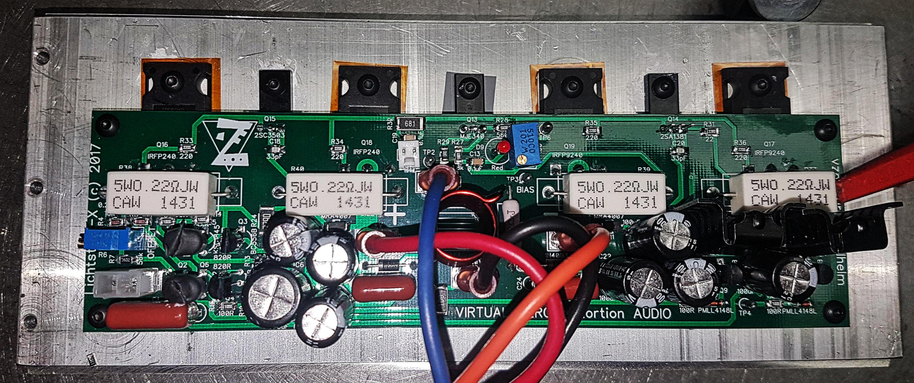

Lichtstark-X is up and running nicely. I posted some initial testing results in the Sons of VHex thread. http://www.diyaudio.com/forums/solid-state/294632-sons-vhex-45.html#post5089933 I settled on 15k values for R12 & R13 and replaced the bias pot with 200R. Bias was still flowing slightly with the pot maxed out. It's a very well behaved stable amp so far. It clips nicely too. I've attached the "As Built" schematic.
A nice-looking VHex+ format board - just copying Jeff's picture from the other thread :up:

Val, can you please help with resistor values when running the ip stage on 65Vdc. I suppose the the OP vertical mosfet stage is OK with 65Vdc ?🙂

For +/-65V DC rails the optimal values are:
R4, R5 = 24K
R12, R13 = 20K
R18, R19 = 30K
Schematic is attached to make sure we use the same reference numbers.
Valery
