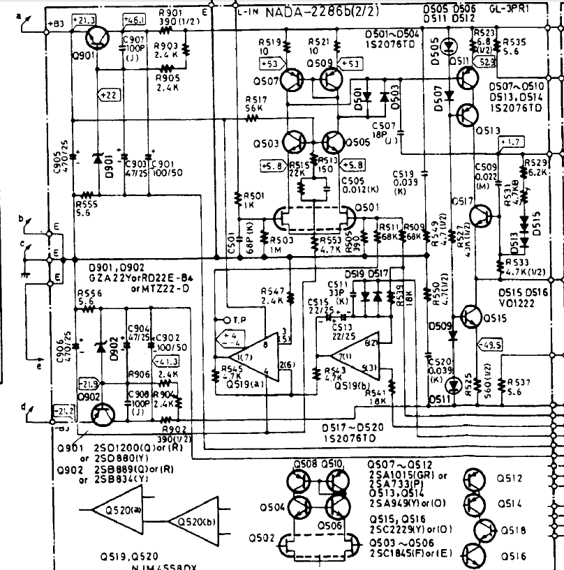

Here is a commercial solution.
That's what I'm talking about here: http://www.diyaudio.com/forums/solid-state/290970-several-schemes-9.html#post4868898.
As we can see, the output 5(3) of opamp Q519(b) goes outside the scheme, while the need to connect to ground and this connection would be a draw much easier and closer. We need to see the whole scheme, but I think this wire is or goes to another amplifier, measuring a voltage drop on the cable between the blocks of the amplifiers to reduce interference, or the Mecca of ground, or "cool" terminal on the speakers.
Engineers from the firm Onkyo were able to come up with such things.
Upd.
Here are the manual amplifier M-504. The wire you were asking about, connected to "cold" (-) terminal of speaker systems (wire SV from R231 22k, square A3). If you choose the wire resistance between the connection =point SV and Mecca ground= 2 times more resistance than cable acoustic systems, the resistance of the speaker cable will be compensated by the unit of opamp Q203.

I thought you'd posted an updated schematic somewhere showing this, but I wasn't able to find it.
Upd.
Actually, this M-504 is a good example of using the right ground references.
DC servo's ground reference is taken right from the "-" terminal (that's where we need DC to be "zero") - SV. Zobel is also connected in a clever way - separate wire goes to the power amp section ground - EP and E are different connections. Nice.

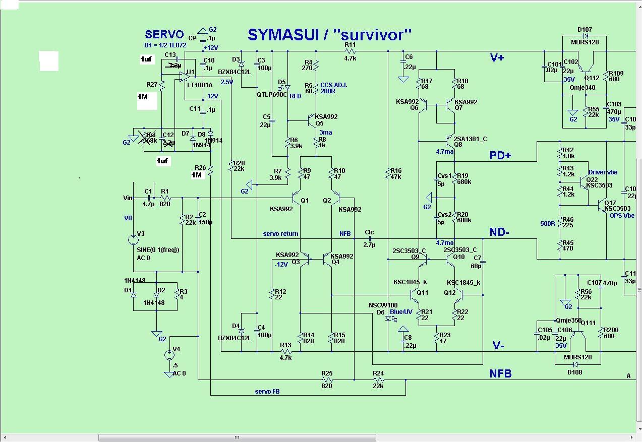

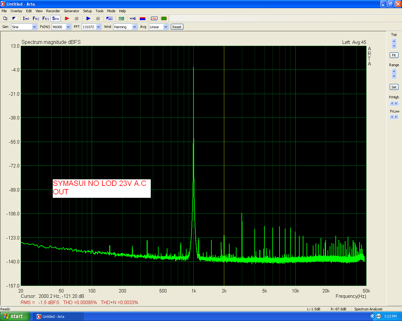

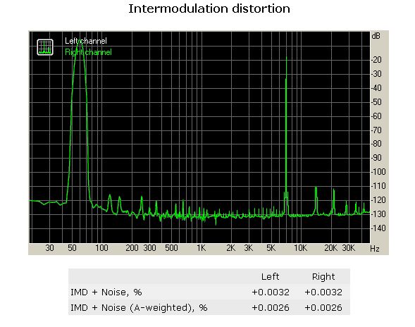

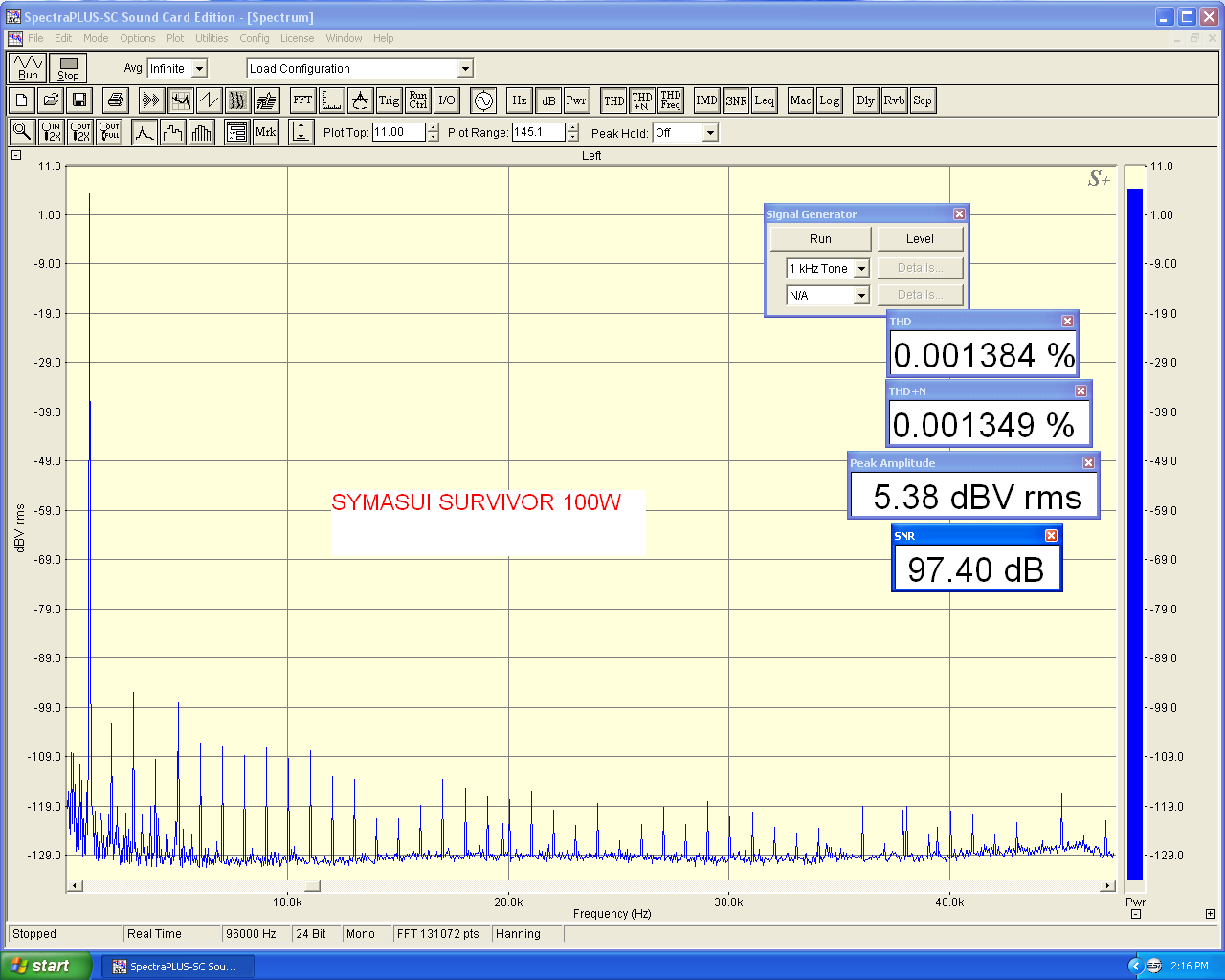

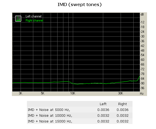

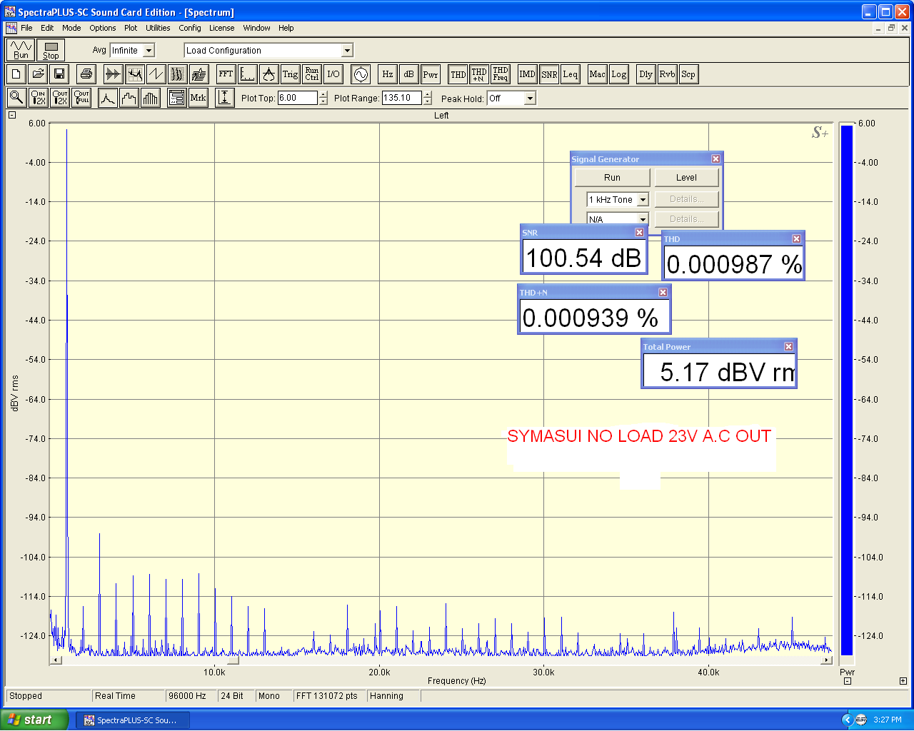

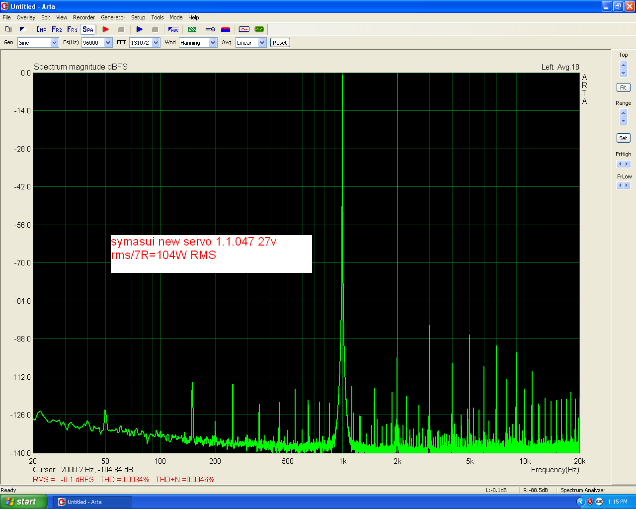

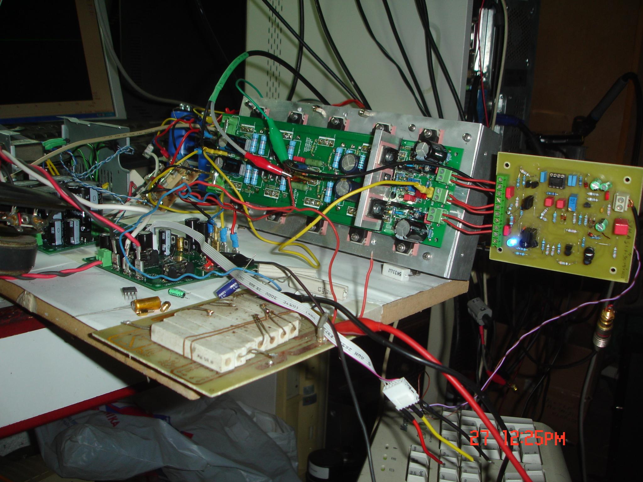

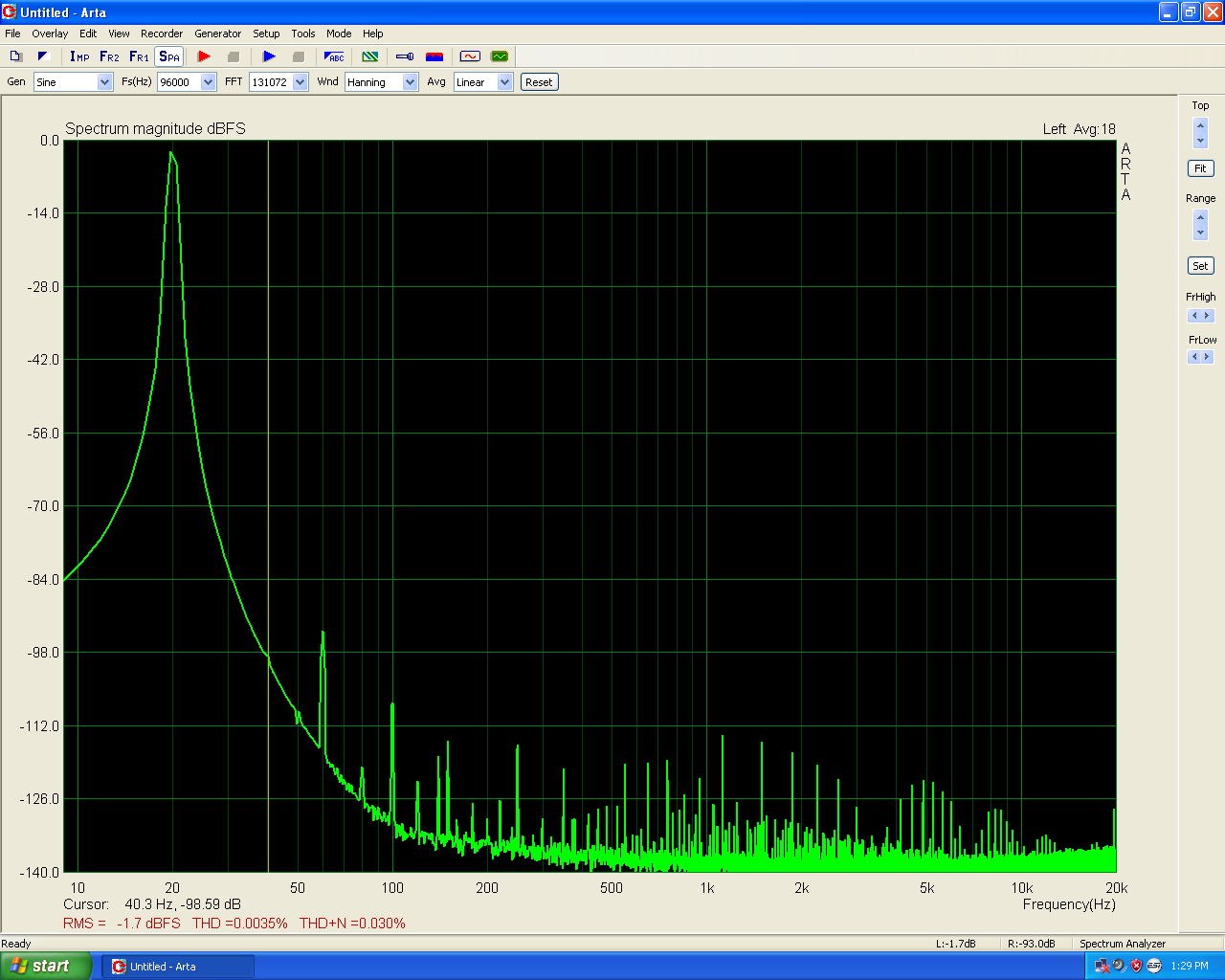

Hi boss!
My experience to Valery N.S gives me the opportunity for the two giants mixing!
Testing the Symasui Survivor i see that is some abnormal function on offset controller.
Then i hooked up the Symasui on the Slewmaster and i see the same.
What is the strange?
1)The long settle time (about of 20'').
2)Offset controller can't ended up Below 2.9mV.
To see what happen,the IPS modified as non servo.
This non servo version(tested here.http://www.diyaudio.com/forums/solid-state/248105-slewmaster-cfa-vs-vfa-rumble-957.html) starts immedietly from about 100mV & ENDED UP VERY SOON about 5'' latter at 2,9mV
Then could not resist the challenge for a separate +/-15v power supply for servo and input,this challenge gives 0 v offset!(non servo) that is because of a small difference in + & - voltages.

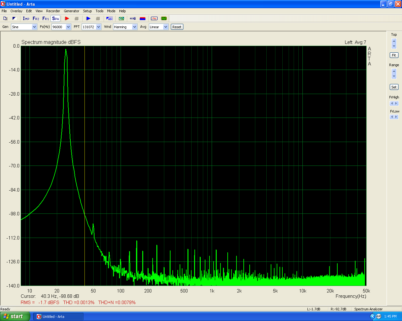

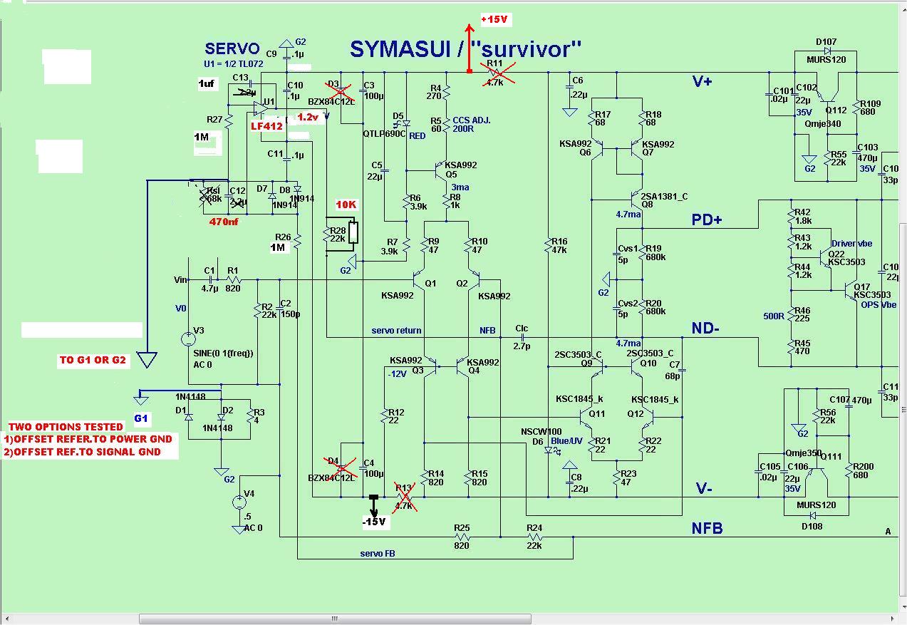

picture 1 is my version as built when the problem existing
picture 2 is what Jeff post as an apdate version.
picture 3 is what i have modify now.

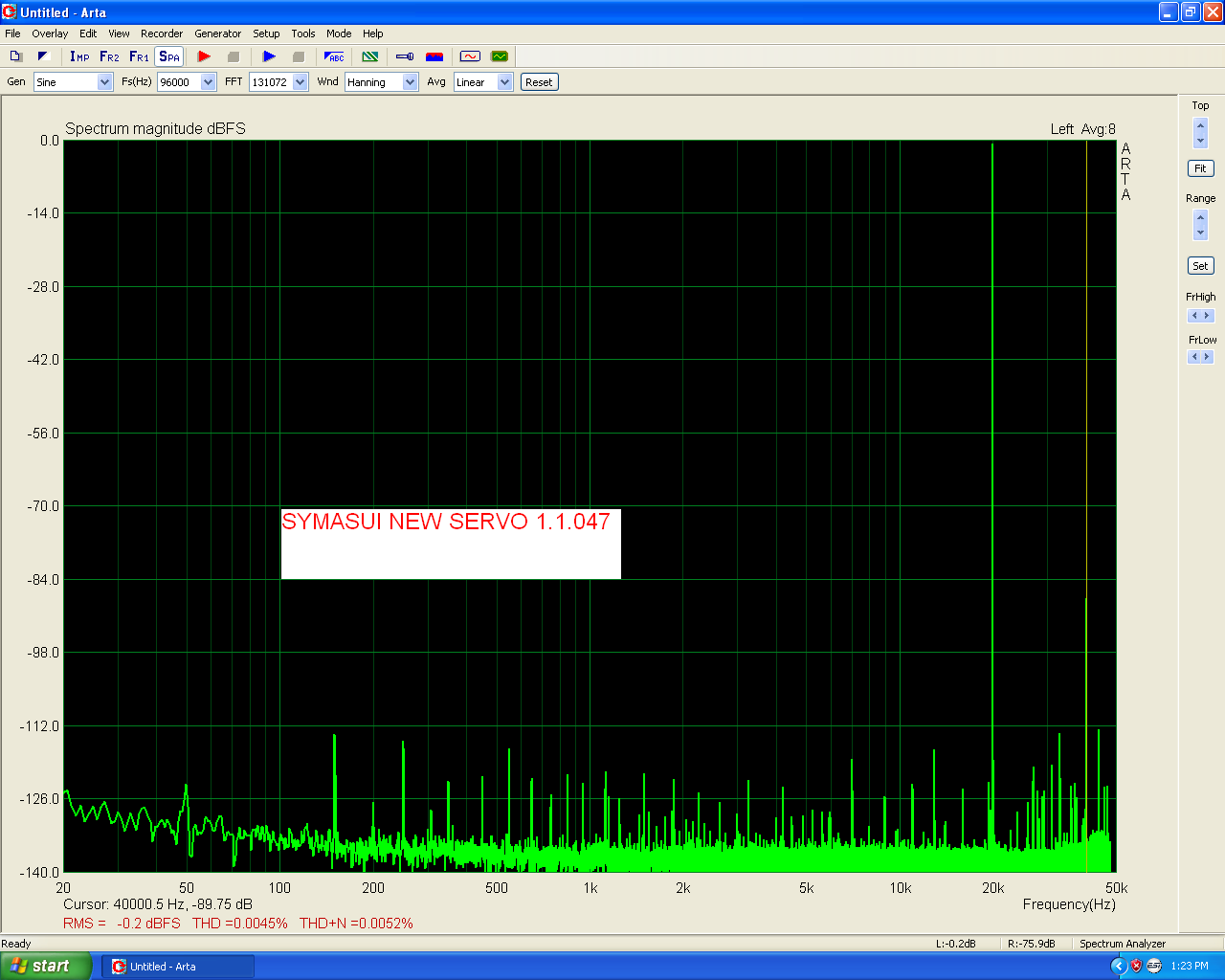

Two days now i have test step by step using ARTA,RMAA and STEPS.
What i see?
1)TL072 don't act well in this IPS as this although the modifications can't go below 2.9mV.
2)LF412 can go to zero ONLY WHEN C12 decreases to 470nf or below.
3)The GND reference of the offset controller haven't measurements results.
4)The settling time is reduced when the value of Ρ28 resistance decreases.

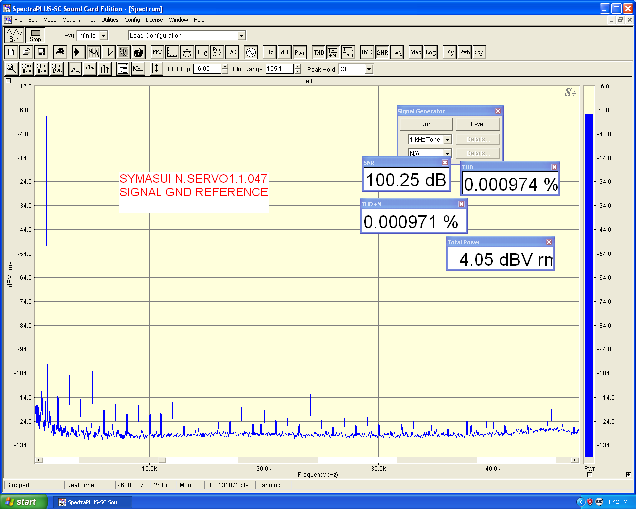

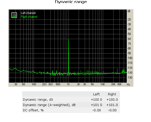

Now about measurements.
I will post 2 different set of measurements.
One using power GND as reference for offset controller and the other using Signal GND as reference.
I believe that the most suitable program for offset testing is the STEPS.
May be someone have a better way to do.

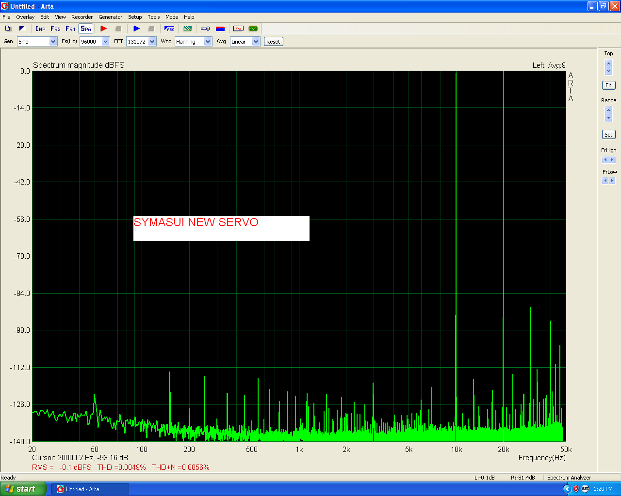

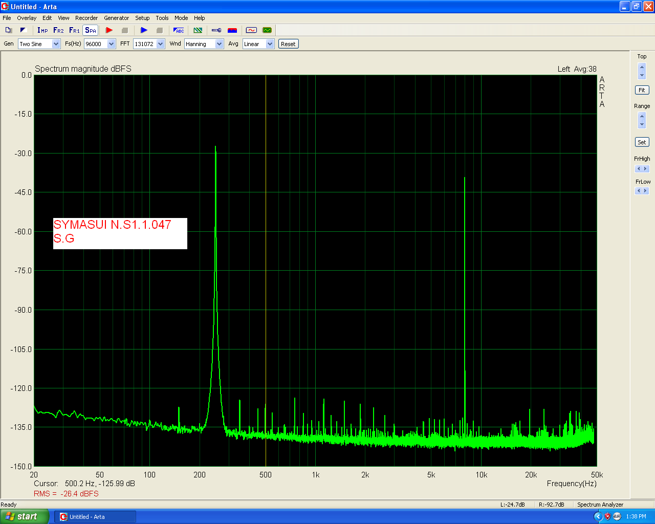

First set using signal gnd as offset reference.
I must say that the output board(power amplifier out)is the Slewmaster.
Reason that i post here is why this adventure has been started here.🙂
I hope that isn't something wrong😕
Sorry i have mixed the STEPS files so i will retest😱

Hi!
1. You don't need to rush with the settling time.
2. You picked the wrong servo circuit, see file. It gives large distortion at frequencies around 20 Hz due to the nonlinear conductance of the diode protection D7D8. I am not mistaken, if I make an assumption: you don't need the distortion.
3. You can get rid of these distortions, if you increase the resistance R26-27 and the capacitance C11-13. This increase to reduce the signal voltage to the diodes 7 and 8.
4. But the settling time will also increase, see first paragraph 1. You must make a simple choice: will you accept this increase. or you come to terms with the distortions.
5. The voltage at the amplifier output 3 - 5mV is acceptable, this voltage is too small to worry about him.
6. You need to choose a GND to connect the integrator closest to the signal ground. The Japanese did a similar connection to the ground of acoustic systems for their own reasons. I explained these reasons. You don't have these reasons, another schematic of the servo, so you don't need to do that.

Hi and thanks for reply.
Sorry i can't see this file.I know nothing about simulation programs.🙁
You mean the capacitors C12,C13?
I know that 2 or 3mV or higher up to about 80 mV is something acceptable but this amplifier can go to zero without servo(tested).
In any case i will prefer the long settling time and a little d.c offset but not the distortion🙂

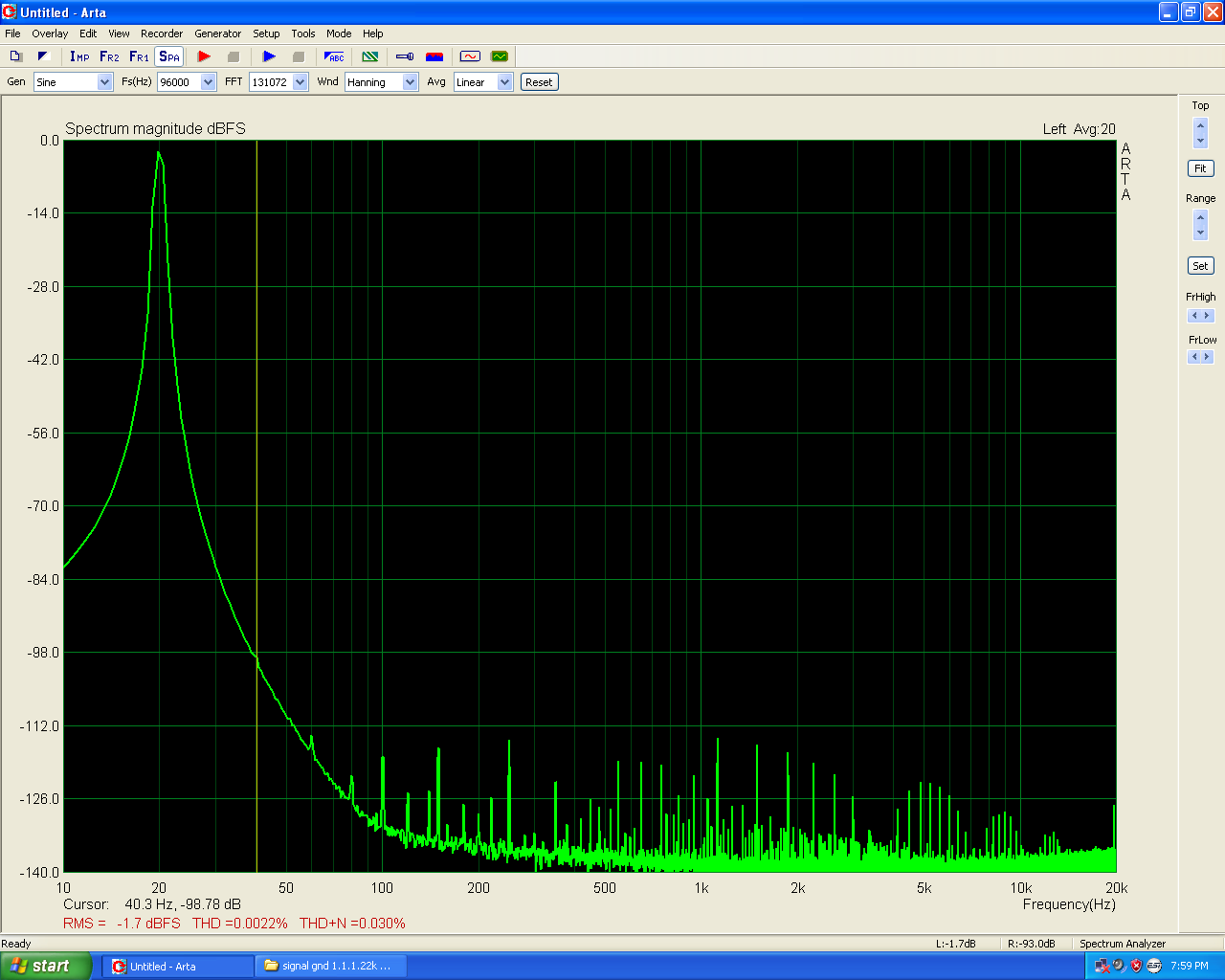

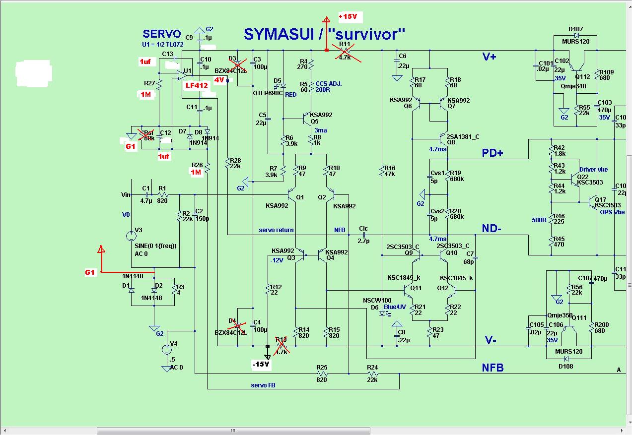

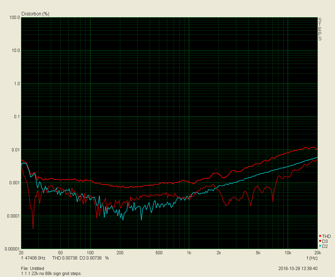

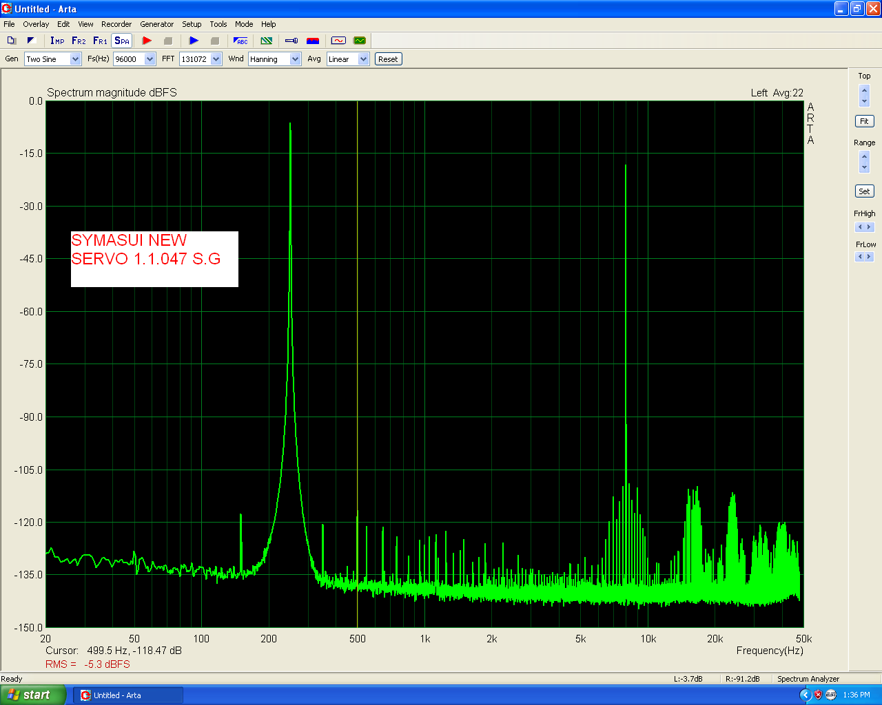

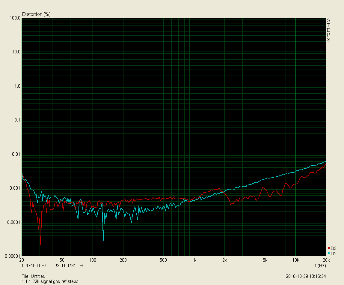

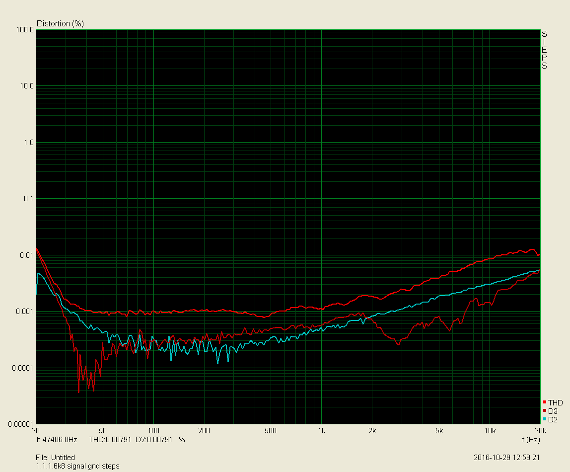

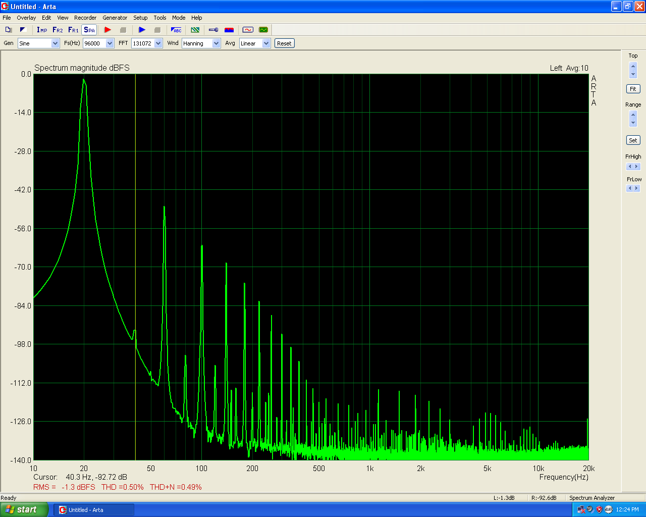

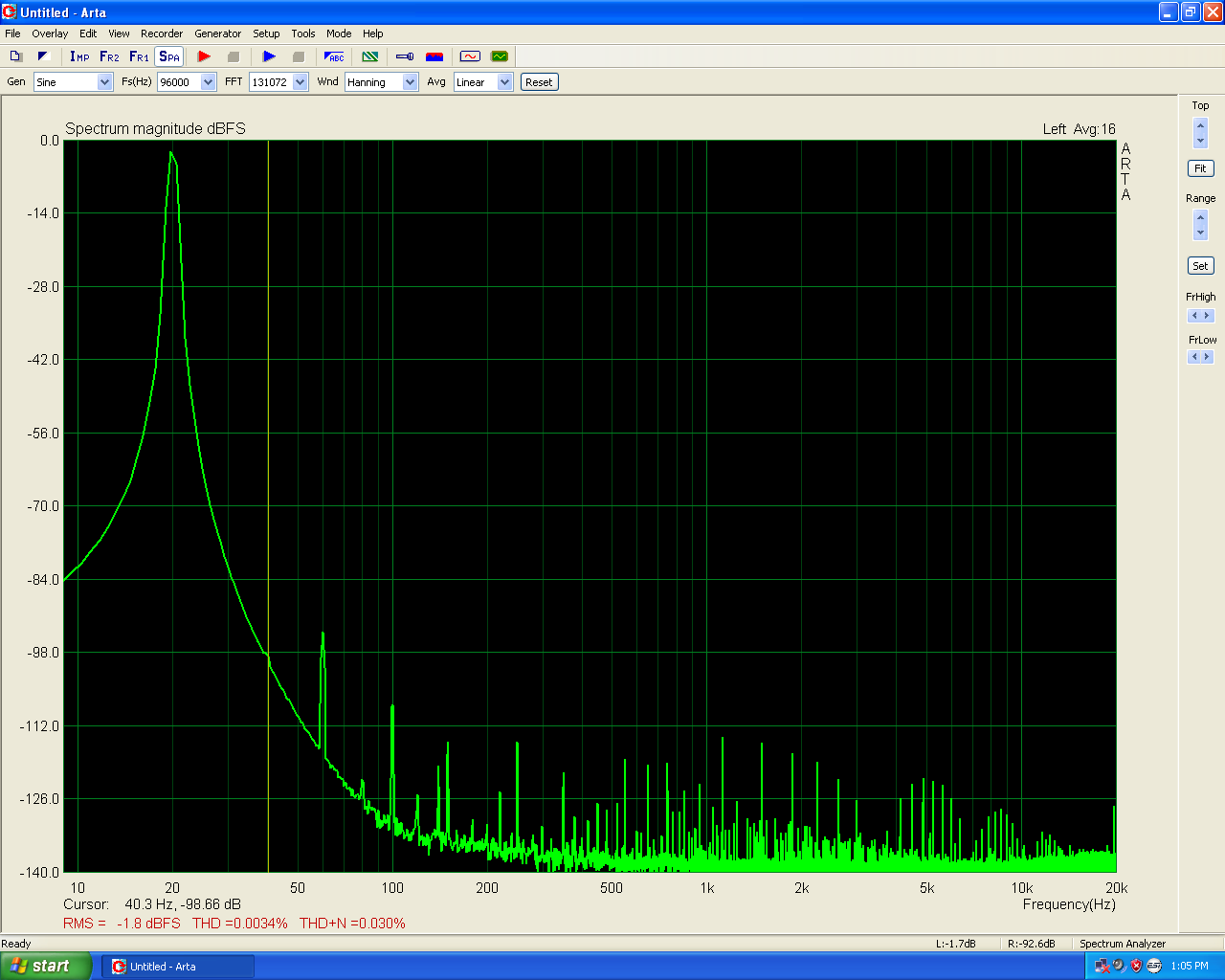

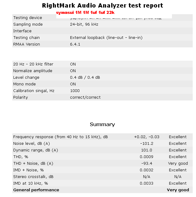

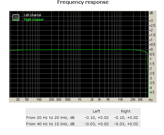

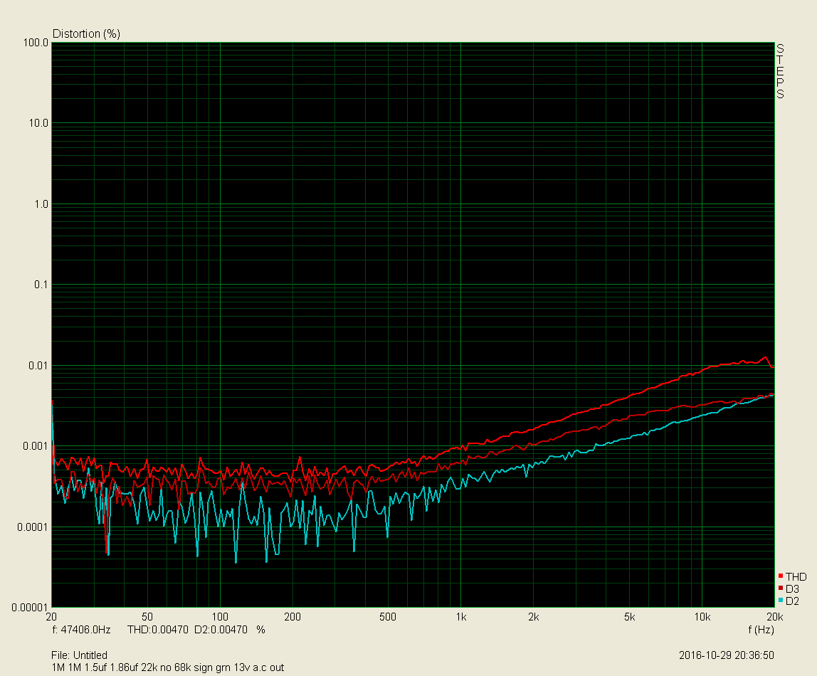

Servo experiments.
Yes my last modified circuit hasn't good performance in low frequencies
The distortion is high in low band.
See pictures 1&2.
The first try after this was to increase the C12 value to 1uf.
See picture 3&4 better results but i have -4mv offset and very long settling time.
The second try was to change R28 VALUE from 6k8 to 22k.
Settling time is now 12'' and offset is zero.
See pictures 5&6
Too late for edit.
Here is the circuit as tested in the last 5,5,7,8,9
A final test using RMAA.
Hi!
Above I explained why Japanese people made it so. You want to repeat it. But if you don't understand the reasons for the decision of the Japanese, you will have to rely more on God, than on circuitry. 🙂
I don't think your explanation is correct.
Q203 is a DC servo, taking its reference from the speaker terminals (which is a good idea by itself) - time constant of the integrator is 1 sec. Nothing to do with speaker cable resistance compensation. It makes no sence to compensate it in DC. AC is a different story, but it's not addressed in this circuit.
I do not offer my explanation as the only correct and detailed. But we don't have another point of view. 🙂
You can't link the choice of the connection point and the servo settling time. Doing so is wrong because the wires do not contain timing circuits, whose delay time can be compared with the 1 s.
Your second assumption (regarding the fact that the servo works only on DC) is also incorrect. Look closely (for Onkyo 504): Opamp Q203 (the right half) is covered by 100% NFB loop via C215-С217. This opamp included a voltage follower for the current signal of the acoustic systems in the frequency range up to megahertz. The other half of the amplifier has a gain of -1: R235 / R233 in the frequency range up to megahertz. Our current view is different: you see servo a DC amplifier, I see the AC amplifier.
In the third place. Very bad decision - to take the referent to the servo near the back wall of the amplifier, a mile away from the clean signal GND. Such a connection forms a magnetic loop antenna. This loop adopts magnetic interference as we have seen in the graphs from thimios. Opamp amplifies the potential difference between the GND and the connection point of the servo. Therefore, we need to draw the Board as to protect this loop against interference with normal operation of the compensator the nonlinearity of the current speakers. Otherwise, we should take as referent the servo as close as possible to the clean signal GND to avoid interference.
You have to understand my thoughts, how would you not find it difficult to do so. 🙂
