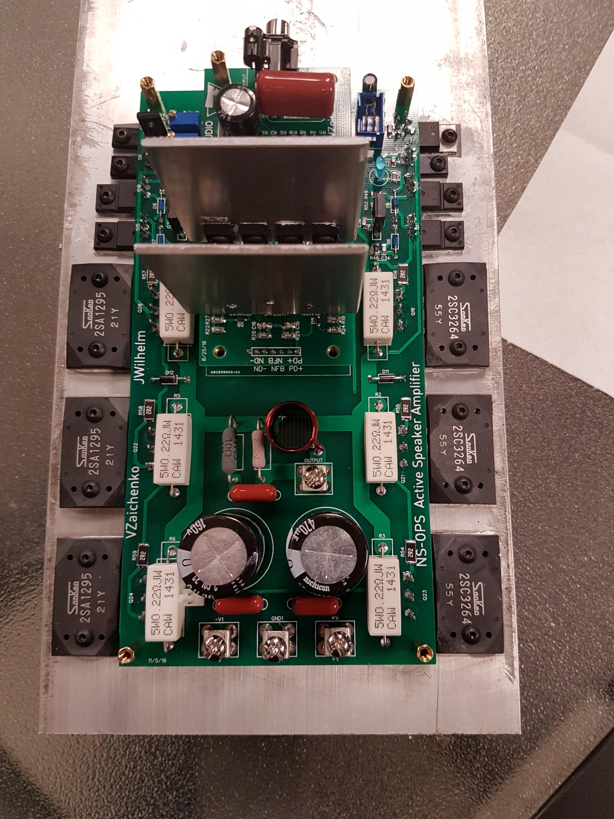

Evan has the Vertical CFA/VFA with NS-OPS boards. These were from before I gave up on trying to keep up with Valery's new input designs and layed out the modular boards. You could select either CFA of VFA by what parts you populated.

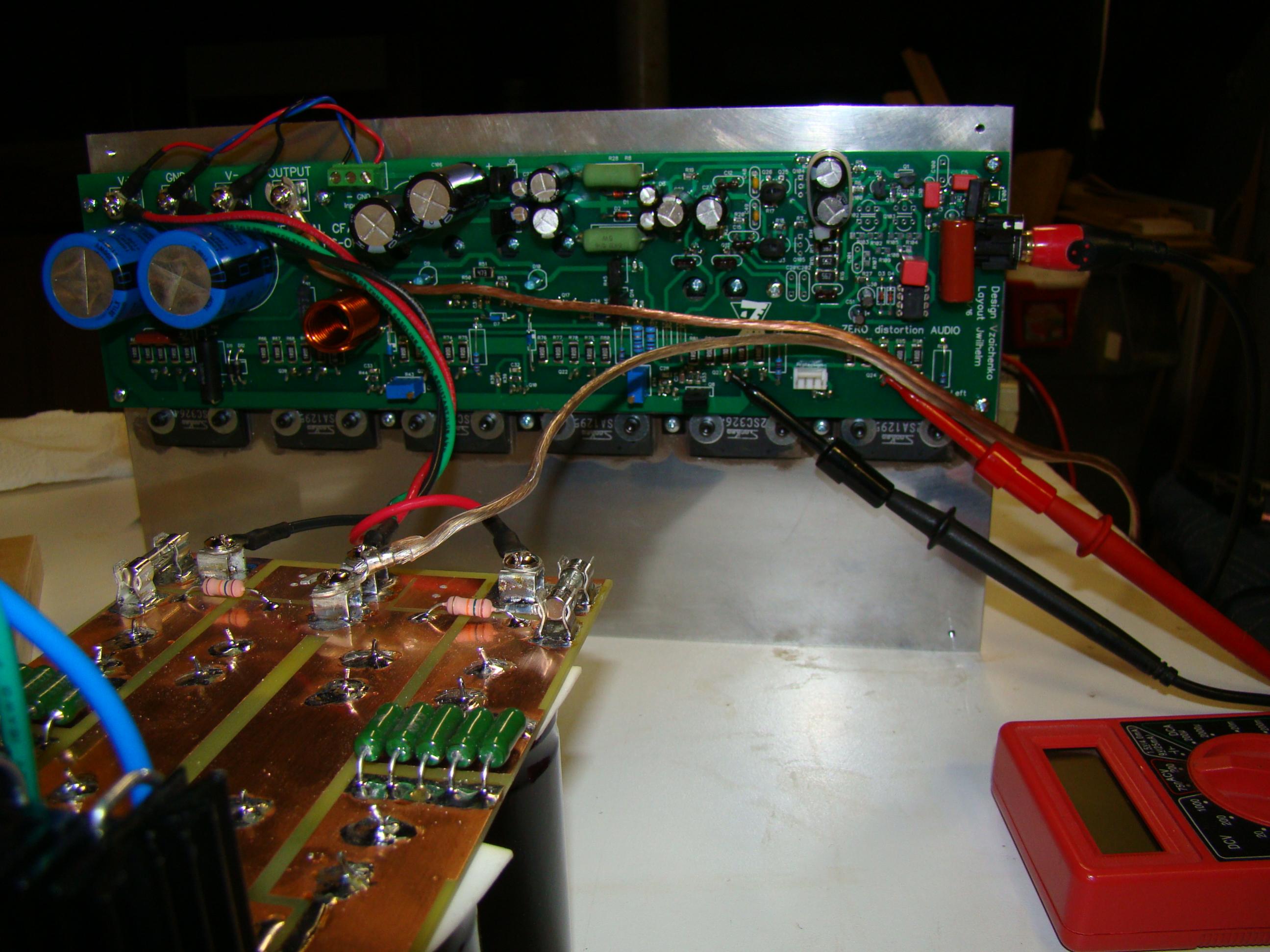

Hi Evan,

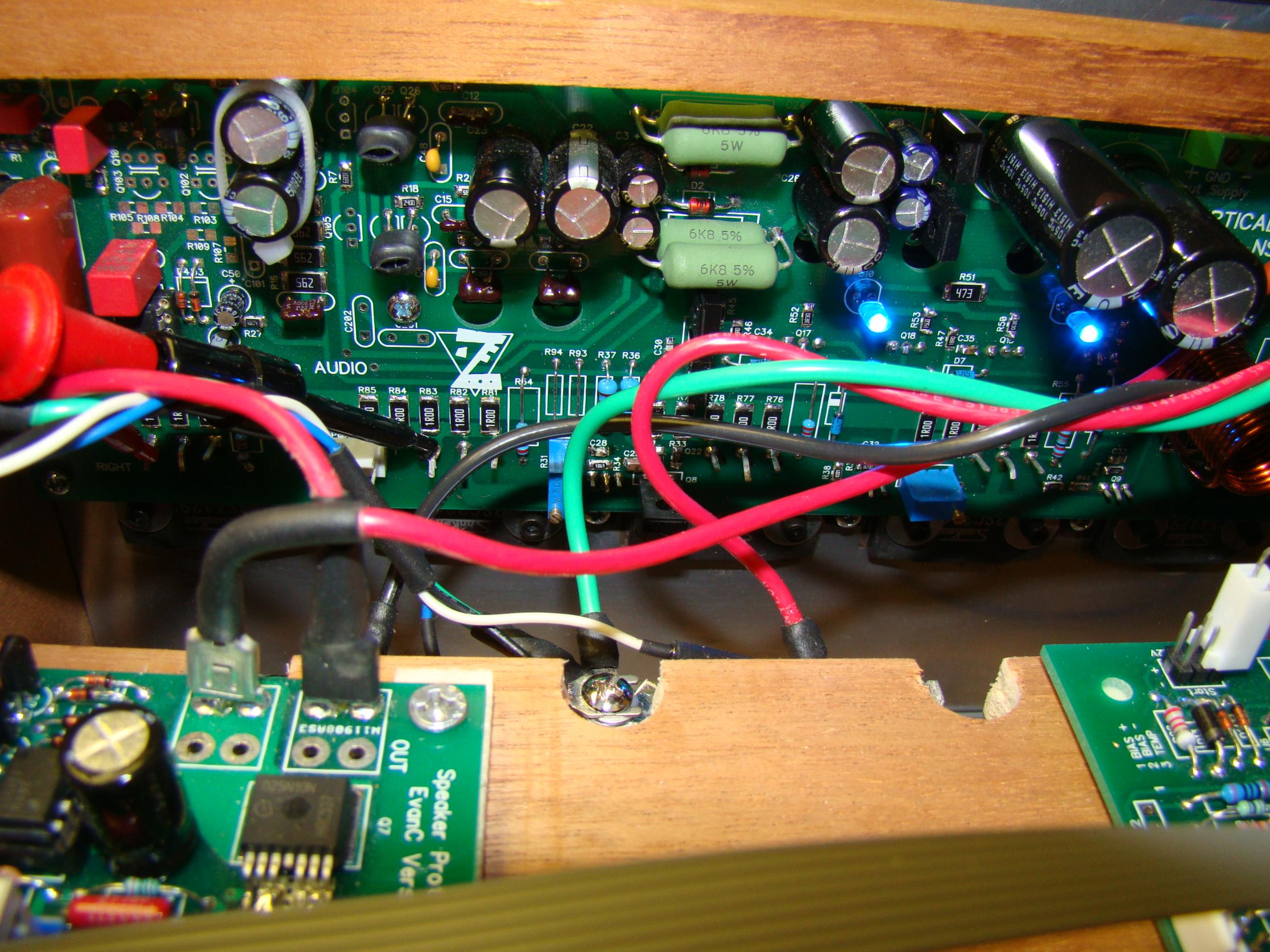

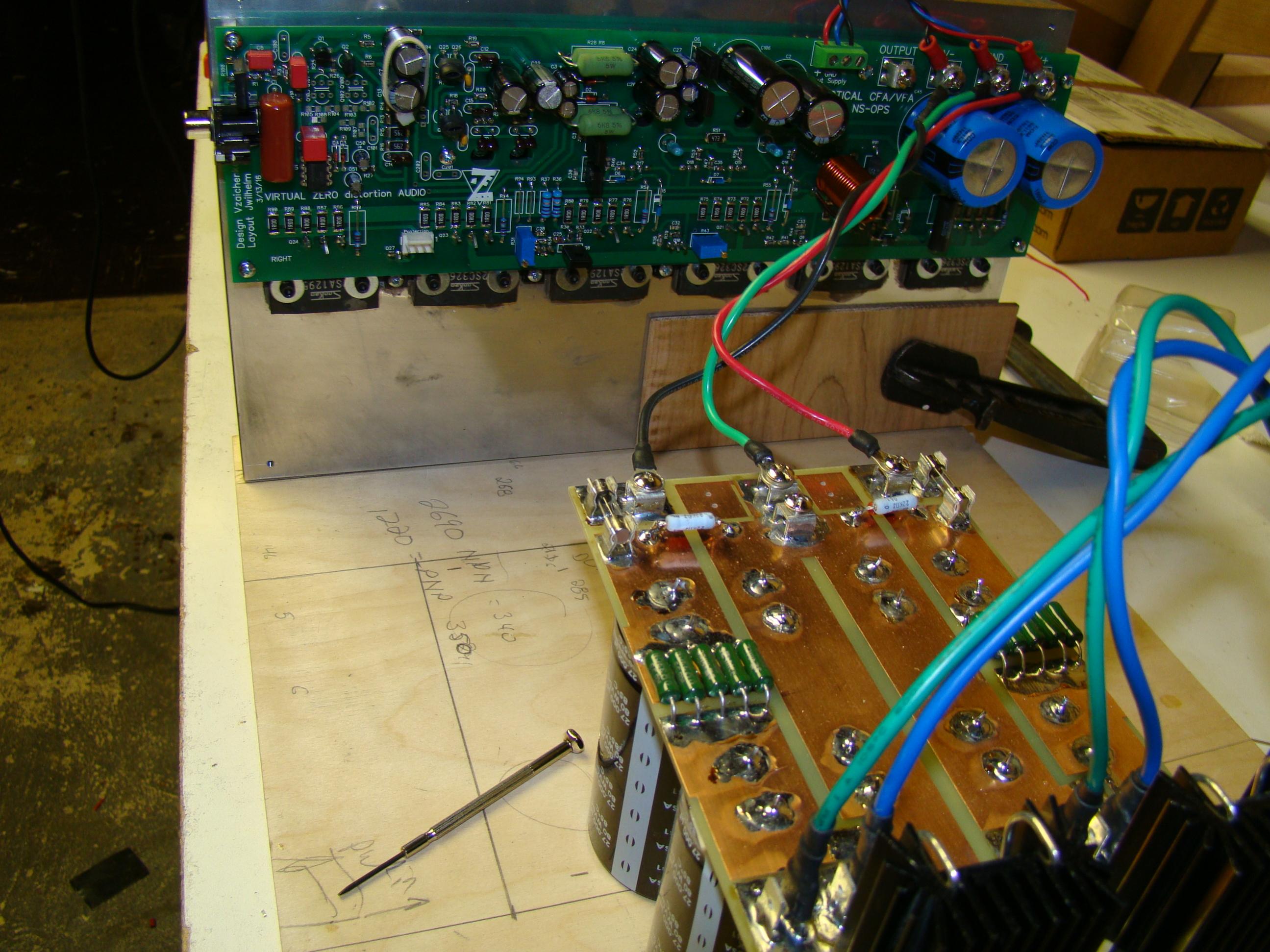

Great job - nice looking boards and good PSU filters!
R44 will not help - it provides adjustment for clipping symmetry.
The right one to change would be R40 - say 1.3K
However, I would recommend to leave it as is. Set 3mV at both channels - in fact, the closer you are to zero axis - the better.
Thimios - these boards allow building both Vertical CFA and VFA (either, or) - some placeholders stay unpopulated.

This is actually an earlier version of the layout, designed just before Jeff came up with the modular setup (the one you have). Topology is the same as if your "carrier" OPS would have a Vertical IPS module attached.

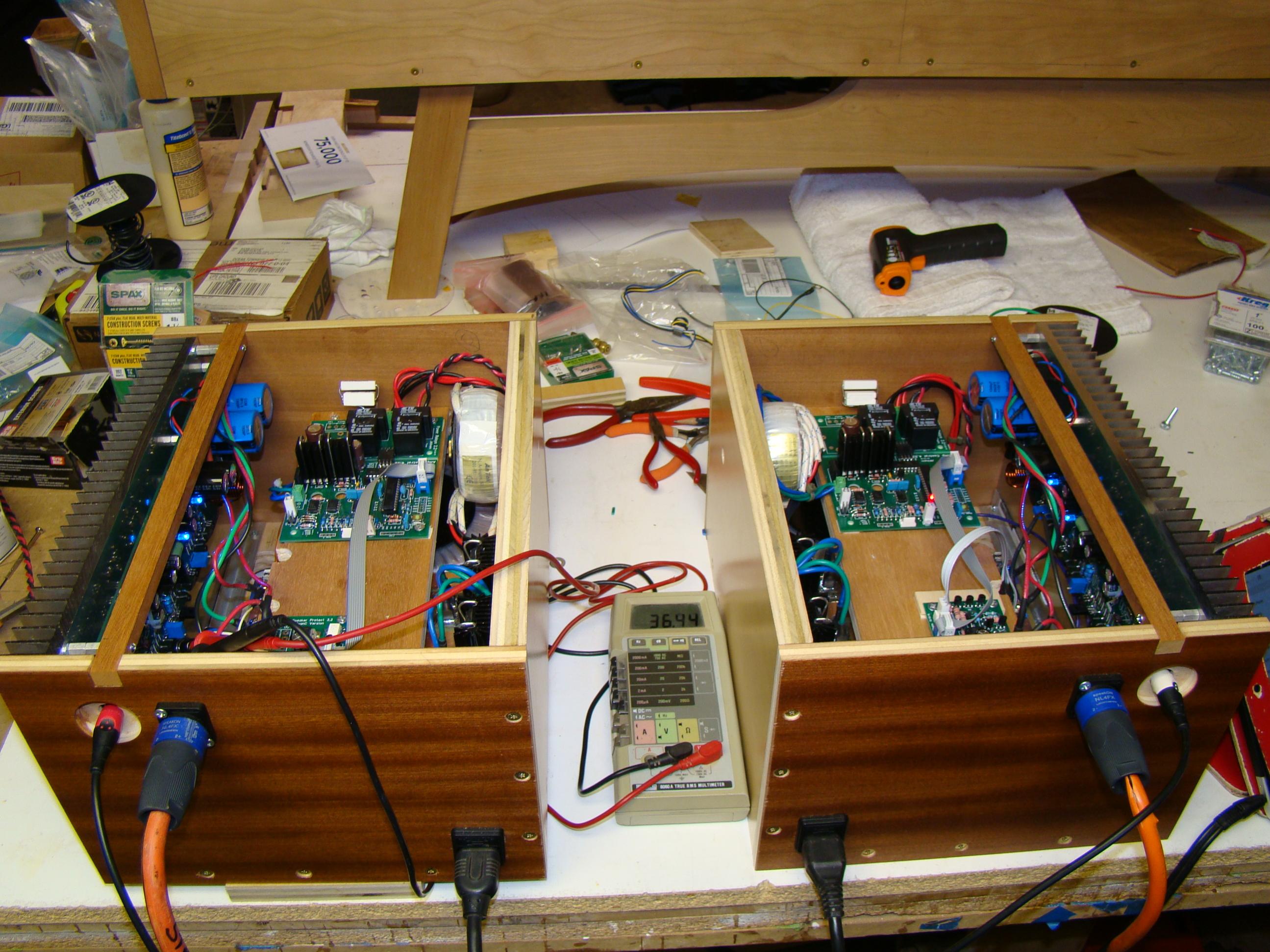

Both amps started up first try and have been playing for a few hours.
Workshop photos. I'll let these play in the shop for the day tomorrow and they should be in the real system by tomorrow night. I plan on using these to drive the midwoofers.
My only fear is that I will love them and then I'll need two more channels.....
Thanks for the great fun,
Evan

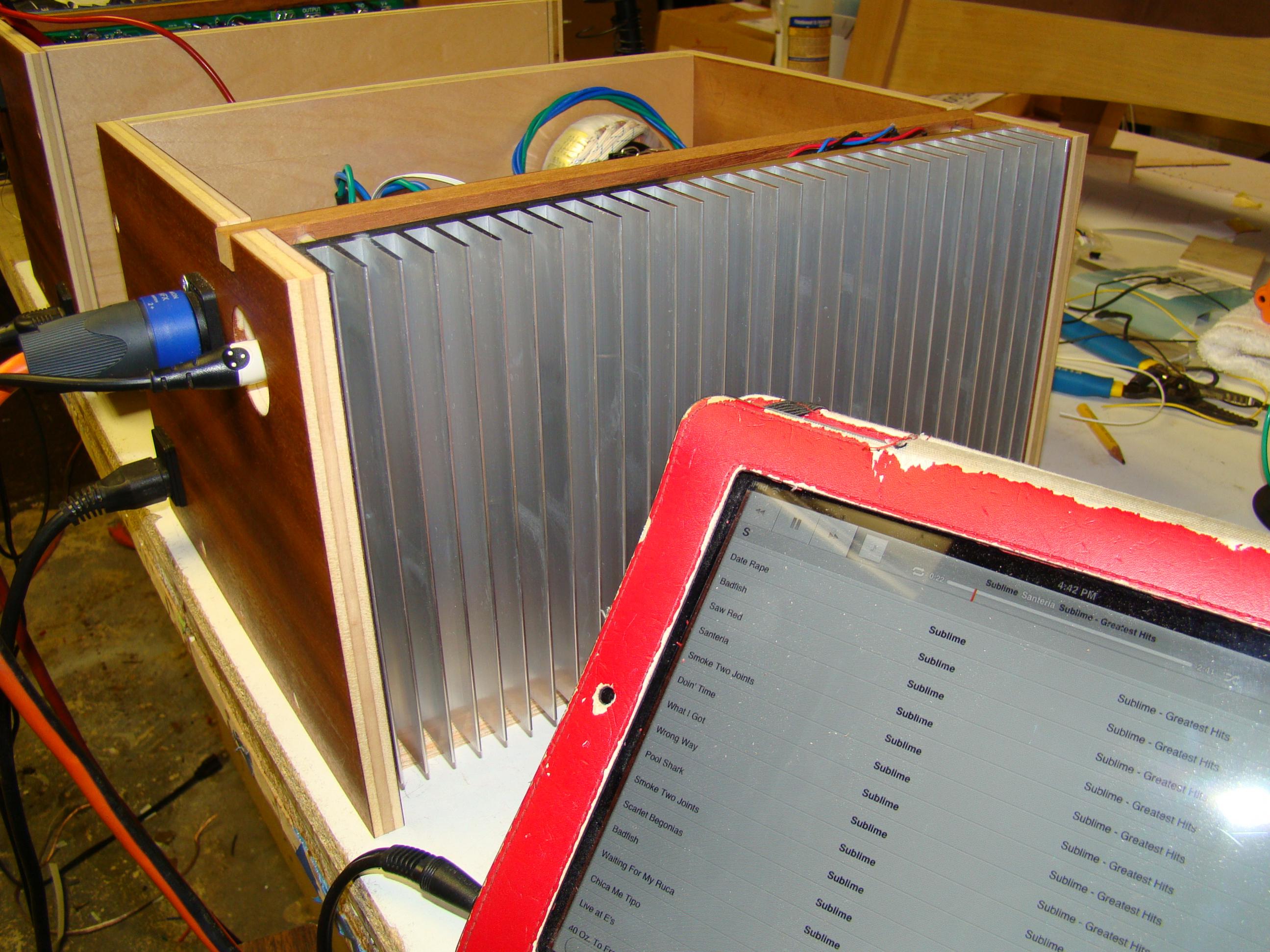

So I've been listening to the vertical cfa NS ops for a while now. As as I feared...I need/want two more channels.
I used a 7" piece of this for each channel. 12.000" - HeatsinkUSA
They get quite warm after some hours of playing. The new amp will use an 8" piece per channel. Rails will be +-72 Vdc The transformers I have come with an 18 vac output. I assume I can regulate this to the +-15vdc I need for the front end power.
