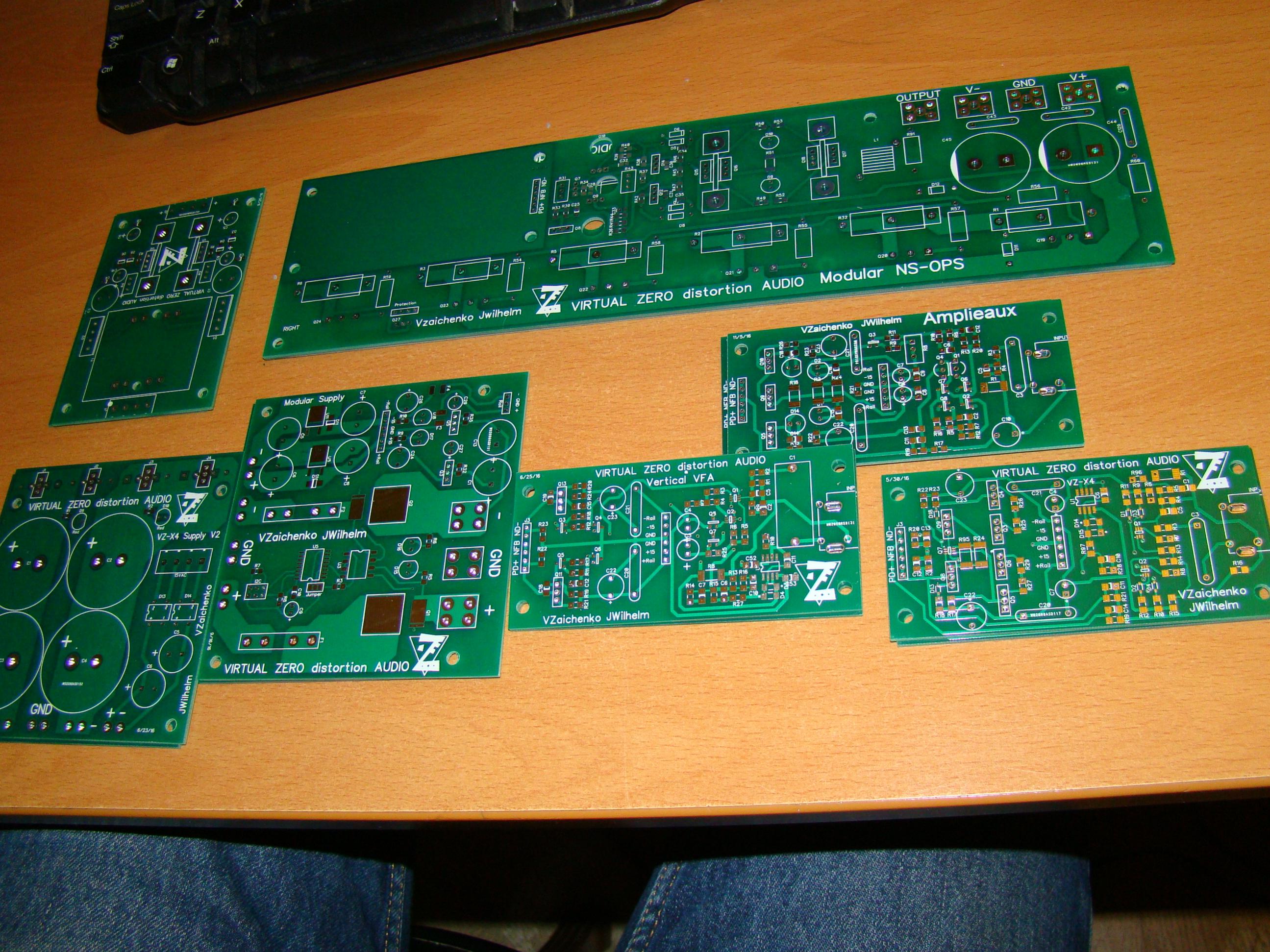

A nice package arrived today. As usual the boards look very nice. I'm excited to see the vertical vfa board. I have been liking the Spooky/slewmaster driving the midbrange and woofers. It will be fun to try some of these designs in that position. The vertical cfa ns ops is superb driving the tweeters.
It will take me some time to look these over. I'm sure I'll have some questions.

Pretty much everything for a great build - even the PSU with rails control.
Cool choice of the front-ends
![up :up: :up:](https://files.diyaudio.com/forums/images/smilies/up.gif)
Control board - you've got a spare one for this build, right?
Questions - welcome

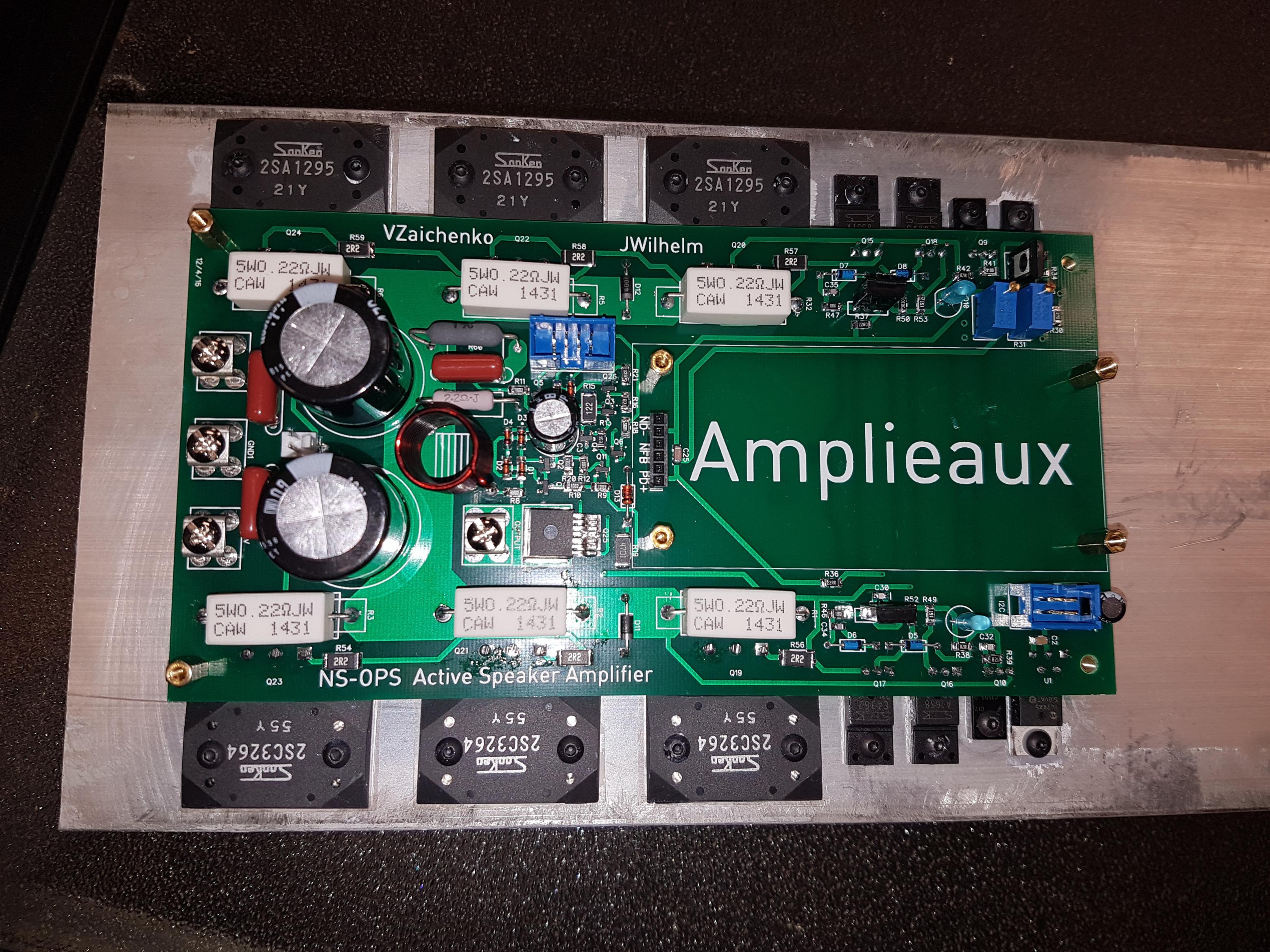

Round 2 of the NS-OPS plate amp is ready for testing. I've added speaker protection to the amplifier board this time.
Wow that is a cool looking piece of gear!

Is it a controller free protect version?Round 2 of the NS-OPS plate amp is ready for testing. I've added speaker protection to the amplifier board this time.
Is it a controller free protect version?![]()
This still uses a control board.
Ok Jeff,i see this blue connector now.This still uses a control board.

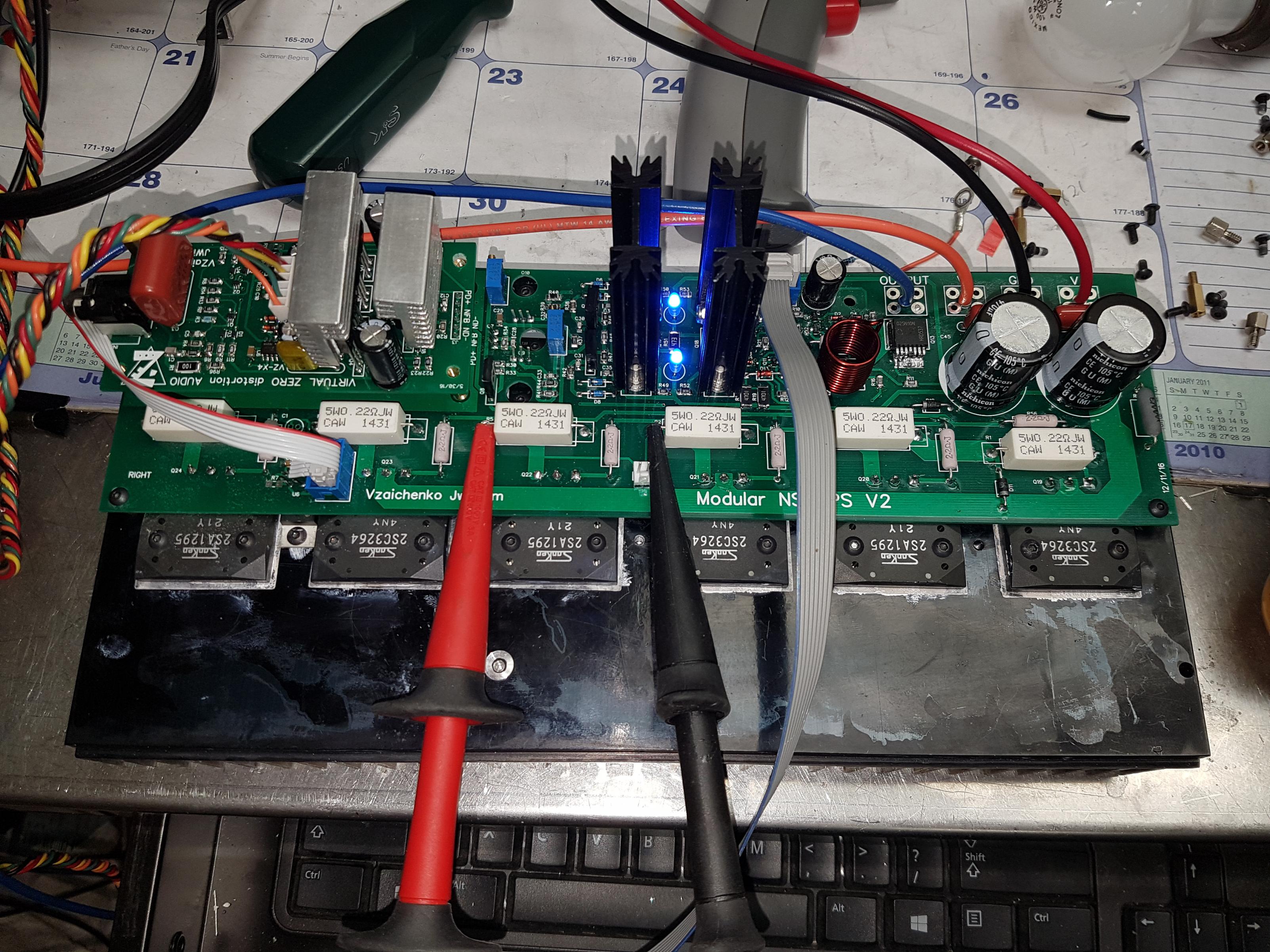

The new plate amp fired right up and worked great, but was having some troubles with false triggering of the DC detection circuit. Having the DC detection circuit right on the output of the board added a lot of ripple the rail feed to the DC detection circuit and showed me a glitch in the DC detection circuit design. Valery saved the day and came up with a simple fix for the issue and this thing is working perfectly now. Some scope shots will follow.
