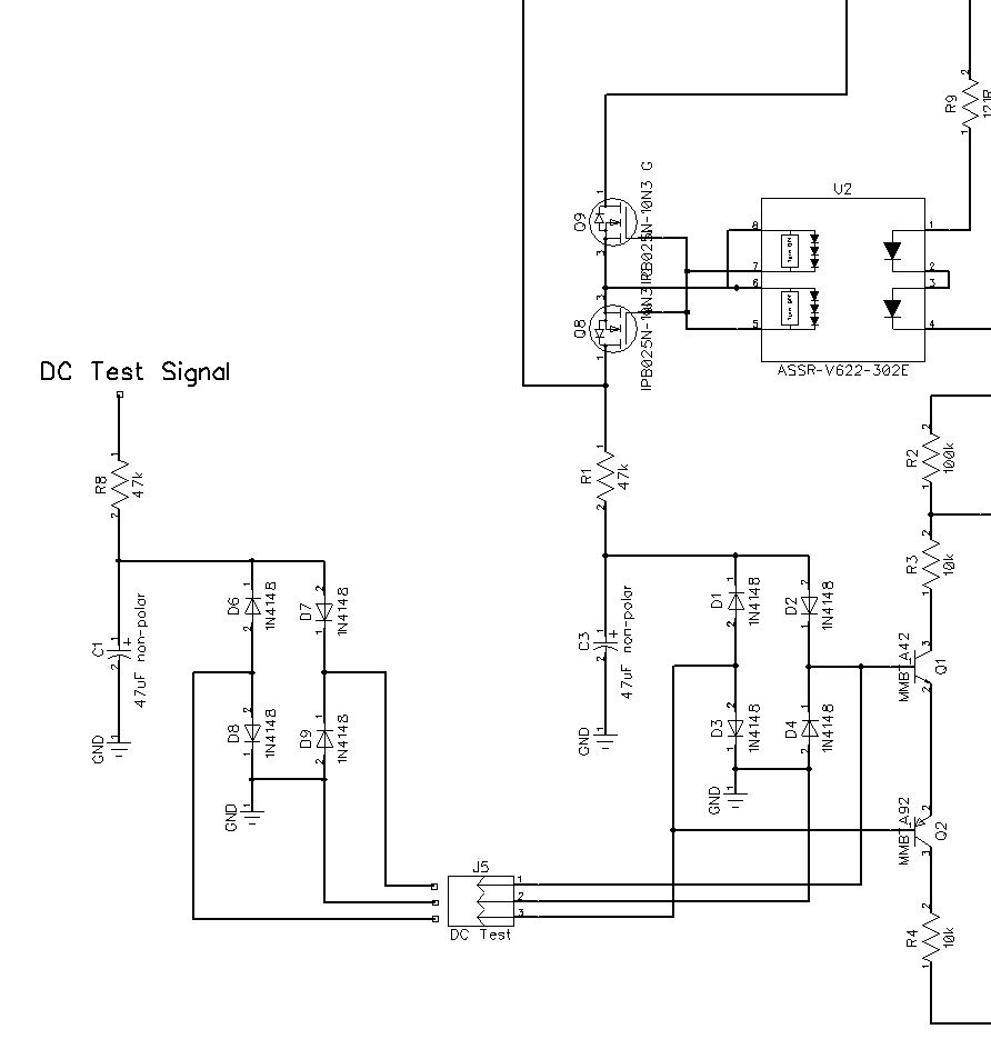

I just need to think of a way to properly test the DC detection now. I think it will involve removing the output inductor and resistor to apply DC.

Jeff, as an option for the future update - we can add a service connector "DC Test" - see attached.
In this case, we can apply the test signal - AC, DC, AC + DC - whatever it is through the circuit shown, even when the amplifier is up and running, without interfering with it - just using an independent "parallel" channel.
Or just have the whole circuit on the board and connector for DC Test Signal 🙂
Jumpered to ground when not in use.

My concern is that we need to apply DC to the output from the amp to test it. Disconnecting R1 from the output and applying voltage there would work for testing. A simple solder blob jumper between it and Q8 would work for this. I'd like to add a bunch of test points for measuring and applying test voltages in the next round.

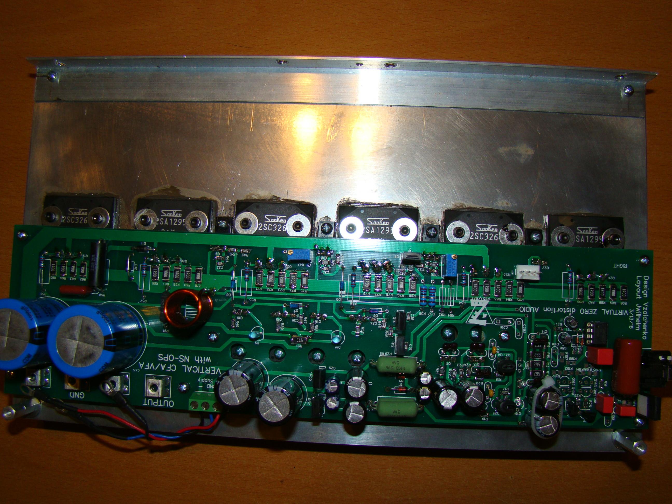

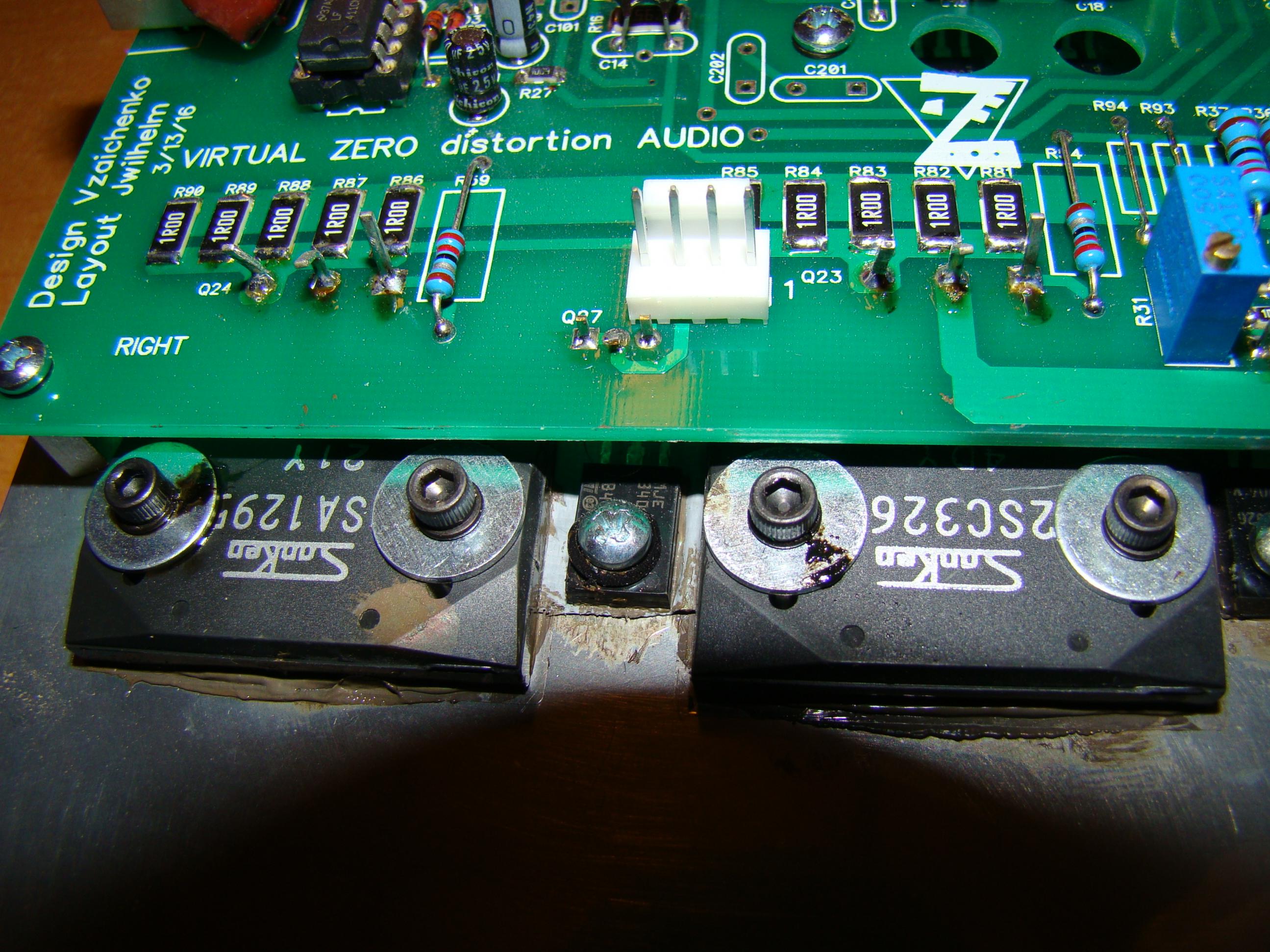

Well...I guess i was overdue. Had an amp go south. Thankfully the protection circuit seems to have saved the ribbon tweeter.
Playing at low volume and there is a "snap" sound and a bit of a smell. See the black stains around the two bolts holding the output transistors Q23 and 24 to the heatsink. My guess is it will be harder to find out what went wrong then it was to build the amp.

There is continuity from the collectors to the heatsink on all of the output transistor collectors on the bad channel. I have never seen a mica insulator fail...

It sucks that you had an amp go down! If your output devices shorted to the heatsink, the amp might still be fine. Those MT-200s are hard to hurt. This type of short would be directly rail to rail and not actually send high current through anything.
It's hard to tell from the pictures. Did you use the mica insulators that Sanken provides with the transistors or something else? What kind of heat sink compound did you use?
Thanks for checking in... Yes, I used the mica from sanken. The compound is arctic silver. The power supply was totally discharged right after the event so rail to rail short is likely.
Some versions of Arctic Silver compound are electrically conductive. Most of their computer grade compounds are. You will likely be able to figure out what happened if you pull the amp off the heatsink. There will be a pinhole or crack in the mica if it failed. If the compound passed current you will likely see a carbon track where the ark happened. Those black goop spots look like something might have dripped onto the transistors in the picture but may be scorched compound that squirted out.

They claim that the compound is not conductive. I think the goop is compound the squirted out. It smells bad. I'll be able to take the time to pull the board from the heatsink tomorrow. I'll report what I find.
I did take the bolts out of the two transistors that have the black goo showing and it definitely came from under the washer/transistor.

Yeah I was wondering what that stuff was. It all makes sense now. Use the white thermalloy stuff. I thought that you over torqued the mica but that would usually cause a short right at the start.
The Sanken micas are really thick and hard to short. They don't look like they'd cool the best though. I usually use Wakefield compound for my builds.

If the mica is cracked it leaves an air gap along that crack. At high voltage that crack/air track is a problem, but at the low voltages we use in solid state electronics we don't get high voltage arcing.
When the thermal compound is applied to the two faces the crack is still full of air.
The sink is electrically isolated from the transistor backplate/collector.
With use and repeated heating/cooling cycles the air in the crack expands and contracts. Gradually the vacuum caused by the cooling draws thermal compound into the crack. Eventually the crack is nearly full of compound and almost no air.
This is likely to take many dozens of heat cycles, i.e. months after the first test.
I reckon this, or a similar explanation, could be the cause of a failure after months of successful operation.

No short within the output device but about 300 ohms from collector to heatsink on all the devices. I won't be able to investigate until this evening. The black goo in the picture on Q23/24 came from under the transistor up beside the bolt and exited through the split in the lock washer. It definitely smells like burnt electronics...
