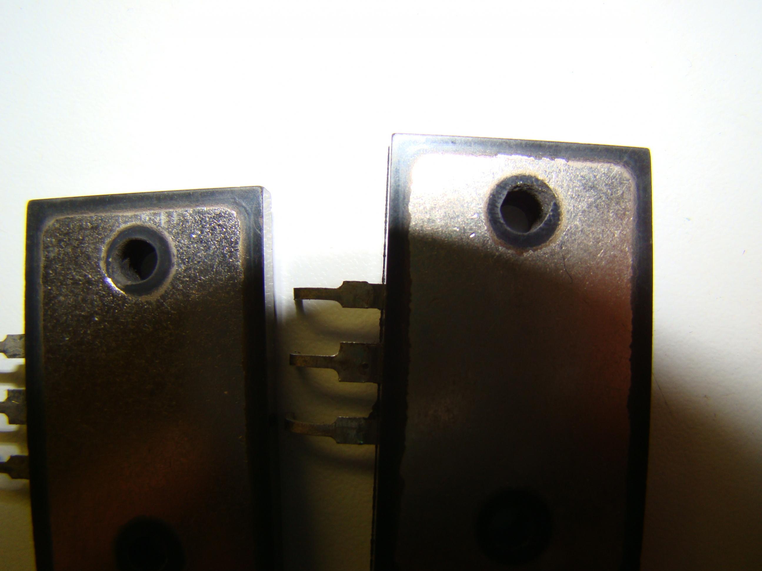

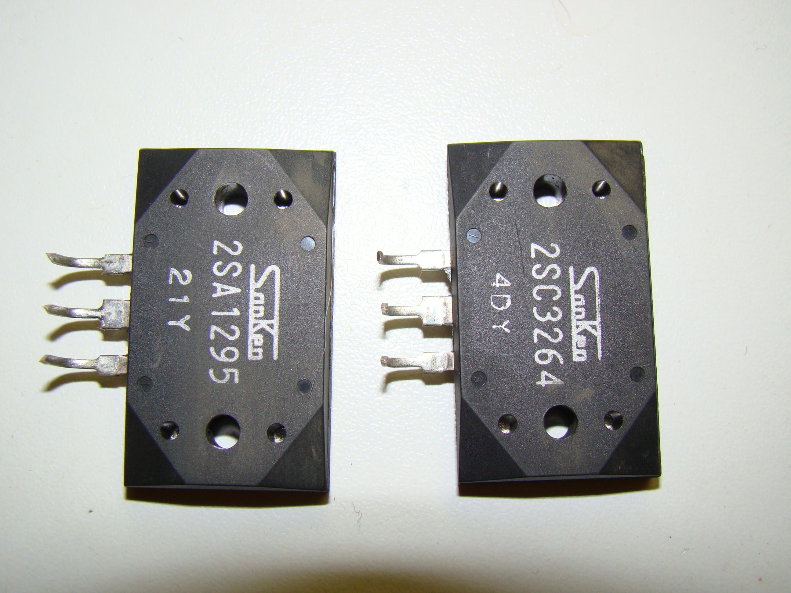

A sheet of the silpad showed up today so I was able to assess the damage to the bad amp.

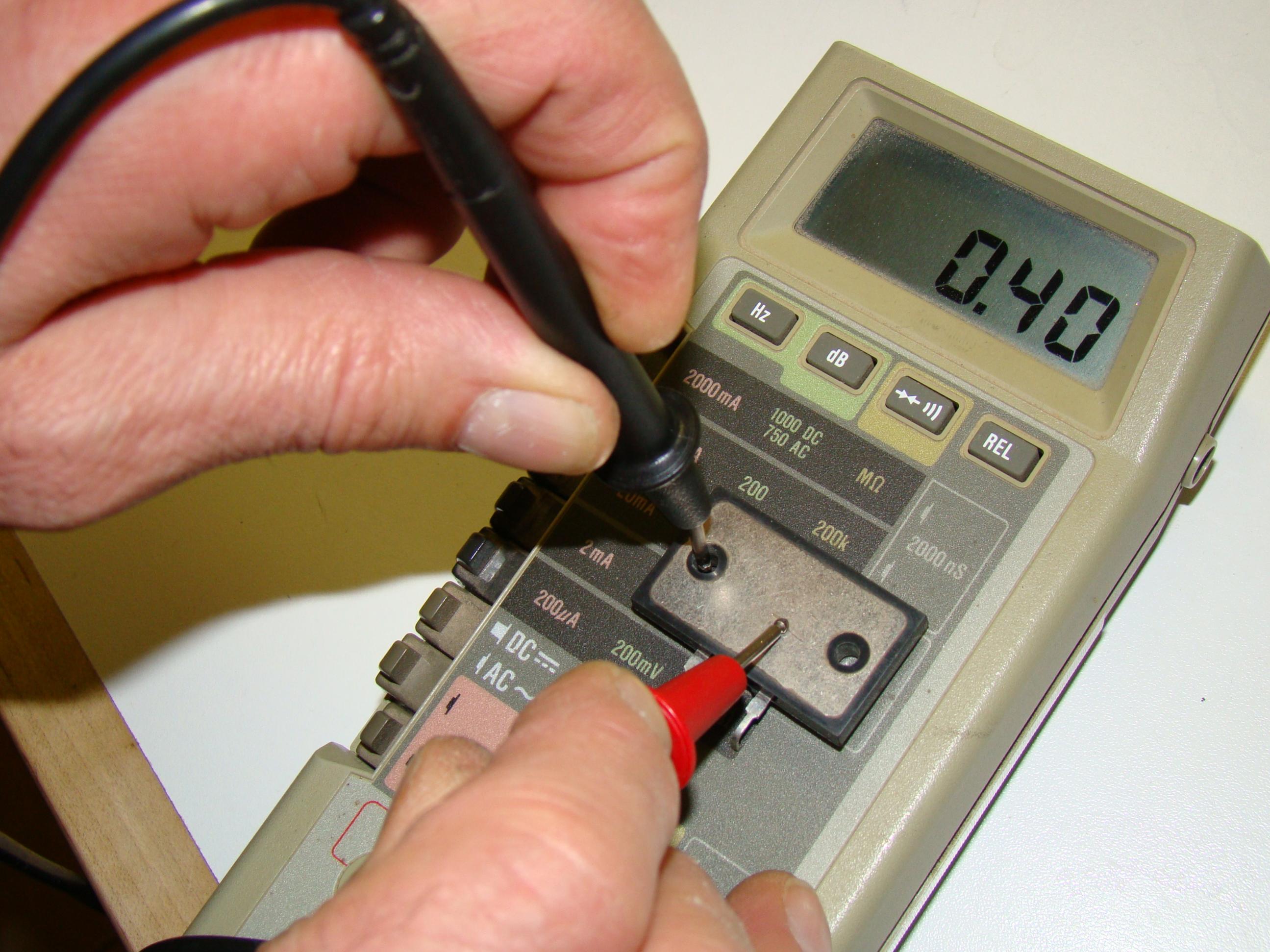

With a new insulator in place I was still measuring continuity from the output devices to the heatsink???? There must have been some metal that migrated from the transistors backside up into the bolt holes, there is continuity from the transistors metal tab to the inside of the bolthole in the transistor.
I replaces the two outputs that showed they had arced and the amp works fine. Tomorrow I will preemptively take the other channel apart and replace the silver goo and mica with the silpad.
Evan, sounds good. Interesting, rather non-standard experience, useful for all the power amps builders
Amazing. I've seen some really exploded/burnt MT-200 transistors, conducting C-to-E, but I've never seen the ones, looking good, conducting plate-to-hole 😱
I can't see anything in side that looks suspicious. I guess 140 volts and a lot of capacitance can do funny things.
I think you may have a layer of carbon inside the screw holes from the blow out. The interior of the screw holes should be epoxy. I wonder if the devices actually survived otherwise? Do you have a small file or close fitting drill bit that you can run through the screw holes and remove a bit of material, then recheck for continuity?
I think your correct about the devices still working. I gave a try at cleaning up the bolt holes with a small file. The epoxy around the bolt hole is crumbly/chalky. I decided to just replace the two devices.

It's at least to my eyes evident the plastic has become charred and thus become conductive, you have to grind of that thoroughly.
It's cool that the whole system has demonstrated rather high reliability - nothing broke, except those two transistors, that experienced the arc - even those two are ok, except some areas of their plastic case became conductive

$13.00 worth of transistors and $35.00 for the sheet of silpad. Not bad at all.
