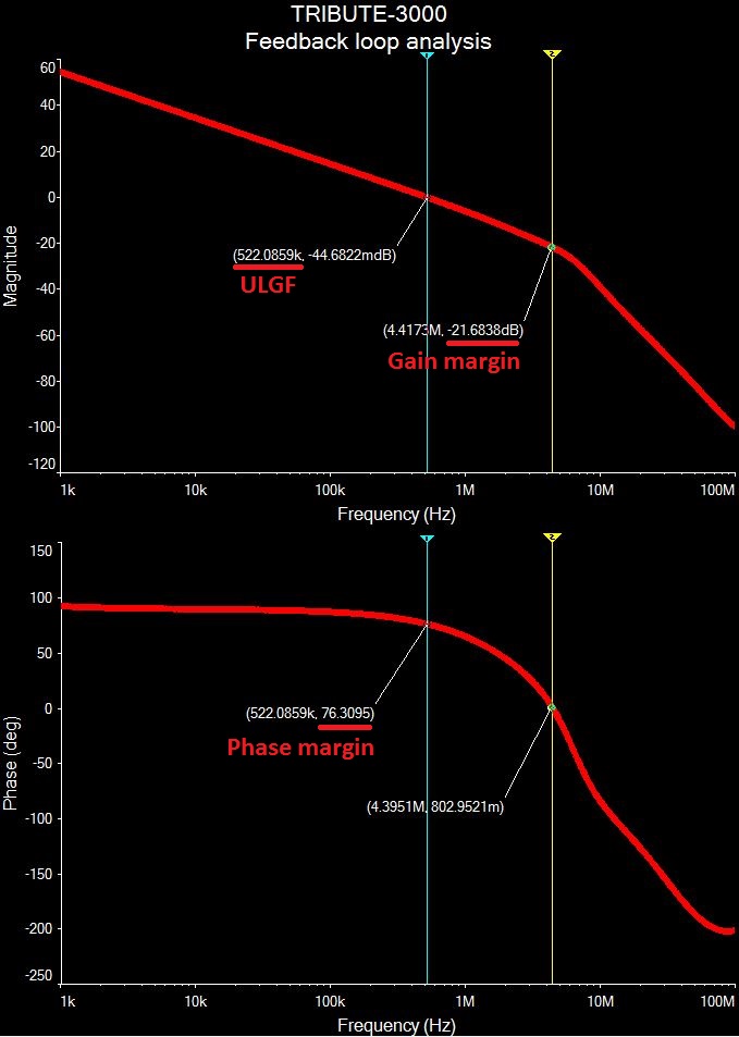

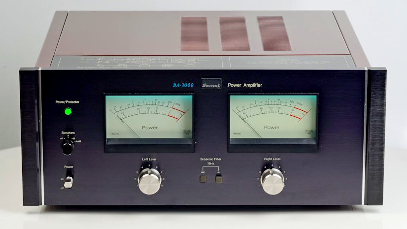

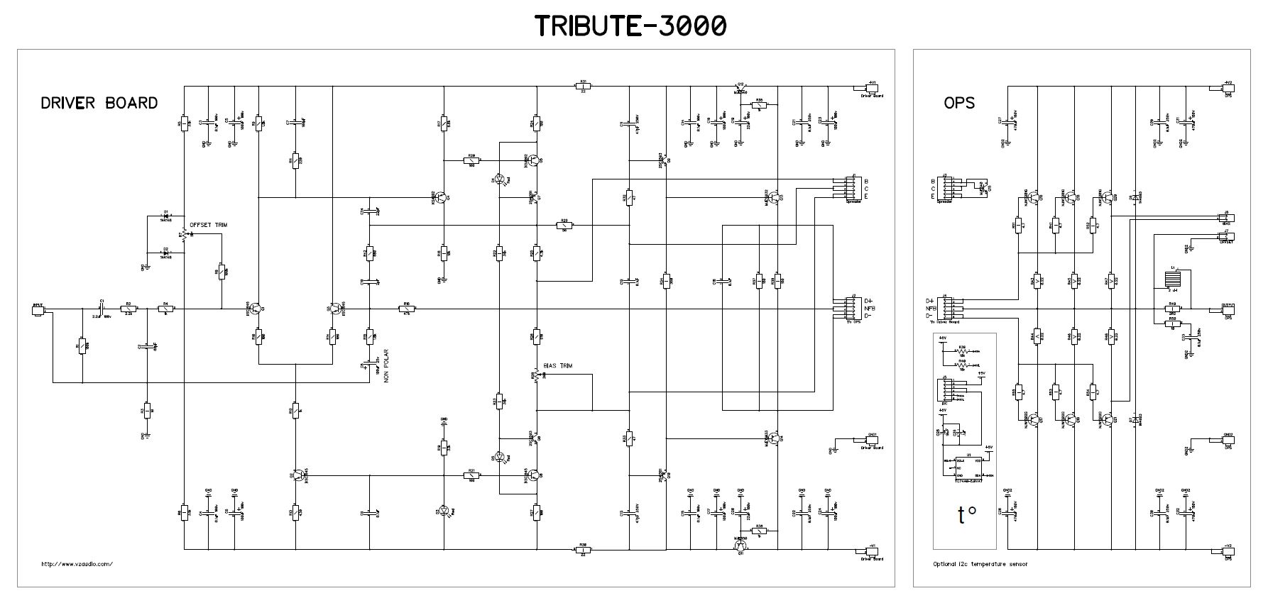

In memoriam of and inspired by the good old Sansui BA-3000
In general, I'm not a big fan of so called "blameless" topology, considering it sort of "too classic", thinking of something more "interesting", like current drive, feed-forward, etc.
However, there are some amplifiers, being a kind of a benchmark of their time. For me, one of such products is Sansui BA-3000 - a deliciously sounding bulky device, introduced in 1976, I was lucky to come across in the beginning of 80'-es. It was a real High Fidelity experience. So, I decided to play with its model, based on the modern active devices, introducing a few mods, mostly aimed to achieve very clean clipping behavior.
The model actually performed even better than I expected. Low distortion, very good profile (mostly H2 + some H3), excellent stability margins. It's definitely not the fastest one, however around 45V/uS slew rate is fine, bearing in mind all the other qualities - highly accurate clipping, symmetric rise/fall time, low noise, rather high power (200+W @ 8 ohm with +/-70V rails). Very low (among the most of my designs) ULGF = 520KHz, that still does not harm - overall "speed" of the circuit is fine.
The design is rather simple, easy to layout on a single side board for etching (slowly working on it). So, I consider it as a good DIY project.
I plan to split the whole thing in 2 boards, just kind of the same way the original BA-3000 is arranged (output devices are placed on the separate board), allowing the driver board to be placed a little bit away from the heatsink.
Hi-res schematic is attached in PDF.
I can also share a Diptrace file if somebody is interested to come up with alternative layout.
