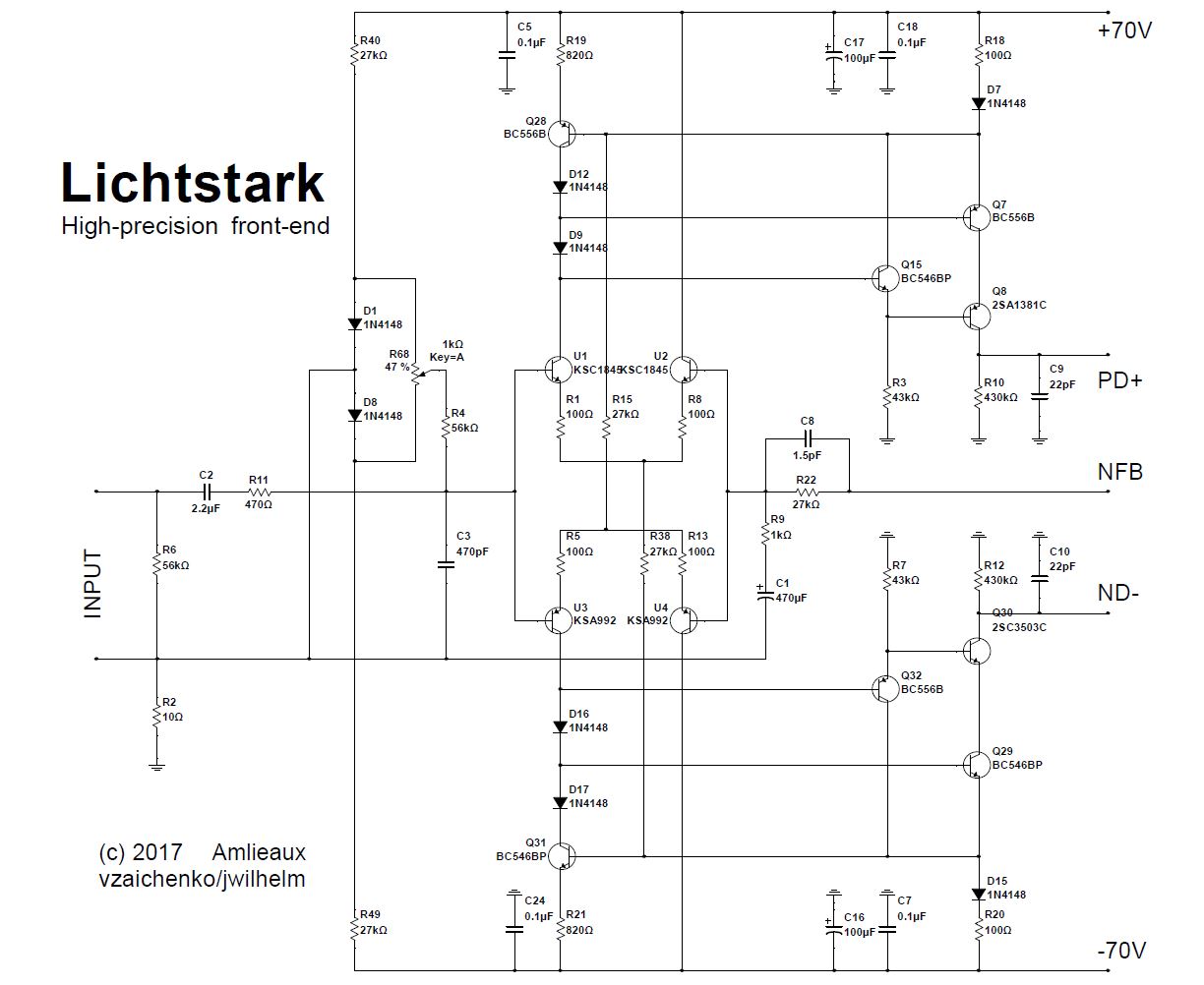

Hello Valery,
You can go even for a simpler VAS: with only one transistor in mirror style.
Keep those compensation capacitors between collectors and ground.
Hi George, sure - it will work in even simpler configurations.
However the level of VAS linearity (trans-impedance conversion) will somewhat suffer:
- simple mirror with "standard" Hawksford cascode - harmonics level increases roughly 5 times;
- simple mirror with no cascode - harmonics level increases roughly 30 times.
Well, even in the simplest case, performance is not that bad, however - my idea is making VAS as linear as I can, keeping the whole front-end simple enough.
Hi Valery,
Looks good!
You can generate very low distortion from very simple compensation schemes. No need for 2 pole comps here.
This current drive VAS would appear to be very linear.
A few ideas...
Have you tried returning R10 and R12 to the junction of R9 and R22. The way you have them configured wastes loop gain. This way you make more efficient use of the available loop gain by "recycling" it (Hope that made sense)
Another change could be to connect R3 to R7? Lose two 0V connections on the PCB.
Could you cascode the LTP transistors off the tails?
Try changing D9 and D16 to LEDs?
It would interesting to try the compensation scheme in my version on this amp.
Paul
Minor update
A small correction to original schematic from post #1859 - R14, R16 must be shorted.
Doing so, we prevent the distortion from slightly increasing at high swings - it stays very low up to almost clipping.

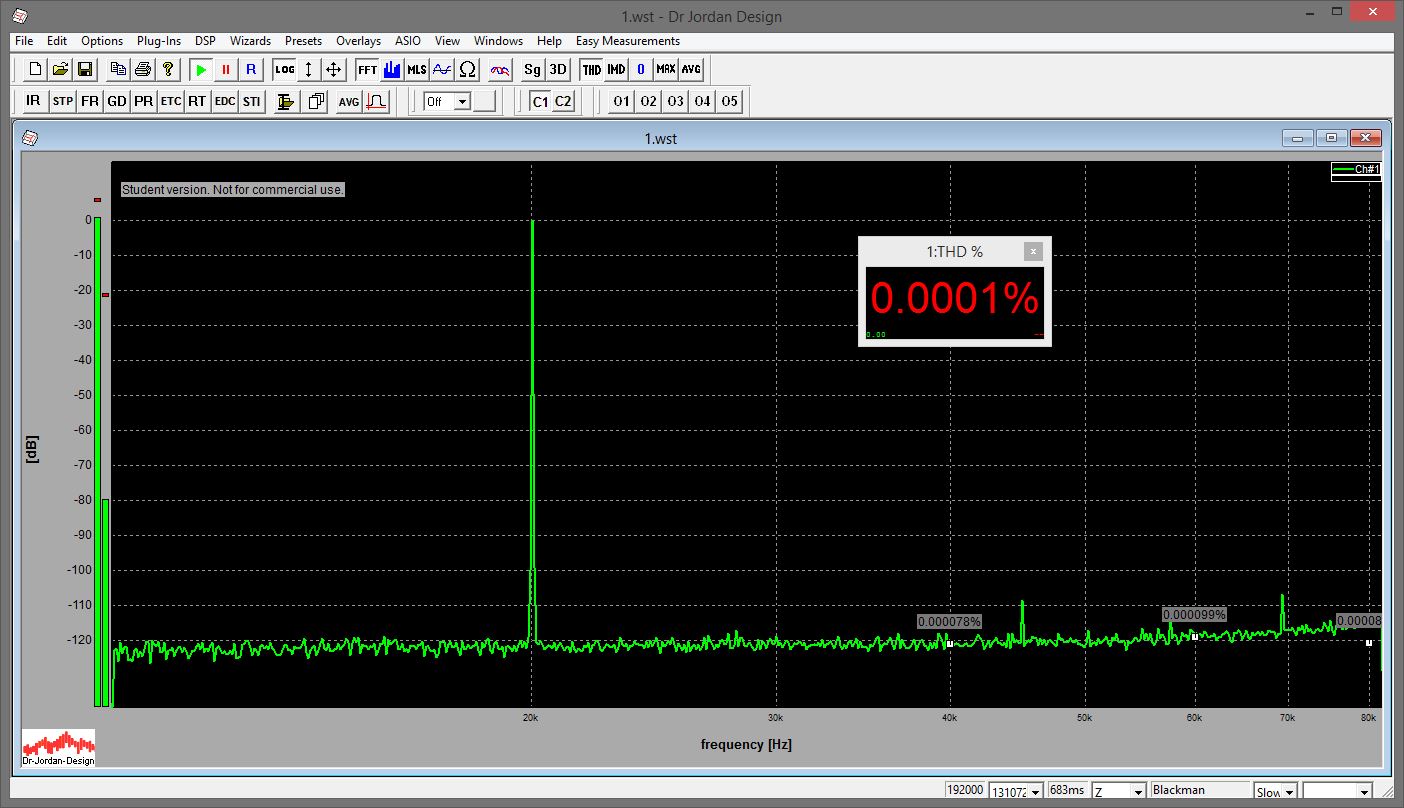

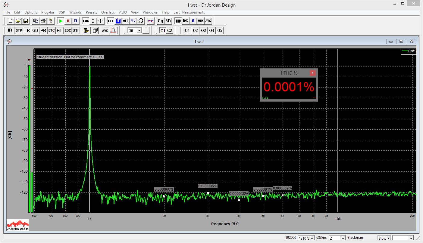

How do you measure that 0.00006% distortion? Is it worth using 3 transistors instead of one?
This is the simulated value (which is normally close to the measured one on the live prototype). I can physically measure THD values above 0.0001% (-120db) - that's what the external loop-back of my measurement system shows (attached - those are live measurements).
My goal is not just the low THD/IMD - I'm trying to achieve as high open loop linearity as possible. In this case, I don't need too much of NFB to reach low distortion, plus the distortion profile is much better.
Open loop THD of this circuit (no global NFB loop at all) < 0.003% @ 20V RMS ( < 0.008% at 44V RMS) within the whole audio bandwidth (OLG = 82db). This is what I'm looking for. Plus - high speed (wide bandwidth).

Hi Paul,
Yes - this approach demonstrates both high open loop linearity and rather wide open loop bandwidth (some 10-20KHz). High accuracy for sure.
The role of R10 and R12 is to slightly shunt the OPS input impedance, decreasing the influence of possible impedance modulation (due to the pre-drivers' base currents change). Well, wasting a little bit of gain, but that's ok as I've got enough of it 😉
R3 to R7 - possible, not really too much difference.
LEDs - possible, but no need - BC546/556 work well at very low Vcb, saving some headroom for the high swings.
Valery
Hi Paul,
And by my studies, not picky about output stage. I have a version where performance is the same when using a 3EF BJT or 2 Stage MOSFET output stage.
Also, as you noted, low THD up to clipping.
My version uses about 23dB of feedback flat up to 20Khz. The rest of the loop gain is shunted via the VAS resistor loads. Still gets single digit ppm distortion at 20Khz 2V from clipping in sims. So, yes, this current drive has potential.
Understand. But you get this as well (I think) with the alternative connection. The shunt goes via the feedback shunt resistor. So you still get the shunt effect and you get to linearise the front end some more. And the added bonus of some additional PM/GM as it speeds the front end up as well.
Valery
If you are willing to sacrifice headroom you can create a nice 2 stage clipping effect.
R3 to R7 - Just me and my avoidance of 0V connections where possible. PCB considerations. 😉
Paul
I will play with this some more time - the way you mention, it's forming a bit of a local FB loop. May give some good effect - agree 🙂
Exactly. A local loop. 🙂
Try very low values for these resistors. That's where it gets interesting... THD doesn't increase proportionally while the loop gain is falling. That's what I have found.
If you look at my version I have used the VAS shunt caps to double as MIC caps. Another local loop.

Hi Valery,
in order to minimize DC offset, wouldn't it be preferable to return the U1/U3 bases to ground via a resistor of the same value as the NFB path resistor R22 and to inject offset correction voltage, if still any needed, into the R9/C1 connection?
