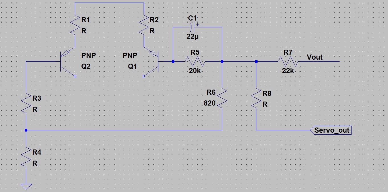

It may be caused by the difference in input LTP's base currents due to significant difference in base-to-ground resistors' values.
It would not be a problem if the input devices would be the jFETs or the tube triodes, but is a problem with BJTs.
For a test, we can insert an electrolytic capacitor in series with NFB resistor, placed between the -IN and the signal ground.

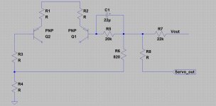

Please show this on the schematic.
Ok please look on the schematic.
Is this what you say?
Exactly! Just also made a picture
Just a moment...what is your recommendation?Exactly! Just also made a picture
A servo plus an electrolytic in feedback resistor?
But the base current is of the order of 6uA. That was confirmed some while ago and confirmed that the LTP was reasonably in balance (just within that tolerance of ±10%).
6uA across 22k is only 132mV.
changing one side to 11k only creates a difference of 66mV. That very approximately should become the new output offset.
The thing is even more strange - there's also R25 = 820R, between the -IN and the ground (bottom part of NFB divider). So our R28 = 22K is getting grounded in parallel with it - overall value change is negligible. Maybe it's not 22K?

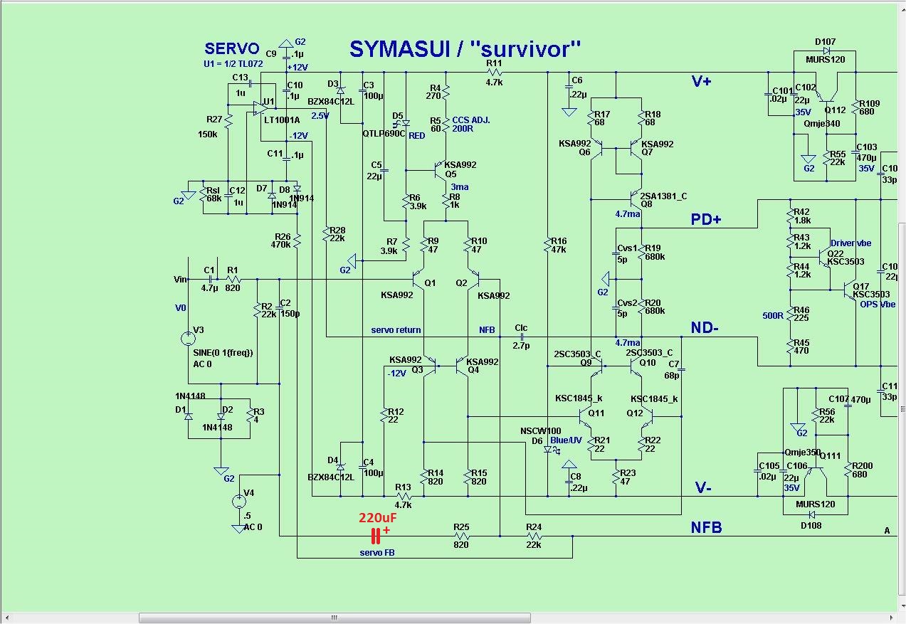

Also, just to clarify with regards to offset values. Voltage gain with the feedback in place is close to 28. So, if we change the differential voltage between the inputs for, say, 100mV, the offset at the output will change for 100mV * 28 = 2.8V
Let's first see what it shows with the electrolytic, but no servo:
- with R28 grounded;
- with R28 open.
And then with servo - r28 is just connected to the opamp output.
WITH the electrolytic,BUT NO SERVO and open R28 offset is 2.6mVLet's first see what it shows with the electrolytic, but no servo:
- with R28 open.
WITH the electrolytic,BUT NO SERVO and R28 grounded offset=140mV
Do you mean servo+electrolytic?
Valery to my point of view there isn't any reason for more modificationsYes.
The last schematic i have tried togethere with opa change from tl072 to lf412 is ok.
5'' from start up to 2.8mV is ok?
5'' from start up to zero is ok.

There are 2 main reasons for using a servo:
1) Long term operation stability - over the time offset at the output may slip, but servo will correct it all the time, so no problem.
2) You can remove electrolytic capacitor from the bottom leg of NFB divider - offset with no capacitor is higher, but servo will correct it.
It's possible to solve both issues with no servo (with manual adjustment), but the input stage has to be very thermally stable (very low offset change as operating temperature changes).

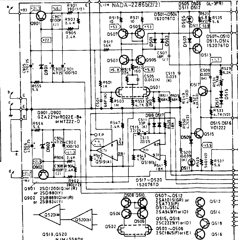

Here is a commercial solution.
- Revisiting some "old" ideas from 1970's - IPS, OPS
