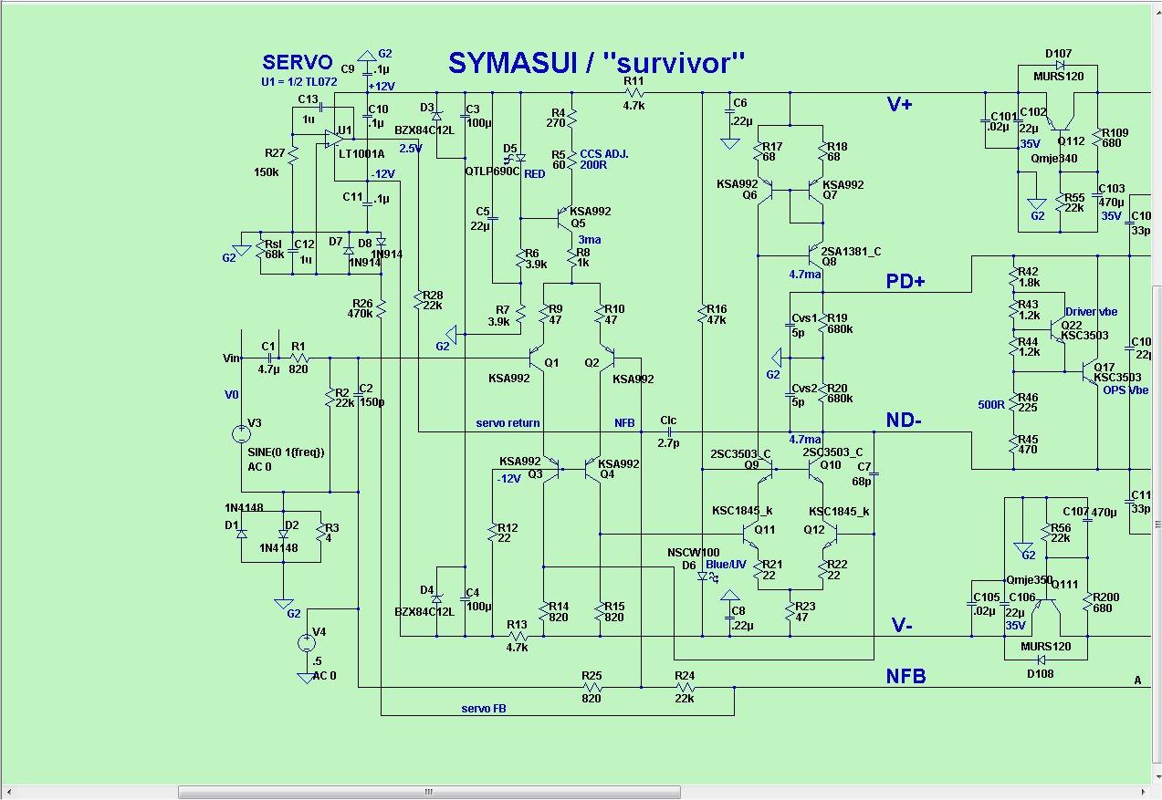

Today i have try to modify the servo controller as this schematic.
What i found?
Using TL072 servo started from 3v and ended up (after 12'')at 24mv!
Using LF412 servo started from 3v and ended up (after12'')at 2.5mv!
I will try the Valery mofification soon.

But why does the amp try to start with only 2.5mVoffset and move to 3Voffset to come back slowly to 24 or 2.5mVoffset?
That's what you have to find out.
Something is going wrong during start up.

I will try to remove this and see what happen thenCould this be from C12 slowly charging on power up?
C12 is connected to Power Ground on one side and via 470k+Speaker to Power Ground on the other side.I will try to remove this and see what happen then
If the speaker is open circuit there is an alternative path to Power ground via R24 - R25 - R3
During power OFF C12 should be completely discharged.
At Power ON it should not acquire a charge. Where would that charge come from?
The question is - what makes the output jumping to 3V with the servo in place - as no-servo test showed, it starts at 2.5mV and stays there, right?
Yes,the no servo version start from 2.5mv and stays thereThe question is - what makes the output jumping to 3V with the servo in place - as no-servo test showed, it starts at 2.5mV and stays there, right?
So, it looks to me like it's the servo itself moves the output to 3V and then, as C12, C13 charge-up, corrects itself
Time to arrange some standalone servo test. It will require 2 opamps - one foe integrator and the other one - for phase inverter. Connect the phase inverter to the servo output, the servo input resistor - to the output of the phase inverter.
The whole thing is expected to start with the offset close to zero and stay there (probably even closer to zero after some time).
