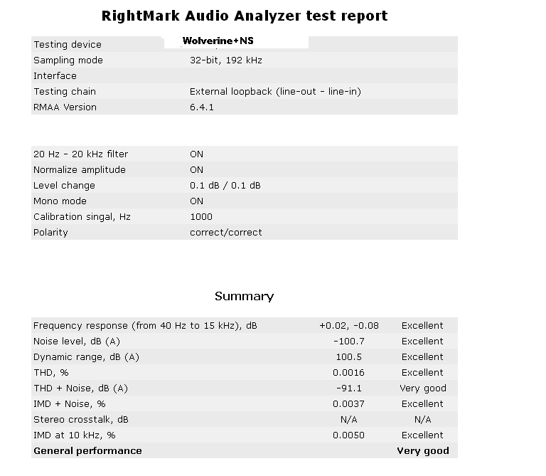

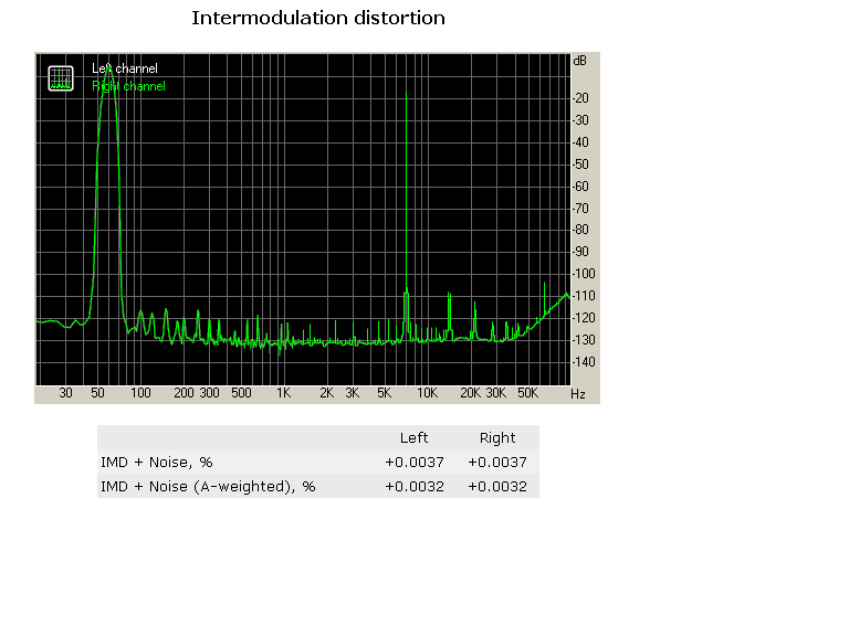

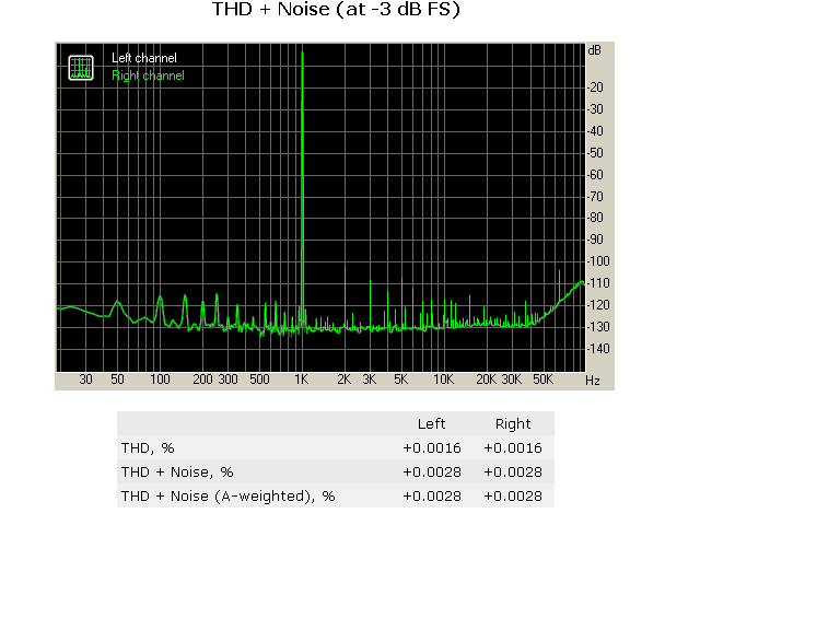

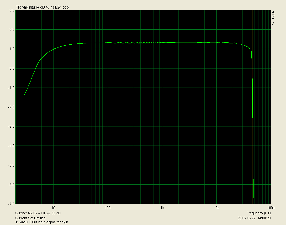

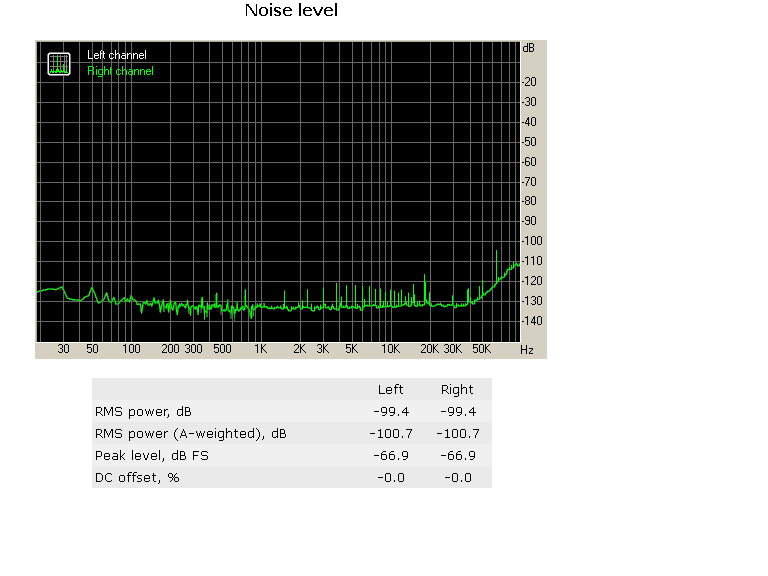

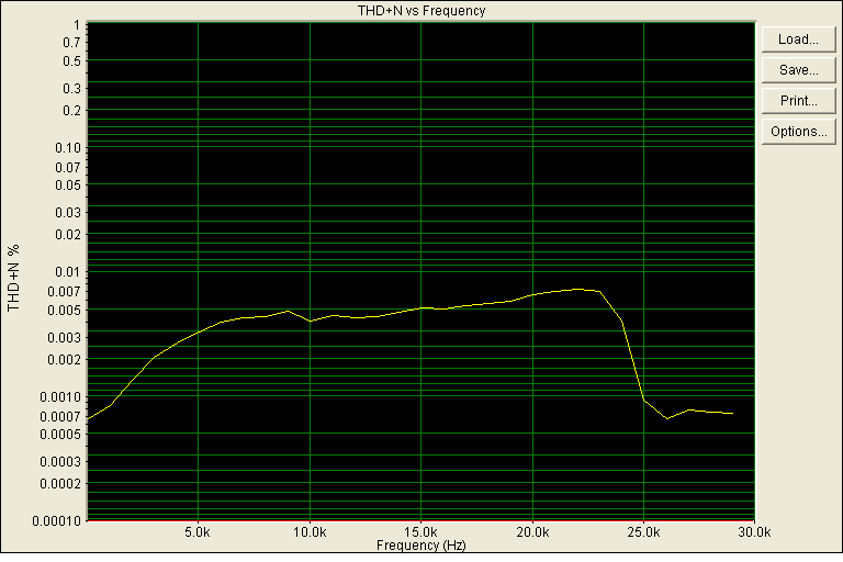

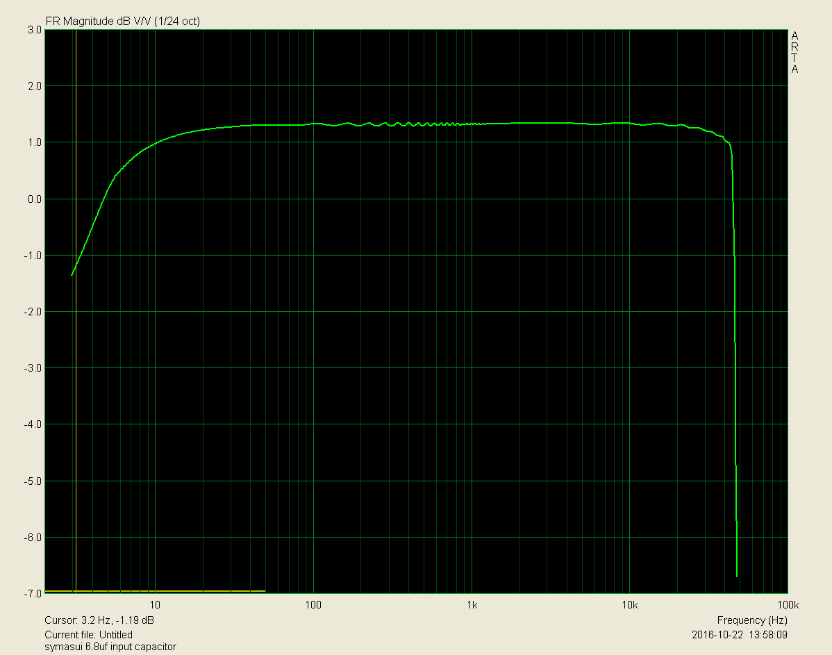

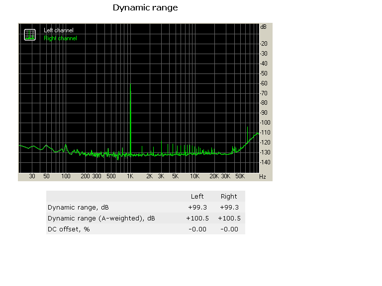

Testing Frequency Response and THD+Noice vs frec.

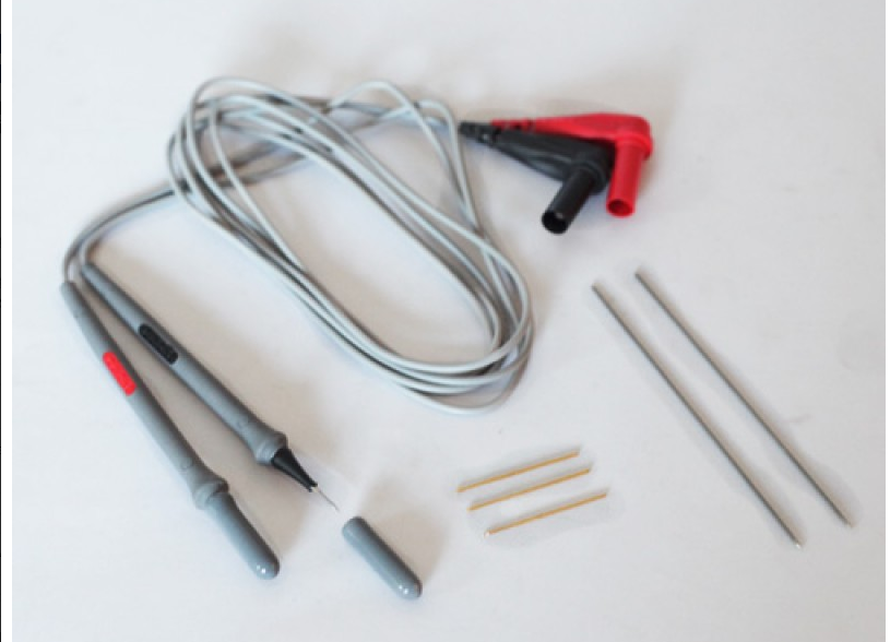

I had check testing cables 3 times and 3 times was mistake.(red cable to common on multimeter,these testing cables are gray and only at the end are colored,Fluke stupid selection)
No, theory is theory and can't be upside down.
These measurements are positive +145,+141
Sorry again.
here is the testing cables

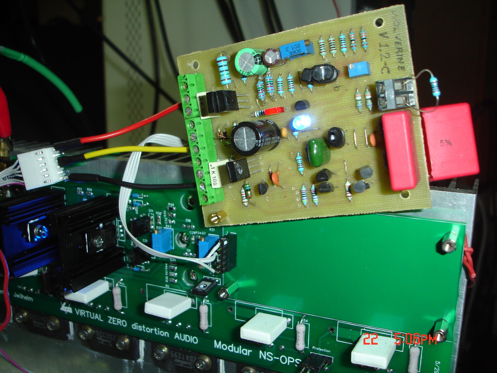

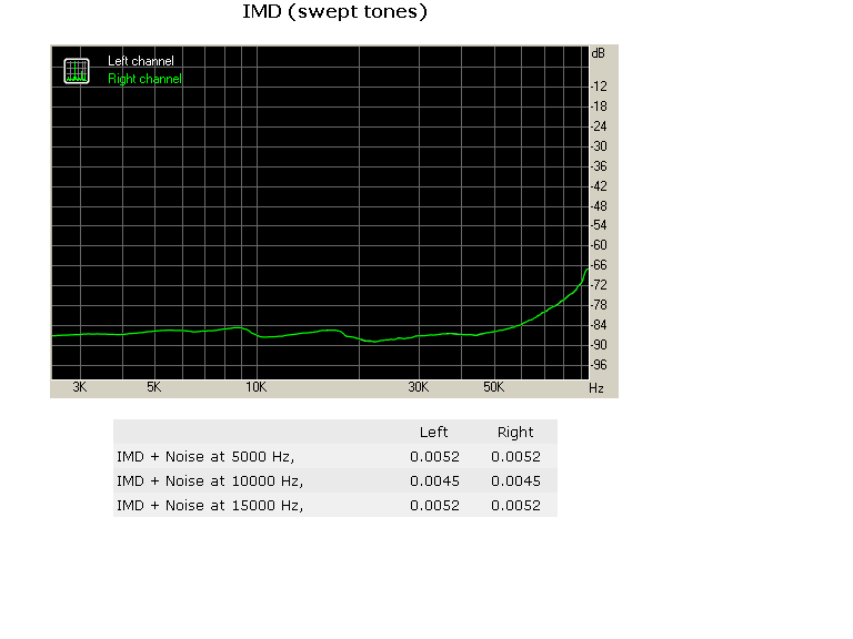

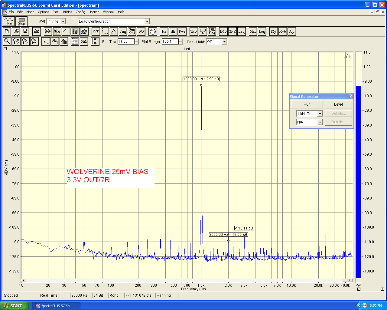

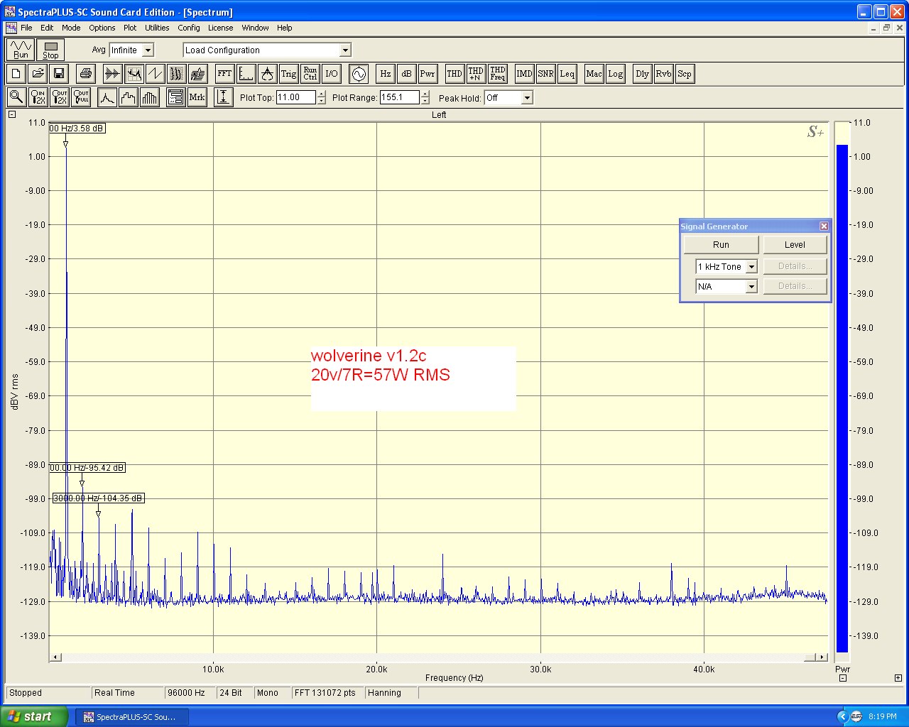

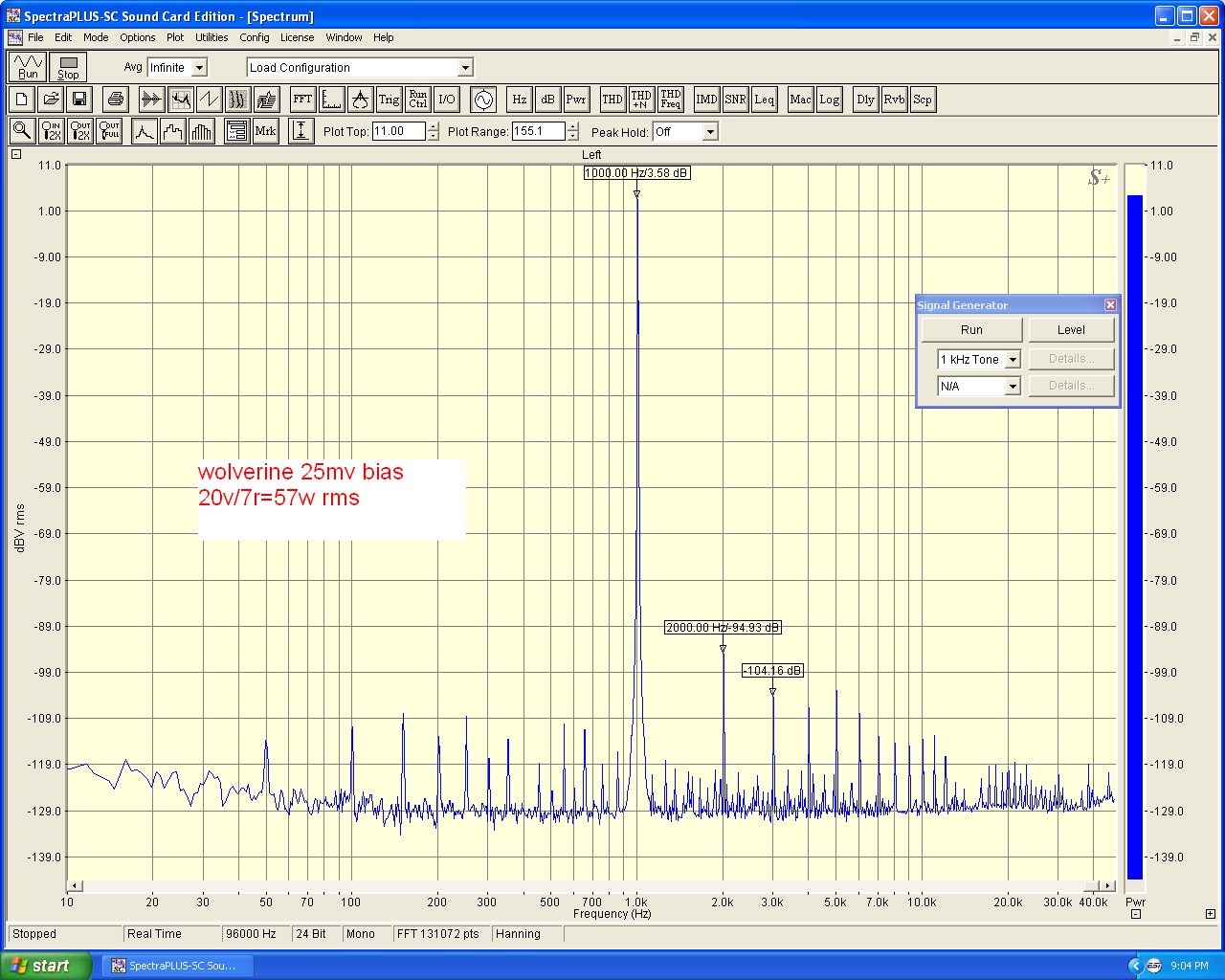

Frankenstein continue
Wolverine IPS+NS OPS
