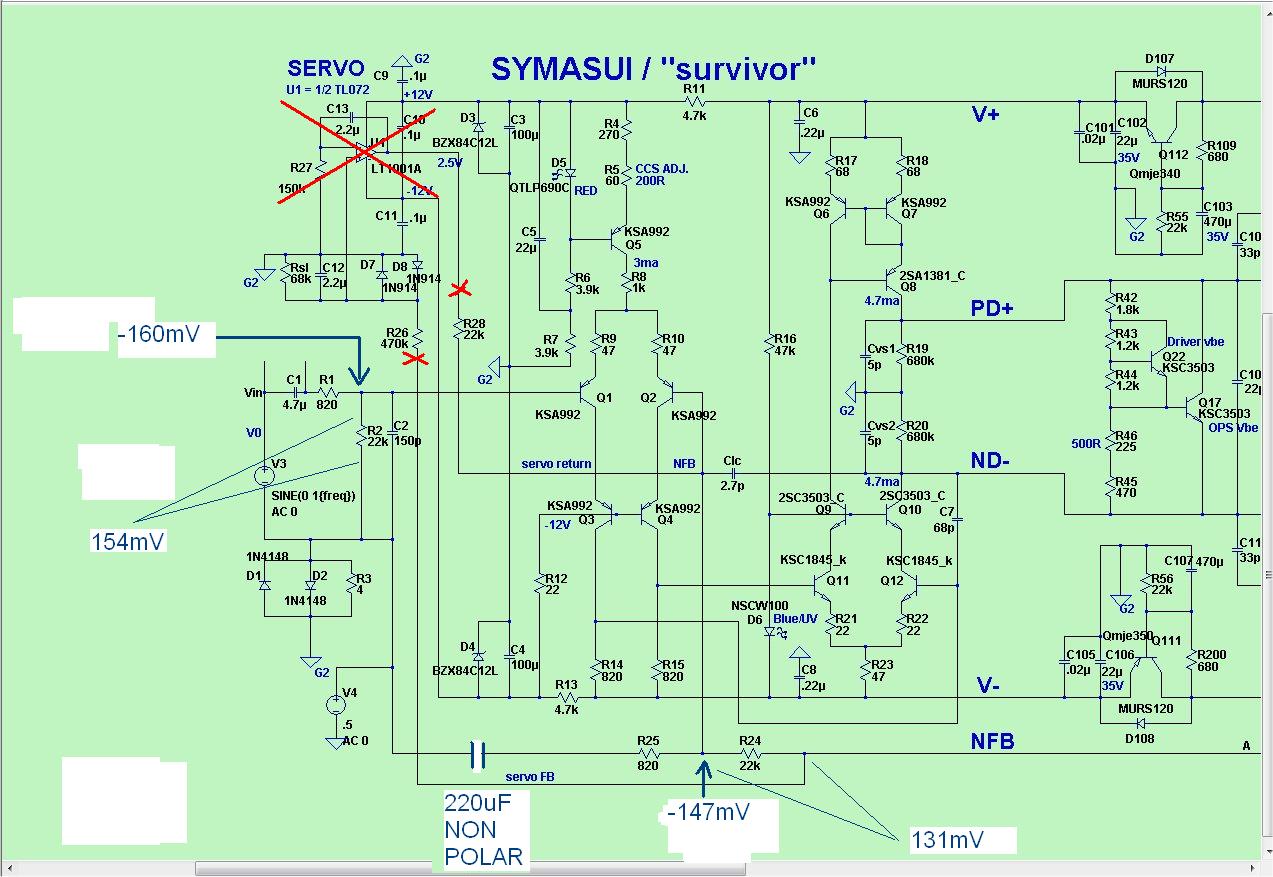

No, there is something else that is causing the need for this excessively high correction signal. Disconnect the servo and investigate.
This already done.(servo disconnected).
Offset without servo is 2.5mV.

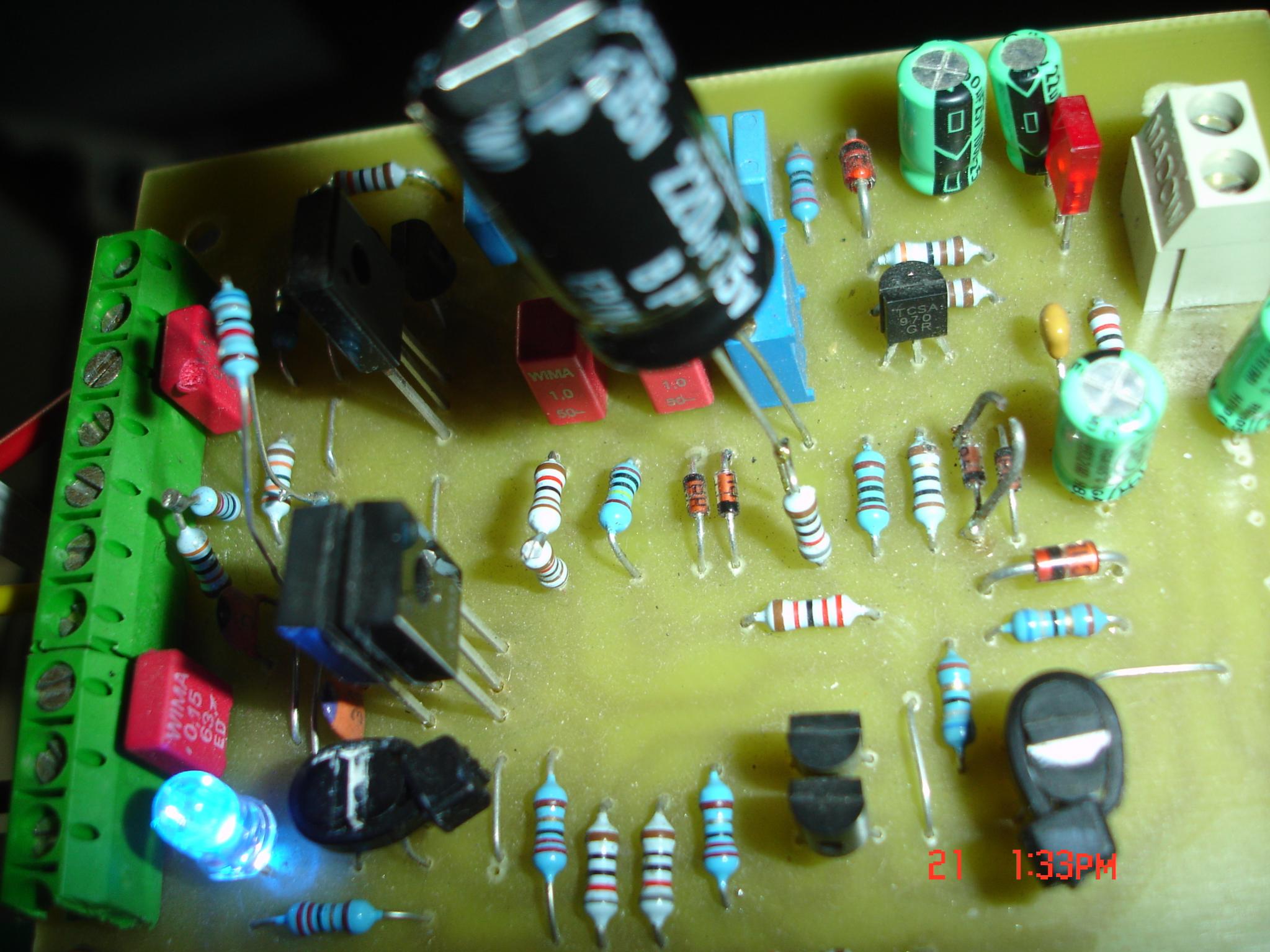

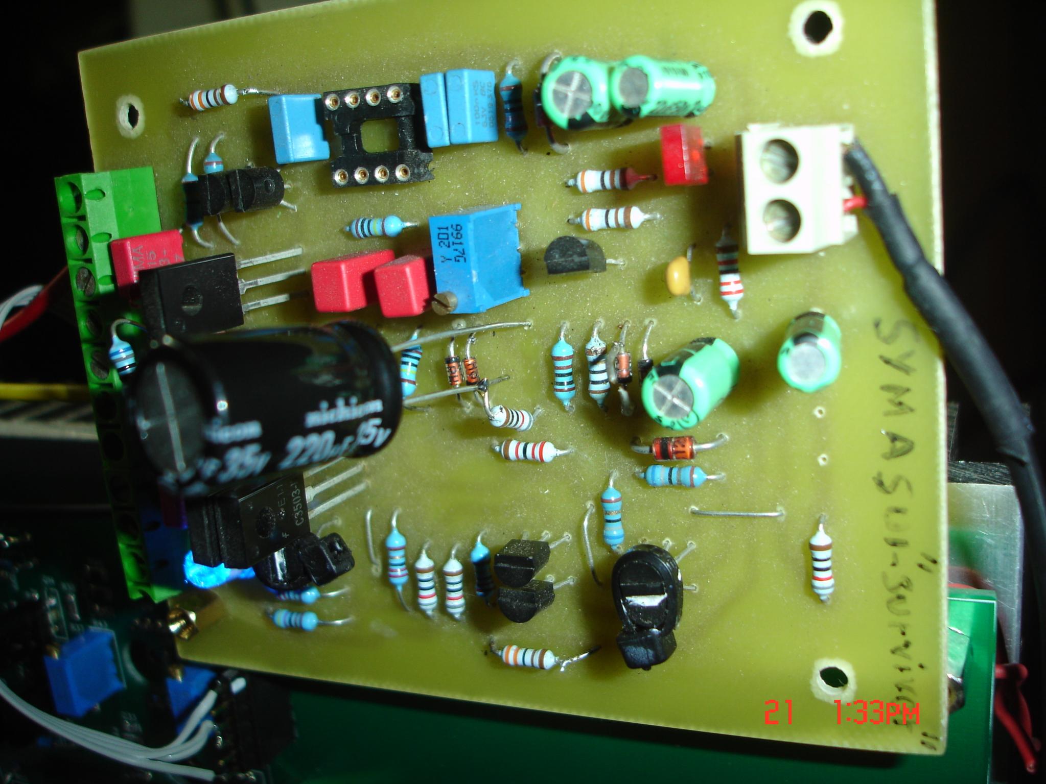

Likely if you were to see the whole schematic, OS would have a voltage applied to the NFB signal in the simulation to test the servo. The initial offset needs to be coming from somewhere.
If you look at the design, the input transistors would balance out if a pot was installed between R8, R9 and R10 to trim offset.
The original sch in post1523 is correct, except for that high voltage and the need for 1:1 resistors to apply that big correction.
The revised values shown in post1553 is not good. It appears to have fudged component values without curing the cause that requires the high correction voltage.
What are the voltages at those nodes and across those resistors?
AnderewT that is.

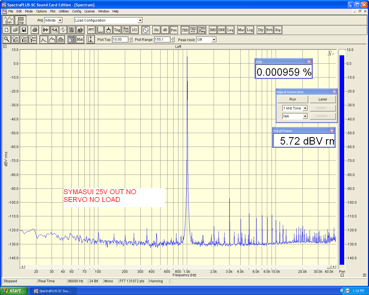

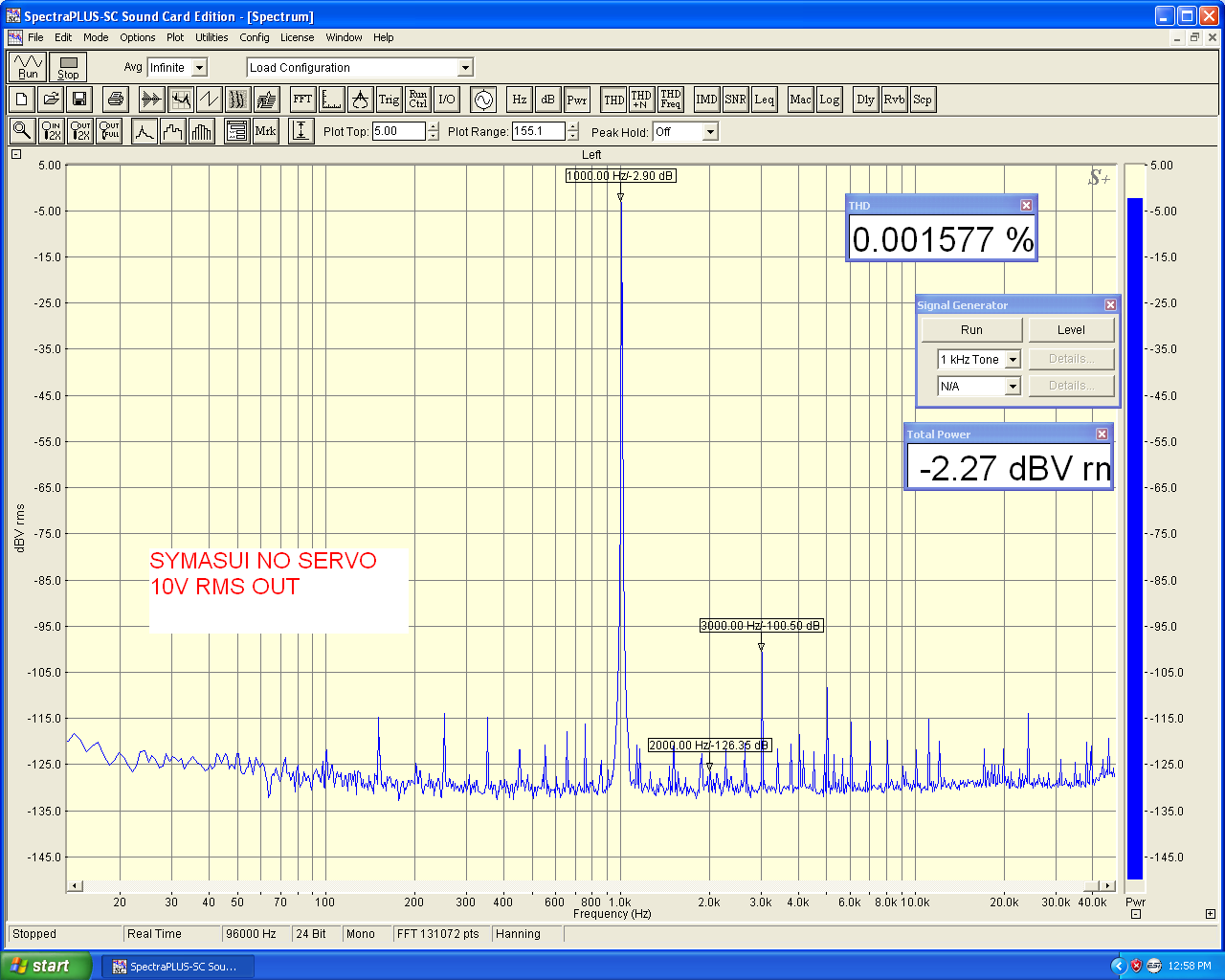

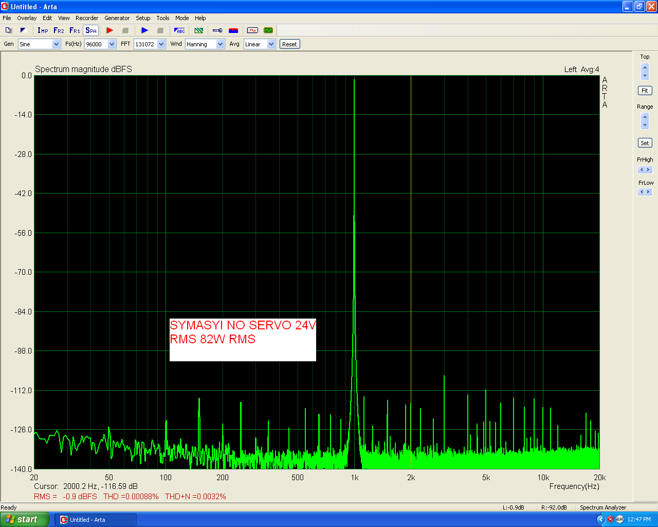

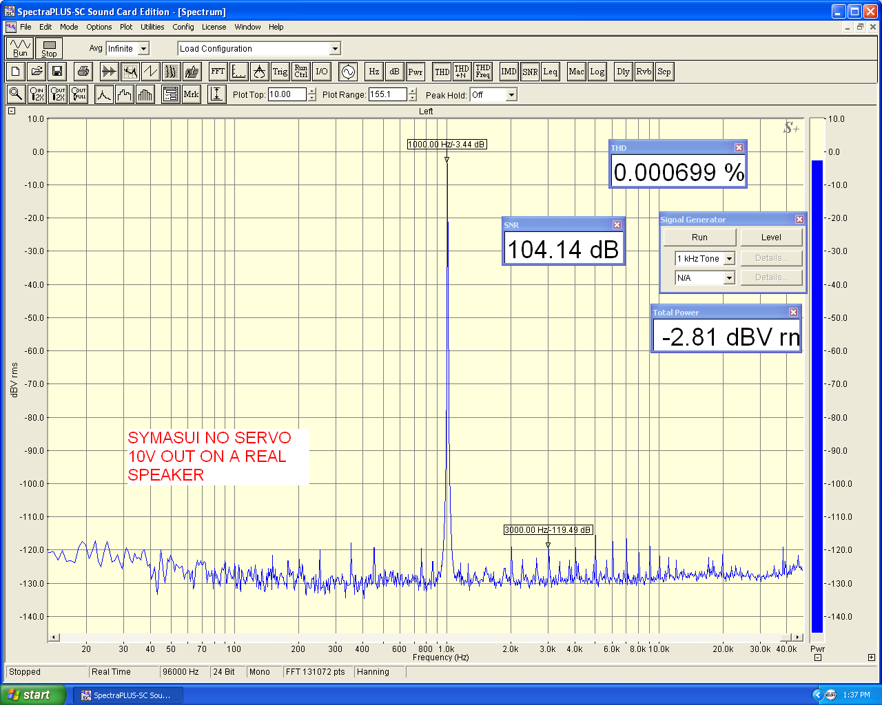

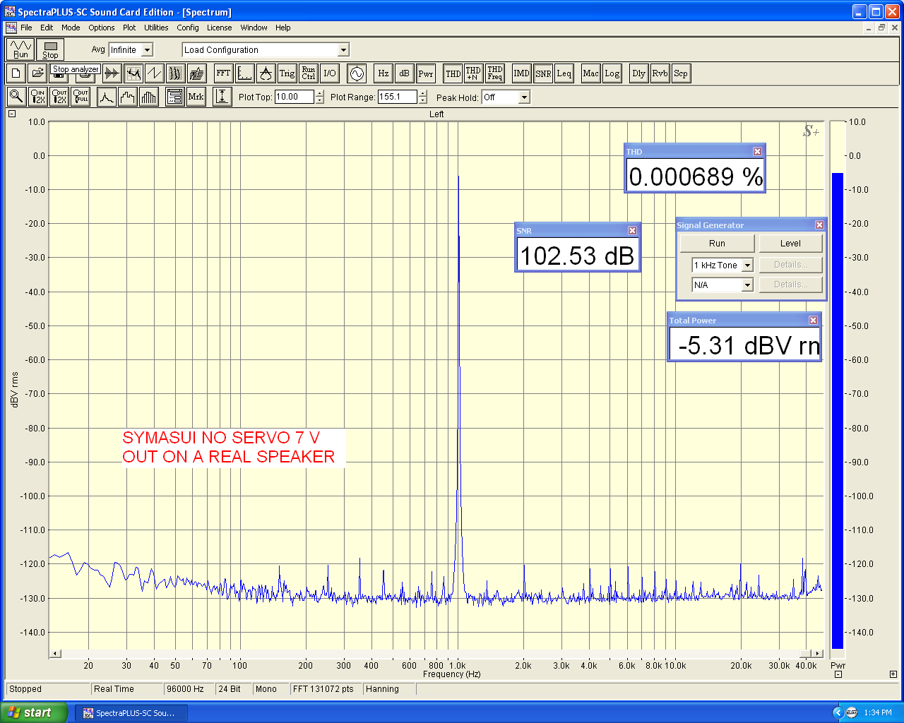

Jeff, without servo offset goes to 2.5mV instantly!

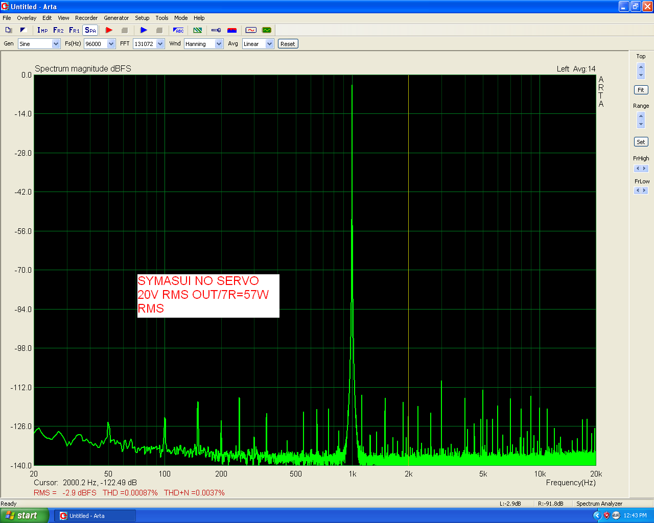

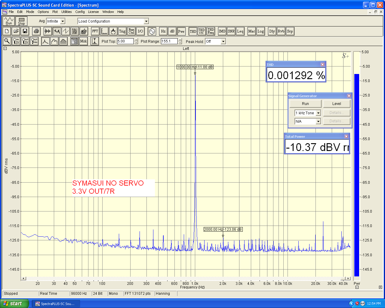

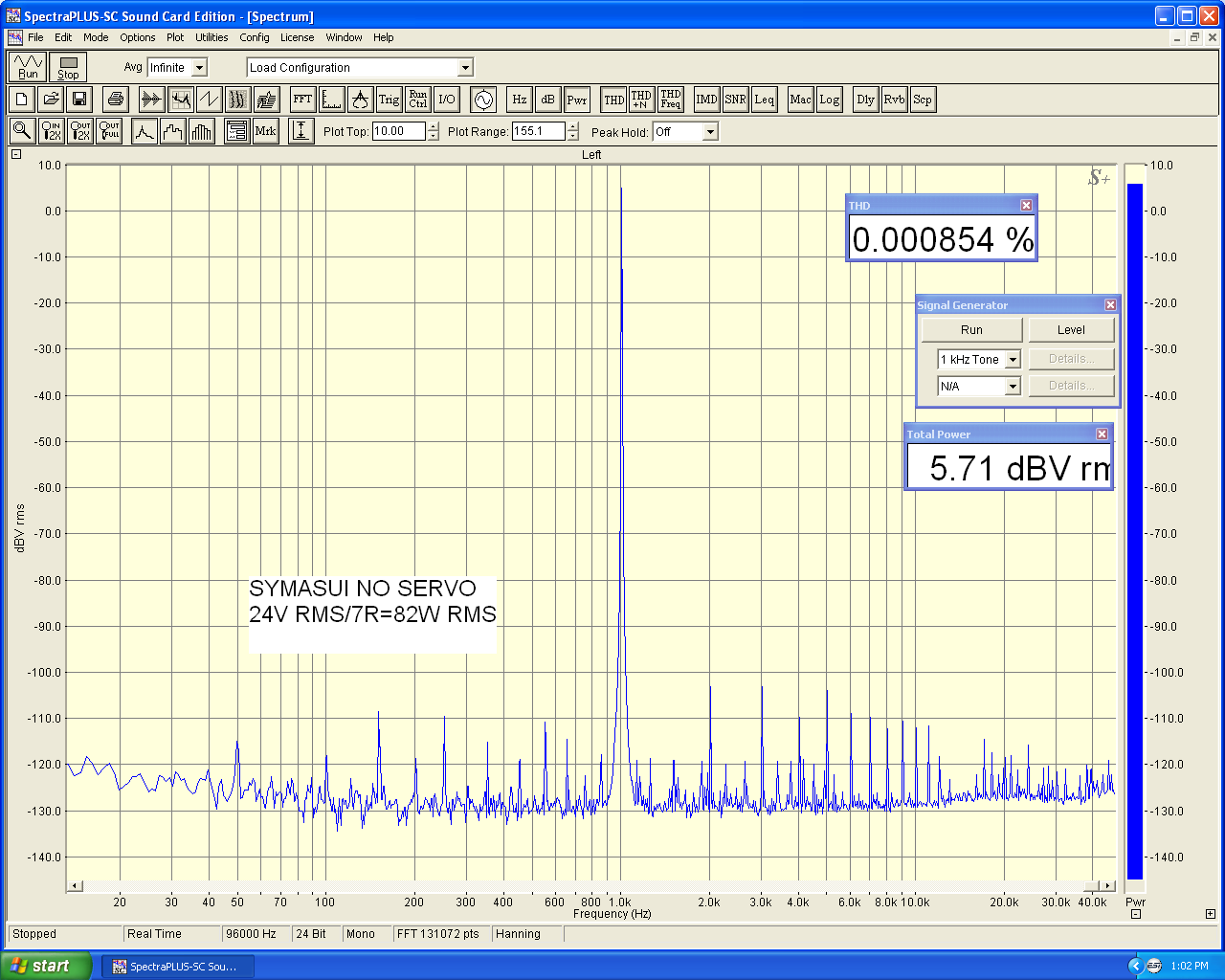

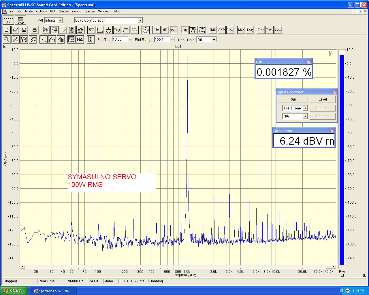

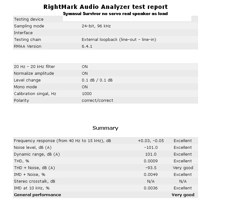

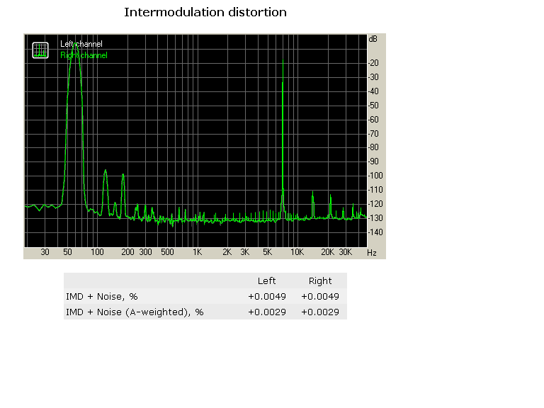

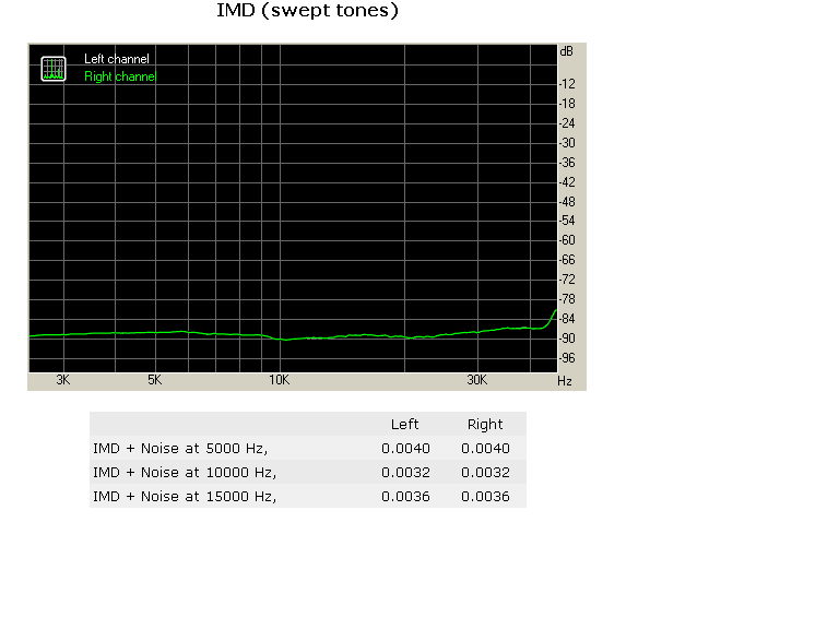

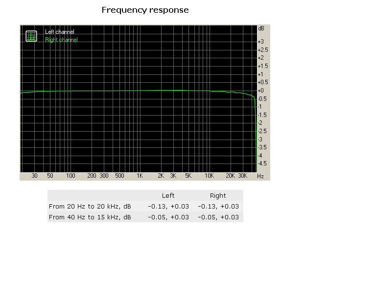

Testing Symasui Survivor+NS using RMAA
RMAA test Report.

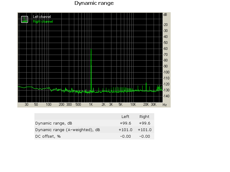

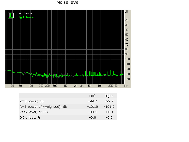

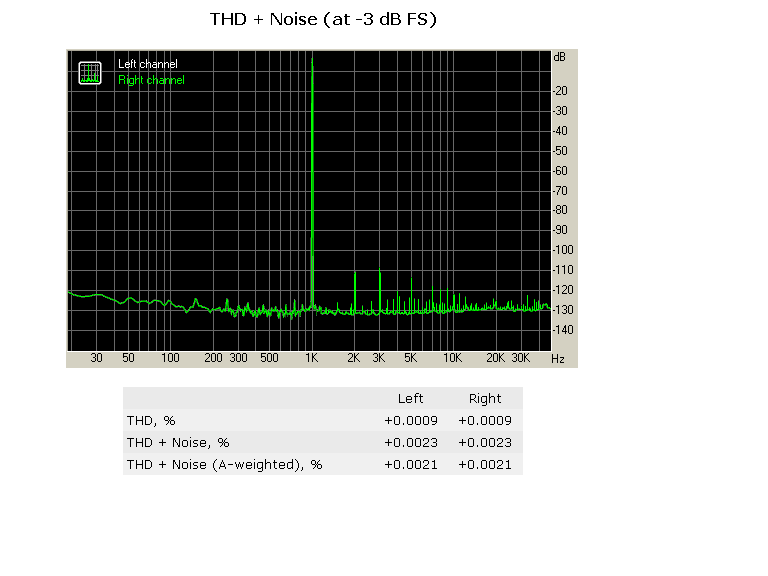

-160mVdc at the input node cannot be right.
It should be a +ve voltage, because the base current comes from the +ve supply through R2 to Signal Ground and thence through R3 to Power Ground.
Check the voltage @ R3, looks like it is ~+3mVdc reference the Power Ground and 0.0mVdc reference the Signal Ground.
3mV indicates 300uA flowing from Signal Ground to Power Ground. This could be adjusted to be quite a bit less, but I don't know how it varies with temperature. Worth checking when cold, warm, hot.
Same error for the -147mVdc voltage.
