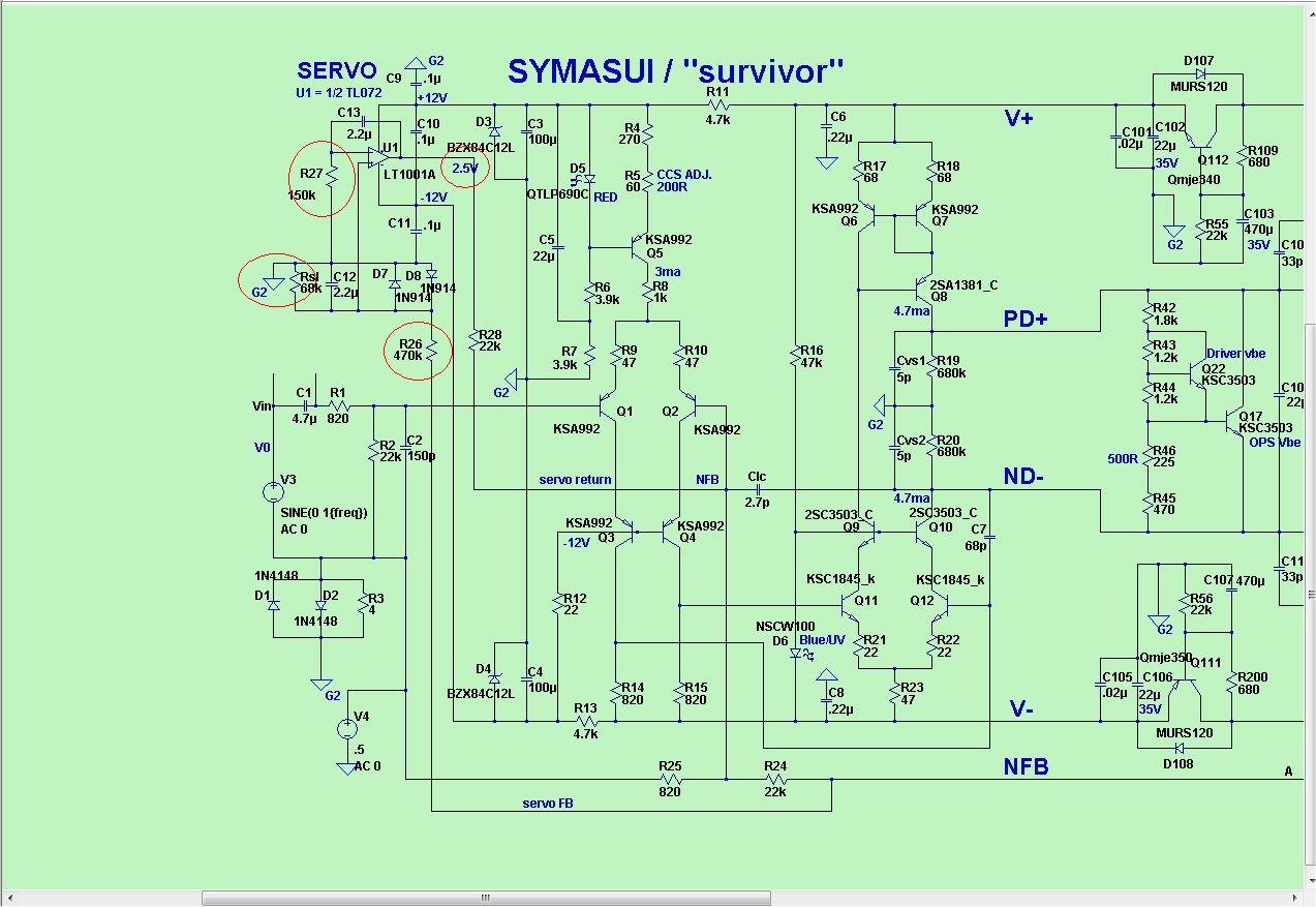

Trying to make the offset settle time shorter i see that decreasing the R28 value has as result a higher distortion .
My first try with 5k6 in R28 position(servo out).
Then with R28=10k.
Last changeR28= 15k.

Yes Jeff,AndrewT,i have measure the servo out.It is 3v using R28=22K.
2.5v using R28=10K.
Using 22k the amplifier start from 3 v d.c out and go to zero after about 10''
Using 10k the amplifier start from 2v d,c out and go to zero after about 5''.

That tells us that there is something wrong with the amplifier or with the servo.
Remove the servo opamp, or lift it's 22k.
compare the voltages at the two INPUT nodes i.e. R1 & R2 node and R24 & R25 node.
These voltages should be very close.
Pete's prototyping schematic shows 4v on offset out,see post #1523.
That high voltage is what alerted me to there possibly being a problem.
The current through the two bases of the input pair should be the same.
Those currents pass through their respective resistors, R2 & R24. (my calculation indicates ~6 to 7µA)
The voltage drop across both these resistors should be the same.
That means the voltages at the +IN and -IN should be the same.
But clearly with 2V to 4V appearing on the -IN something is not fitting with that model.
disconnect the servo and look for where the problem is.

Well, when there is 4V at the integrator's output, voltage at -IN is much lower, because of the divider. However, if there is more than 100mV at integrator's output, it always makes me worrying - something in the circuit is pretty much dis-balanced.
The closet to zero the offset is set with no integrator, the faster the whole thing will settle with the servo in place.
Schematic in post #1528 is a little different(other resistors values)and shows 2.5v on offset controller out.
