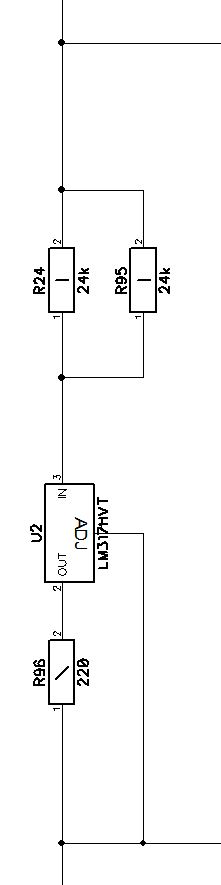

I would add a 2-pole CCS to R24 || R95 - I already have it designed, based on LM317 regulator - see attached.

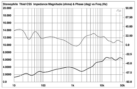

Luckily, the speaker's impedance falls down to that low level (if it does at all) at the low frequencies (below some 200-300Hz).
A good example is Thiel cs5i - a sophisticated five-way, six–drive-unit, having two 4-ohm drivers in parallel in the sub section (below 50Hz). So, we see the 2-ohm load in the range, where low-impedance-load performance is the best. Nice 😎
P.S. Thiel cs5 impedance curve is taken from Stereophile test measurements.
Bottom line is impedance, top (dashed) line is phase.
Serious stuff, demanding a "tank" amplifier 😉

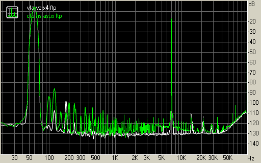

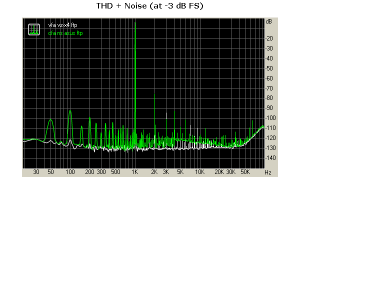

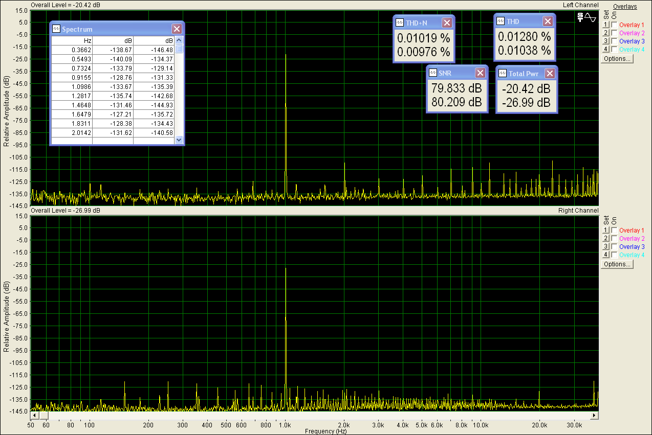

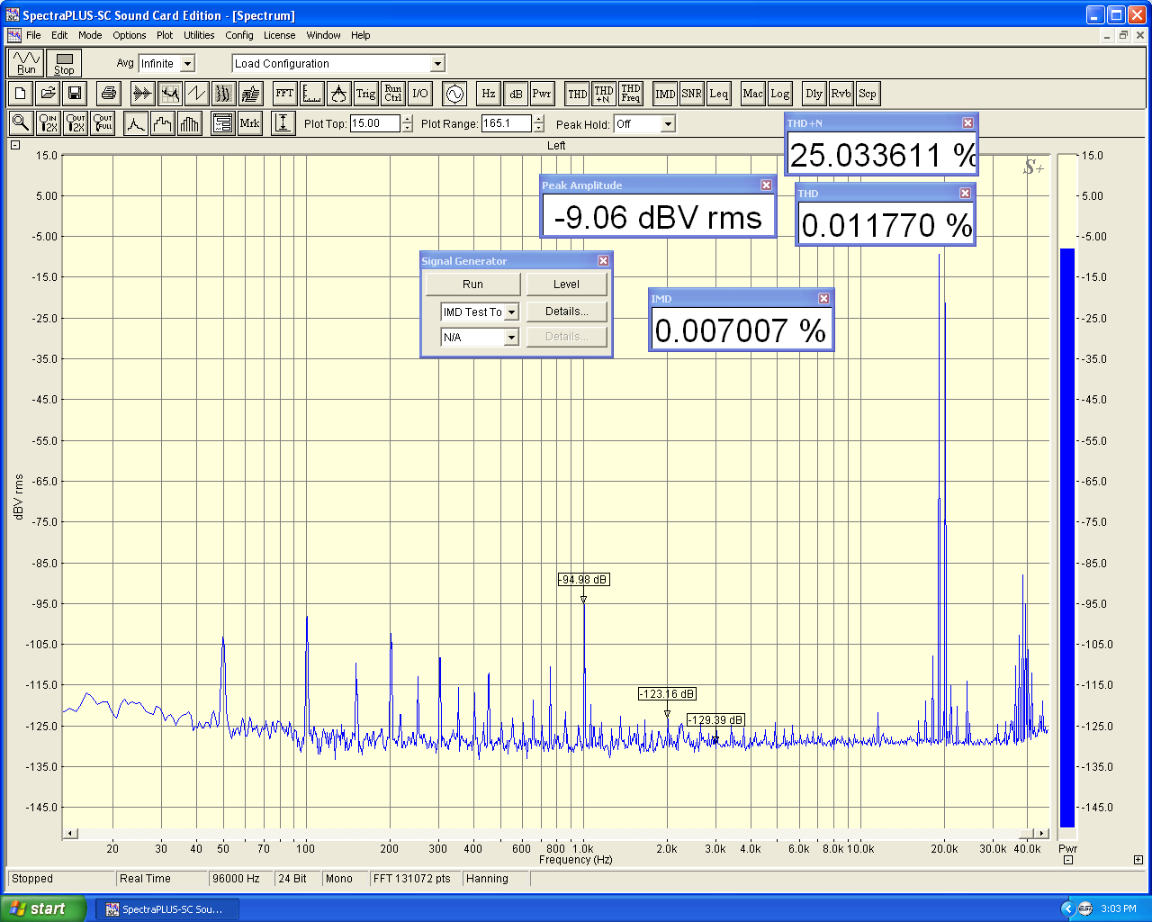

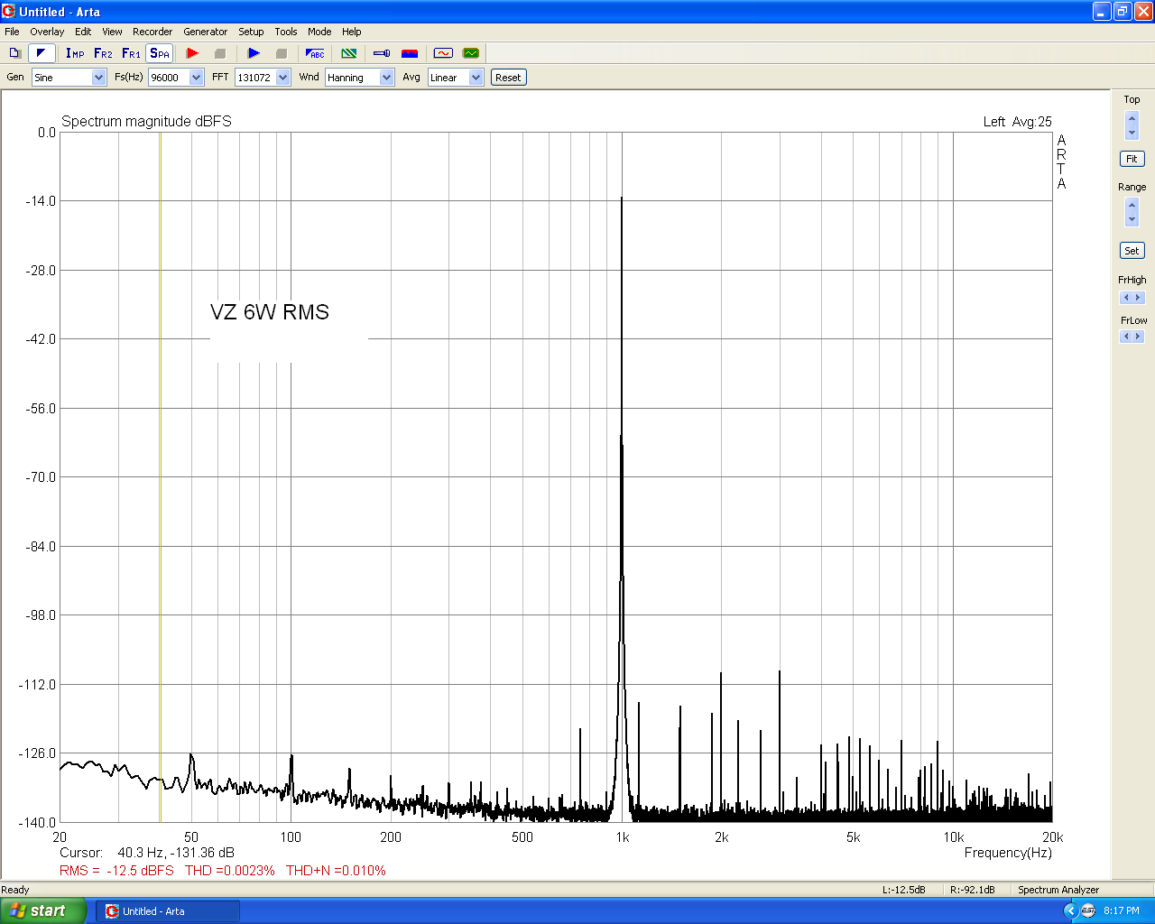

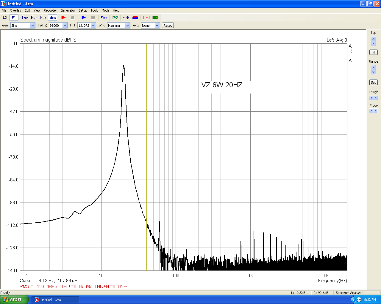

EsiJulia on Asus Mobo
A little more clear results using an Asus motherboard.

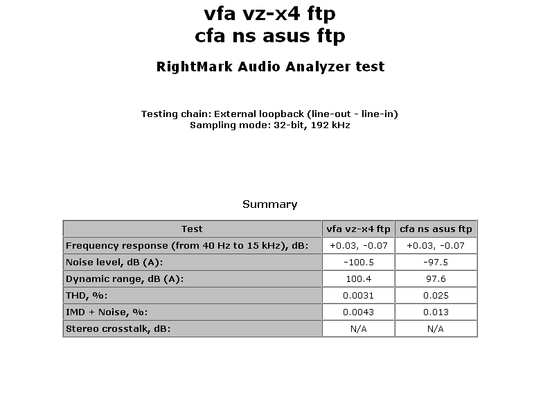

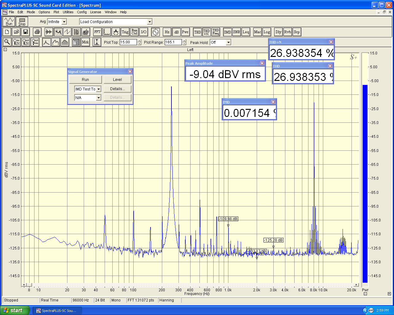

Here is a comparision between vz and cfa
Interesting... looks like there is some grounding issue with CFA front-end.
Because of the low-impedance feedback network, CFA has got no ground lifting - maybe this is the reason for such a big 50 /100 Hz components difference.

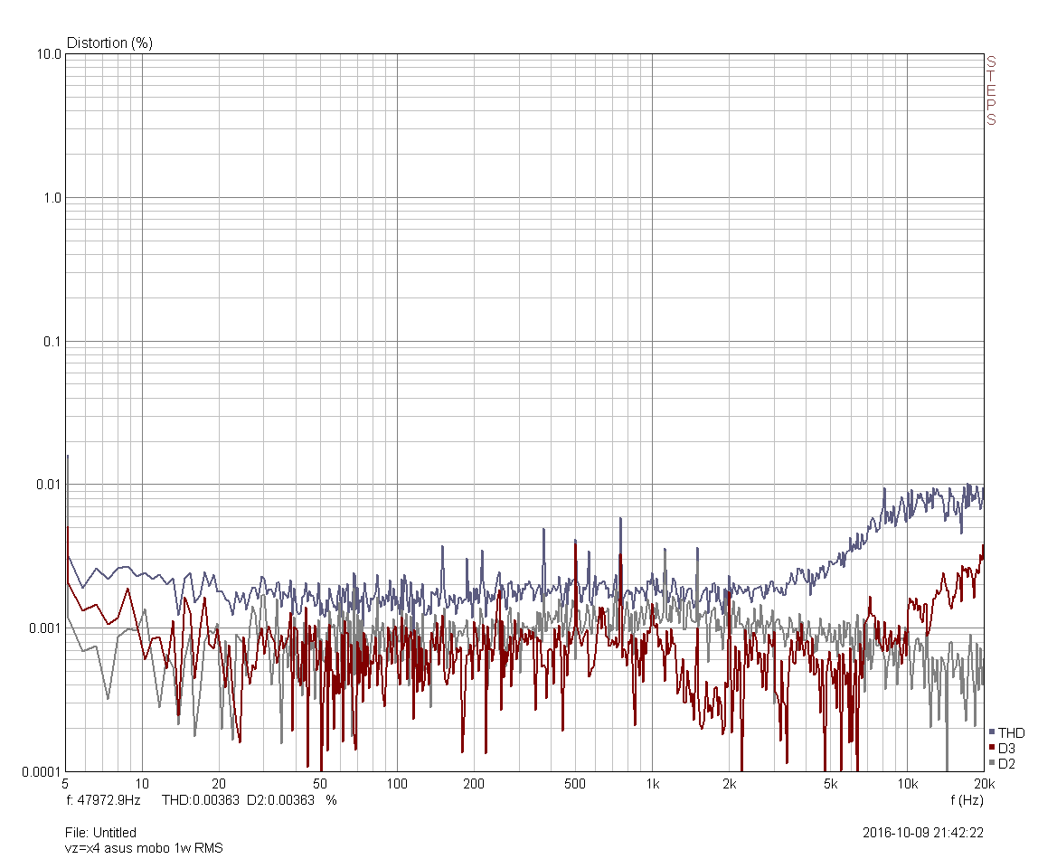

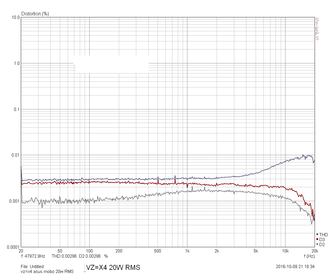

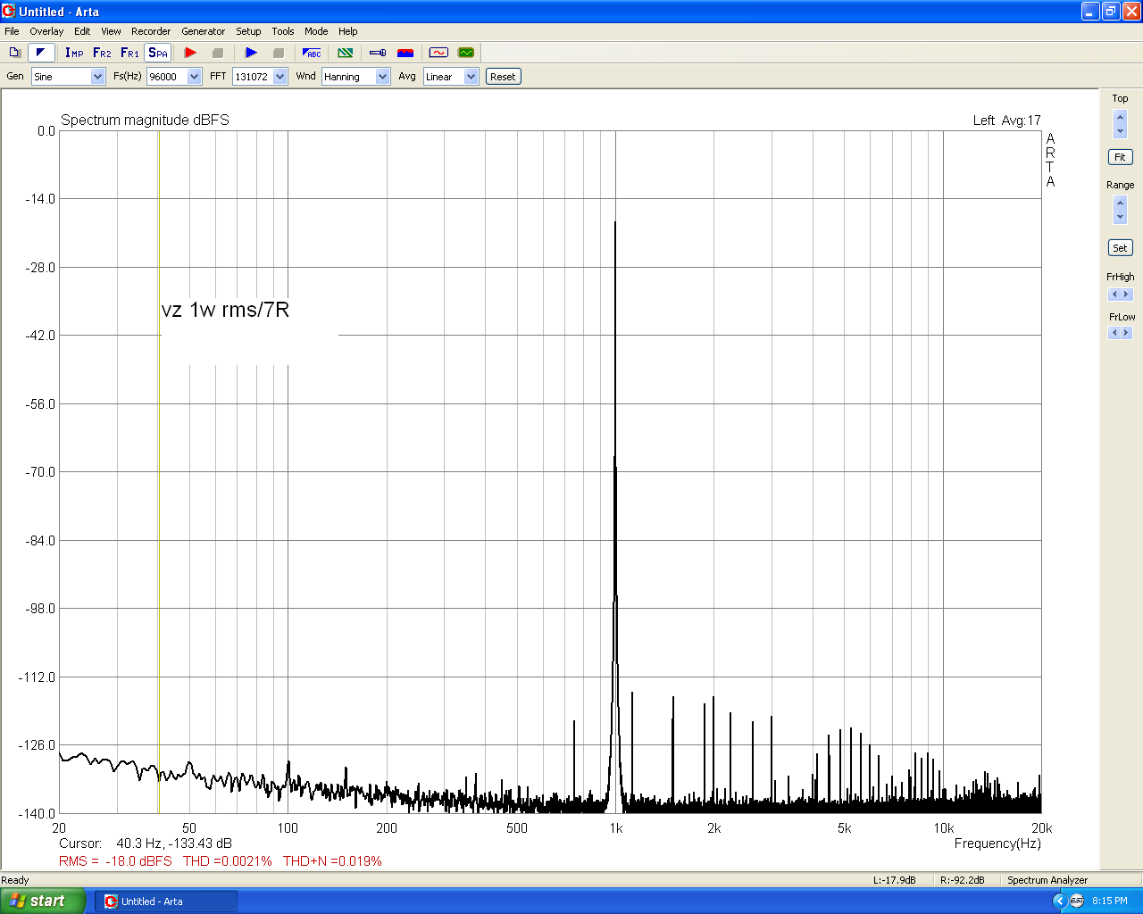

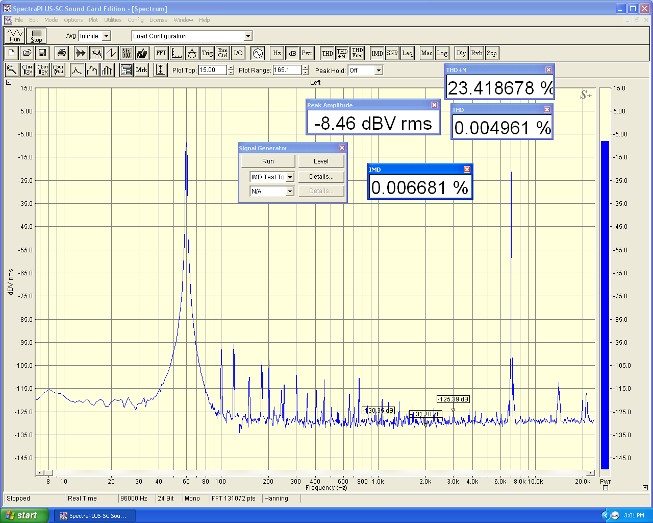

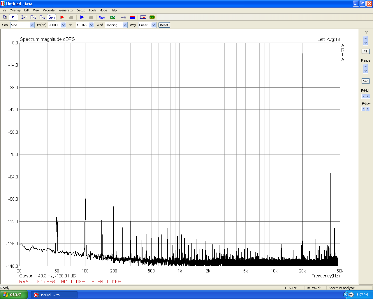

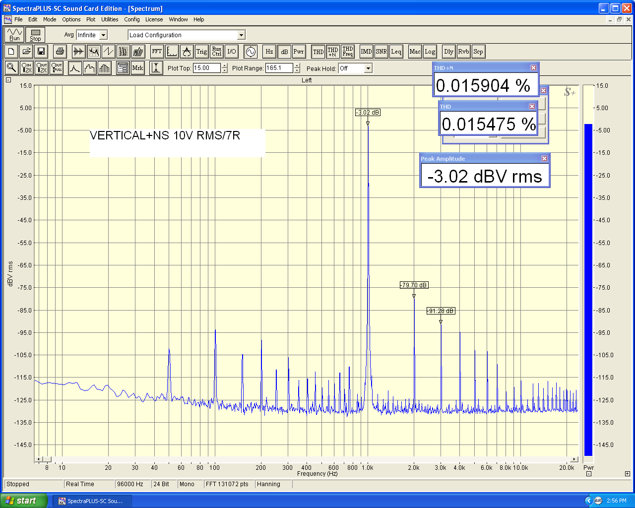

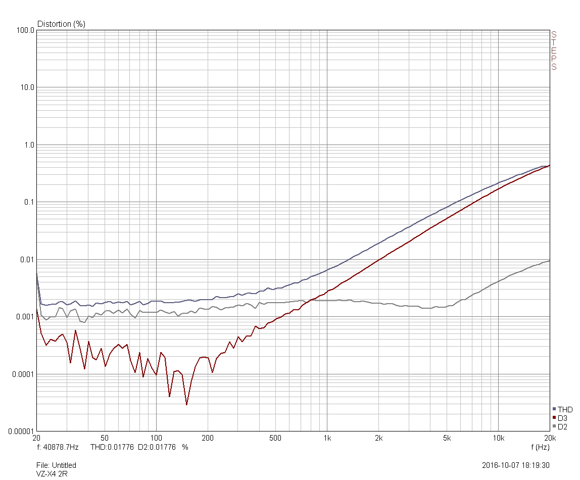

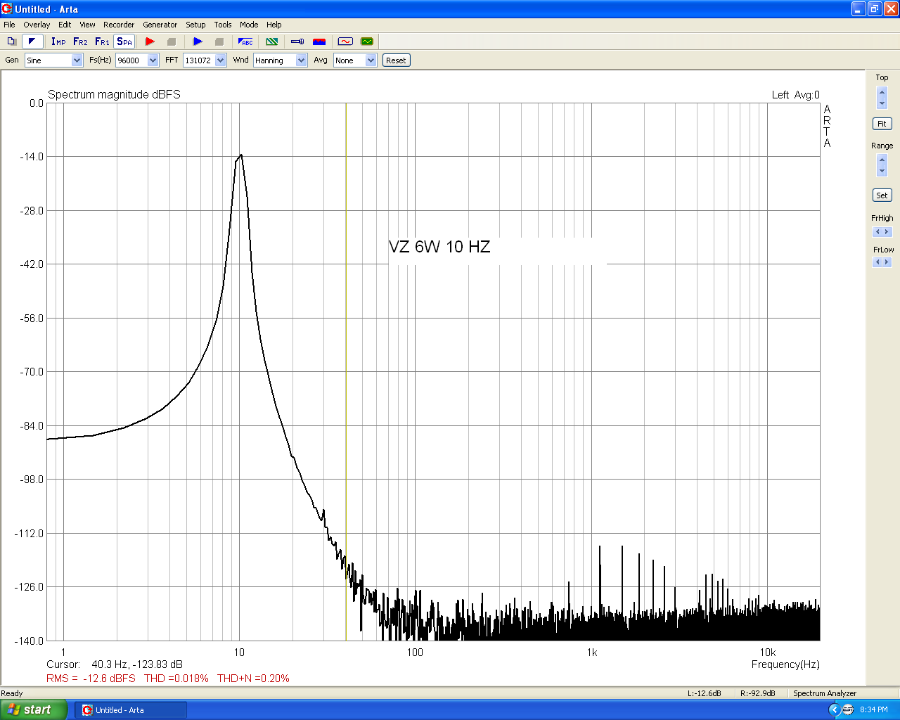

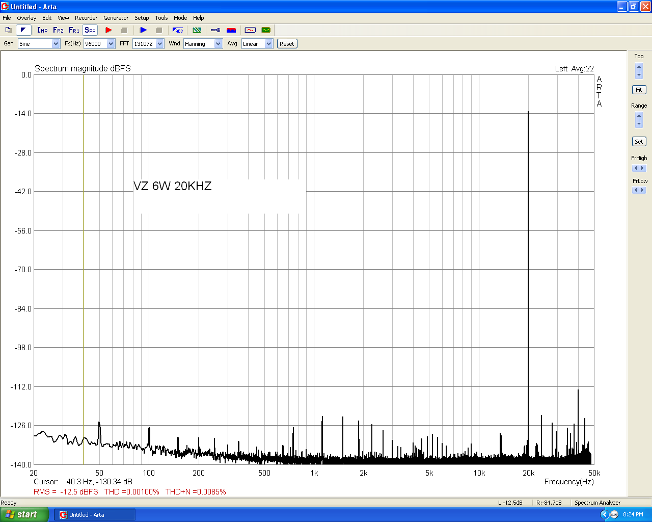

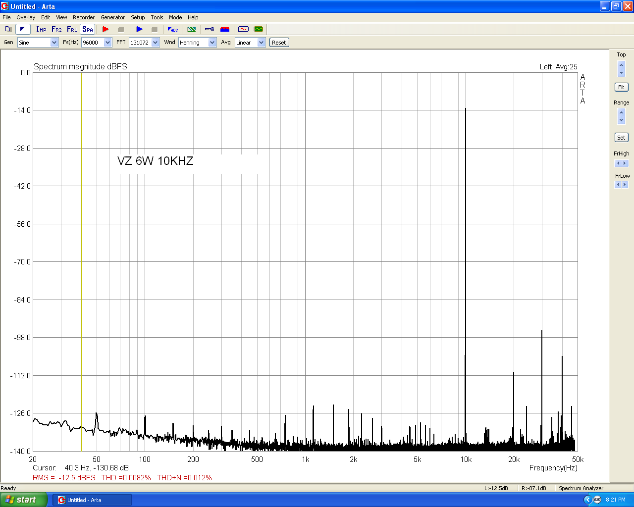

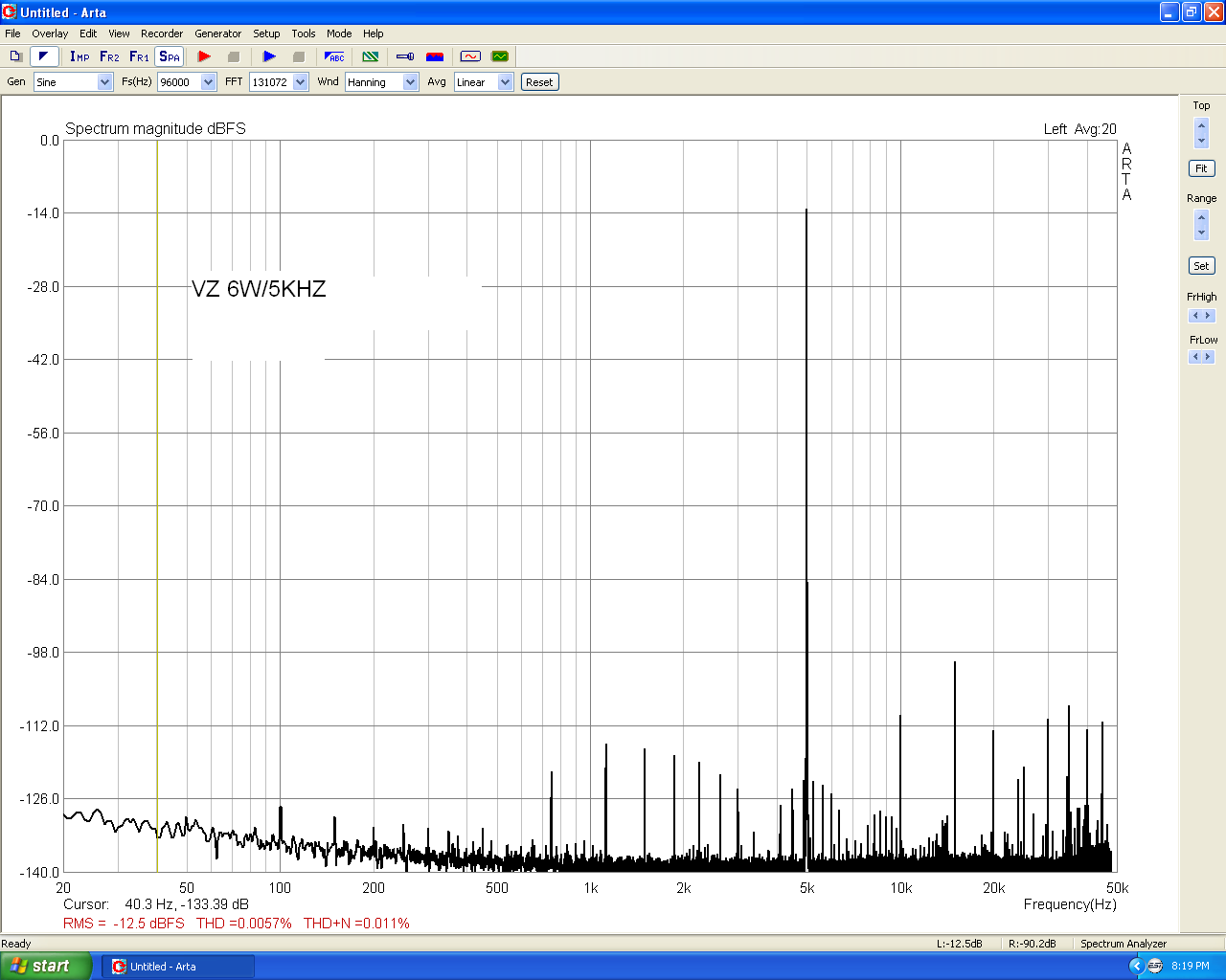

VZ-X4 distortion at different frequencies
Using ARTA.
Using ARTA.

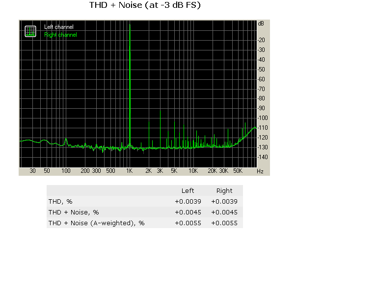

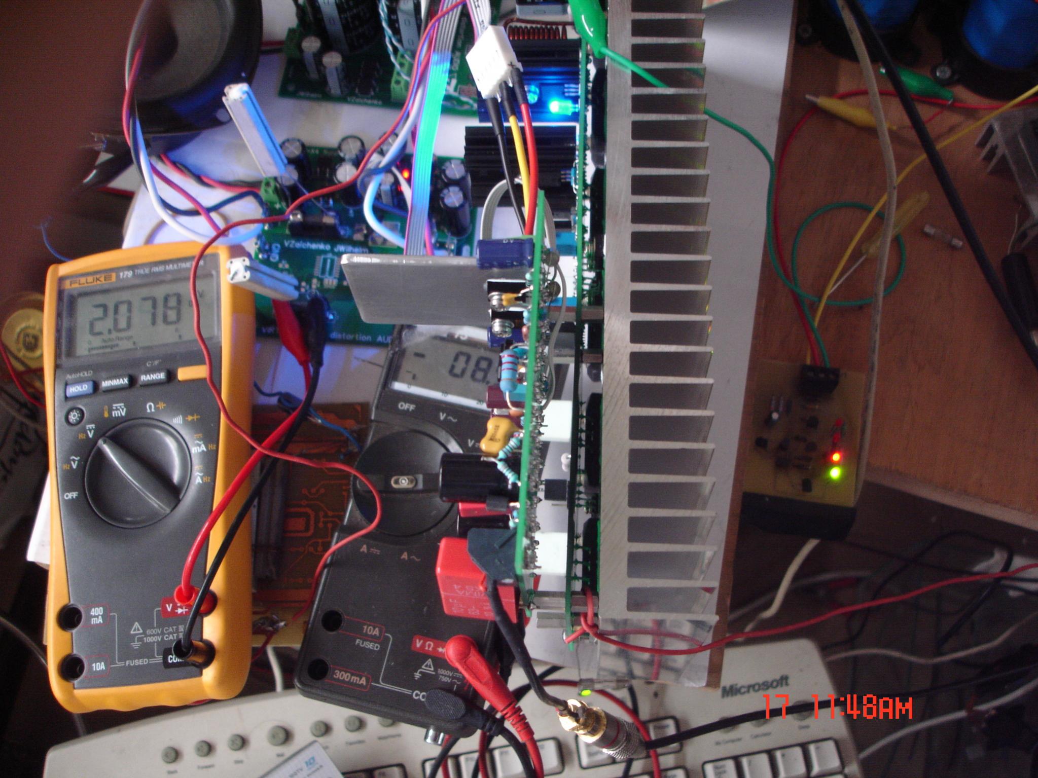

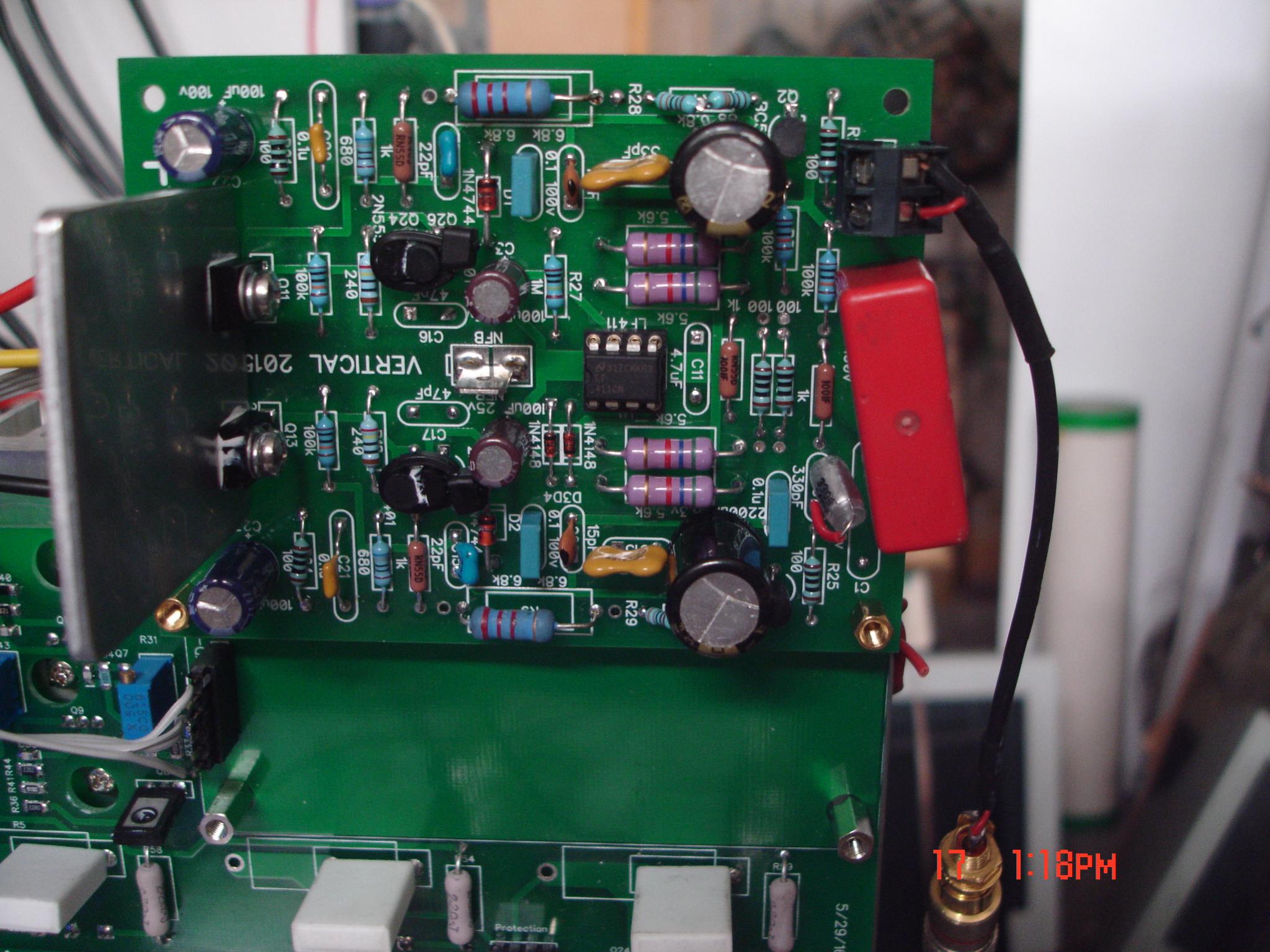

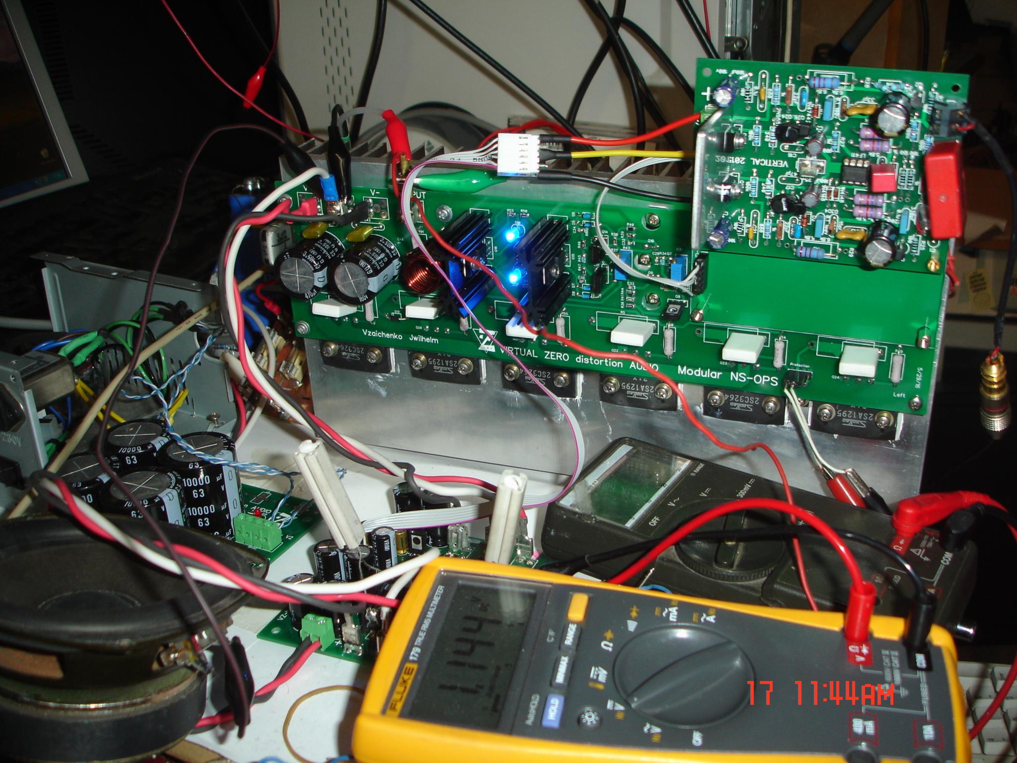

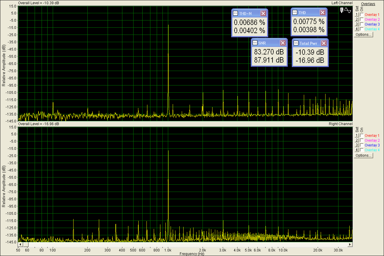

Ns OPS together with the Verical IPS.
Huh! )) 1-st generation IPS with last generation OPS ))

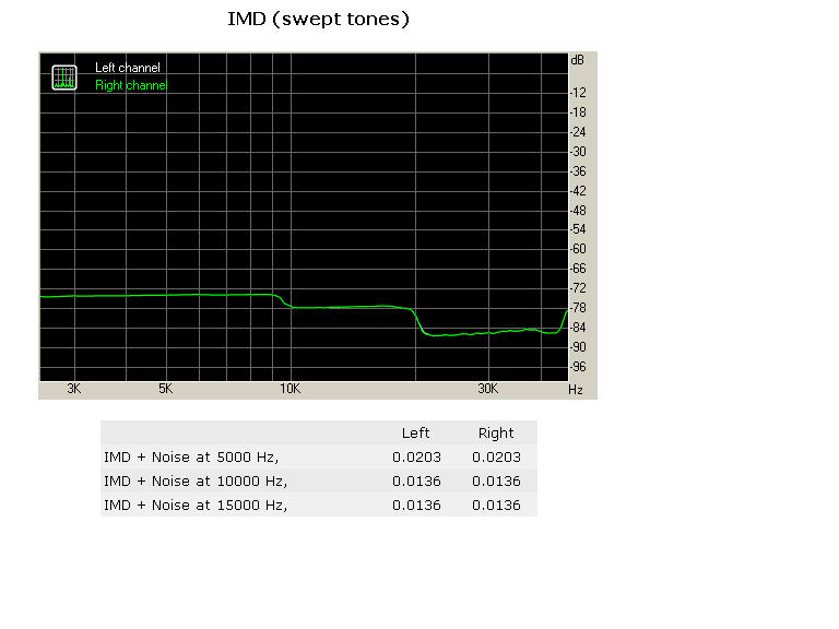

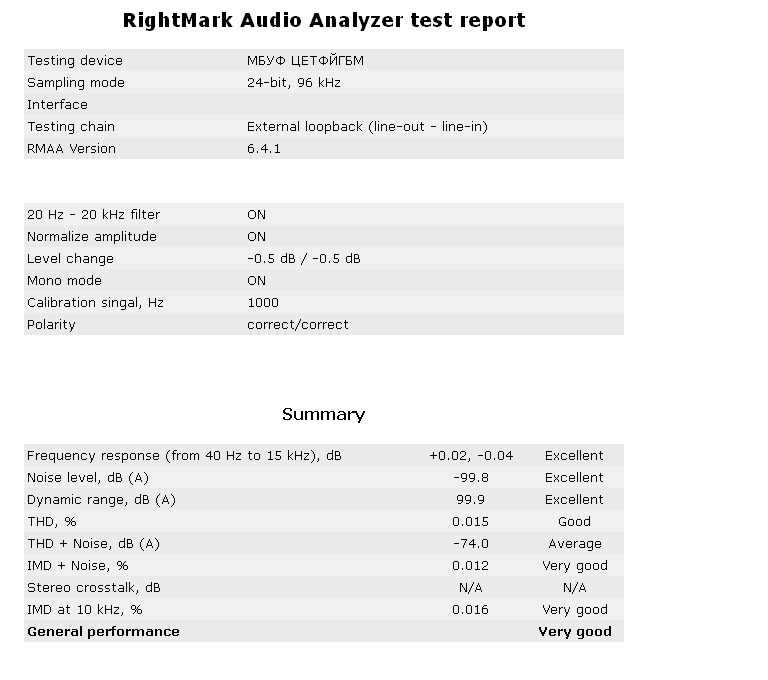

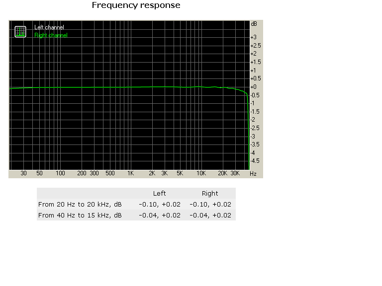

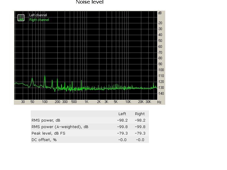

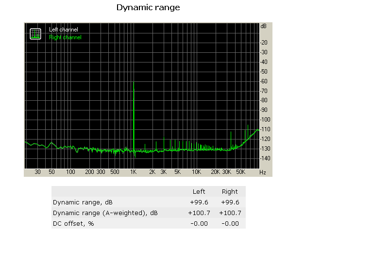

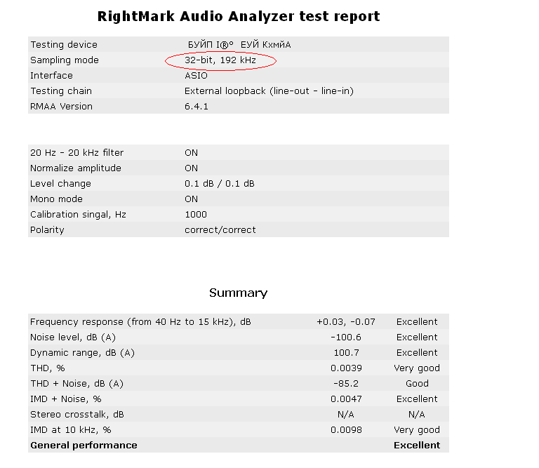

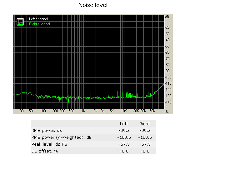

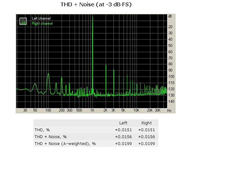

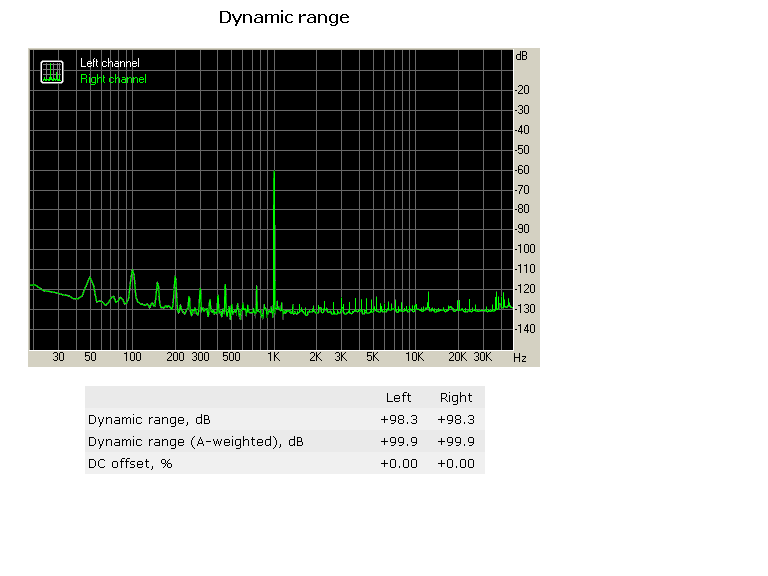

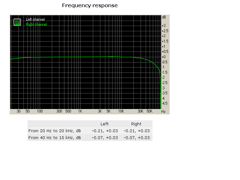

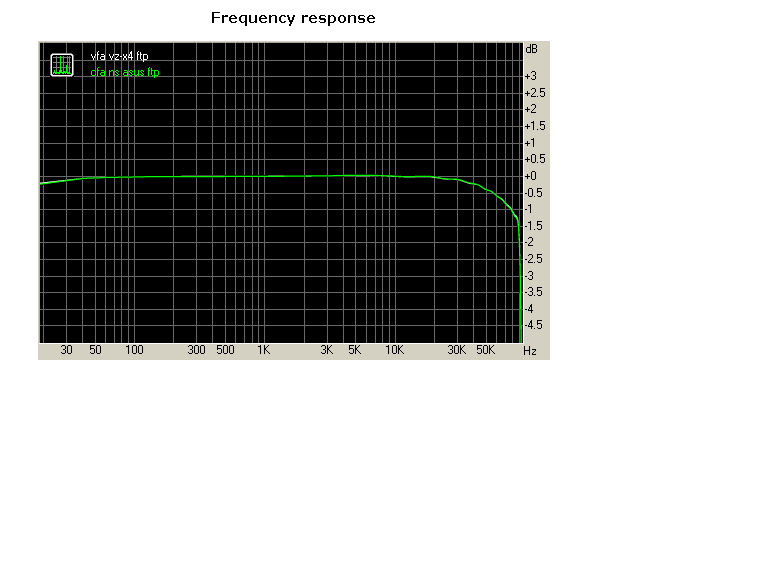

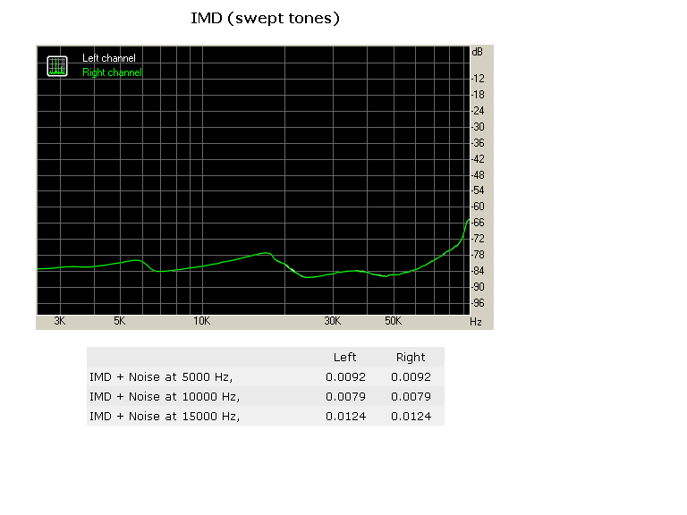

Using RMAA

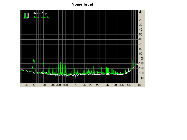

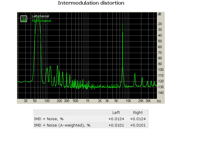

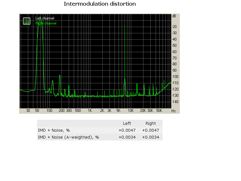

Jeff, please can you explain further this?It'll be interesting to see if the open input noise is still present.
What you want to test?
The first version of the Vertical CFA boards with the big NS OPS board had a 50/60hZ noise when the input was left open. Is that noise still there with this output board?
So you want an fft test leaving the inp open, or you mean a test by ears?The first version of the Vertical CFA boards with the big NS OPS board had a 50/60hZ noise when the input was left open. Is that noise still there with this output board?
Just a quick listening test would tell if the noise is still there. Mine had a quite noticeable 60hZ hum when the input was disconnected, but went away as soon as anything was hooked to it.
