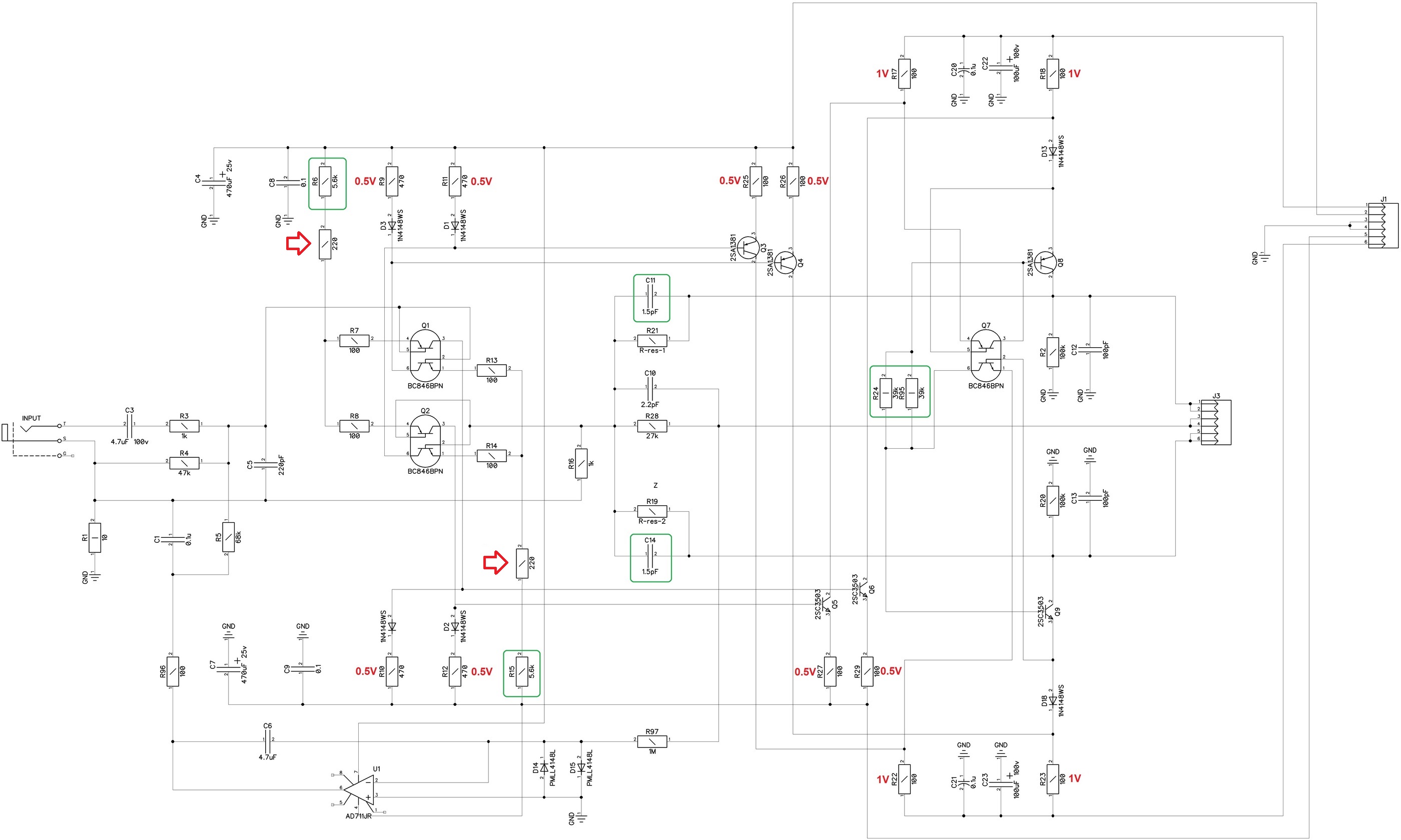

Do you mean that i must place two 5k6 resistors in series for eatch R6&R15?Looks excellent!
I think, we will add one more resistor placeholder in series with both both R6 and R15 - the optimal value would be some 5.8...5.9 Kohm - easier to add-up by 2 resistors.
It's pretty well-balanced by itself - only 56mV at the servo output, easy job for the servo.
Please post a draft schematic.🙂
I will make temperature measurements soon.
That's what I mean (red arrows) 😉
Ok got it.
Yes - light trimming of LTP currents, so that the voltage drop over resistors, marked 0.5V, becomes closer to 1/2 of the voltage drop over the resistors, marked as 1V (now it's roughly 0.6V vs 1V).
If we keep this as final modification it is necessary to modify the Vbe multiplier too.Yes - very good, I think.
Now the end of Vbe trimmer is nothing more than 21mV over 0.44R emitter resistors.
Temperature on four transistors is 47°c when room temperature is 23°c
Well, now the VAS output went a bit below 5mA.
We can either slightly tune-up R24 || R25 for increasing it back to some 5...5.5 mA.
Or - leave 5.6K, as you had before - it runs great anyway.
This is just a very fine tuning ))

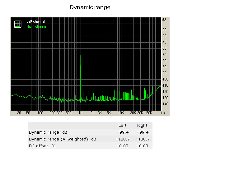

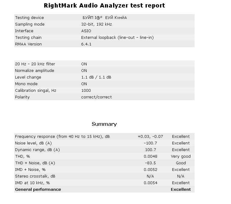

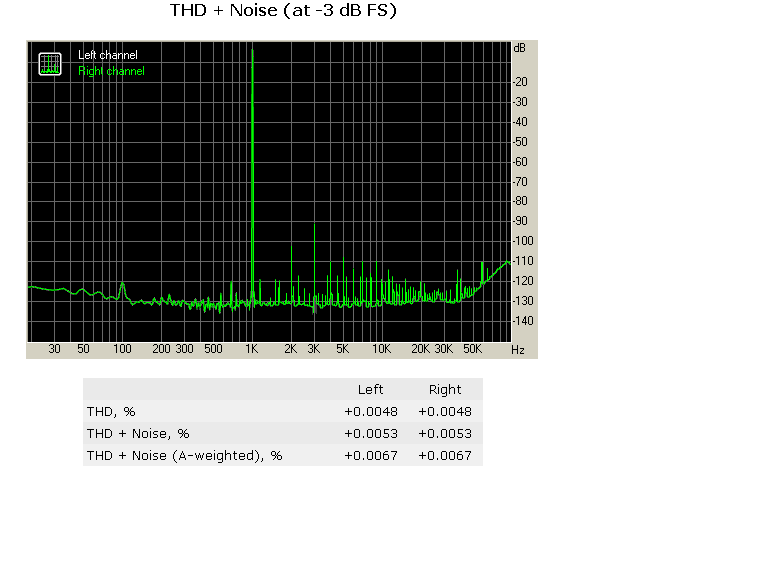

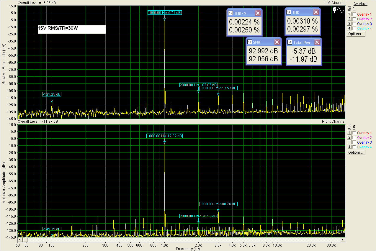

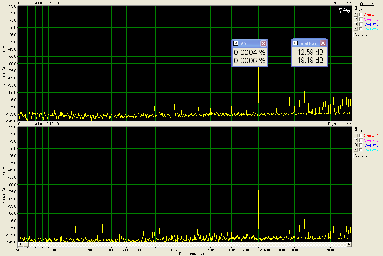

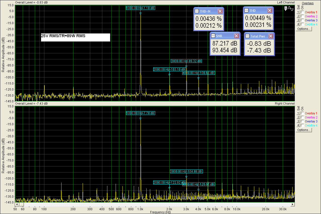

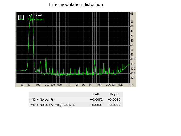

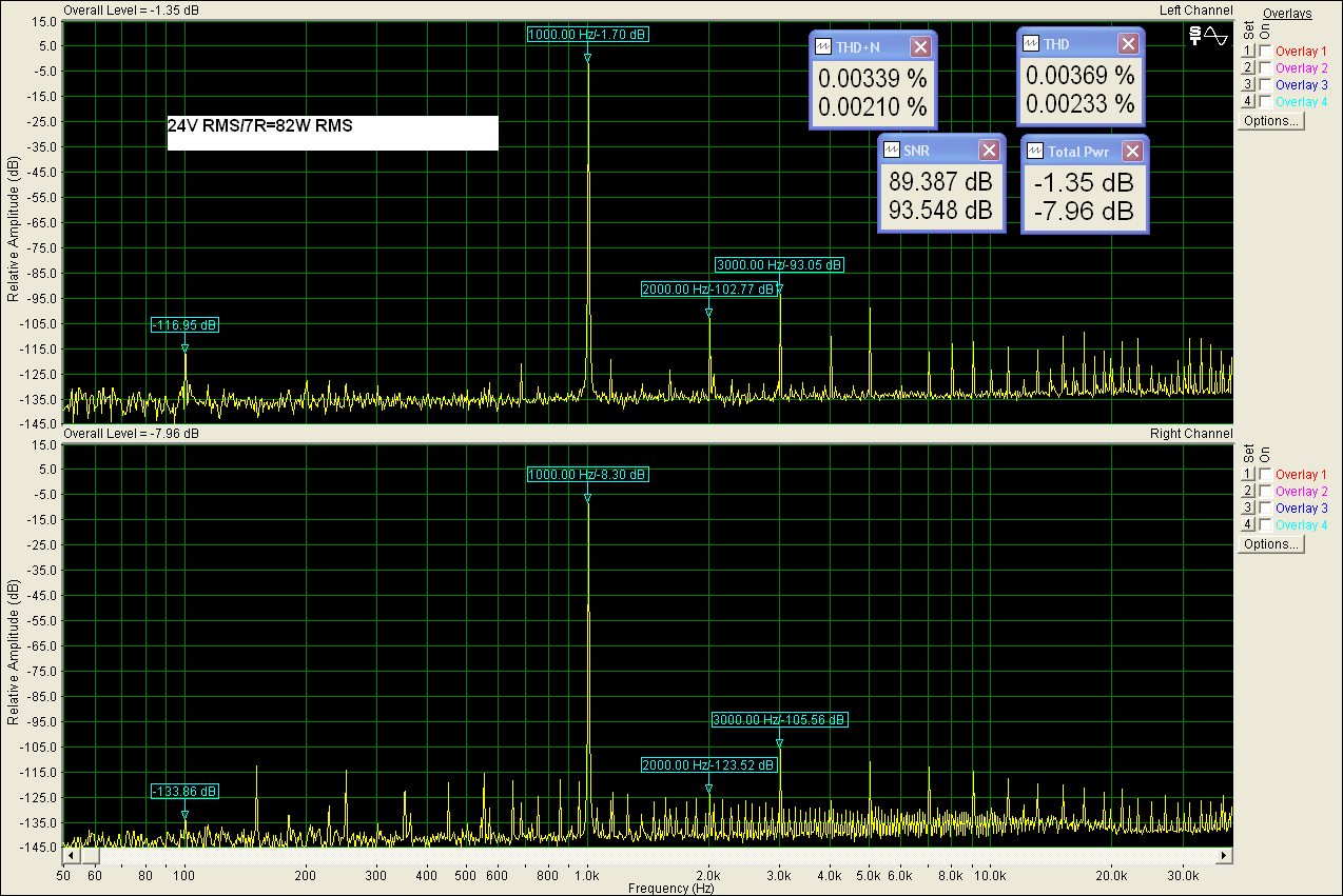

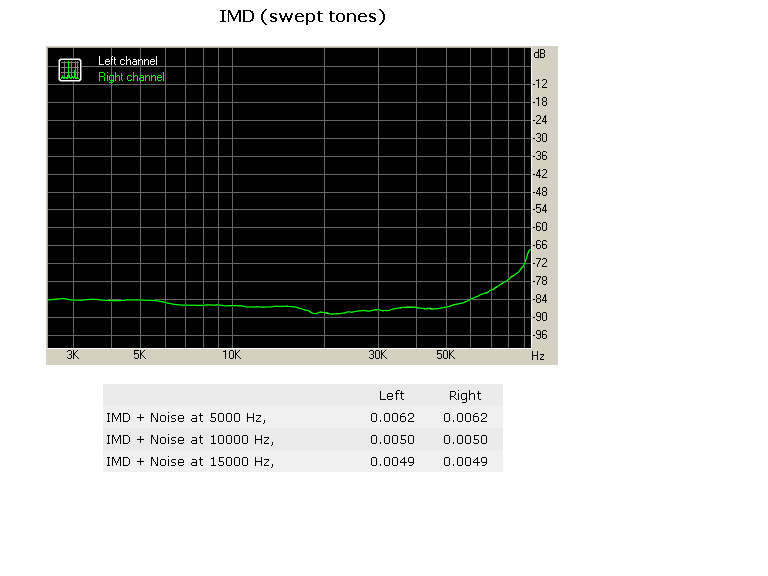

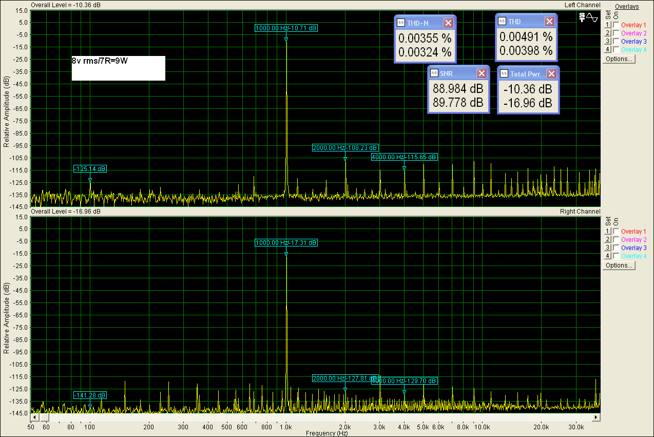

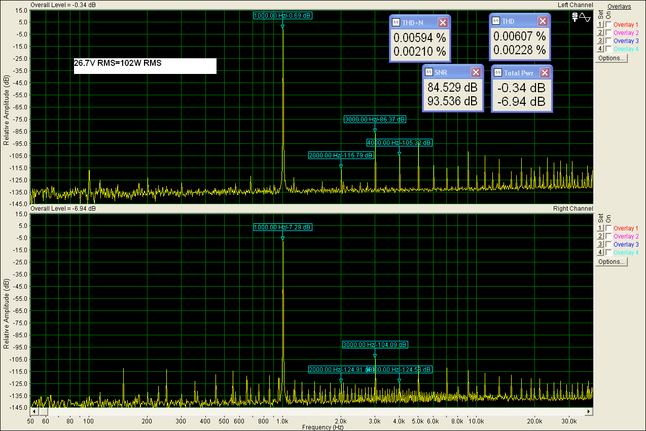

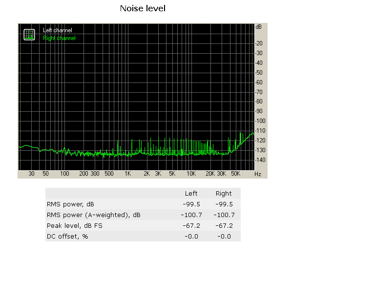

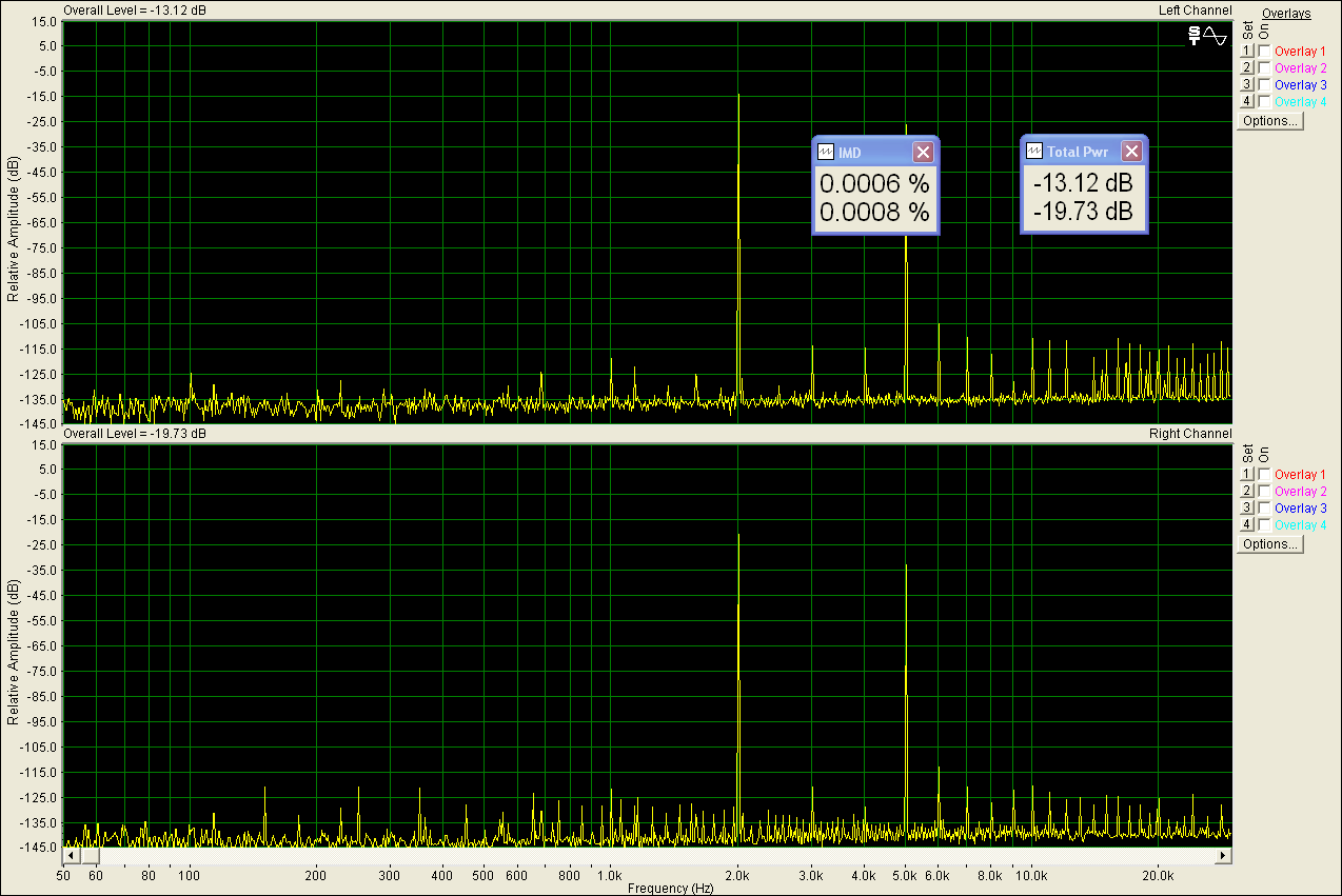

vz-x4 analyzed using RightMark Audio Analyzer.
Wow - RMAA is just what I have been looking for to measure my amps! Just need a good sound card.
This is like the "REW" for amps. 🙂

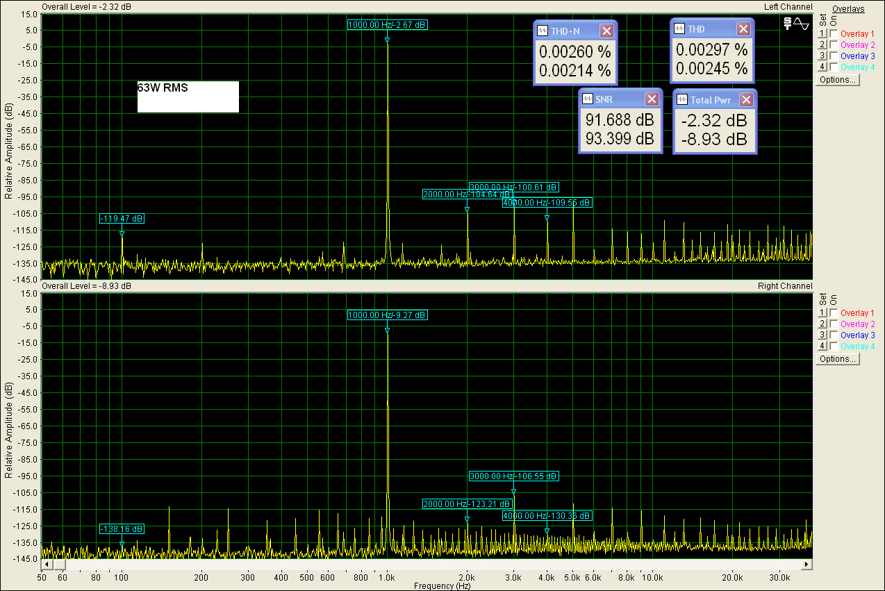

These look good! I don't see as much 50 or 100HZ noise on these ones. Did you try something new with your test equipment?
Still some noise components above 1KHz... however - better than before.
The board performance looks good!
Good catch!These look good! I don't see as much 50 or 100HZ noise on these ones. Did you try something new with your test equipment?

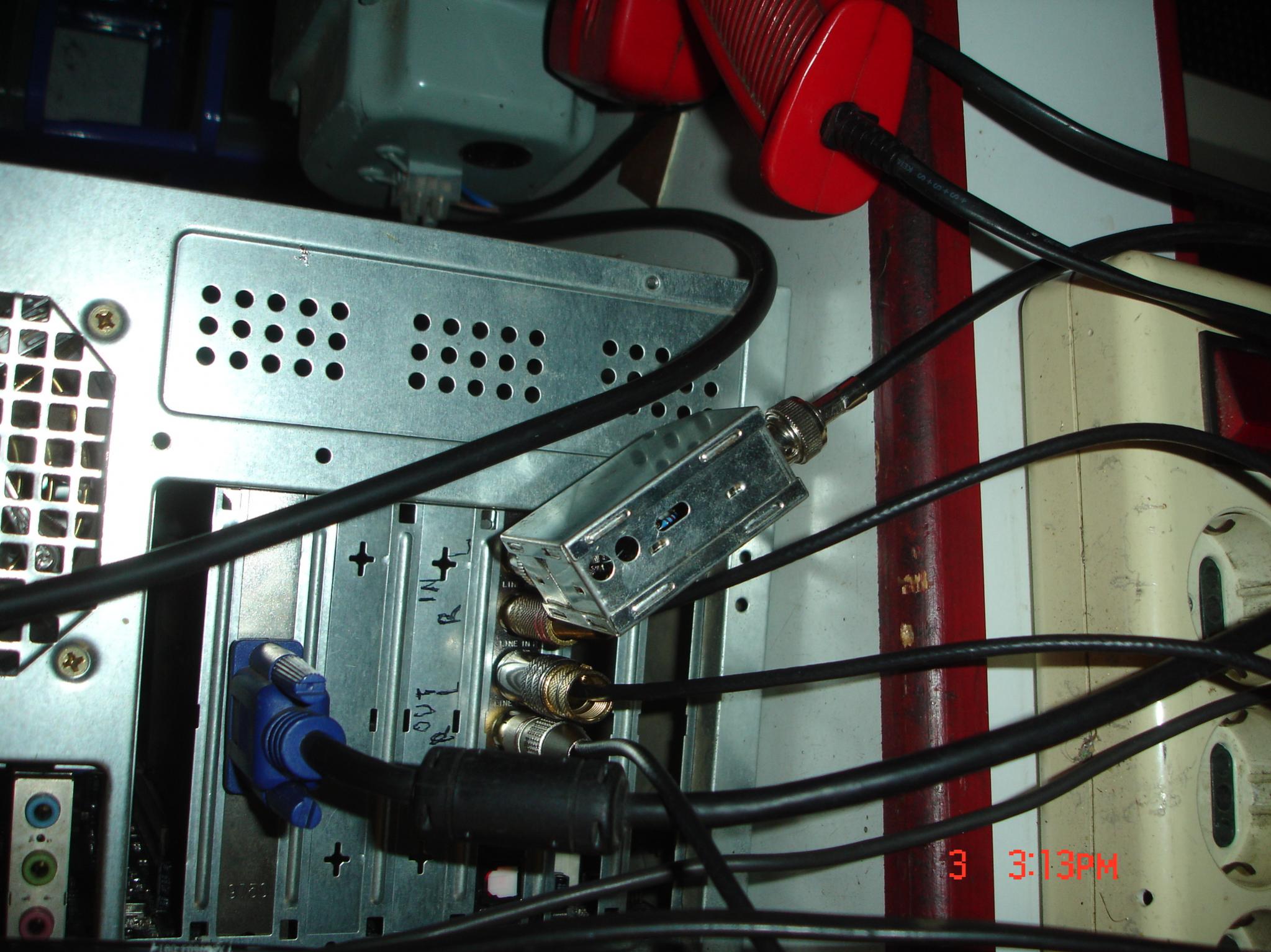

This problem solved in this way.
Resistor divider in a metal box fitted direct in sound card input.
Yes but these are present in the source signal too.(right channel)😉
