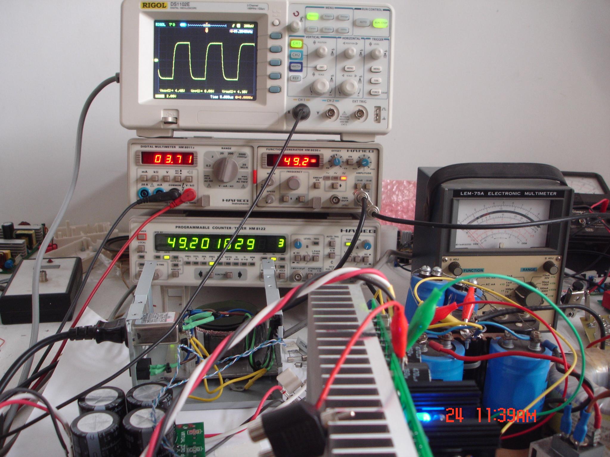

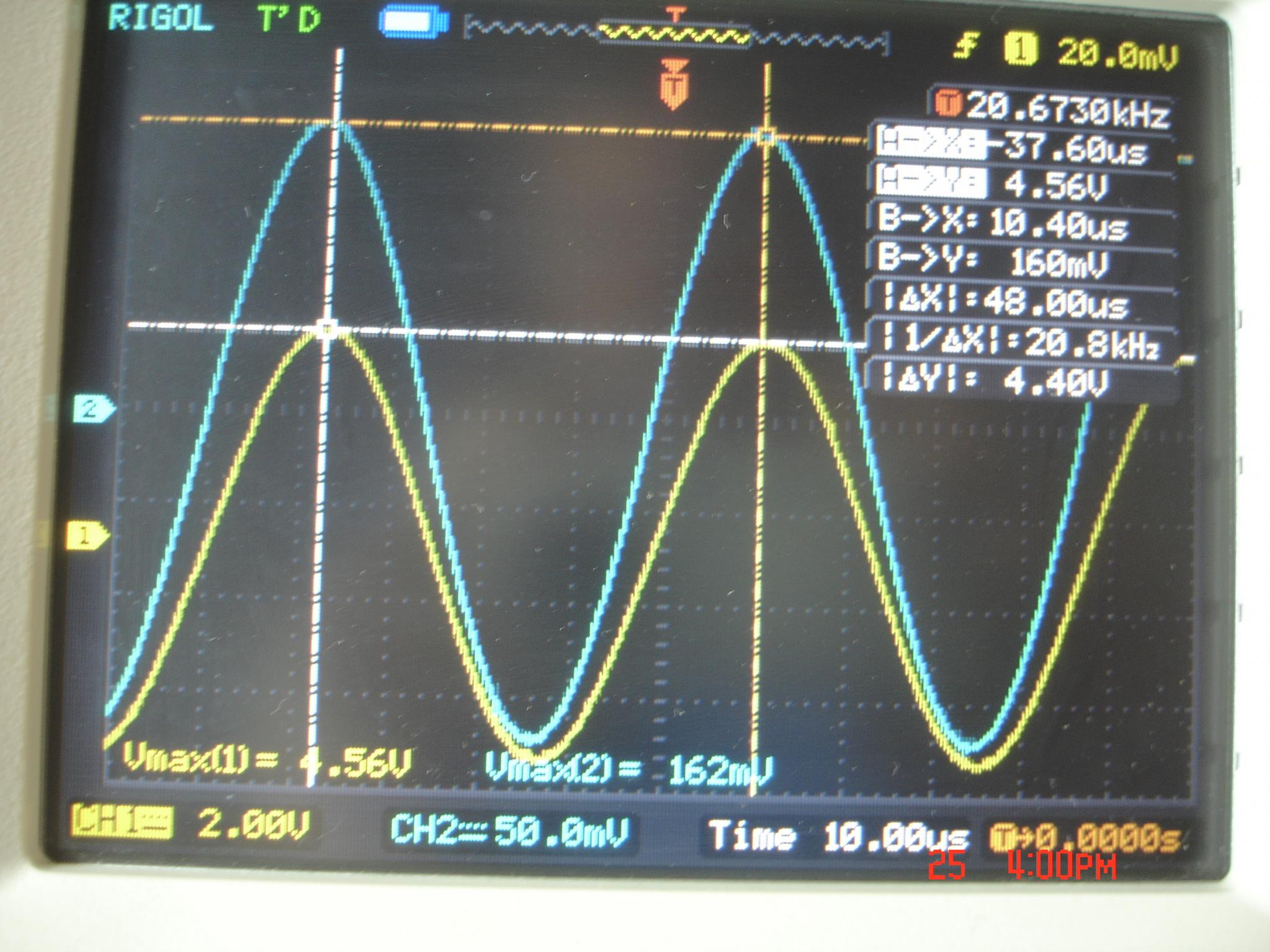

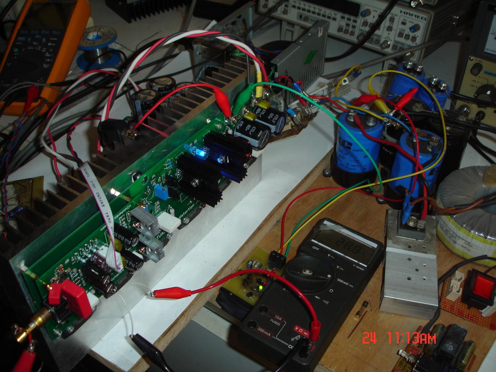

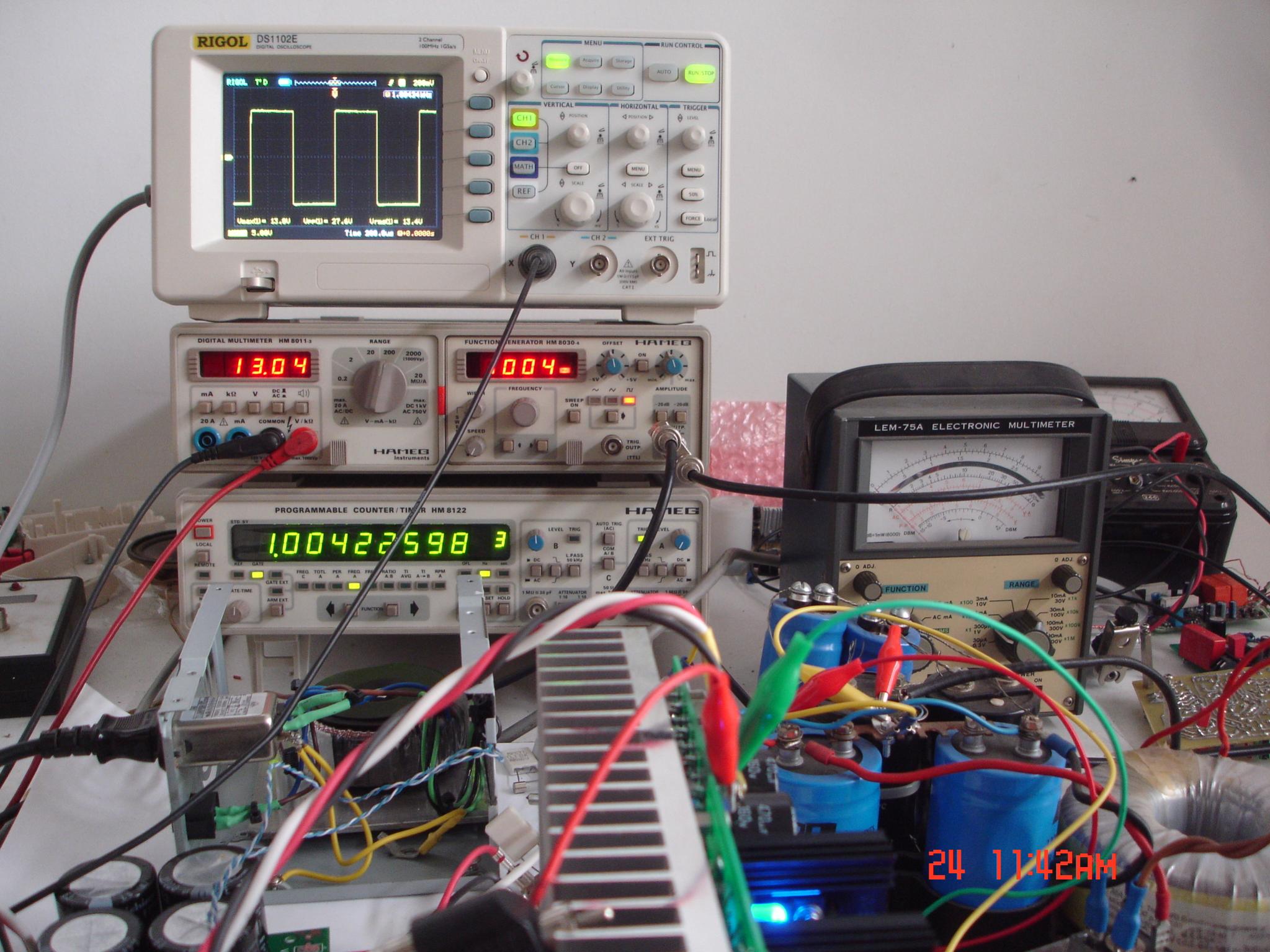

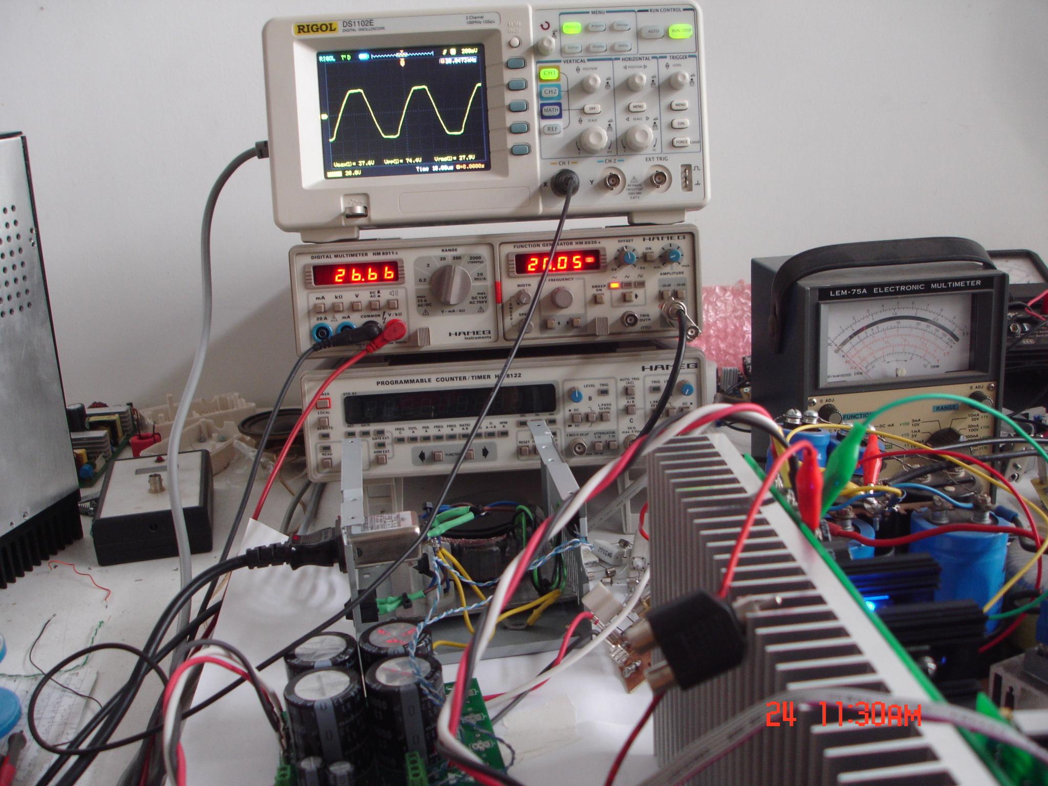

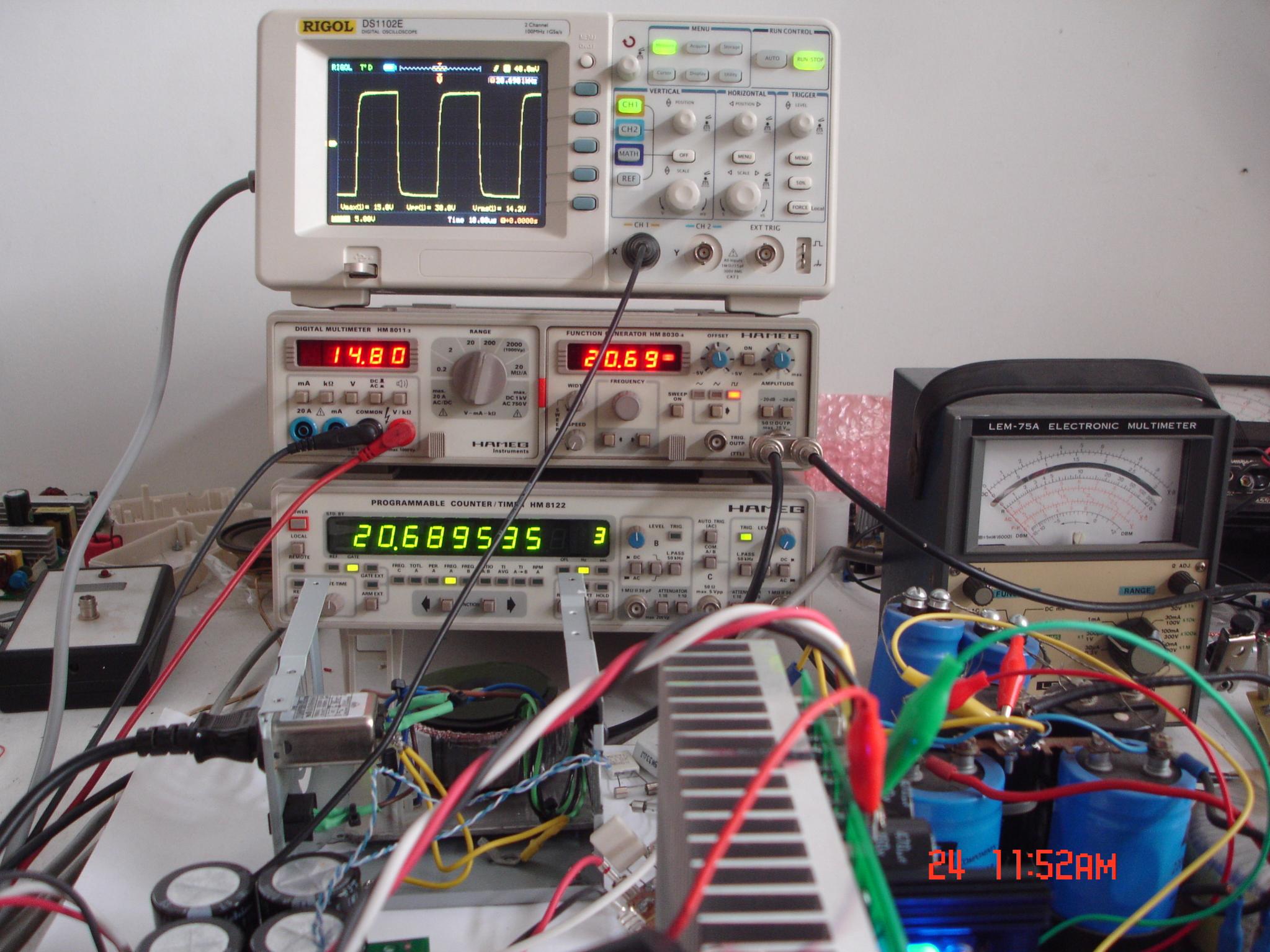

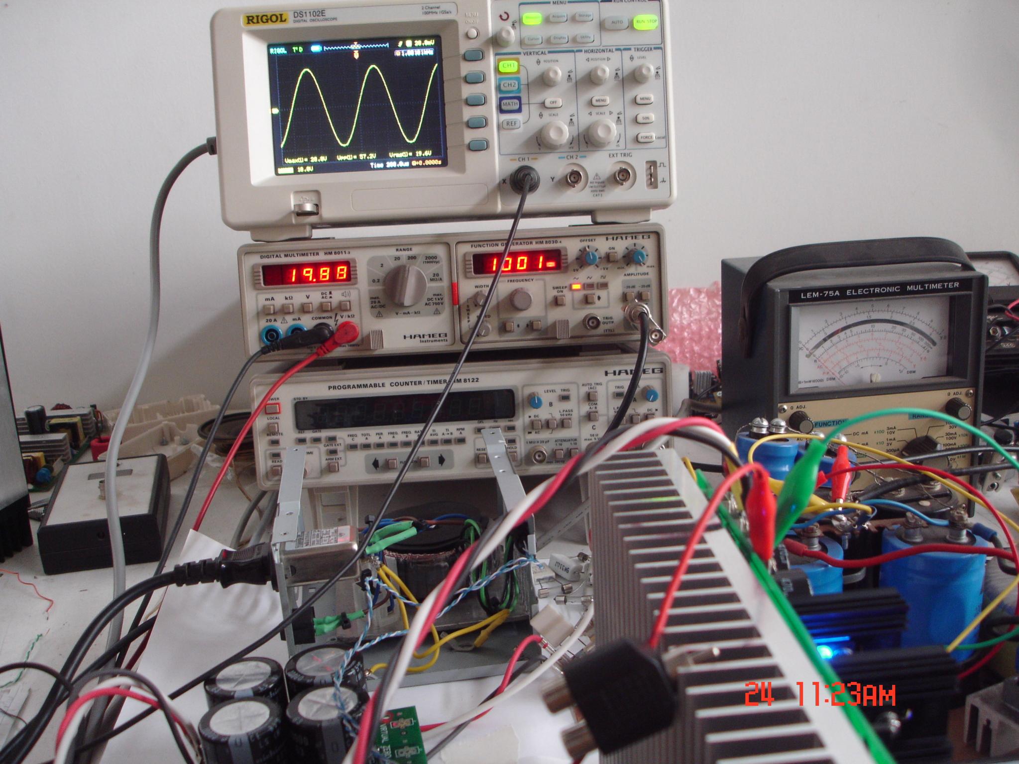

Revisiting some "old" ideas from 1970's - IPS, OPS
I can't repeat the phenomenon.
I have try hard but no success.

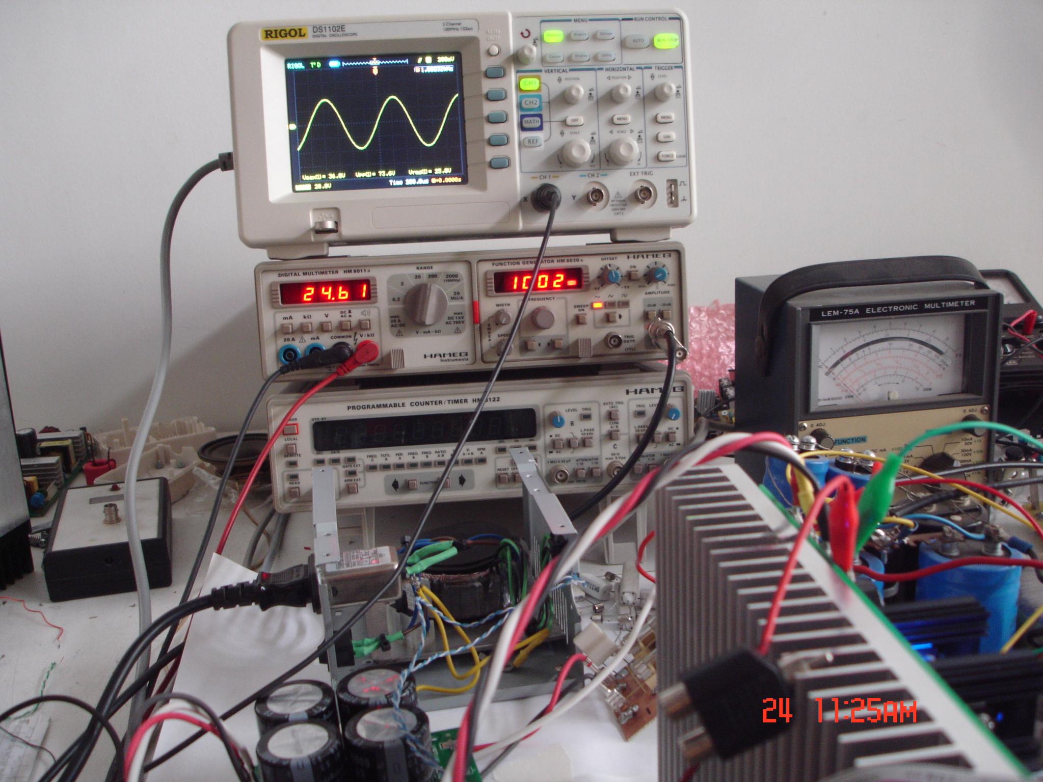

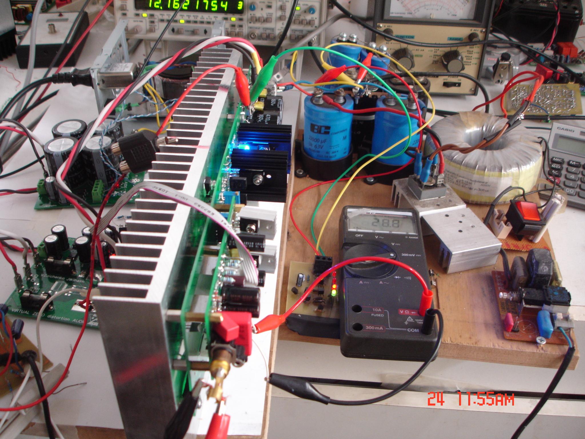

Now it's time for test.

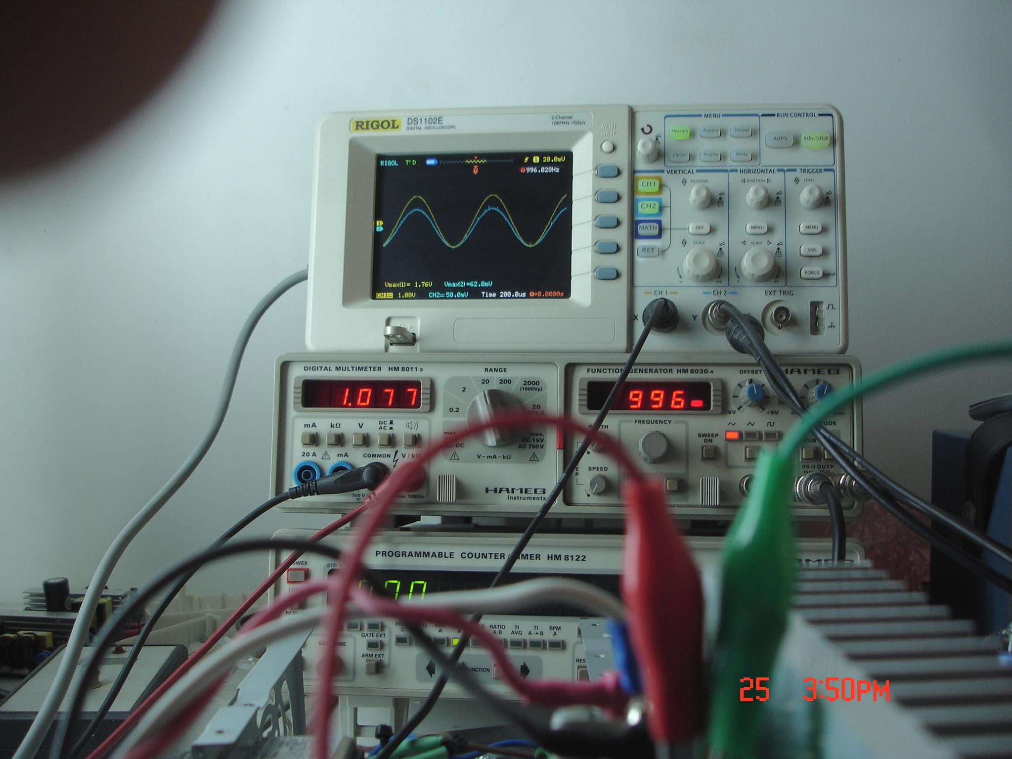

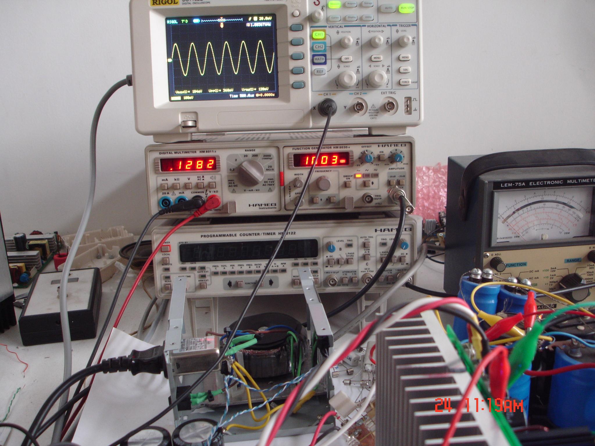

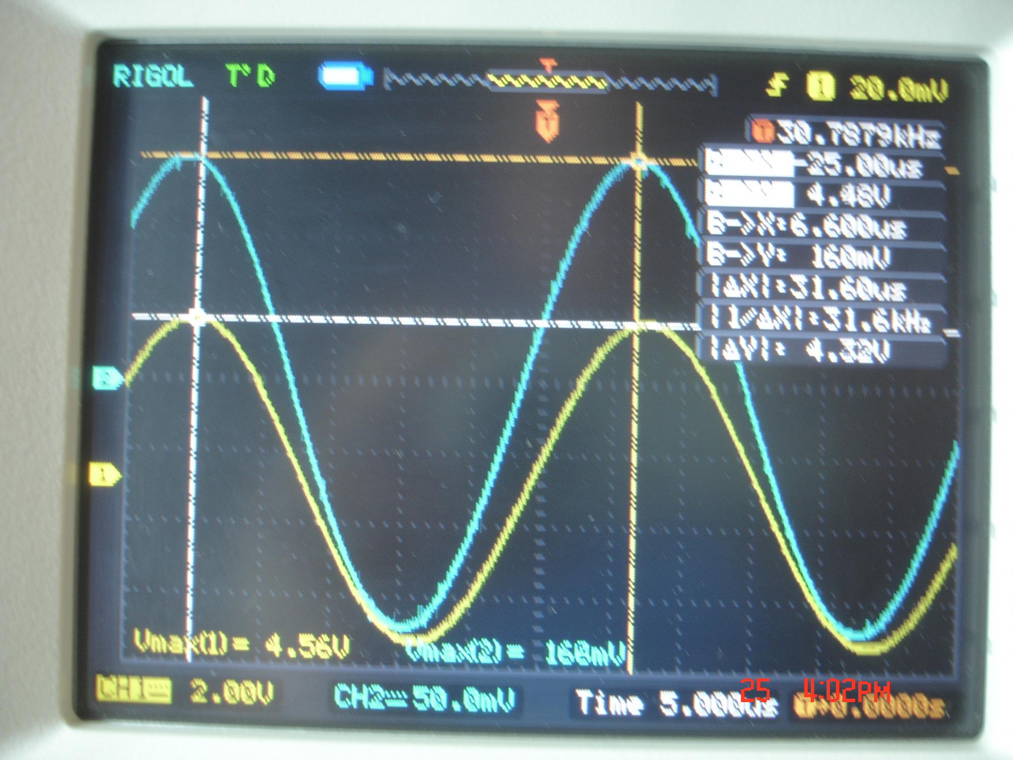

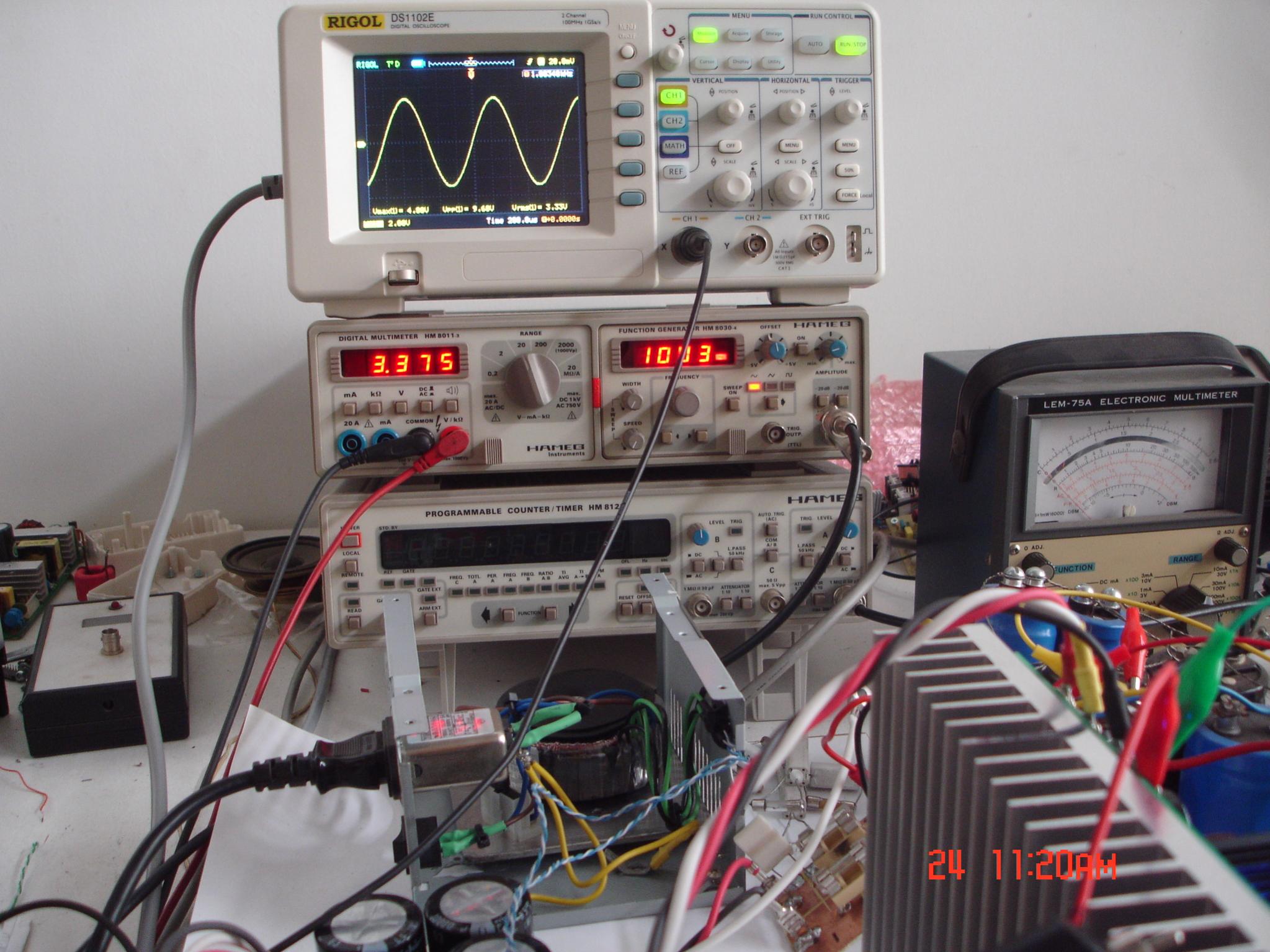

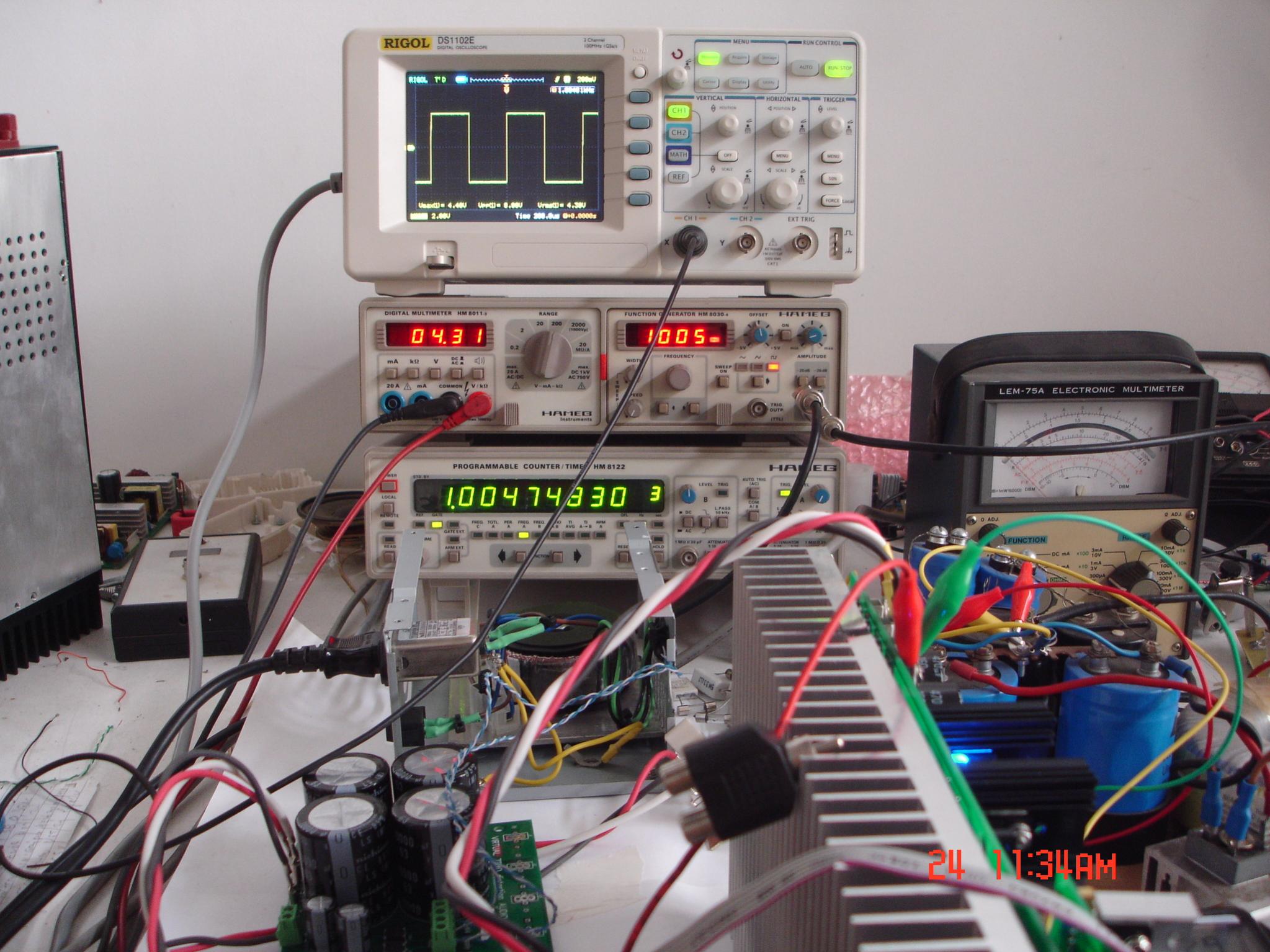

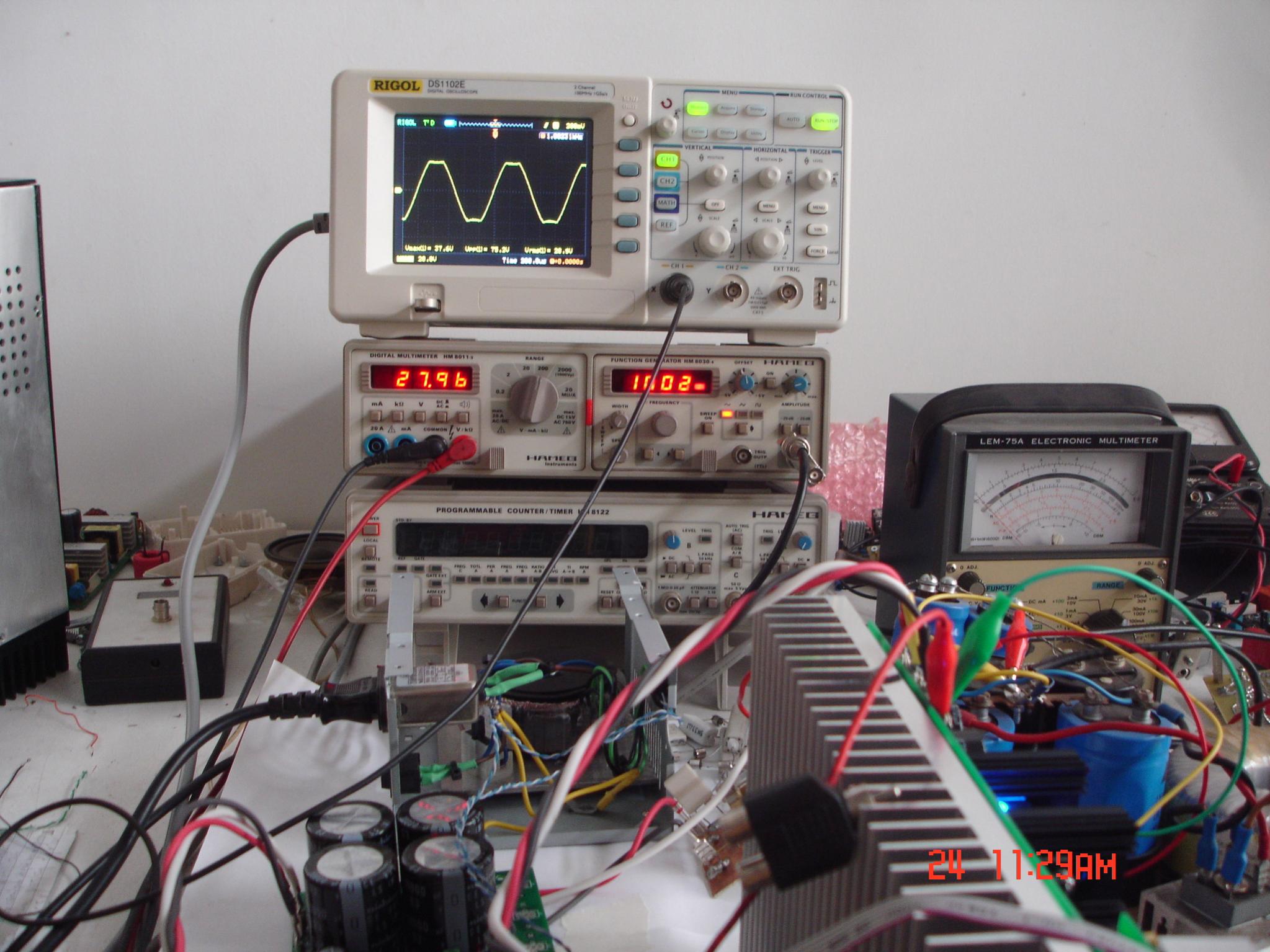

CFA IPS.
+/-50V
74000uf/Rail
idle current 65mA.
R load =7R.
Sinusoidal

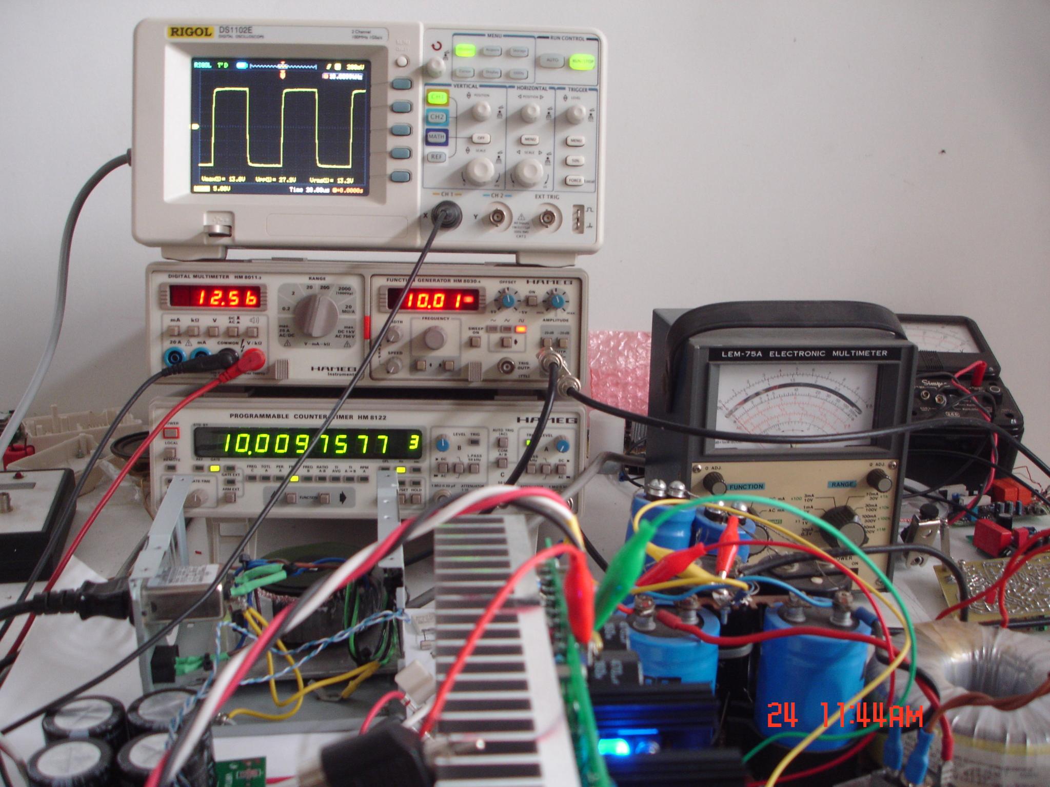

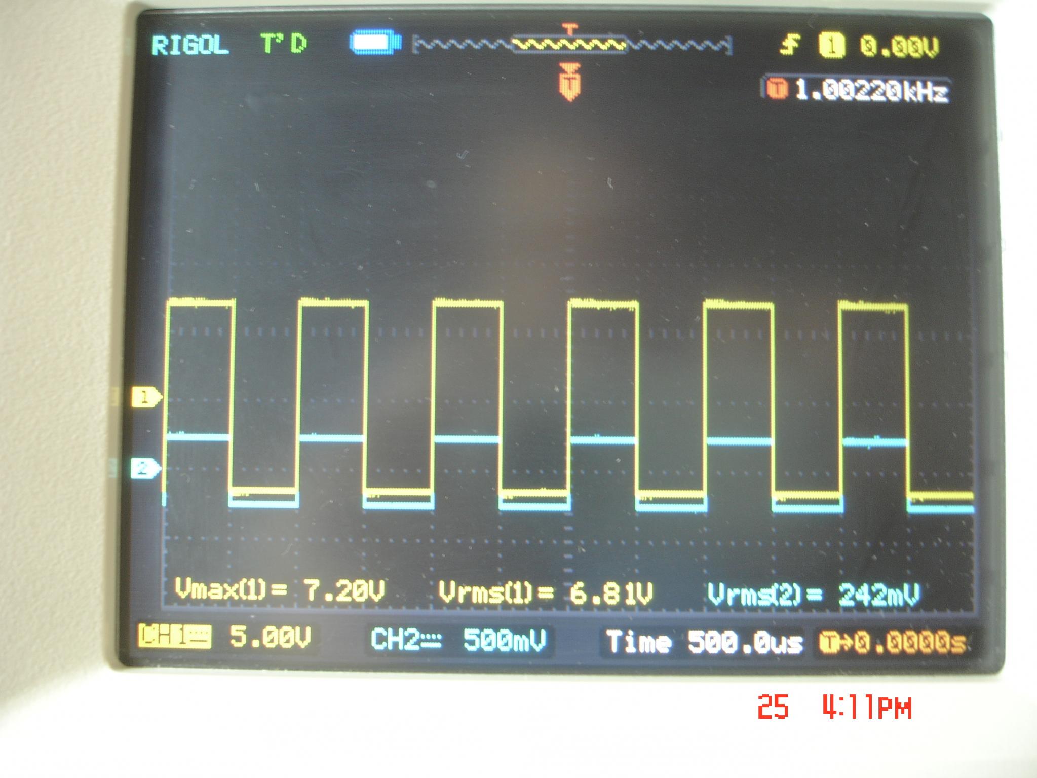

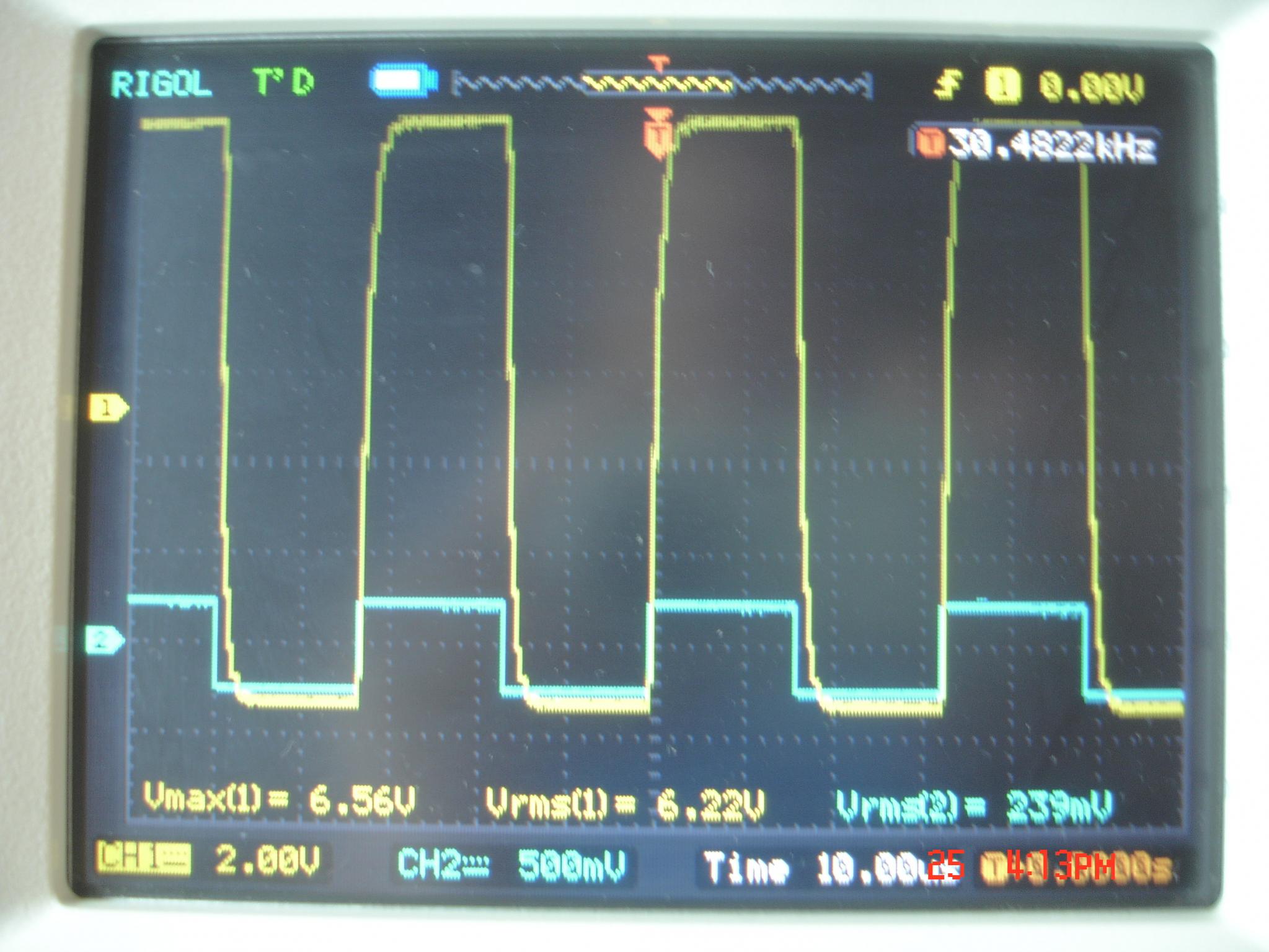

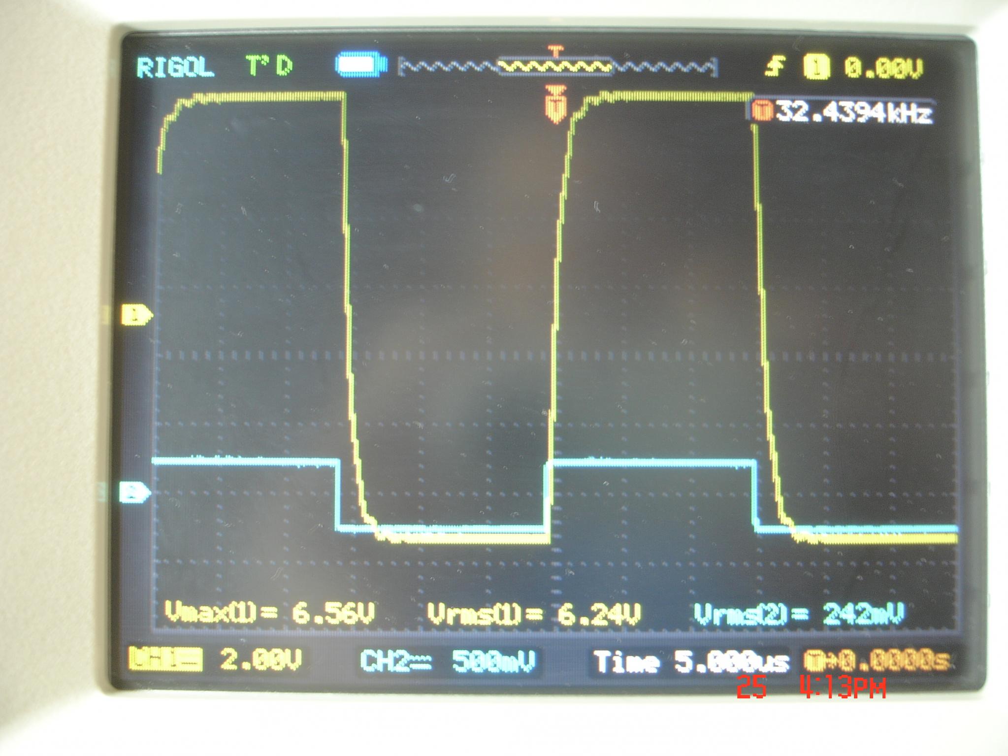

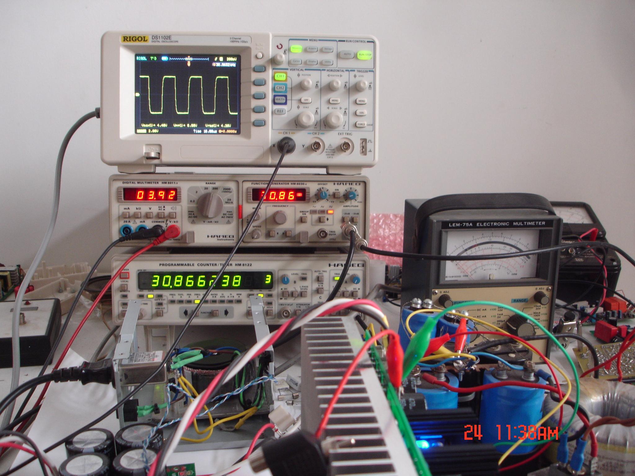

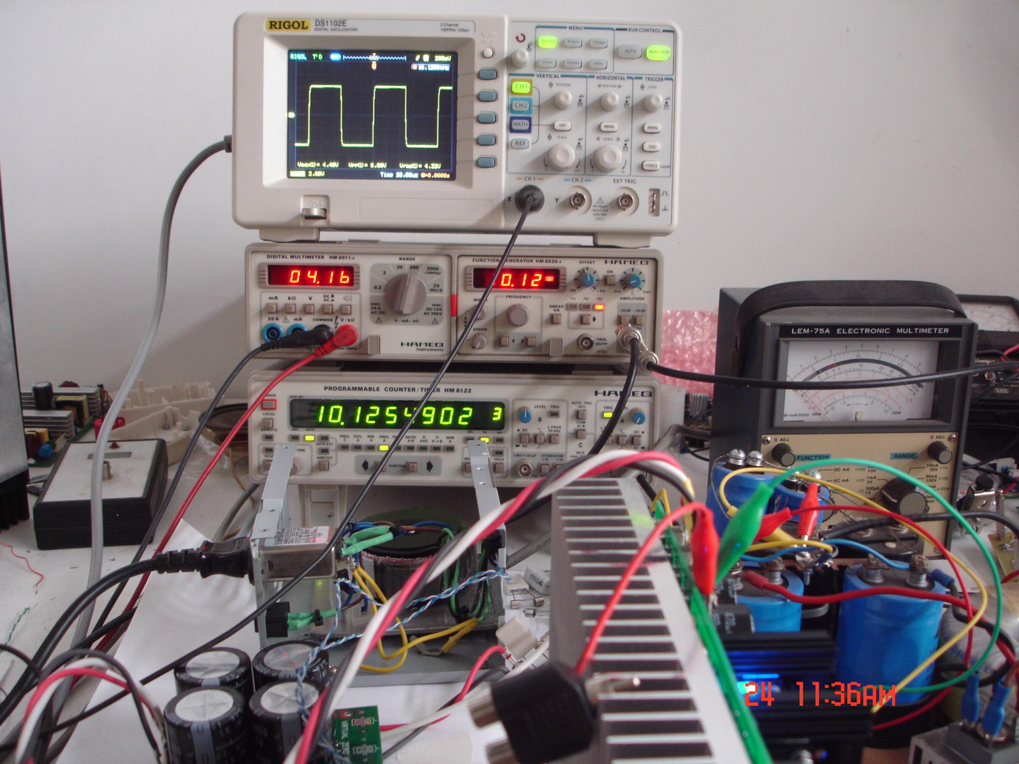

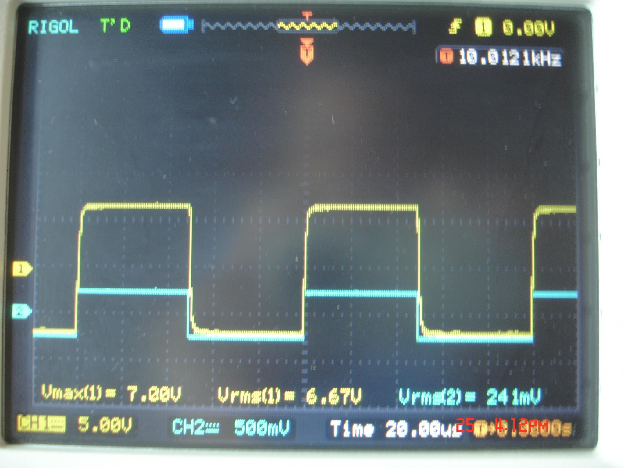

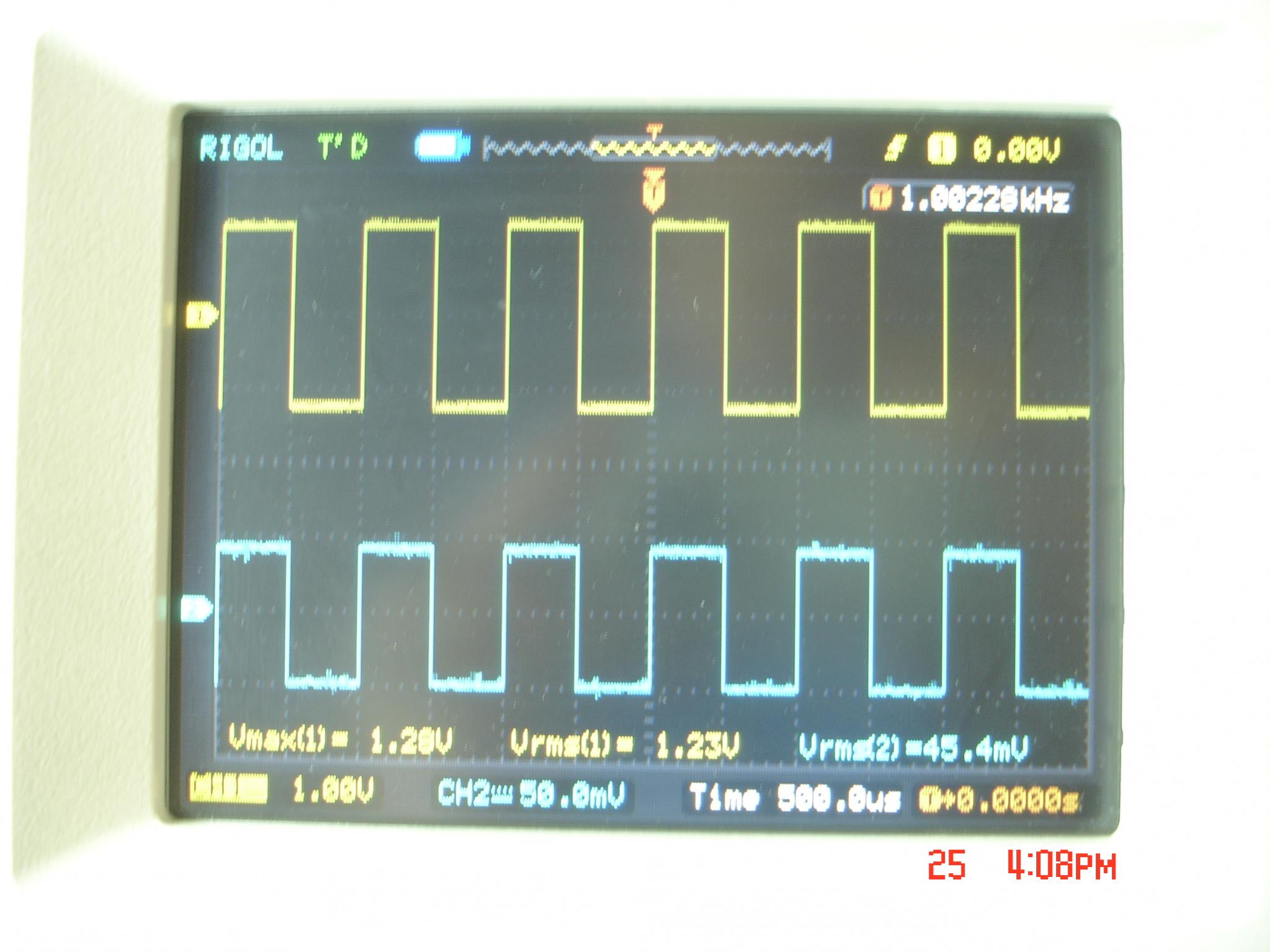

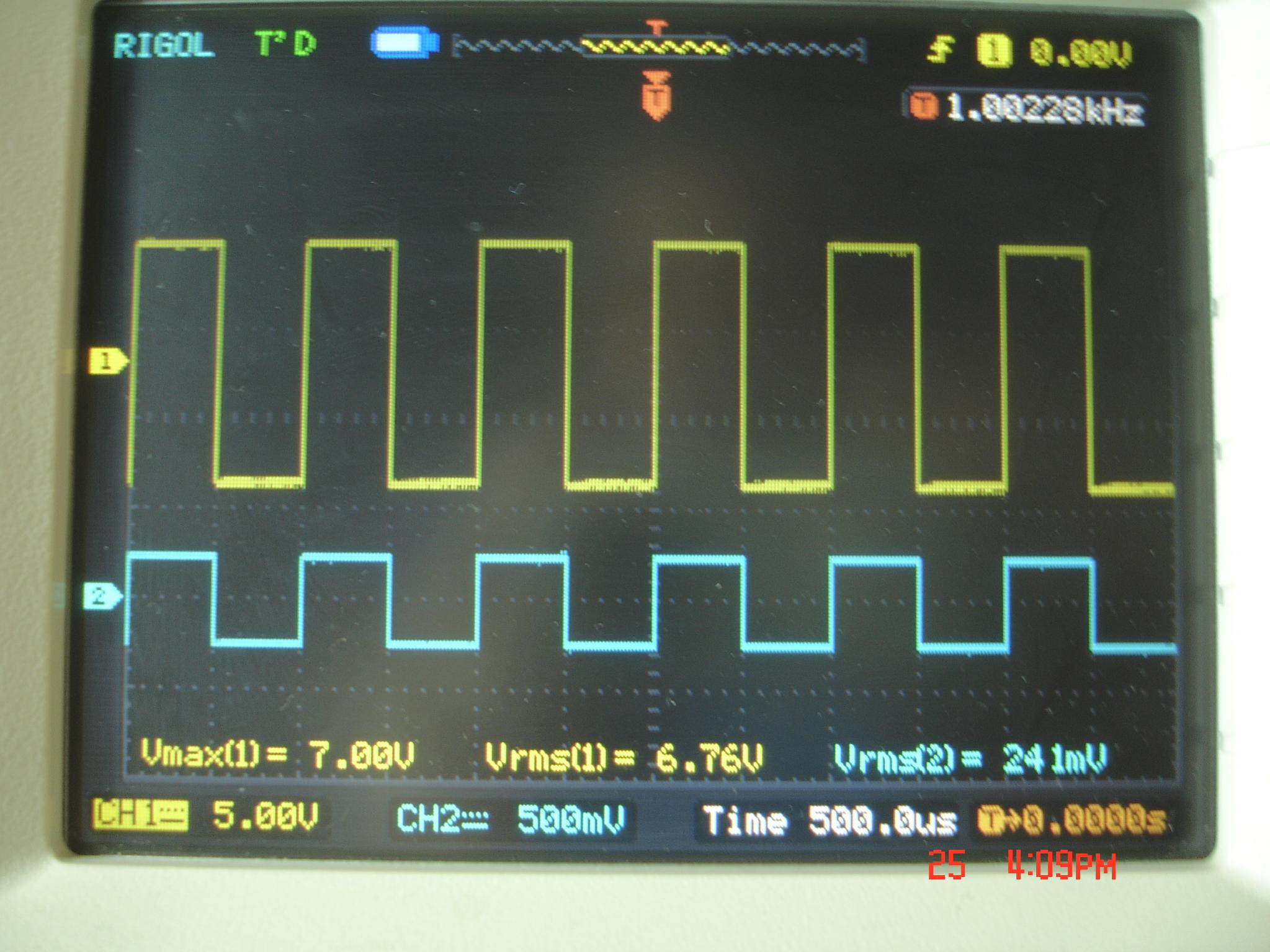

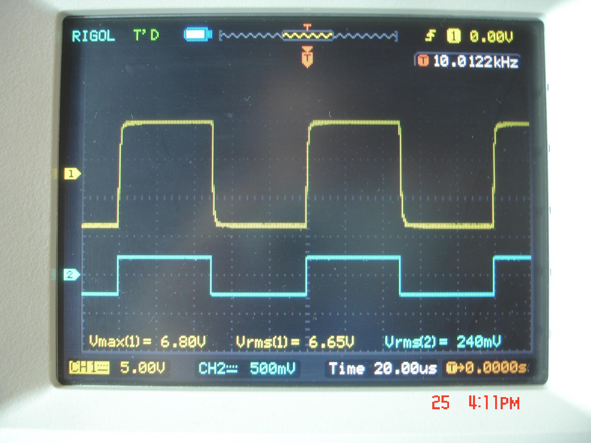

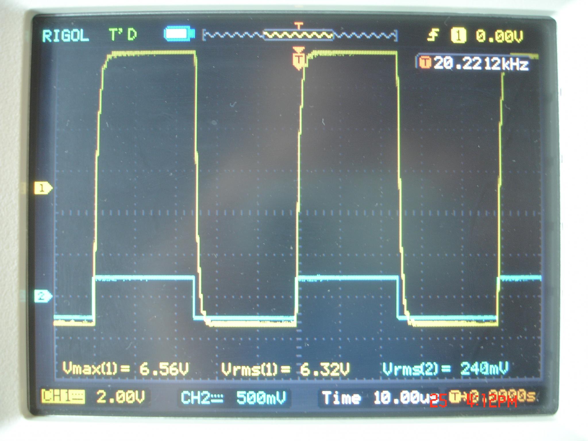

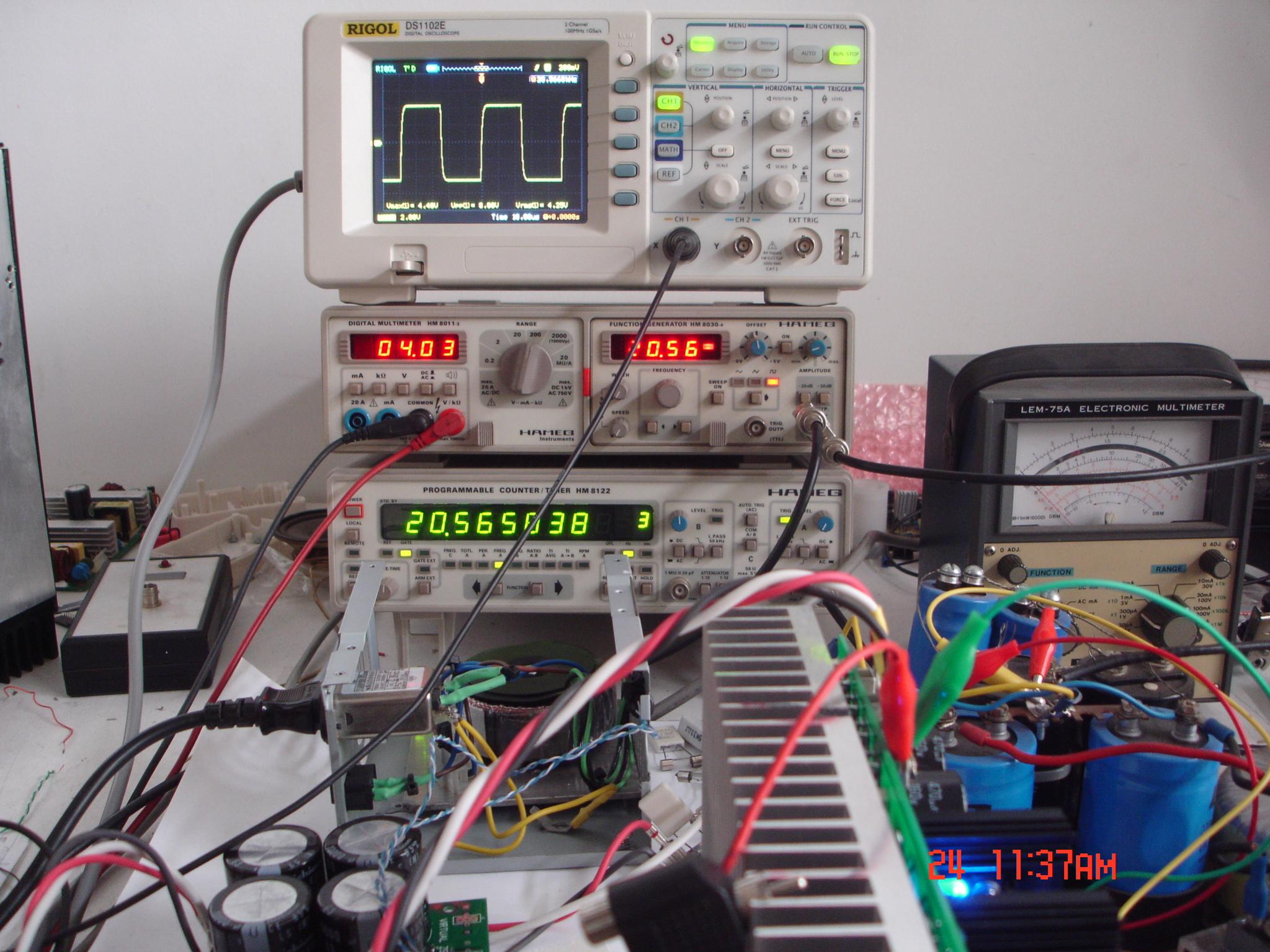

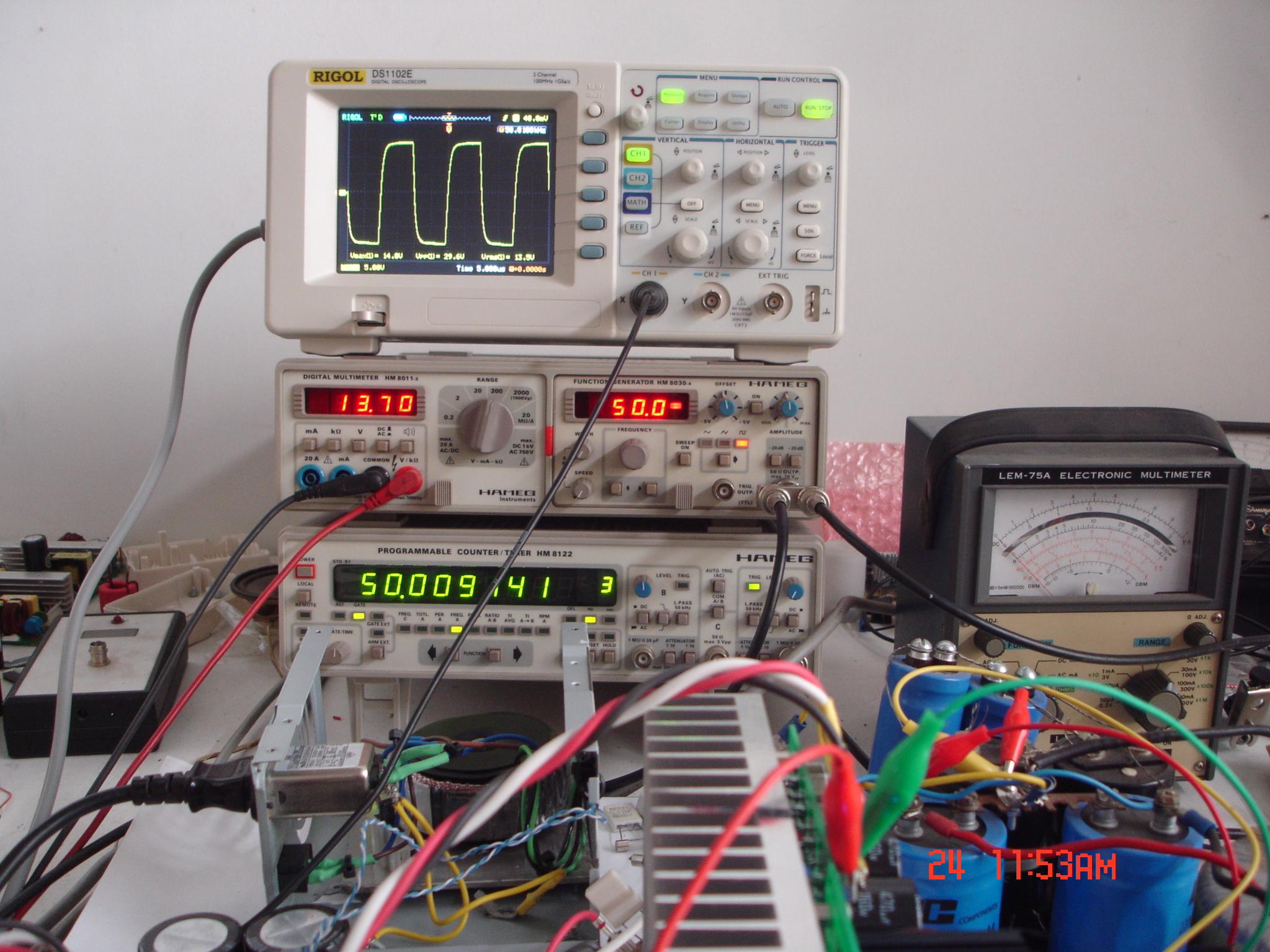

Square wave.

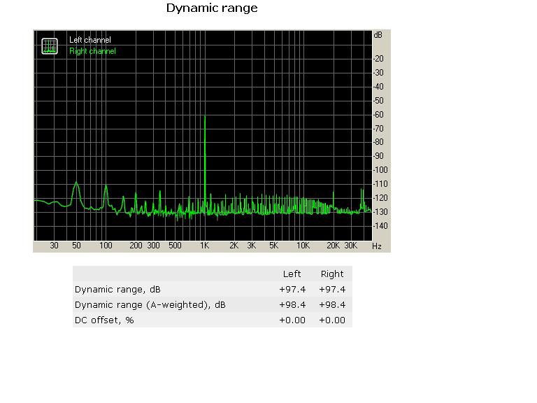

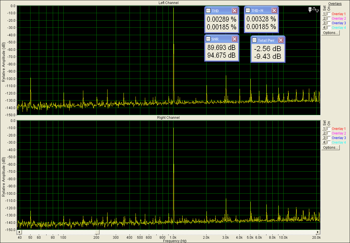

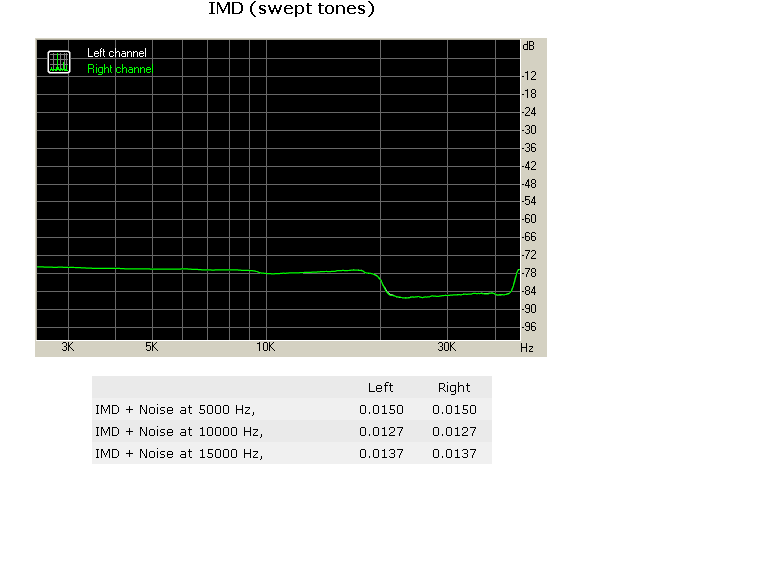

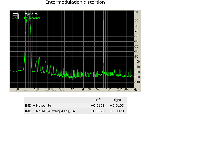

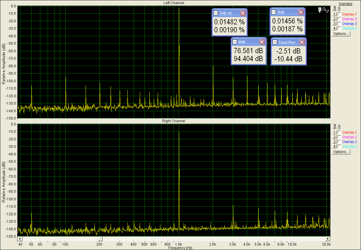

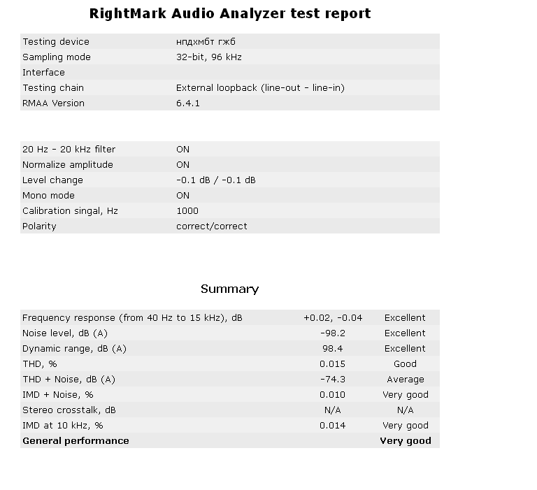

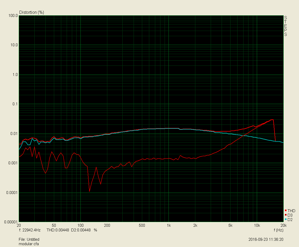

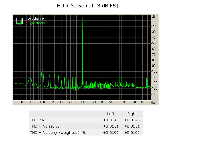

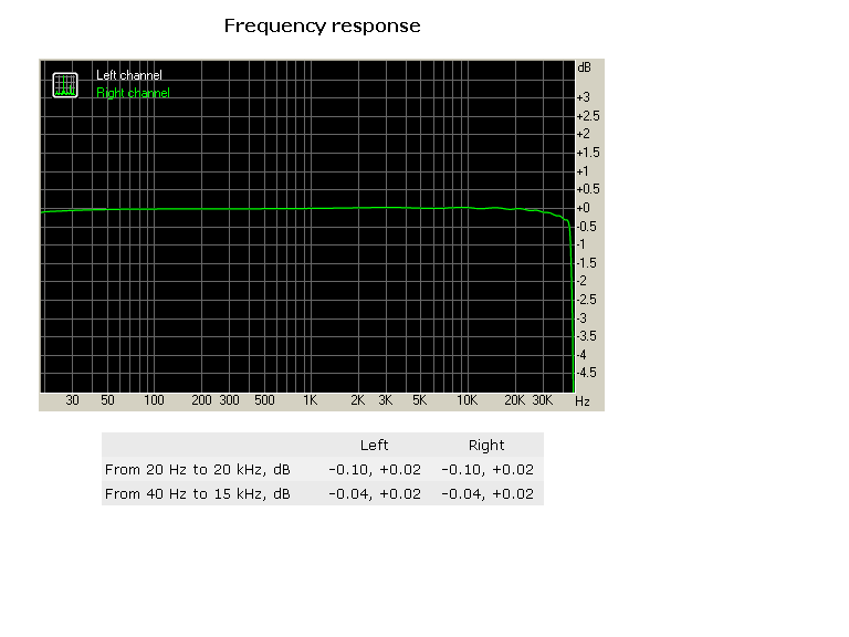

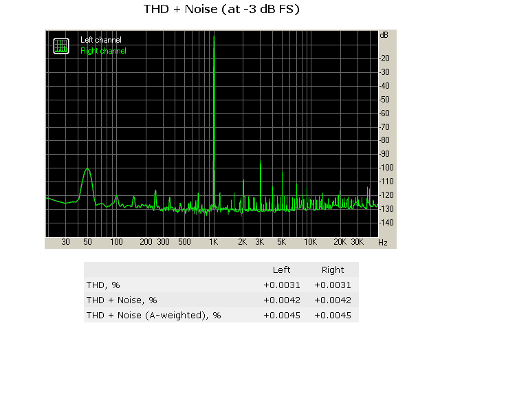

CFA IPS distortion
First group Right Mark.
Right, but to understand the scale, I need to know what RMS voltage corresponds to this -1db level. How many volts AC RMS at 8 ohm load.
Sorry Valery,i don't know,i seen that is just under clip level,but i will measure if it is necessary to know the exactly value😉
P.S i think that is about 25v/7R(this is the clip level according to sinusoidal test).
It makes sense to measure at some intermediate level - say, 20V RMS at the load. Close to clipping you see some higher distortion - which is also interesting to see, but it's a kind of close to the edge.
It would make sense to gust connect the oscilloscope to the output and calibrate the output swing of the sound card to the desired level.
This will be interesting.
1) the vz-x4
2) CFA
3)vz-x4
4) CFA
Same total power levels.
OK - that's what I meant - nominal 0db level is a bit too high 😉
At -10db they are rather close to each other with THD below 0.002%
At -3db, CFA's distortion becomes around 10 times higher - because it clips earlier, I think.
X4 is very cool - consistent performance at any swing.
Ok the vz-x4 distortion at -10db has been posted here. http://www.diyaudio.com/forums/soli...-old-ideas-1970s-ips-ops-130.html#post4828204
#post 1297.
I will test the CFA at -10db and i will post again these two files for comparision.

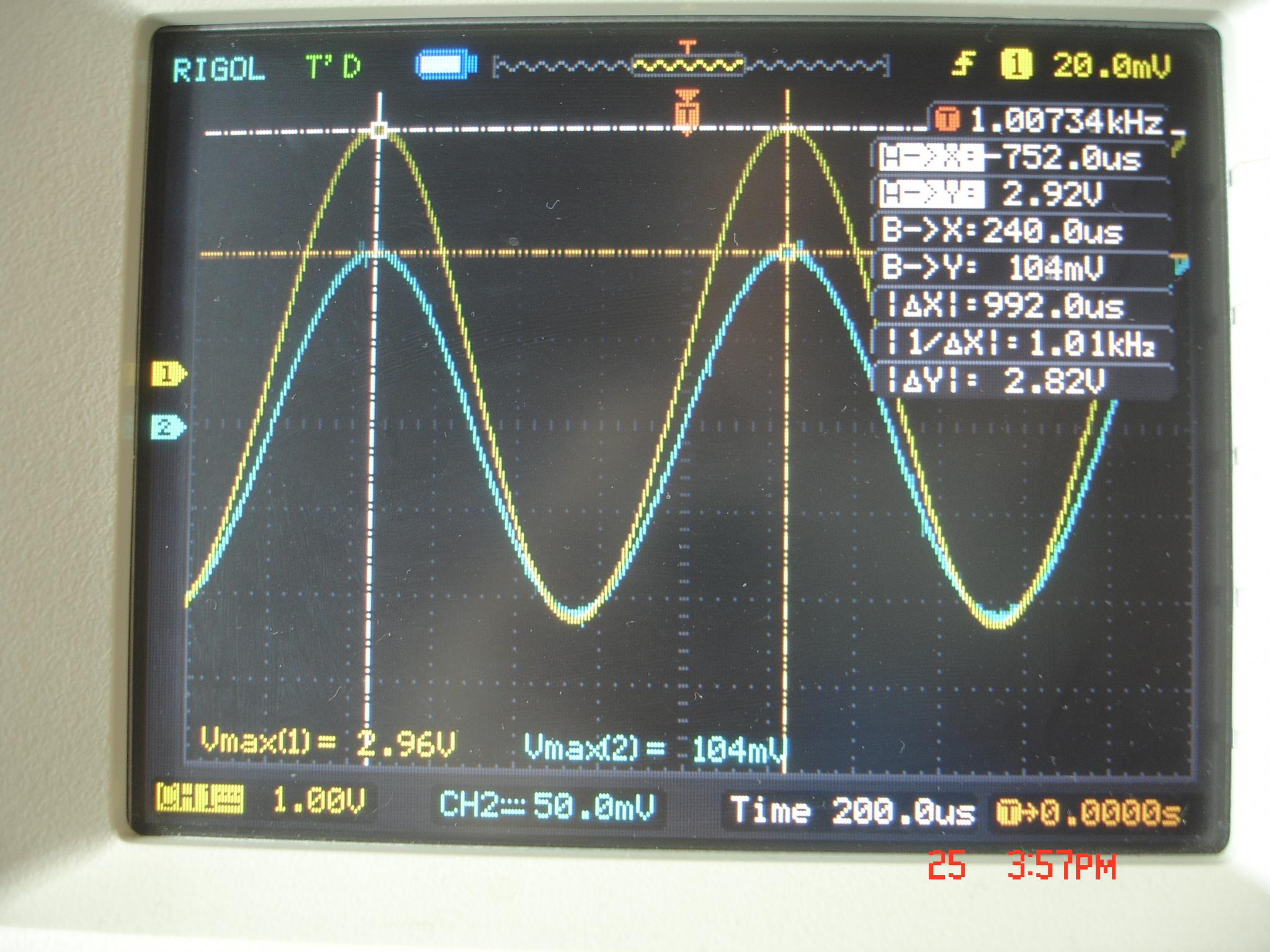

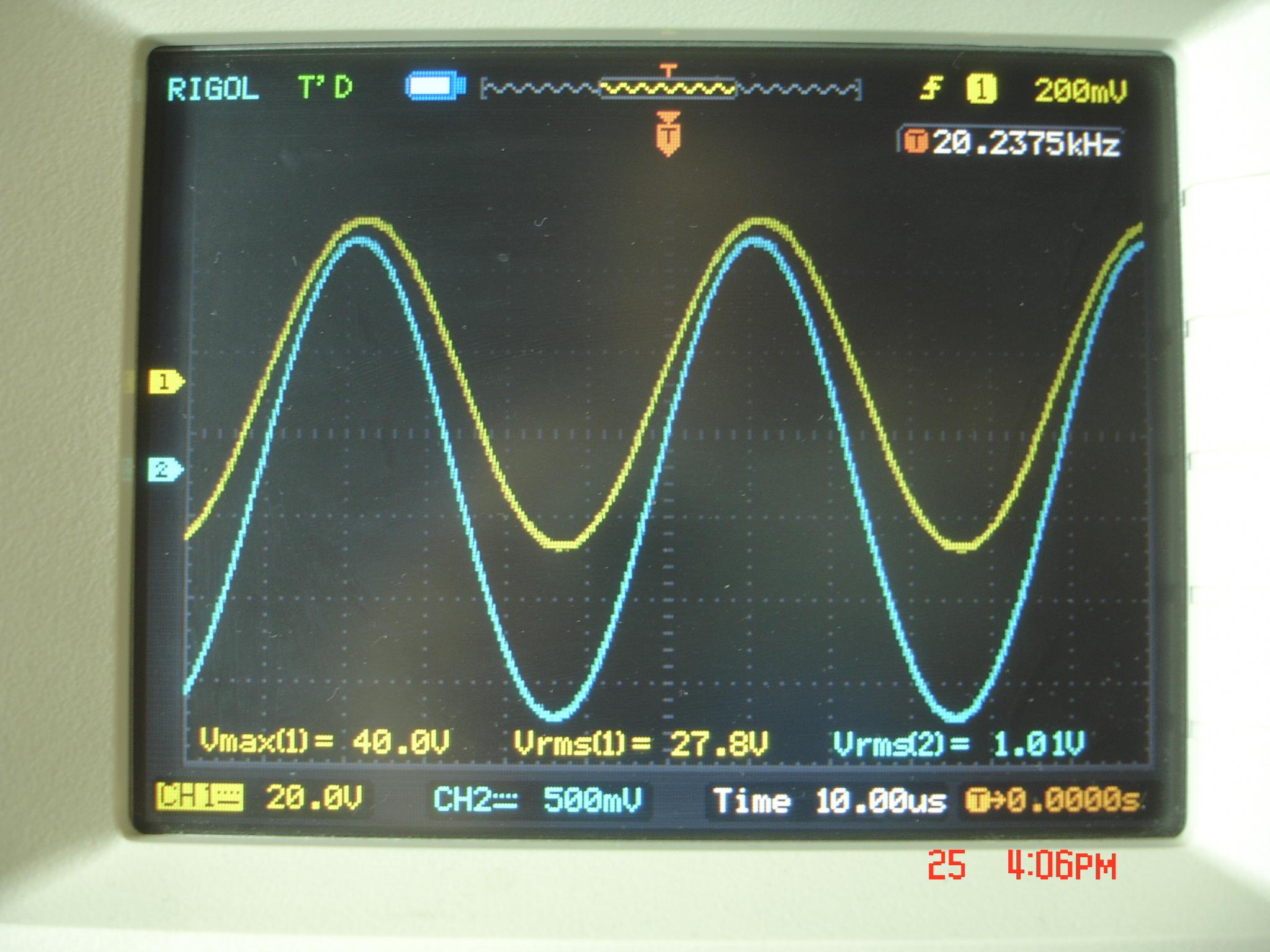

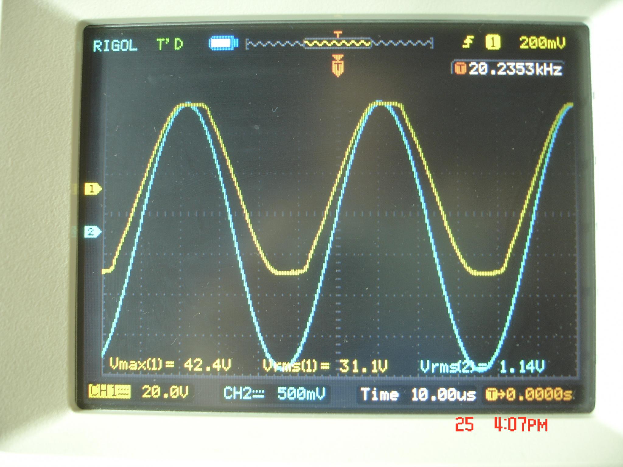

VFA+NS OUTPUT
+/-50v
74.000uf/rail
idle current=65mV
Rload=7R
Yellow is the output signal
Blue is the input signal.
VFA+NS OUTPUT
Square wave
