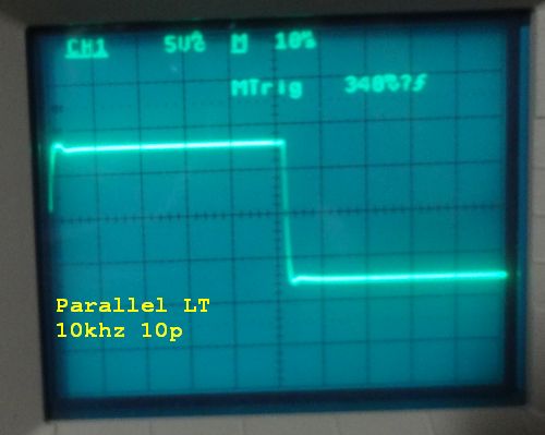

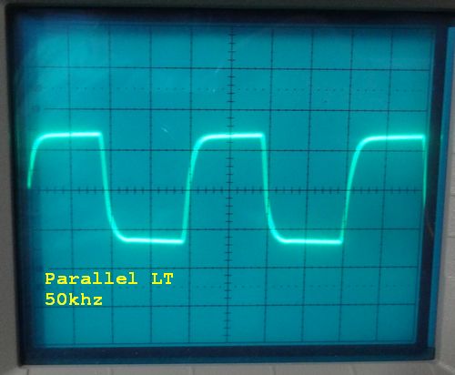

Hi Terry,
If you increase C7 value from 2.2pF to 10pF - that will eliminate the overshoot.
Valery
10p added an over shoot to the top.
OK I changed it to 22p. They are a bit rounded now. I don't have time take pictures right now. I will try 15p next and see how that looks later when I get home. I'll post pics then. I'll get a shot of it clipping too.

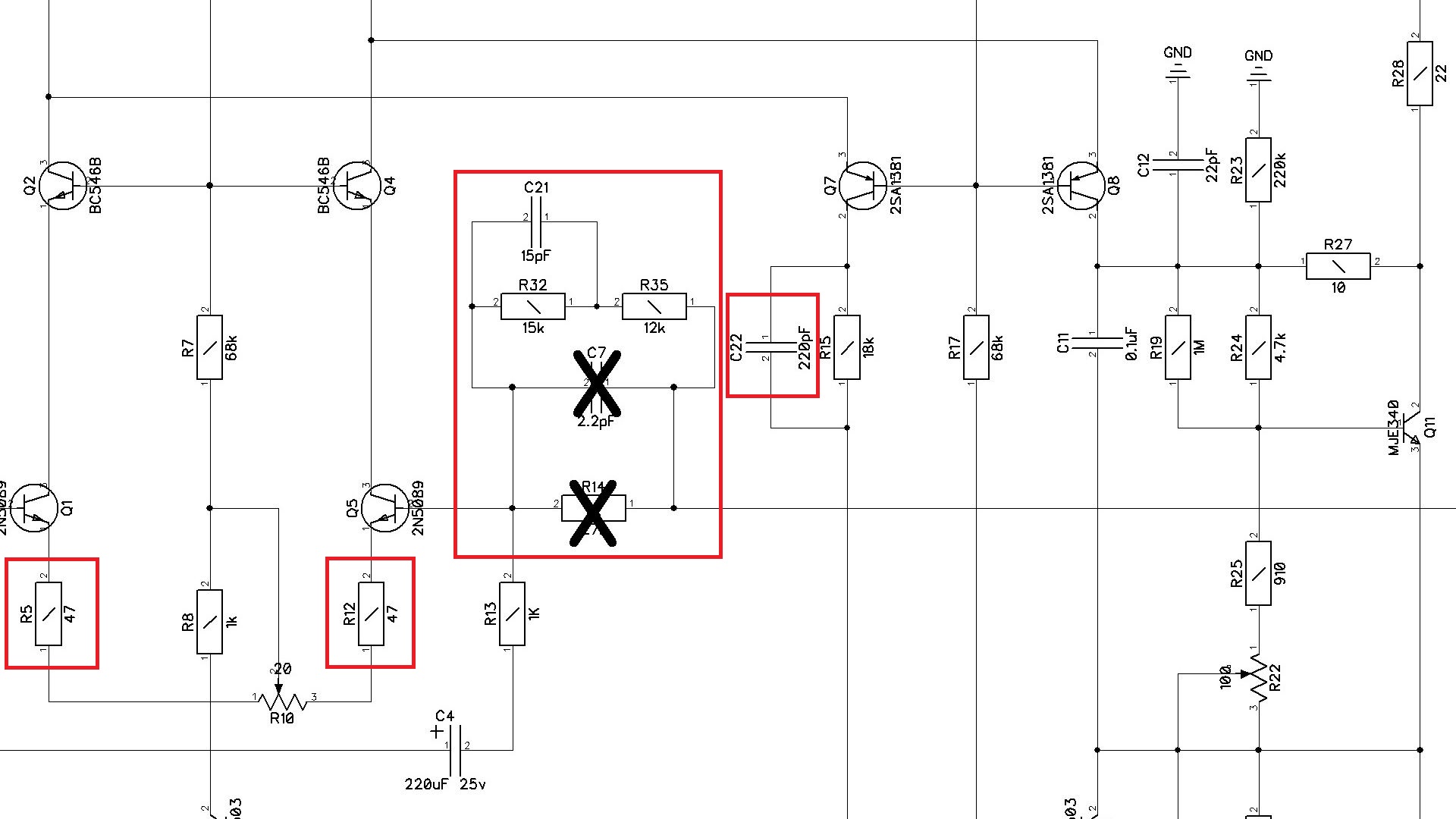

Hi Terry!
Ok, we're almost there.
What you can also do for the best performance:
- Increase R5, R12 from 22R to 47R (this will "calm down" the LTP a little bit);
- Add 220pF capacitor in parallel with R15 (18K);
- After that play with C7 value - I believe, 15p is about the optimal one.
Many thanks,
Valery
Terry - one more thing, if you don't mind.
Remove C7, R14 and place the network C21, R32, R35 instead.
I have marked all the amendments on the picture attached with red frames.
In the end you can play with C21 value for the best square wave at the output.
Valery
Valery

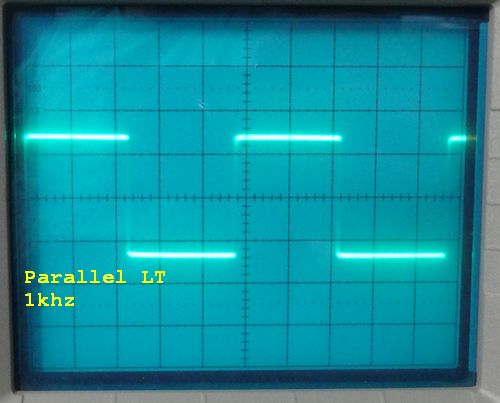

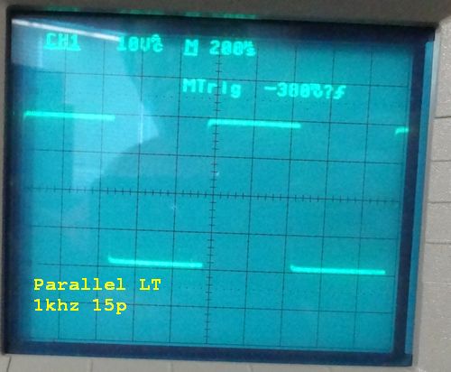

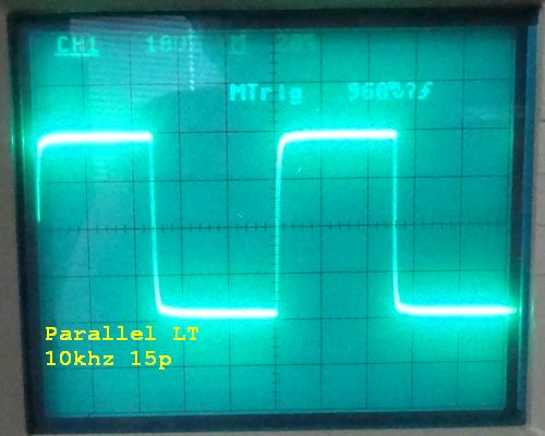

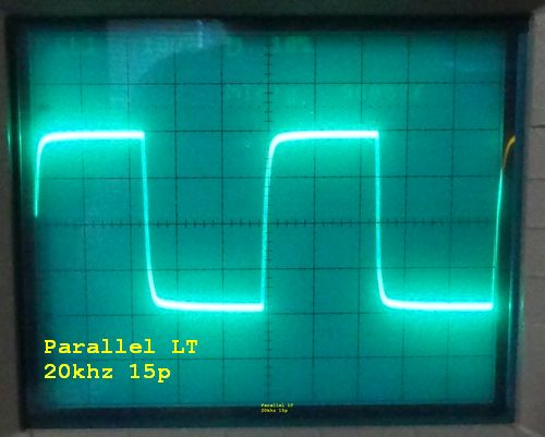

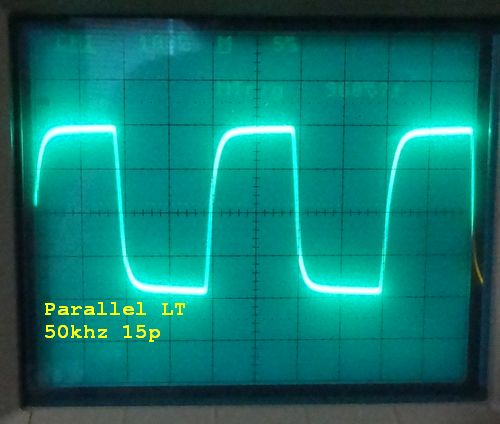

Hi Valery,
Sorry, I've been lazy today. Sitting around watching the Olympics I have recorded. 😱
I made the changes you suggested. I actually think the square waves are a little more rounded then they were with just the 22p. I said I would show it clipping but the gain must be low because I can only get the output to 20Vac and that is not enough to make it clip. My sine wave generator only produces 1.5Vac. Here are some scope shots of some square waves.

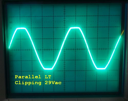

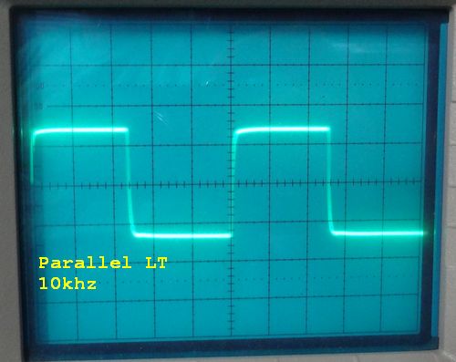

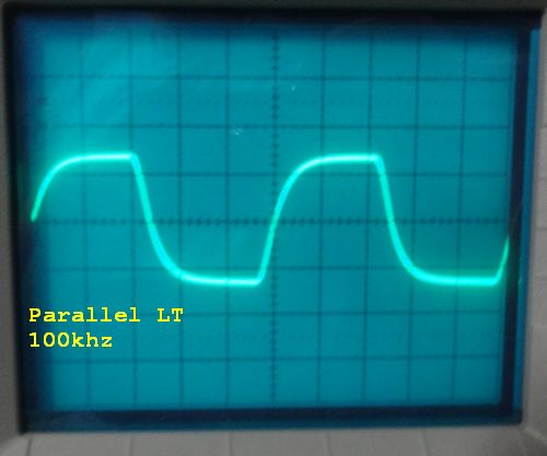

OK I have all the values changed to the values in post #1005. Attached are some scope shots. One issue is the offset. The trimmer is at its limit and I still have 6mV on one channel and 30mv on the other. I did match hfe on all 4 of the LTP transistors.

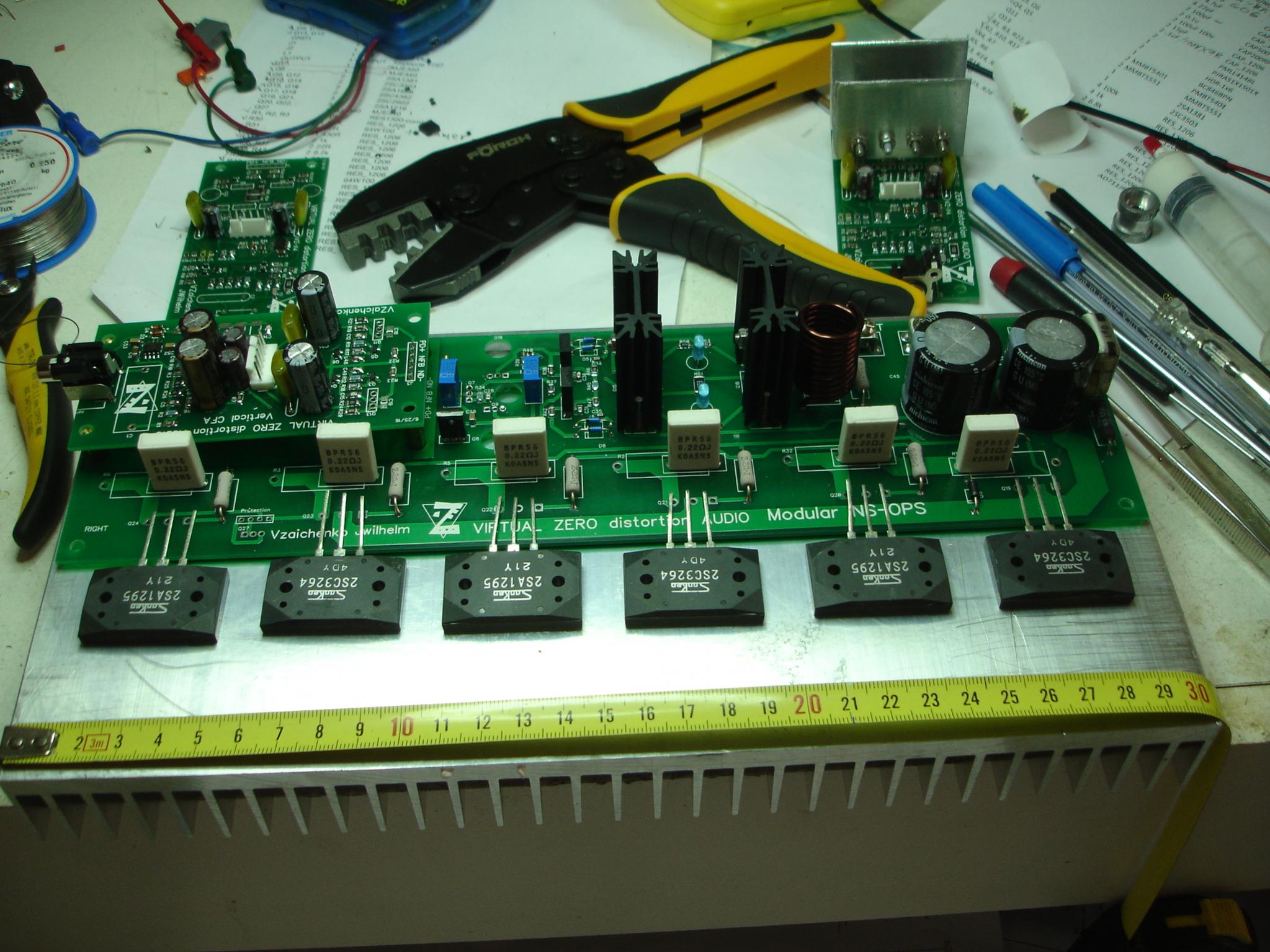

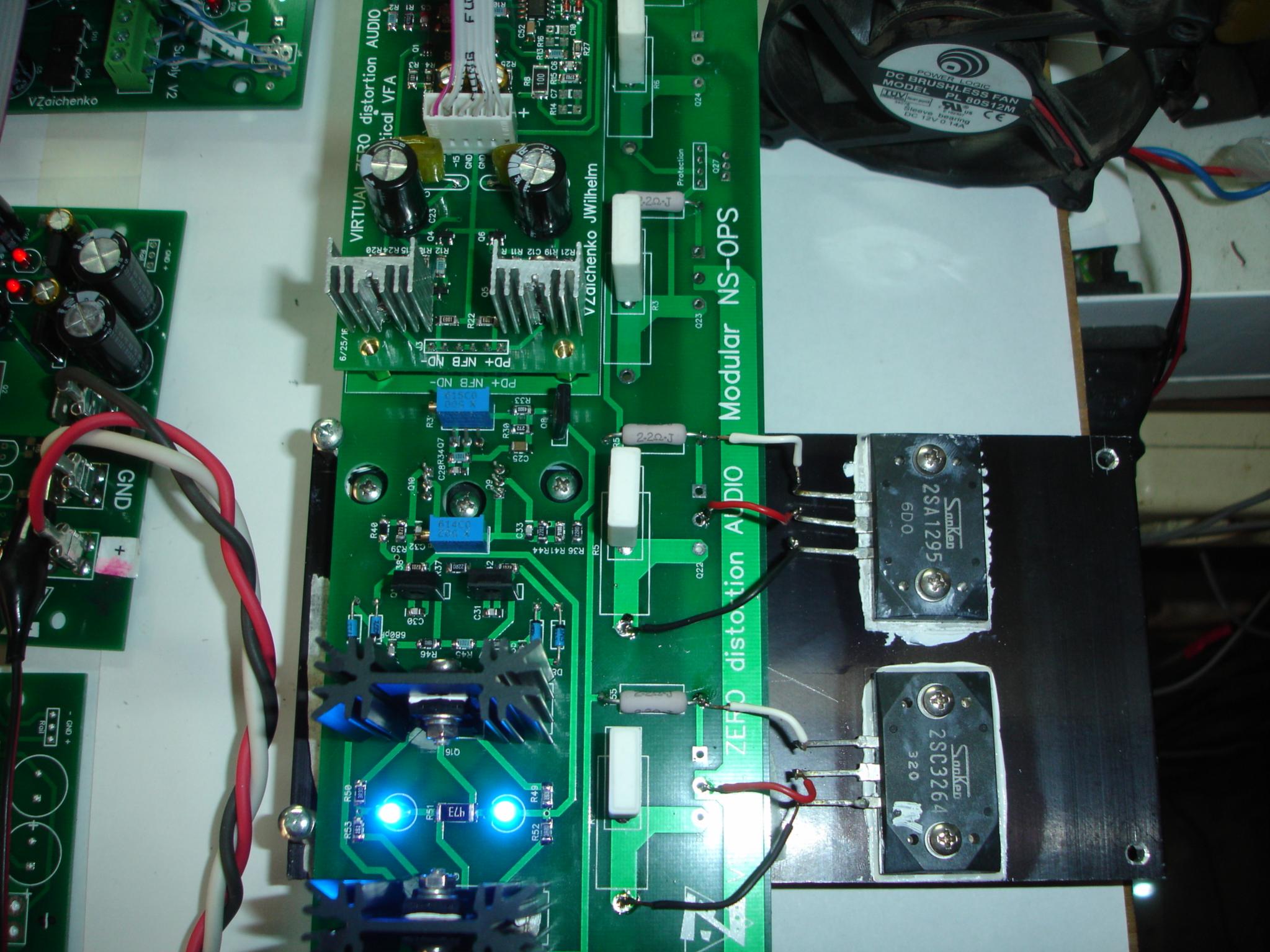

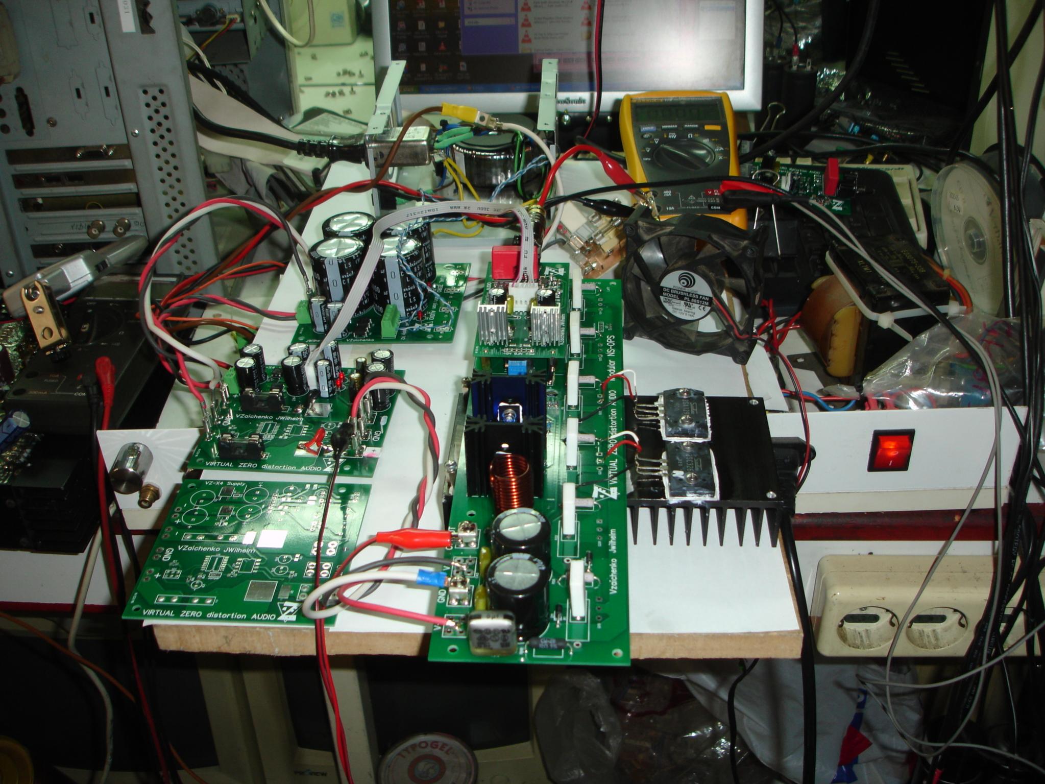

An early test
Waiting for the heatshink package i had tried an early test.
Nothing special,just i can't resist giving a first listening test.
Excellent sound,deep bass,fine treble very musical....just Excellent!
It is the first time that listening test take place first, before scopes and the measurements!
