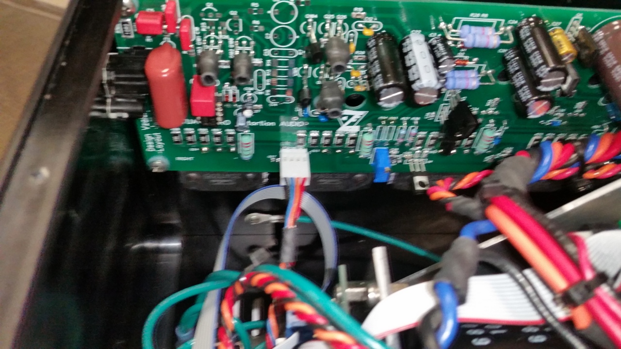

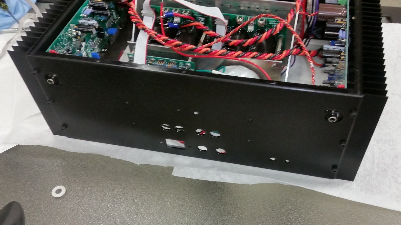

Terry, yes - see the pictures. This is an earlier integrated IPS-OPS version, but overall idea is the same - the board is placed in a way that the plug appears on the rear panel.
Advantage - no input wires - less noise/hum.
Disadvantage - we have to design the separate layouts for left and right channels. However, we believe it makes sense, bearing in mind the advantage 🙂
Now, with the new modular design, we can change the front-end section without touching the bulky OPS board - very convenient!
Front-ends are inexpensive, so the amp owner can try different voltage amplification topologies and choose the one he likes better 😎

The connector is designed to mount flat to the rear cover. If you look close, there is a small ring of plastic sticking out on the mounting surface. This centers it in the hole and adds insulation. There is also a mounting screw hole there. The flat metal surface is chassis grounded, and is not connected to the RCA ground.

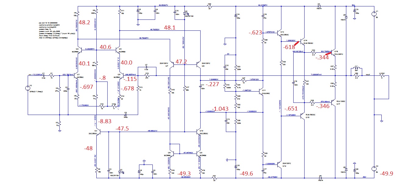

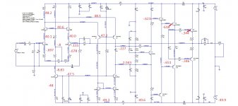

Ok I have been two days trying to find an error in my work but can't. I checked every part for correctness and as far as I can tell I have everything as per layout drawing. I'm assuming that the TO-126 and TO-220 parts all have the base pin marked with a square pad. I have done my best to check out the layout but I must be missing something. I'm attaching a schematic with voltages. Any help will be appreciated.
Blessings, Terry
