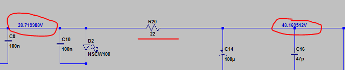

RE: the LT Spice file
FIRST, i'll confess upfront I didn't bother to load the correct transistor models in; i just took the defaults and fired up LT Spice for a VERY quick look.
i see 20V (~48v - ~28v) across 22ohms (R20).
Right away, that sounds like a bit much (~1A!).😱
And a 12v difference between Q7 & Q8 emitters with no signal applied.
Makes me a little leery about some of the other values.
Of course, some of this may clean up when i use the right models, but this rings enough bells to make me say "hmmmm..."
