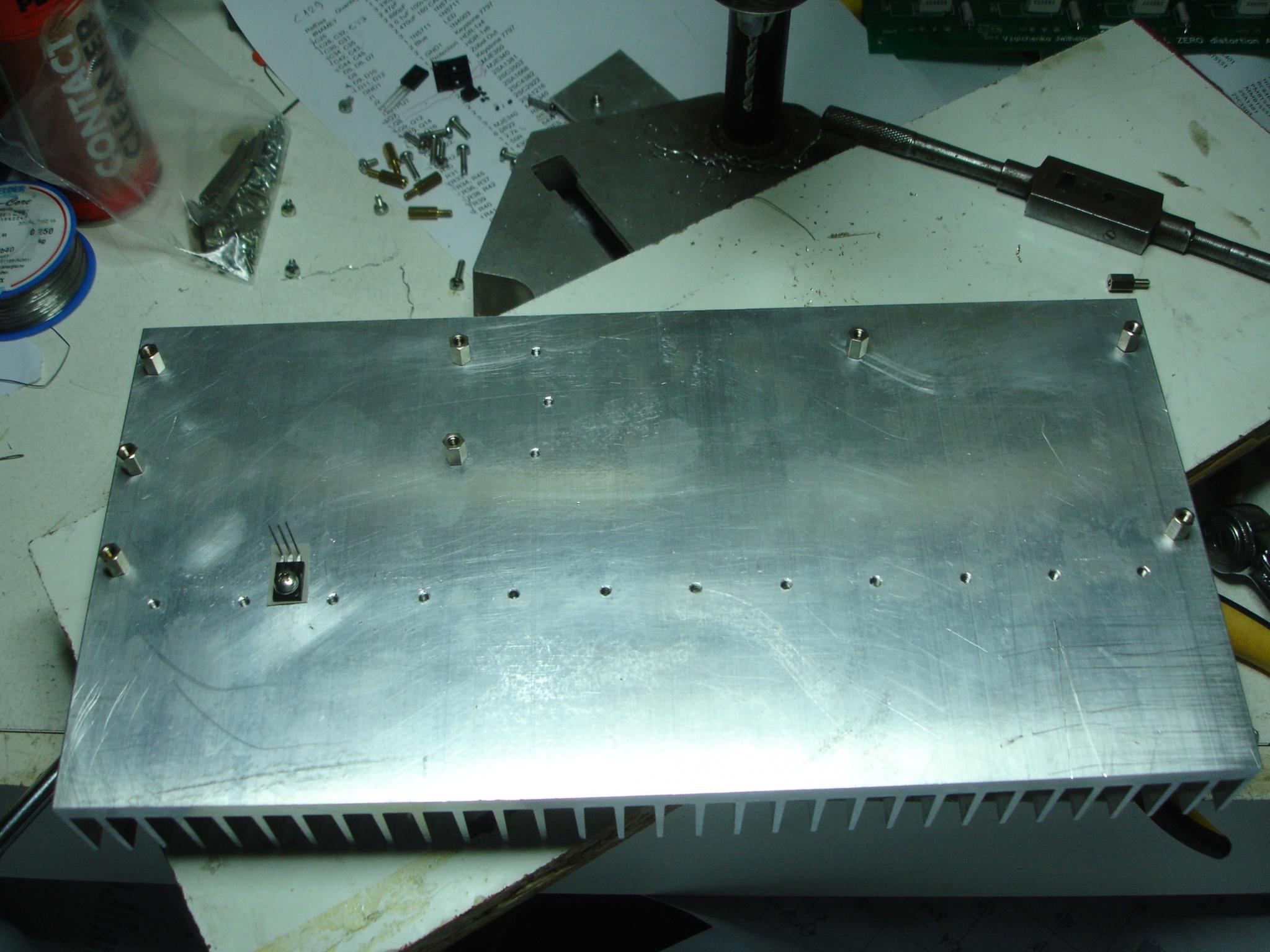

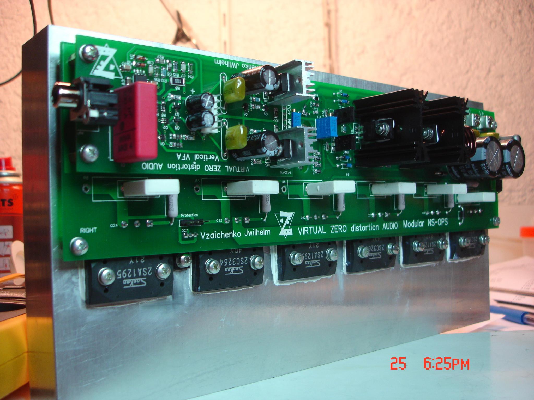

The template I posted was designed for those heat sinks. I have a milling machine, but I actually prefer to tap those heat sinks with a tap in a cordless drill. Very good quality extrusions. As long as you keep everything cool and clean, tapping is very easy.
I can't print the template in correct dimensions😕
When an A4 paper was used i ended up with 2 pages.
When an A3 paper was used the dimensions are not correct .😕
I had tried print<< actual size>> ,<<choose size by pdf>> e.t.c

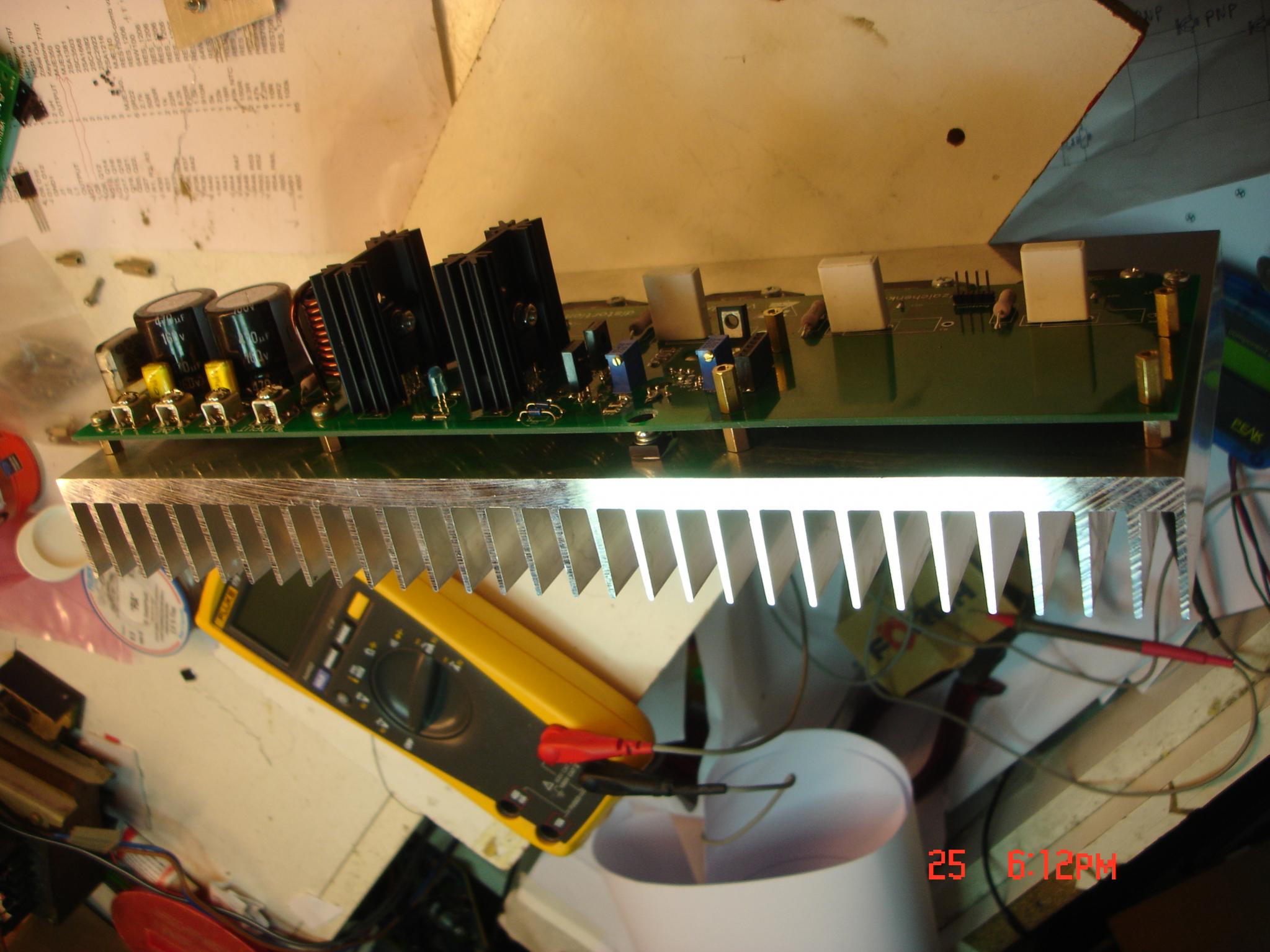

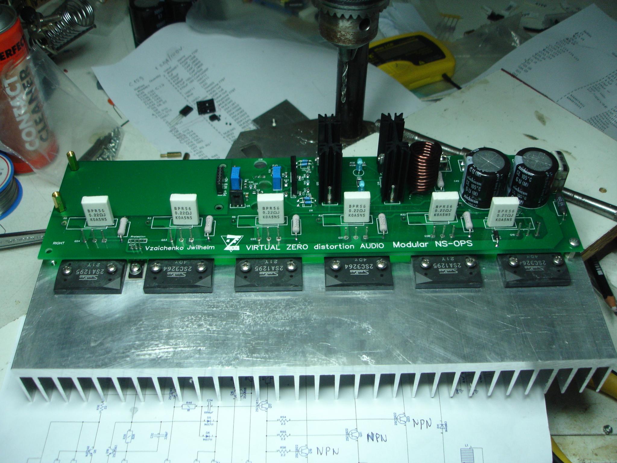

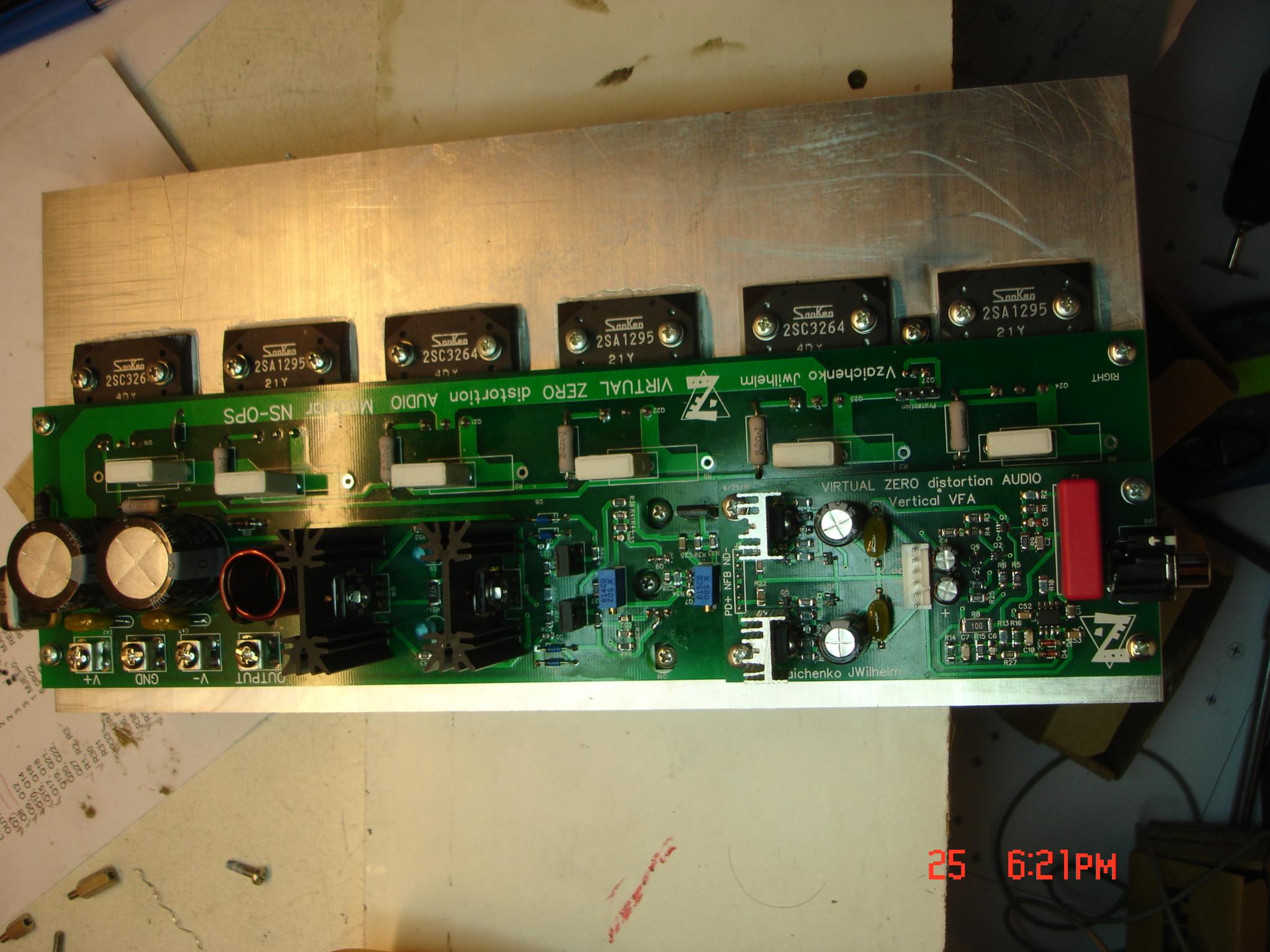

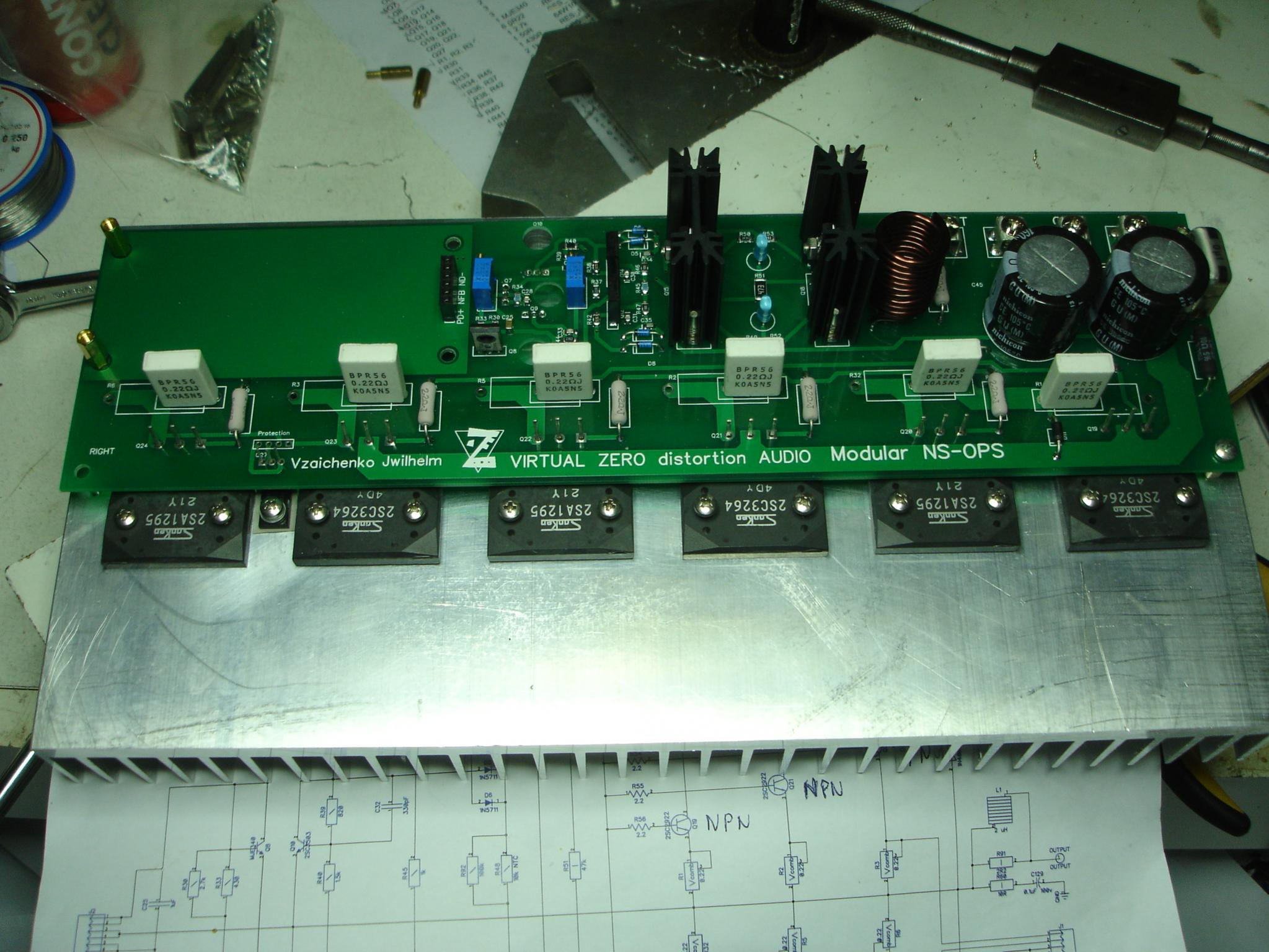

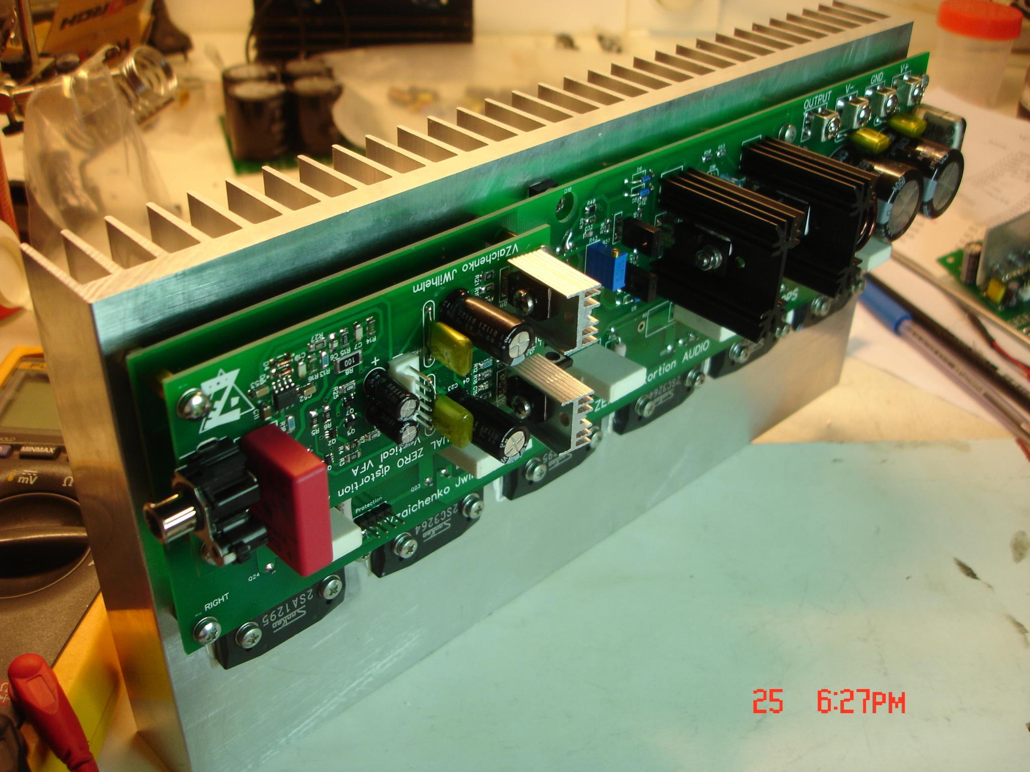

Testing the dimensions
A step farther.
A step before final montage.😉

Looking good Thimios! May I ask what transformer you are planning to use?
Thanks, Terry
I will be waiting to hear of your listening impressions.
Terry,my plan is for two mono amplifiers,i have two toroidals 2x35v/300va,if I had the money I would use 500va.
Carl,from a little listening time using VFA IPS ONLY up to now...it is a wonderful amplifier!
