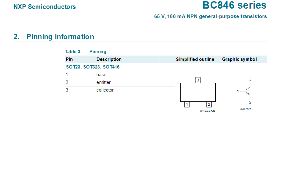

Yes this sot363 dual transistor is smaller to bc846 sot23
Yes it is difficult to solder by hand this sot363

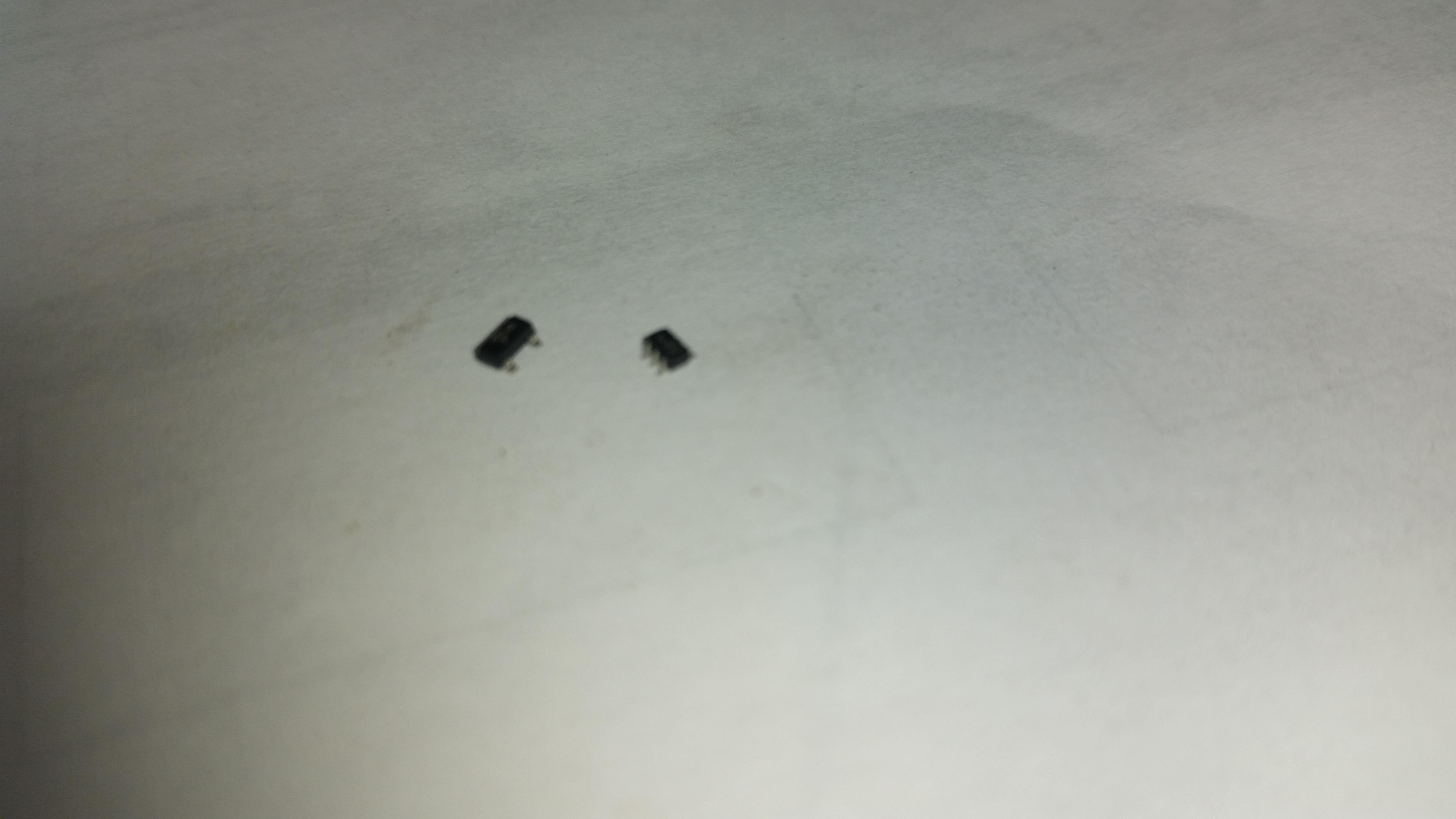

it's the same size as the sot23.
It has extra pins.
It is the same height, it is not top heavy.
Because it has extra pins the pins are clsoer together.
Once the device is tacked by one corner pin, it becomes an easy job to solder the other three corner pins. Then properly solder the first pin. None of this is any more difficult than soldering a 3pin sot23.
The bigger problem is applying solder to the middle pin of each group of three.
Jw has described a method of "swiping" and then cleaning out any shorting between the very closely spaced pins.
I prefer to solder the close fitting pins individually. I have done it with a soic 8pin, but this is nearly double the spacing at 0.05".
They are not the same size. Sot363 2.2mm x 2.0mm x 1.1mm. Sot23. 3.0mm x 2.5mm x 1.1
Biggest issue is aligning very narrow pins on very close pads and holding the part still and aligned to get it soldered. Then clearing solder from between the close pads buried berween the narrowly spaced pins.

I'm not calling you a liar, but I am telling you they are a different size and they are top heavy

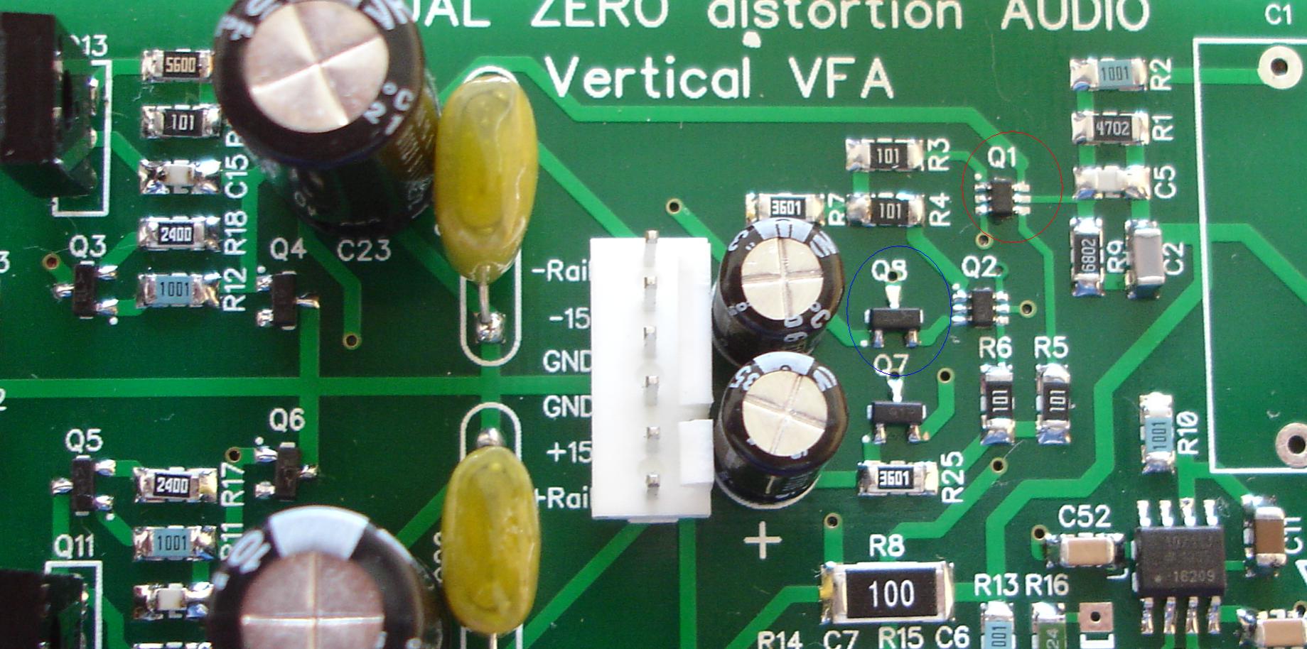

Yes - we can have a matched (and thermally coupled) pair of npn+npn, pnp+pnp, or npn+pnp - whatever we need in particular case - suitable for virtually any kind of a front-end. Lots of freedom for designer.
But there must be some drawback. Difficult to solder manually 🙂 Even SMD opamps - like AD711 - are not that much of a problem as they are slightly bigger.
I'd love to have some more matched-dual or even -quad options available... some C3503/A1381 in a big 6-pin case would be great. As well as some sort of C1845/A992 and N5551/5401 pairs for higher-voltage application. Some jfet pairs would be great. K389 are not produced any more. Just dreaming 😉

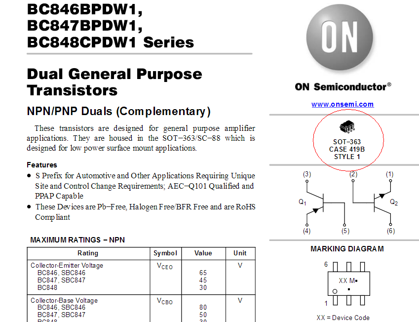

BC846BPDW1T1G dual NPN-PNP. not reported on datta seat as matched devices😕
Hi Thimios,
You are actually right. NPN-NPN and PNP-PNP duals are matched within the package. NPN-PNP ones are complementary, so they are never really matched. However, if you look at the curves in the datasheet, NPN and PNP ones are rather close to each other.
It would be interesting to compare h21 and Vbe measurements within NPN-PNP dual - never really did it.
Although these duals perform very well, so I never felt the need for this kind of comparison 🙂
