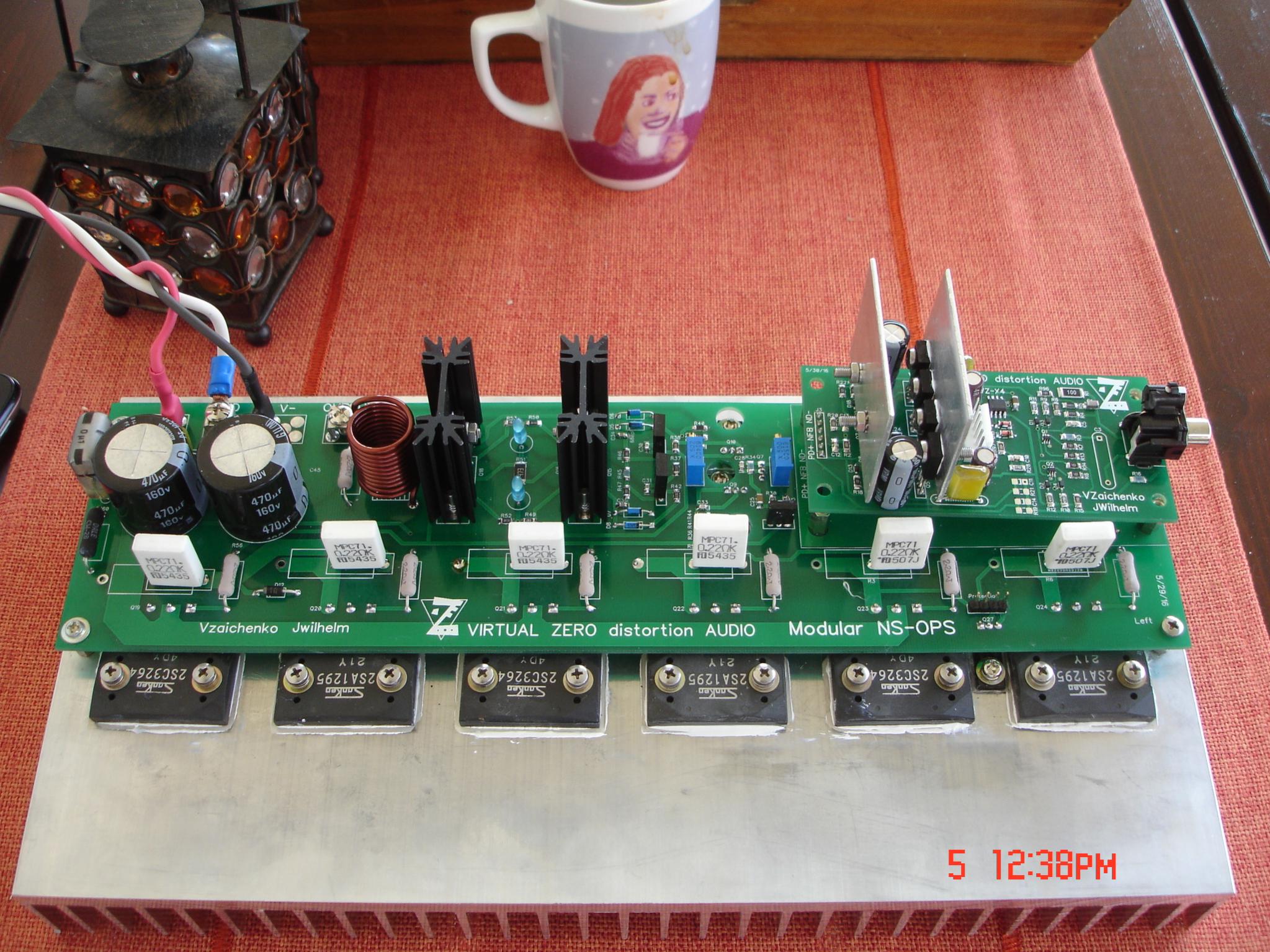

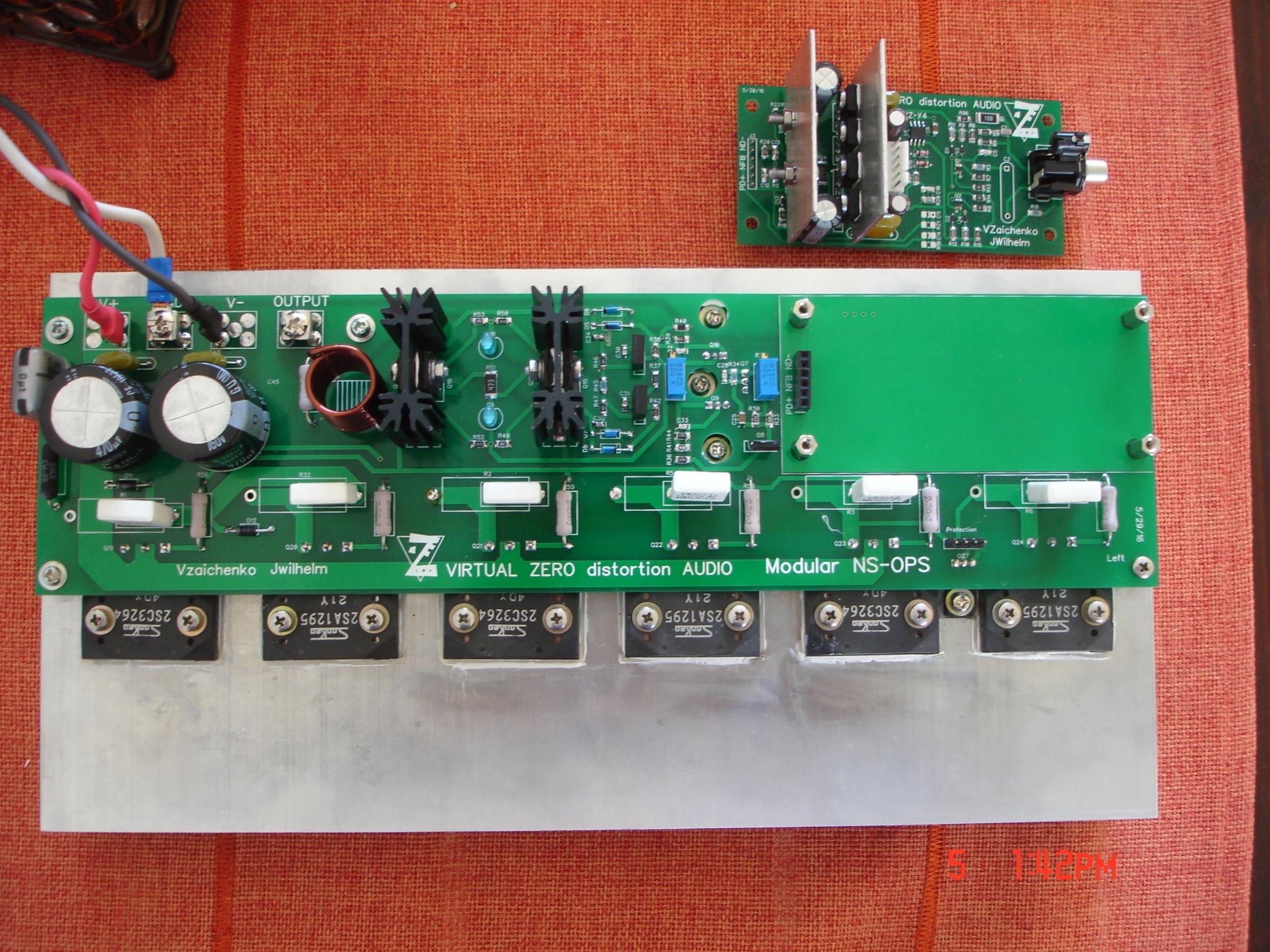

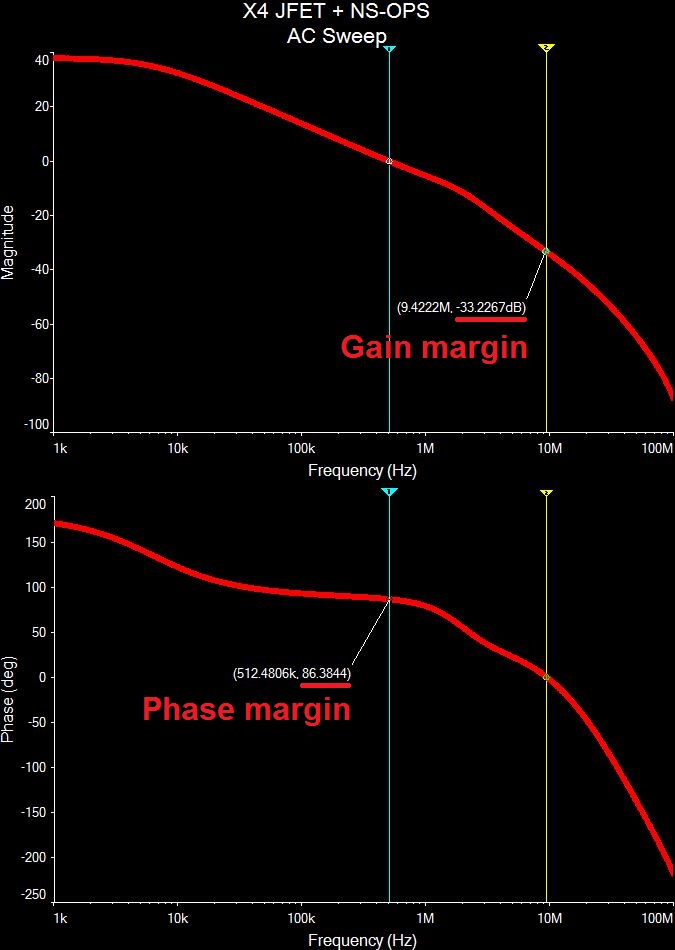

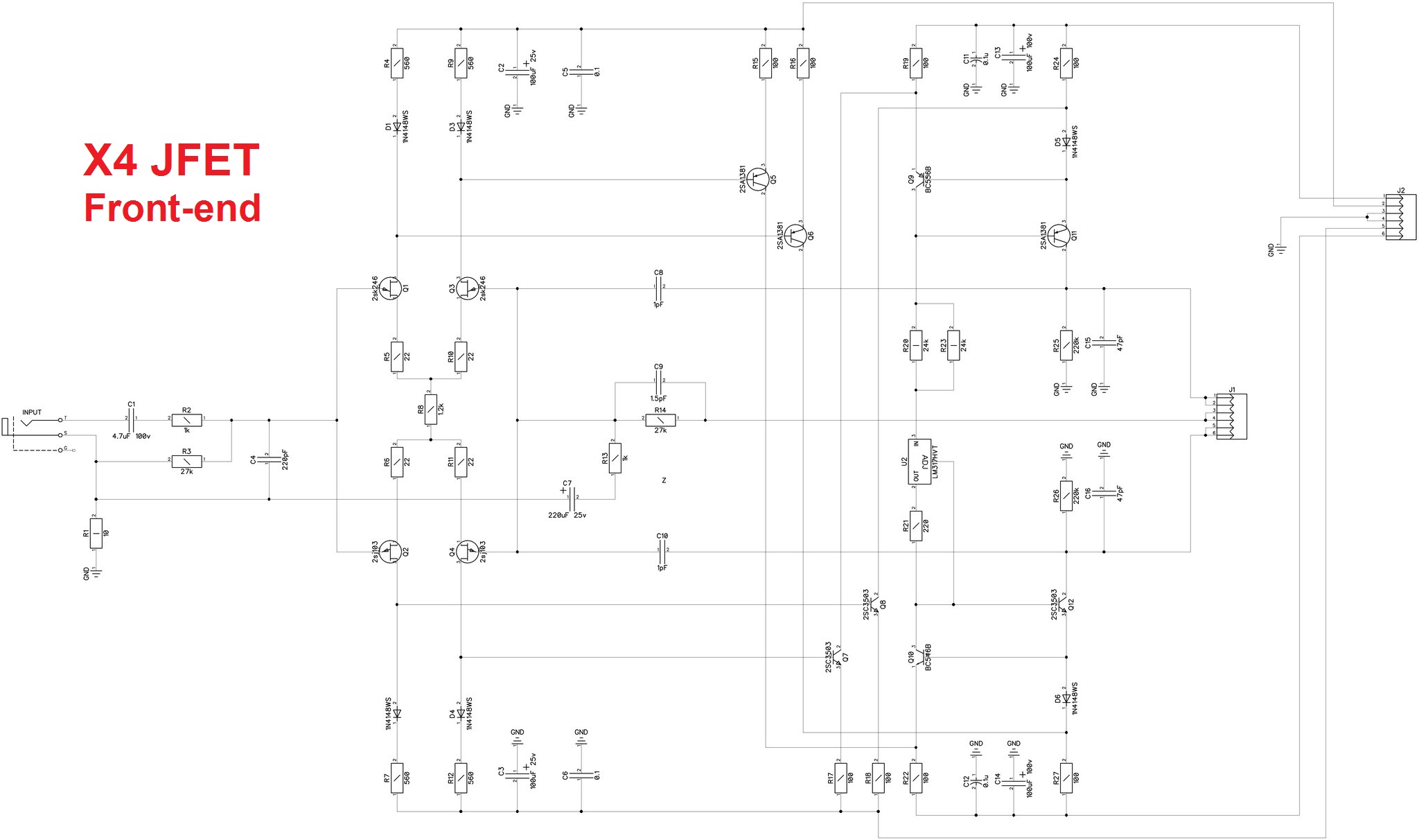

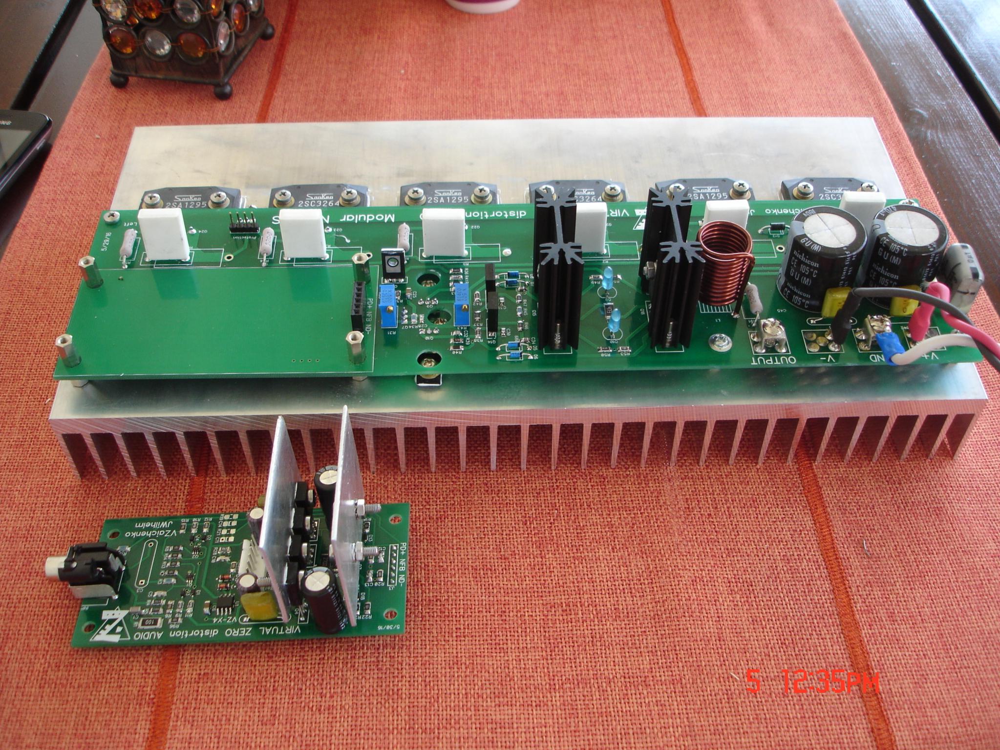

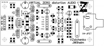

X4 JFET front-end module
OK, here is something we've been missing.
Current-drive family is enhanced by X4 front-end with JFETs at the input.
This one provides excellent step response and very accurate waveform reproduction in general. Relatively low global loop gain (38db @ 1KHz) in combination with very high linearity and light compensation - a bit of lag-shunt at VAS output and a bit (almost none) of lead from the output to FB junction point and from the VAS output to FB junction point. Overall THD is less than 0.005% at 20 KHz (20V RMS @ 8 ohm). Low phase shift at the higher end of audio bandwidth. Clean clipping. Huge stability margins (feedback loop analysis is attached). Rather cool thing 😎
It's going to play nicely, although I did not test this particular one as yet.
It will be interesting to see if there will be some audible difference with BJT-based X4 front-end, which is already in production.
I know, these ones (K246/J103) are hard to find on many territories.
These one are especially good for the input stage because of their low transconductance.
I'm buying as many as I can from the local suppliers right now. They are out of production and I don't see any good complementary alternatives these days.
PCBs are available, but only double-layer ones, suitable for NS-Modular.
If somebody is up to designing a single-layer trough-hole one for etching - more than welcome.
Valery

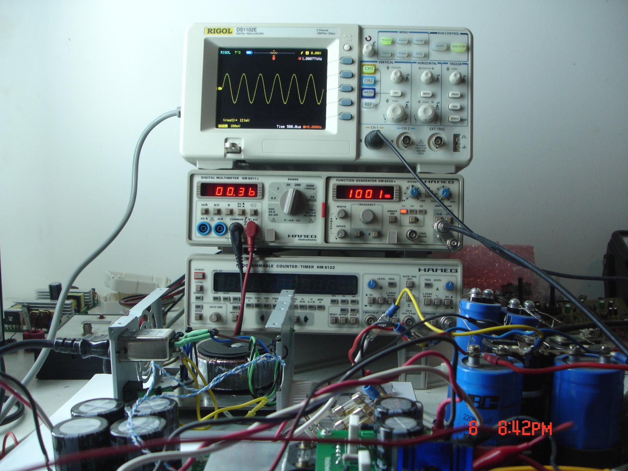

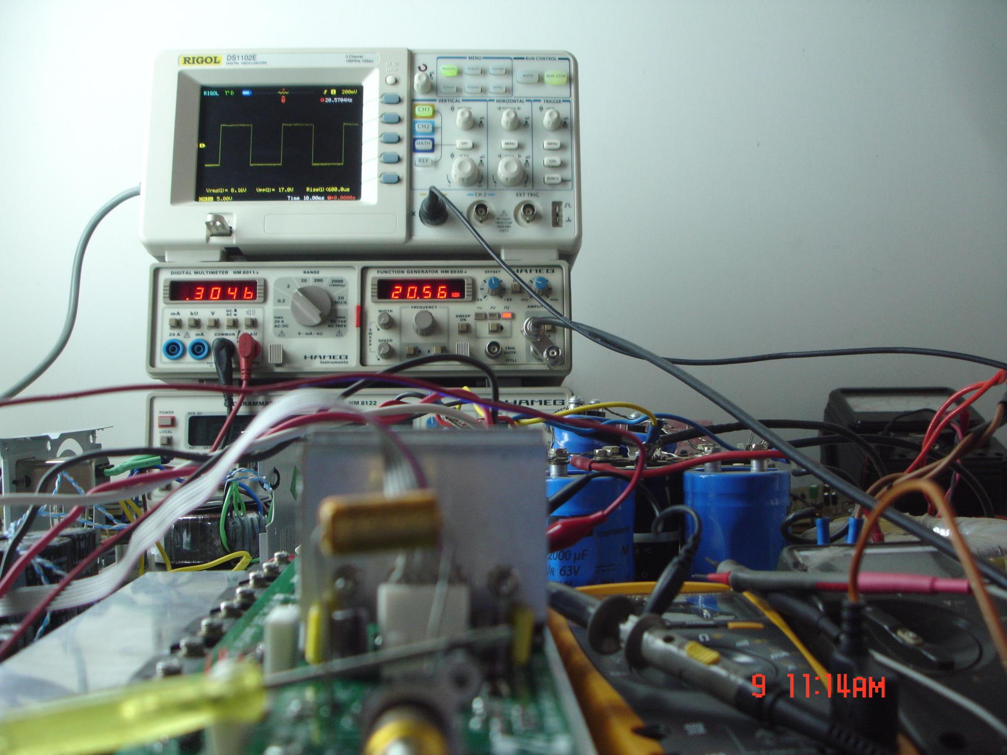

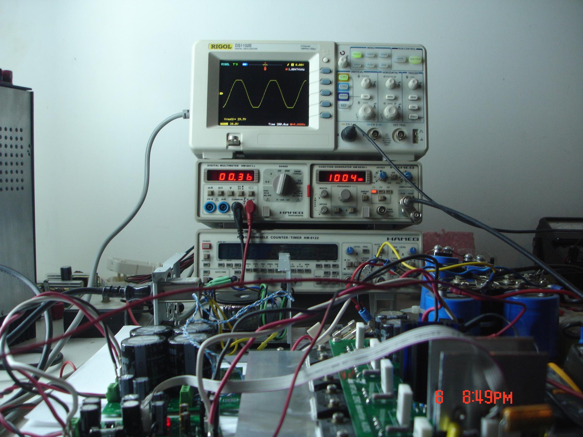

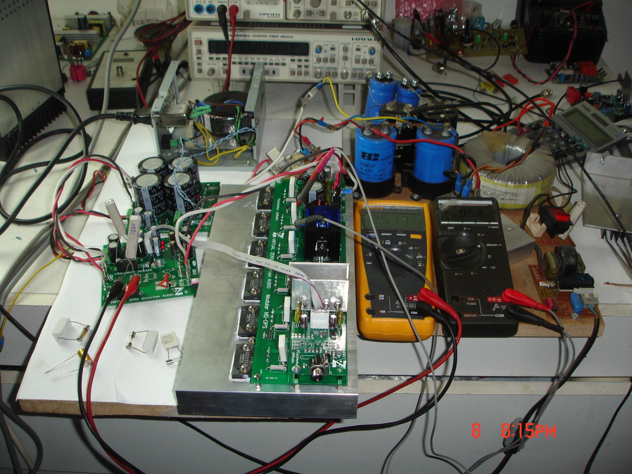

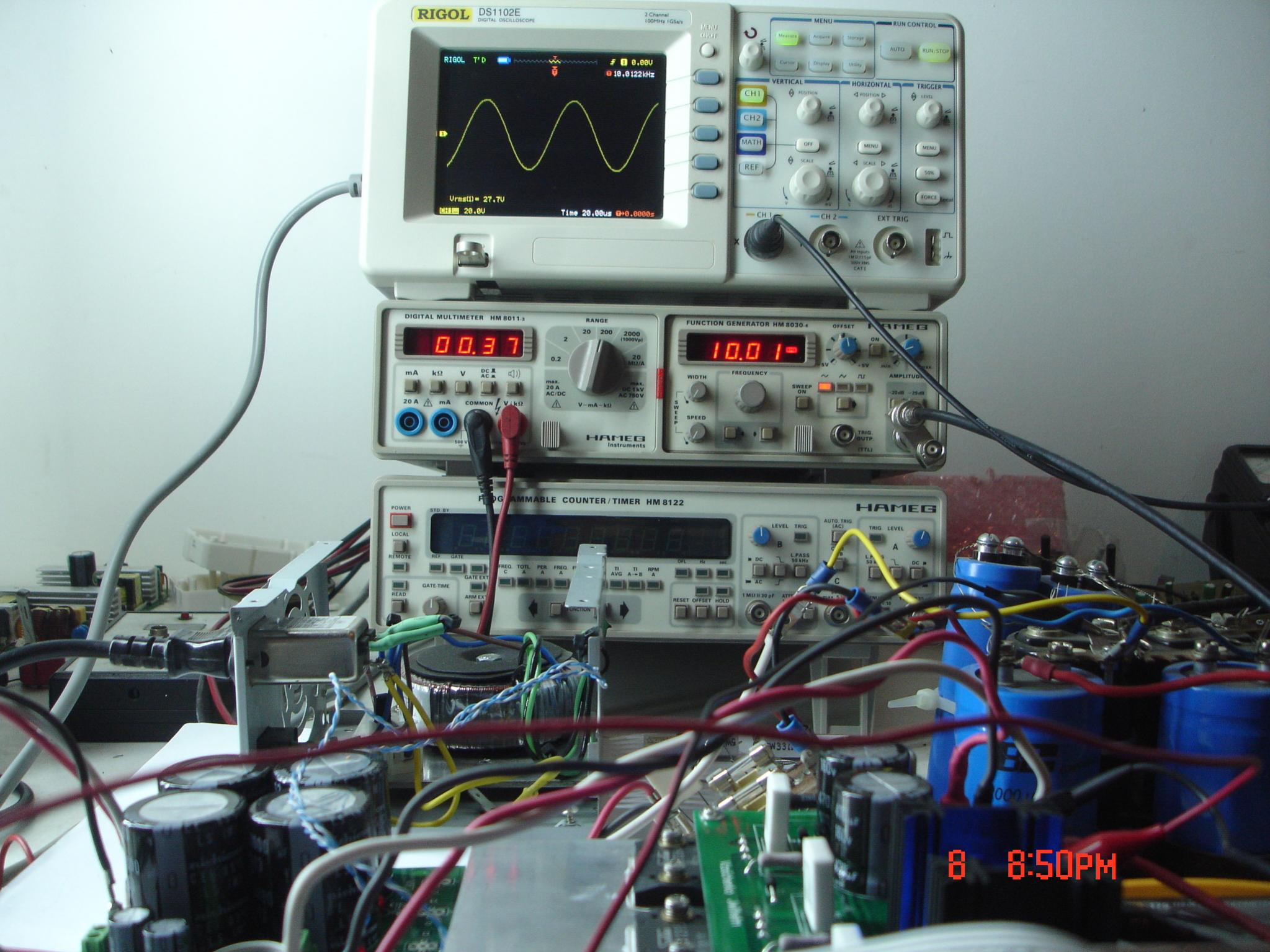

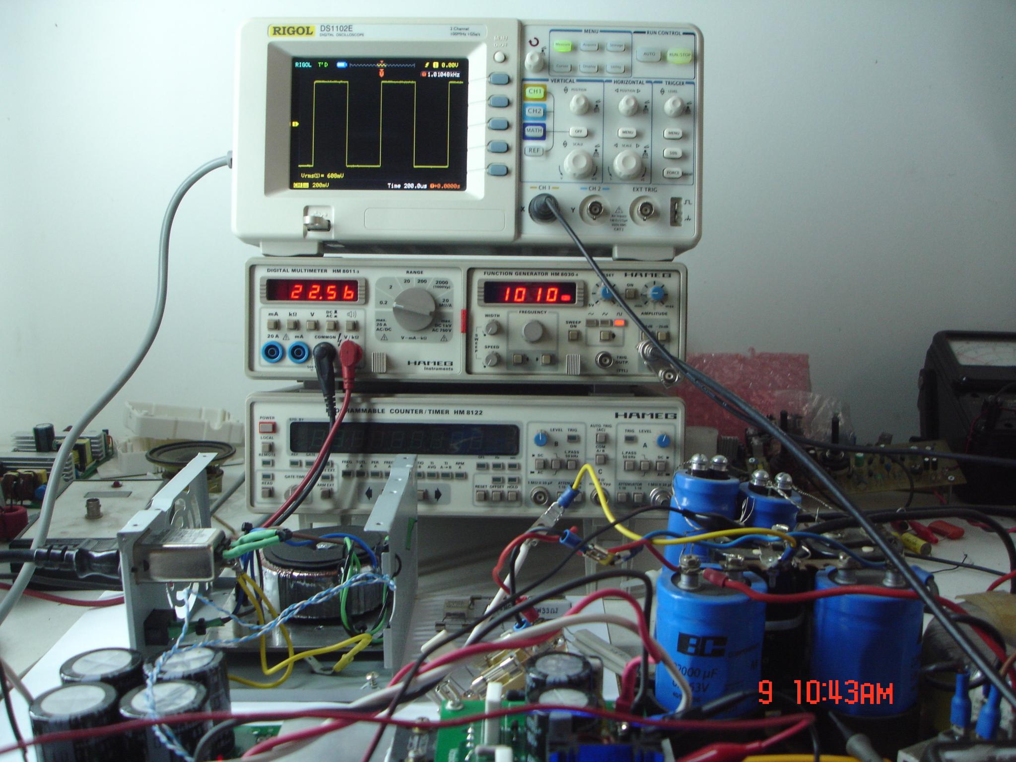

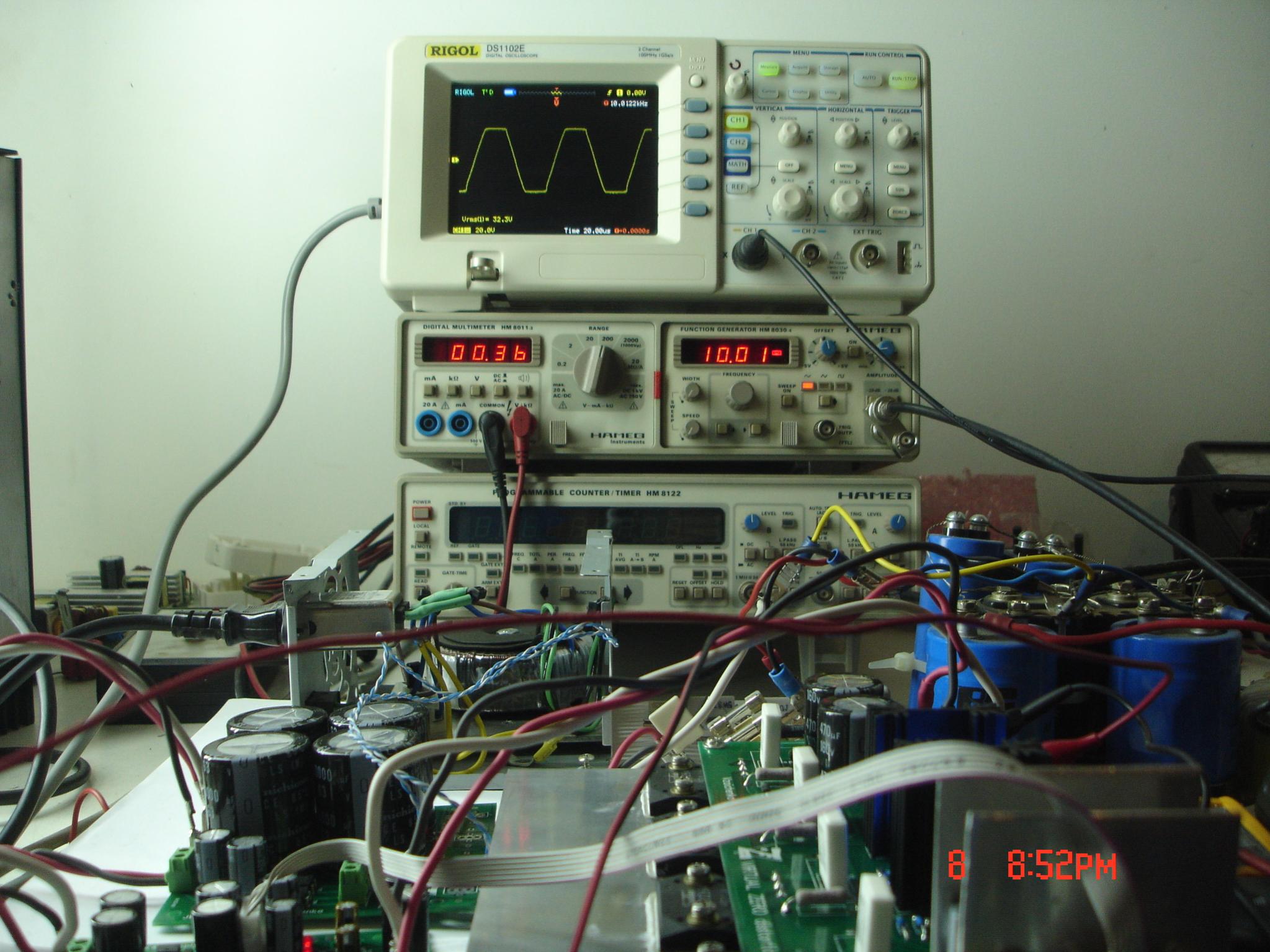

vz-x4 + NS OUT sinusoidal test
Power Supply=+/-50v
74.000uf/rail
Idle current=35mV
Offset=0mV
1V RMS in=27V RMS out on 6R Dummy load=121W RMS/6R (tested at 1KHz)
Power Supply=+/-50v
74.000uf/rail
Idle current=35mV
Offset=0mV
Site is down,here is the rest
Looking good.

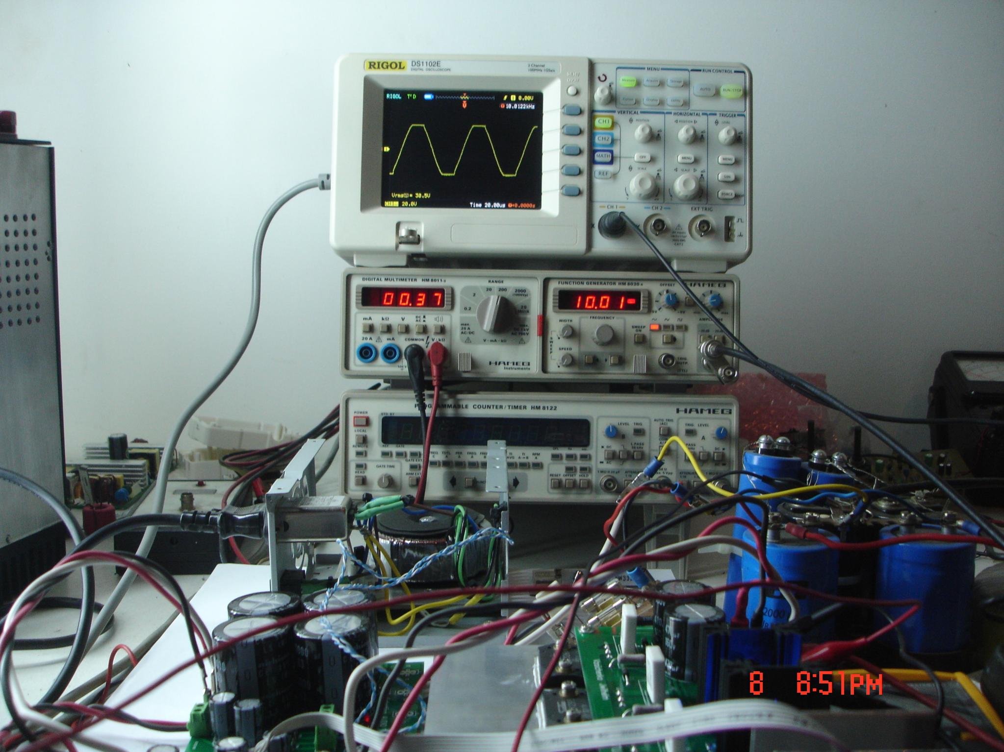

Maybe a square wave? I normally test at 20v peak-to-peak, as the sqr wave drives much more energy and everything becomes rather hot.
Coming soon😉Looking good.

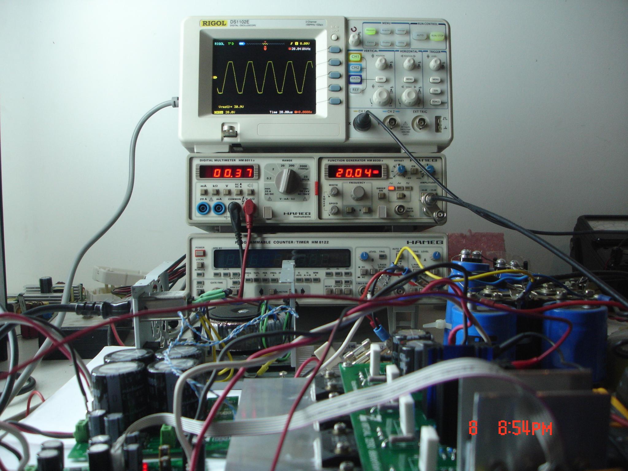

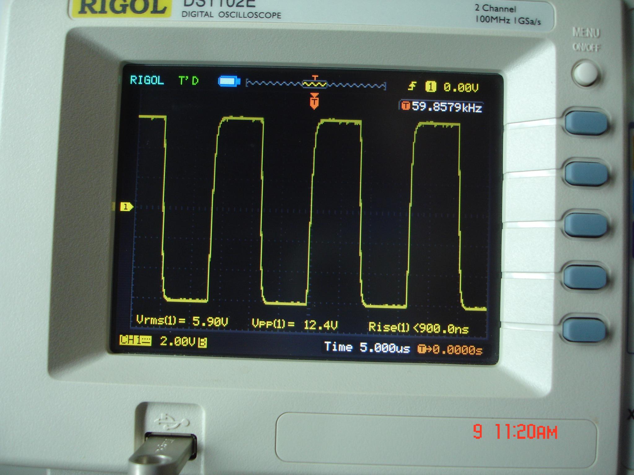

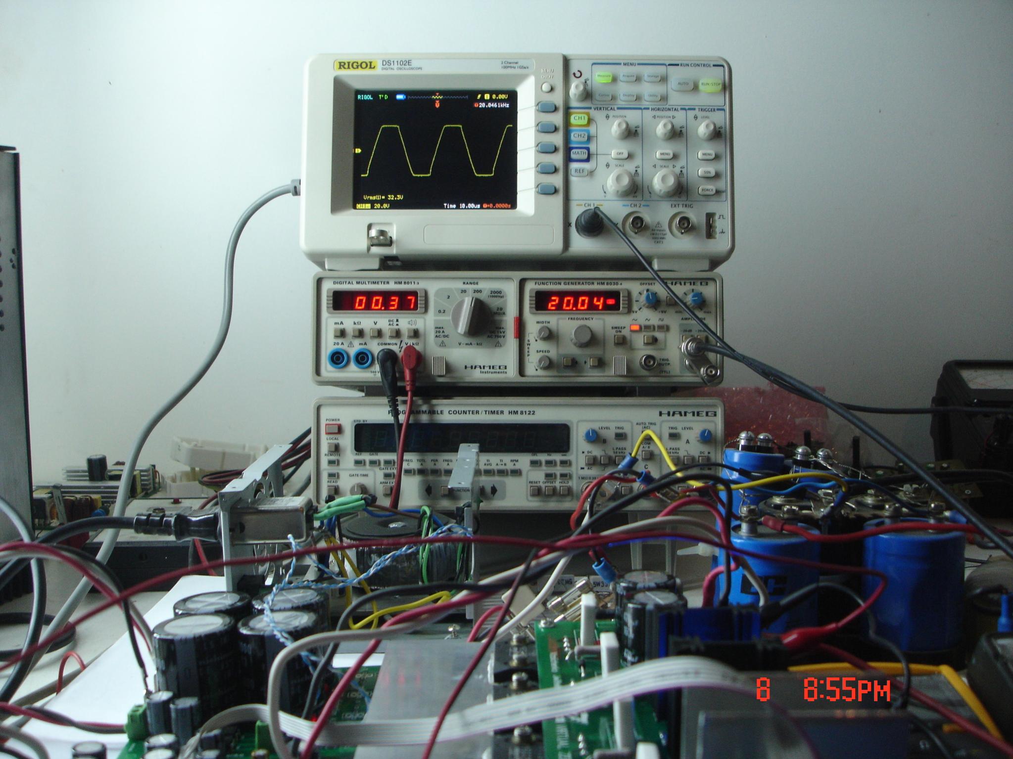

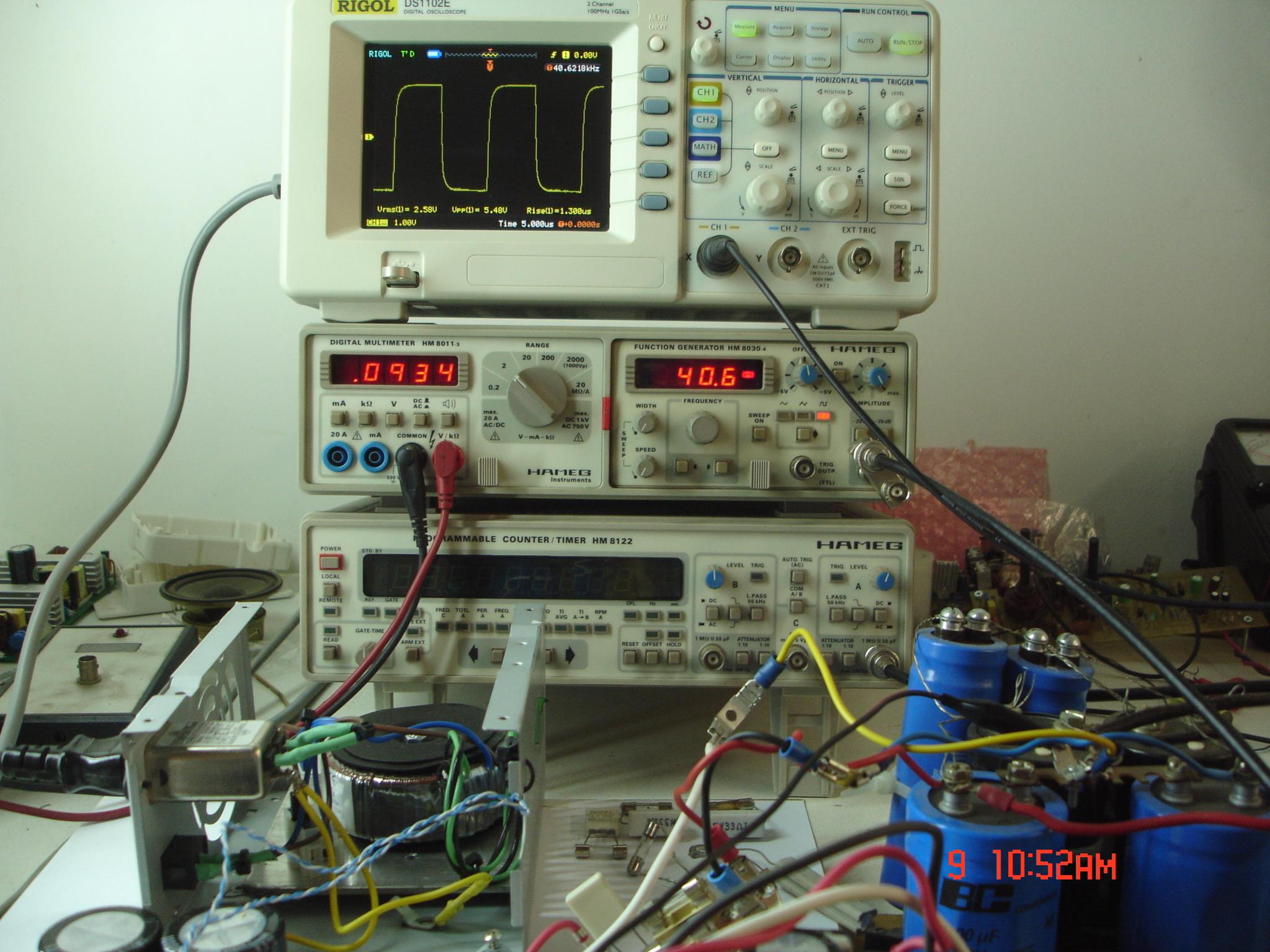

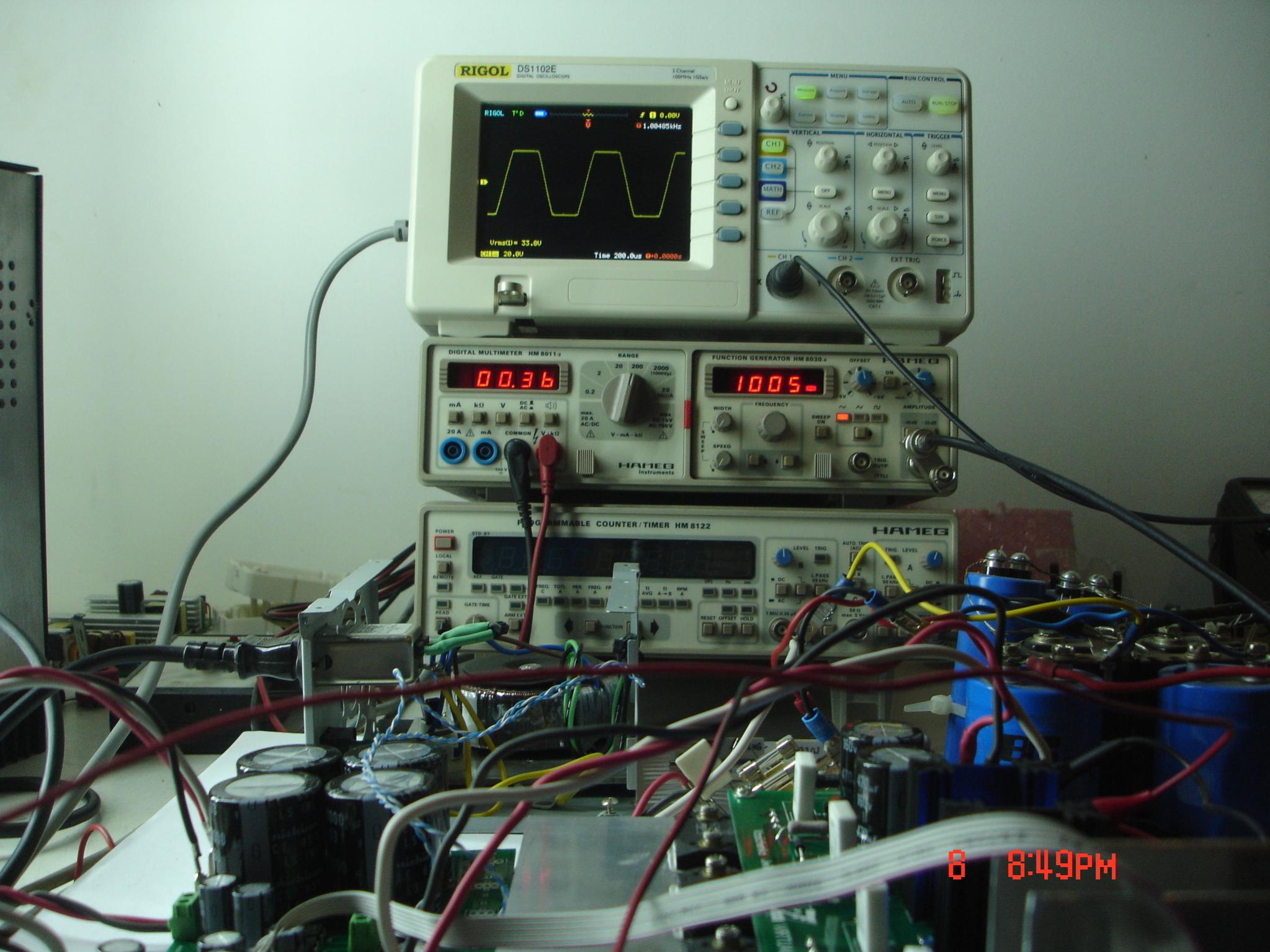

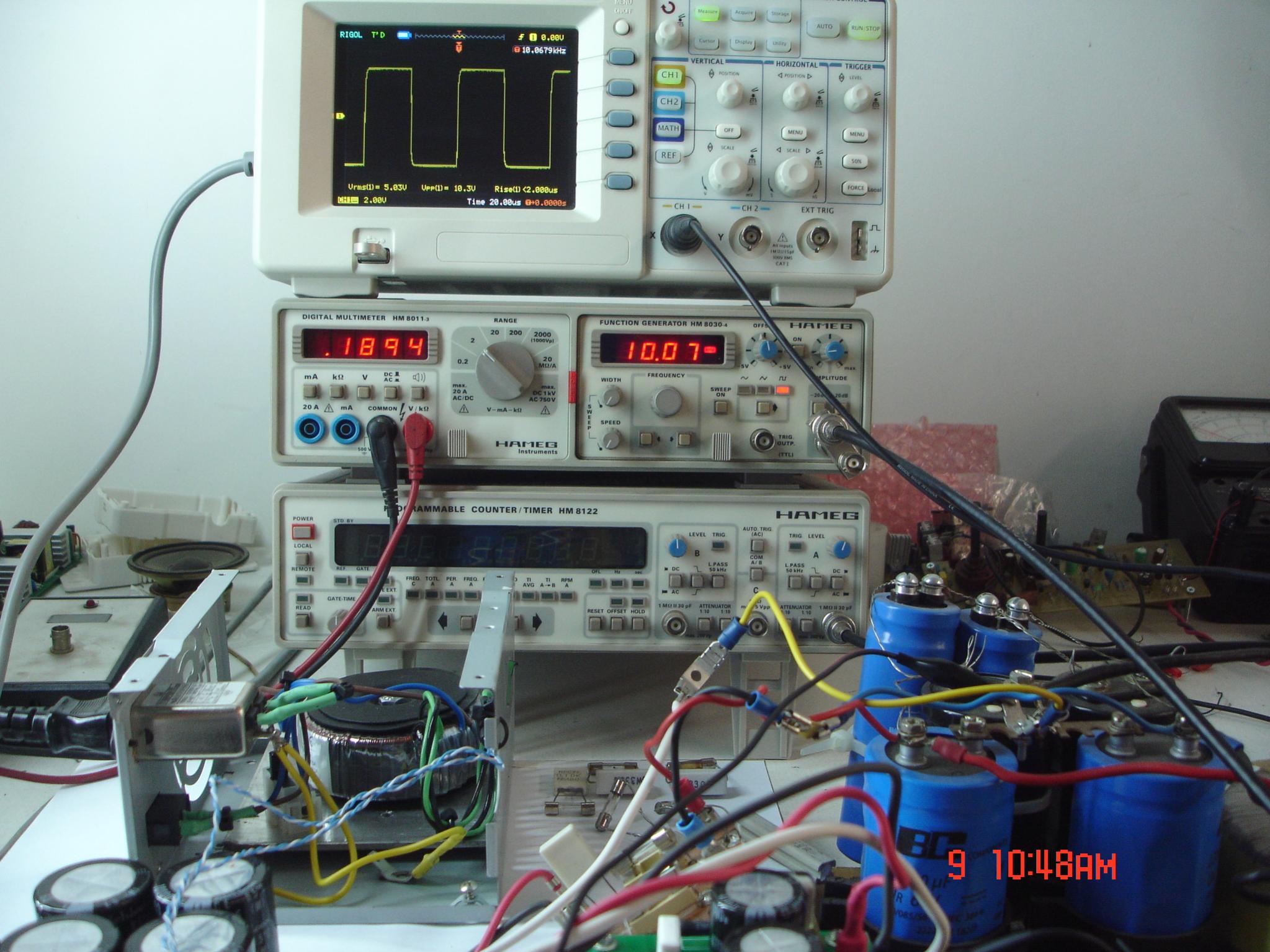

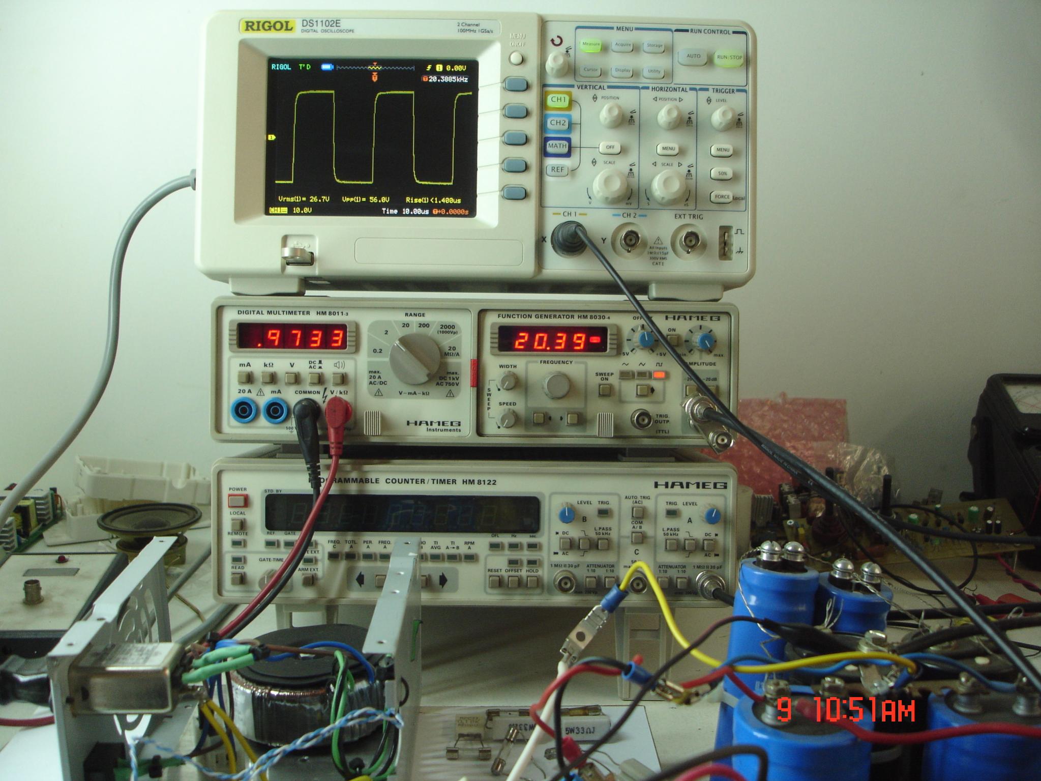

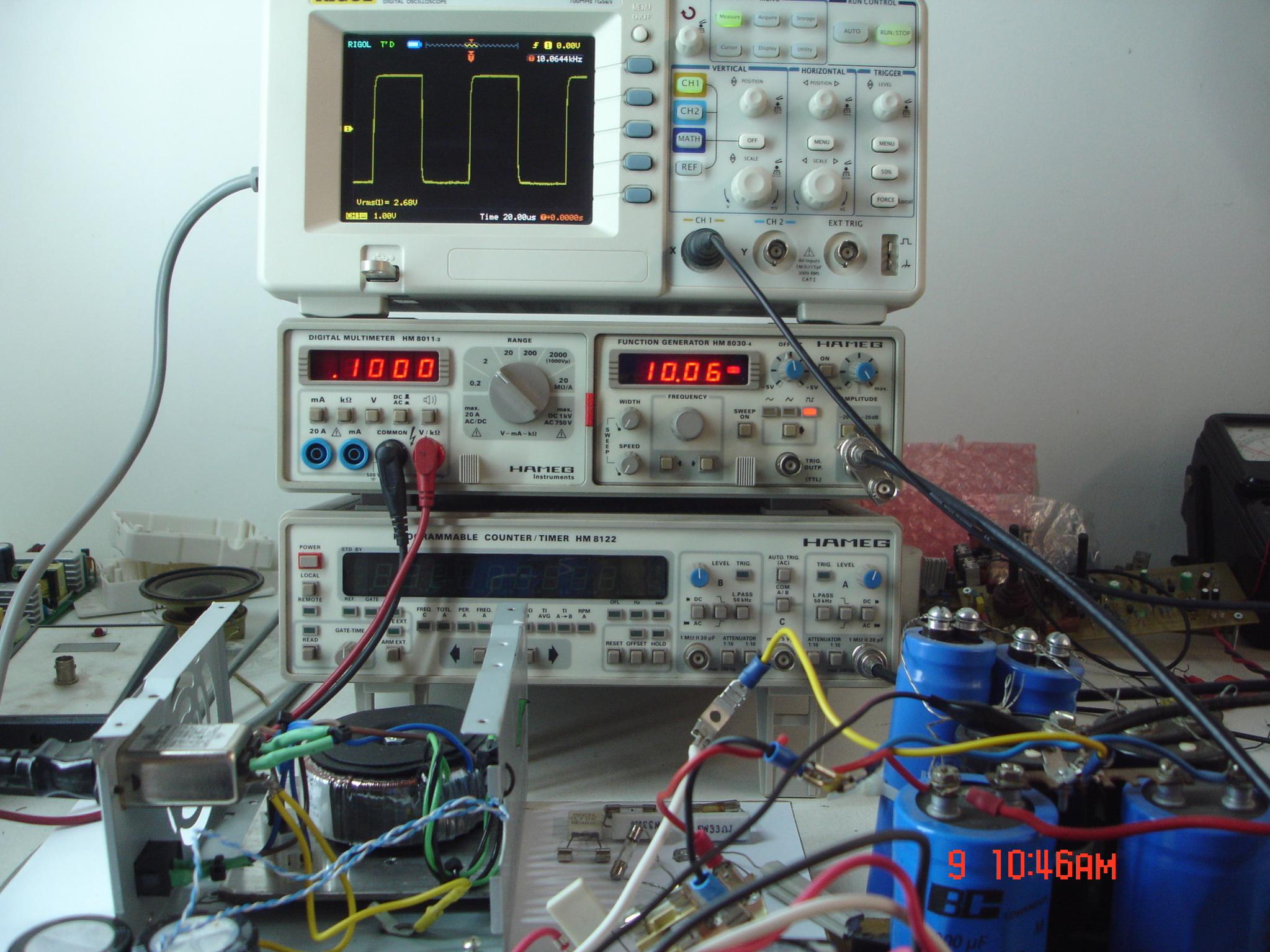

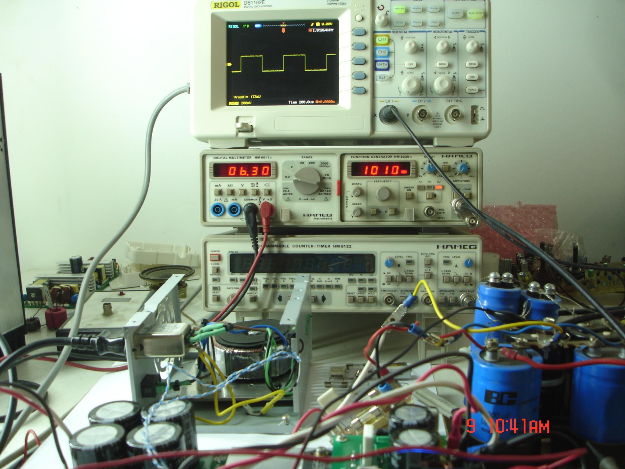

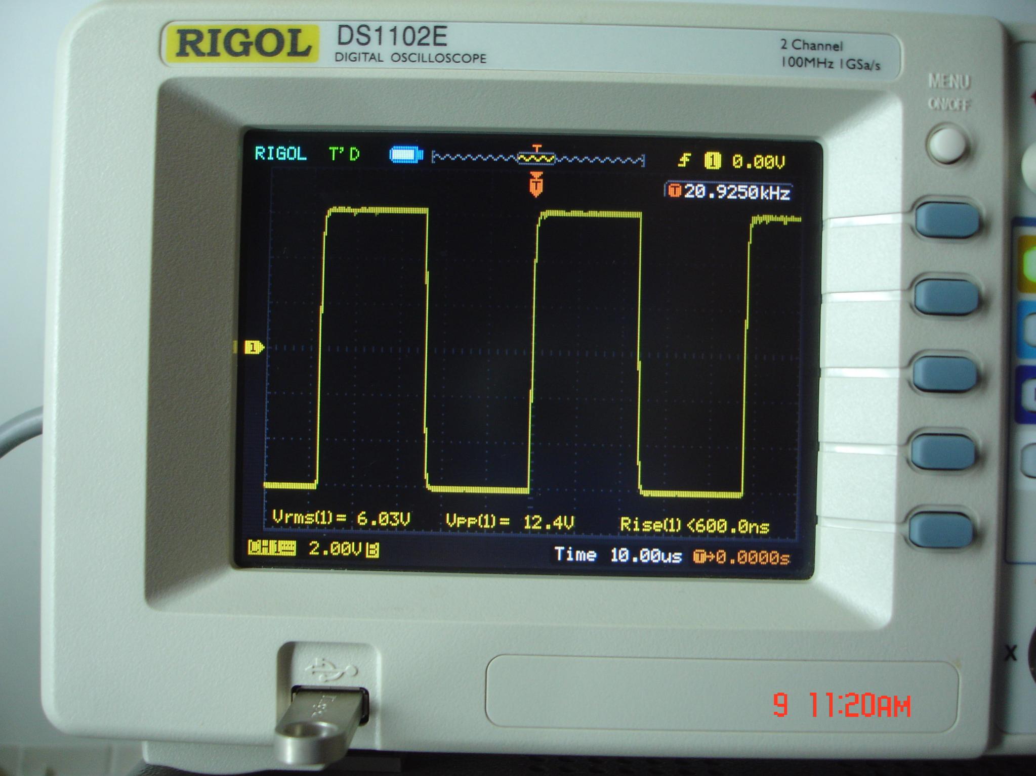

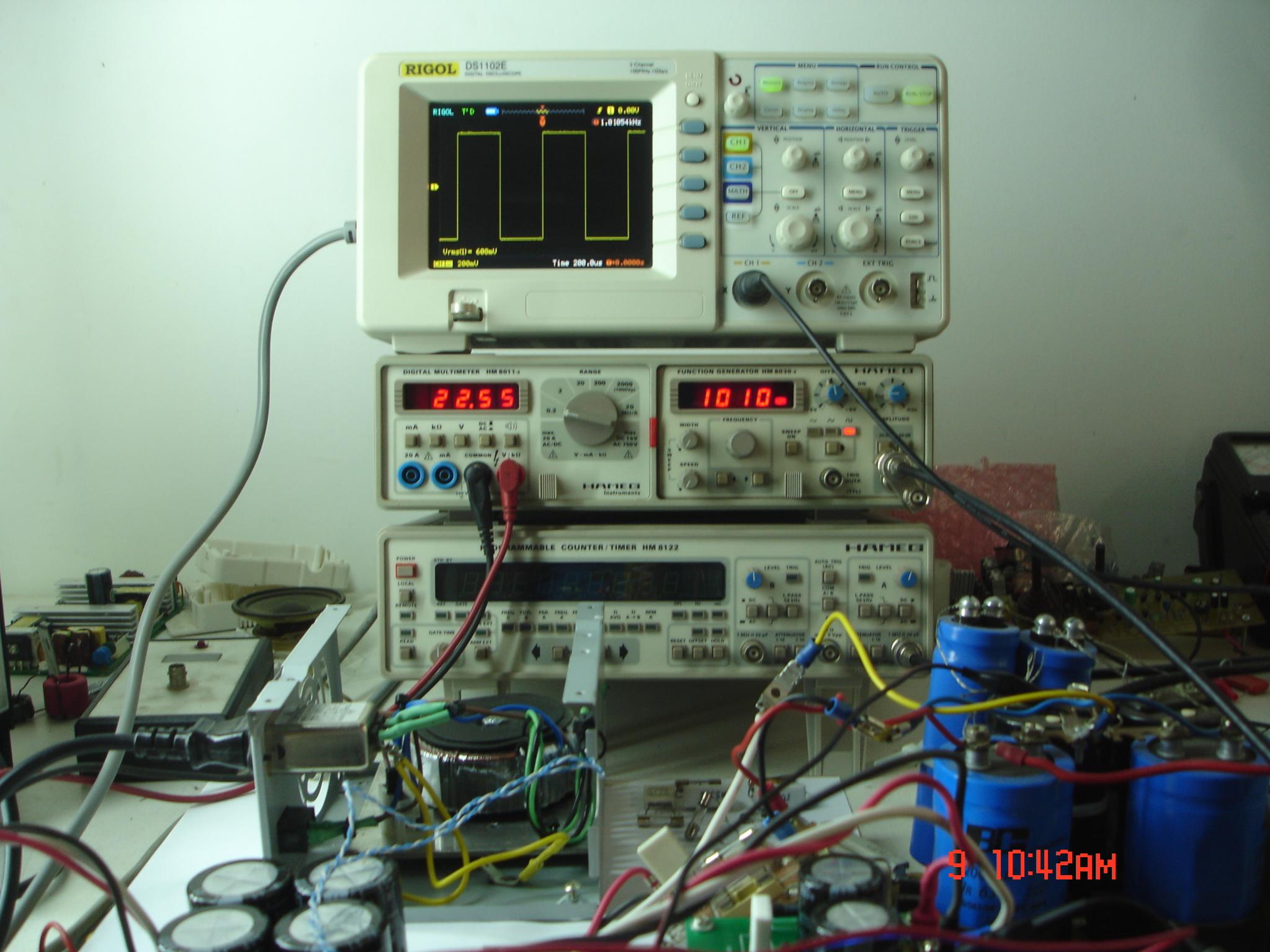

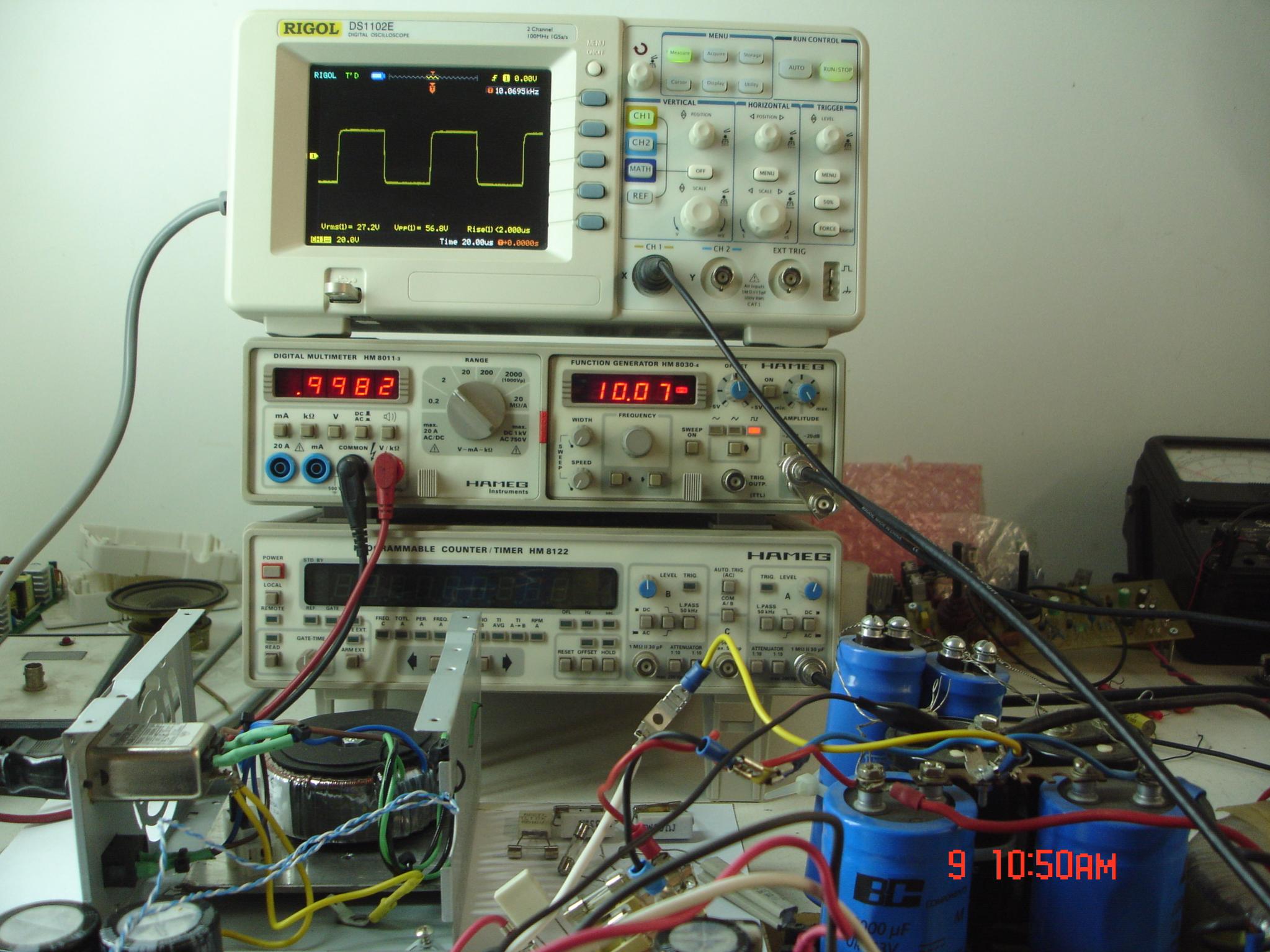

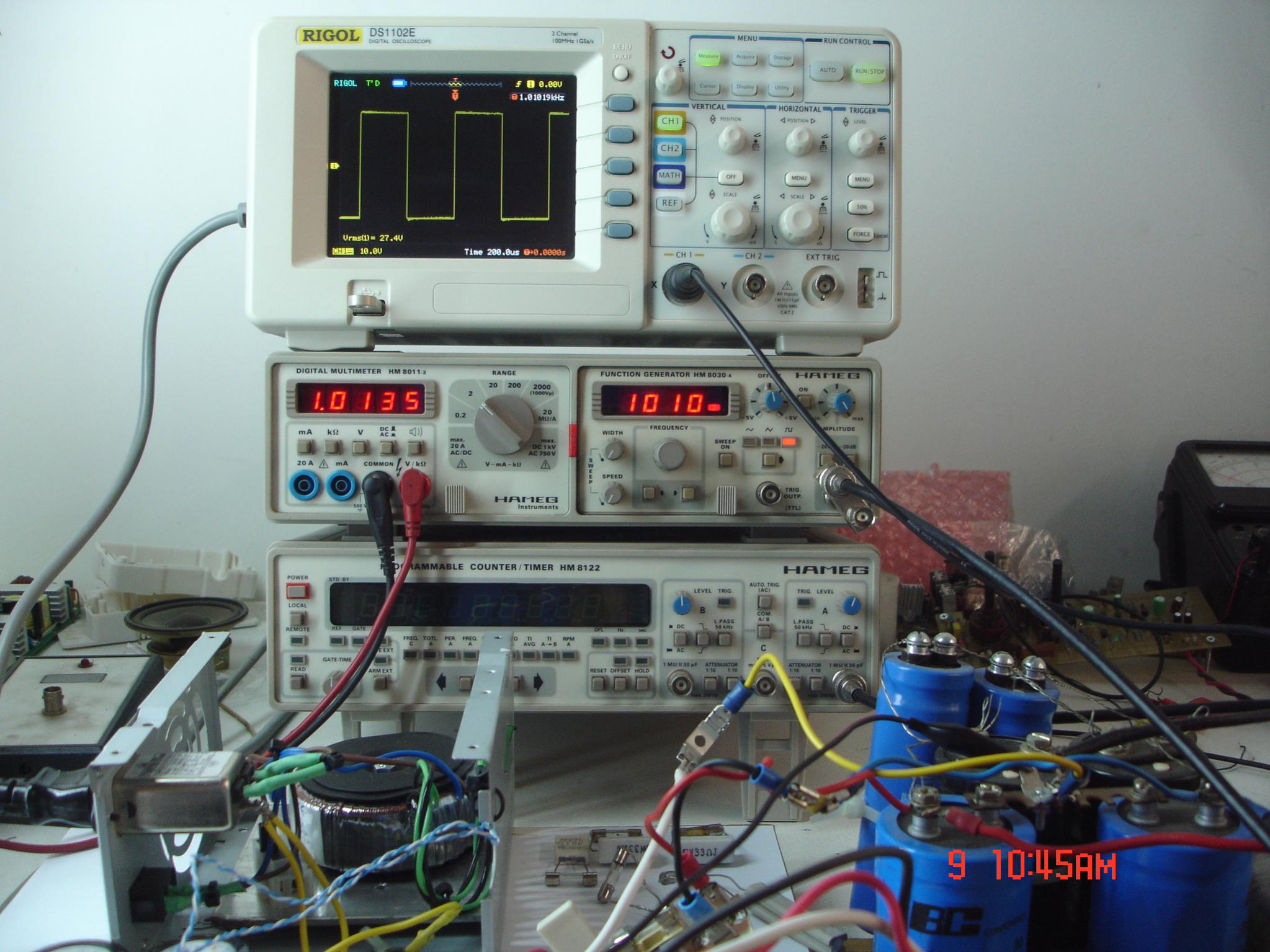

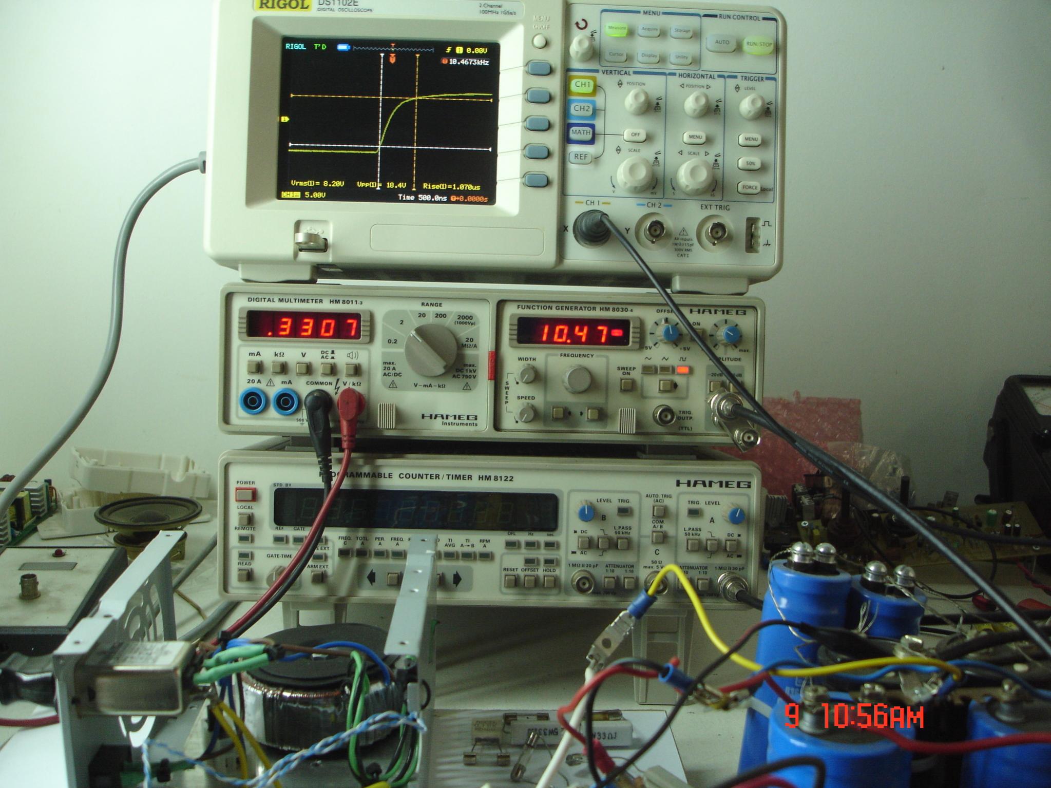

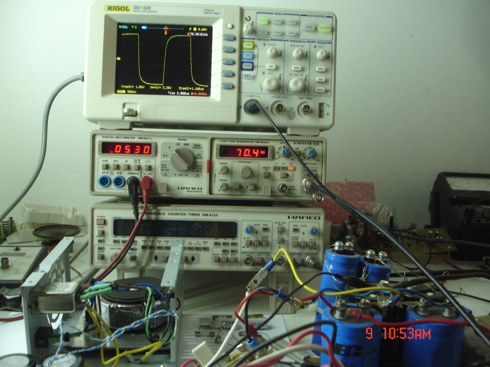

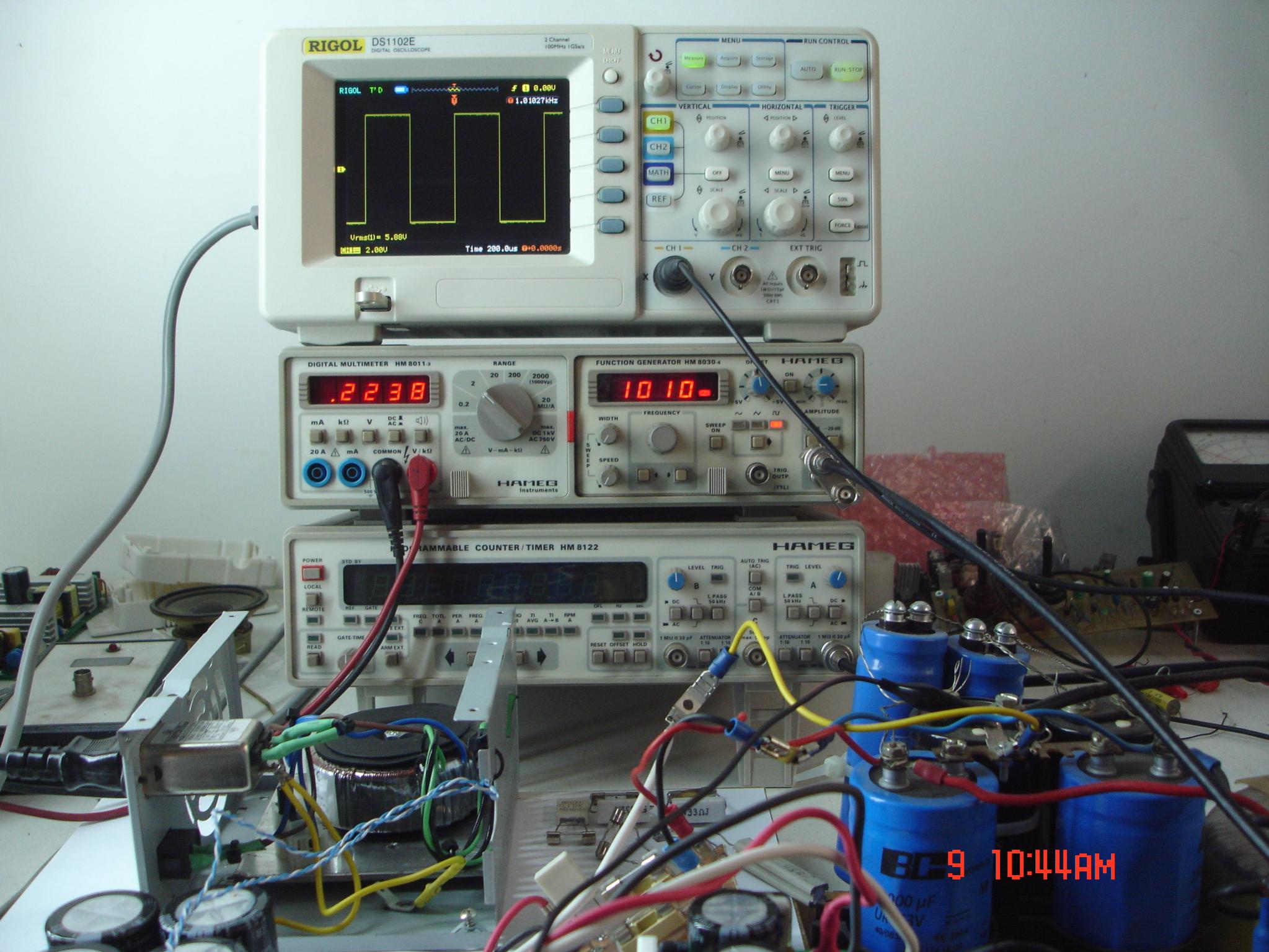

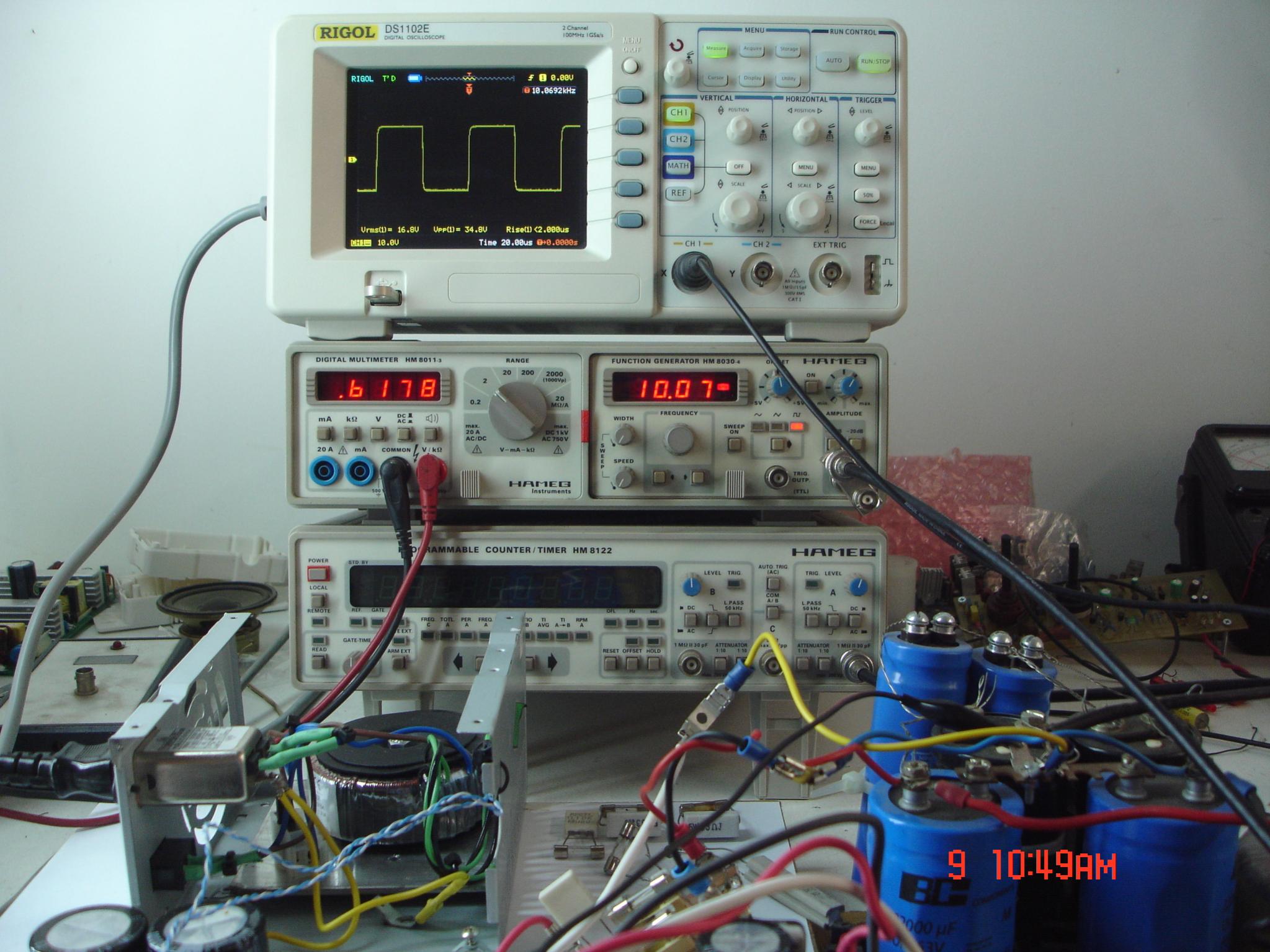

VZ-X 4 square wave test
Peoples love to see square wave😉
Voltmeter show the input voltage.
Read the out voltage on scope.
Read the test frequency on scope or on the function generator.

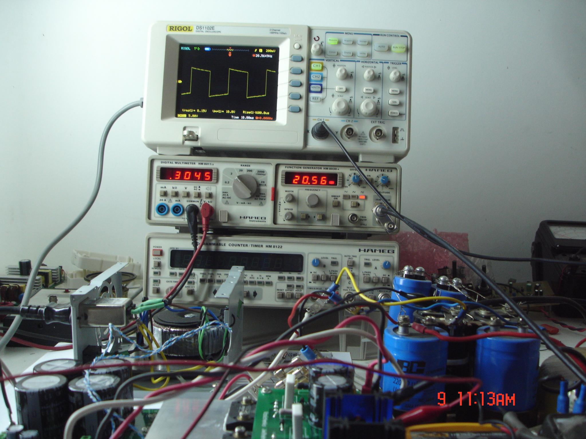

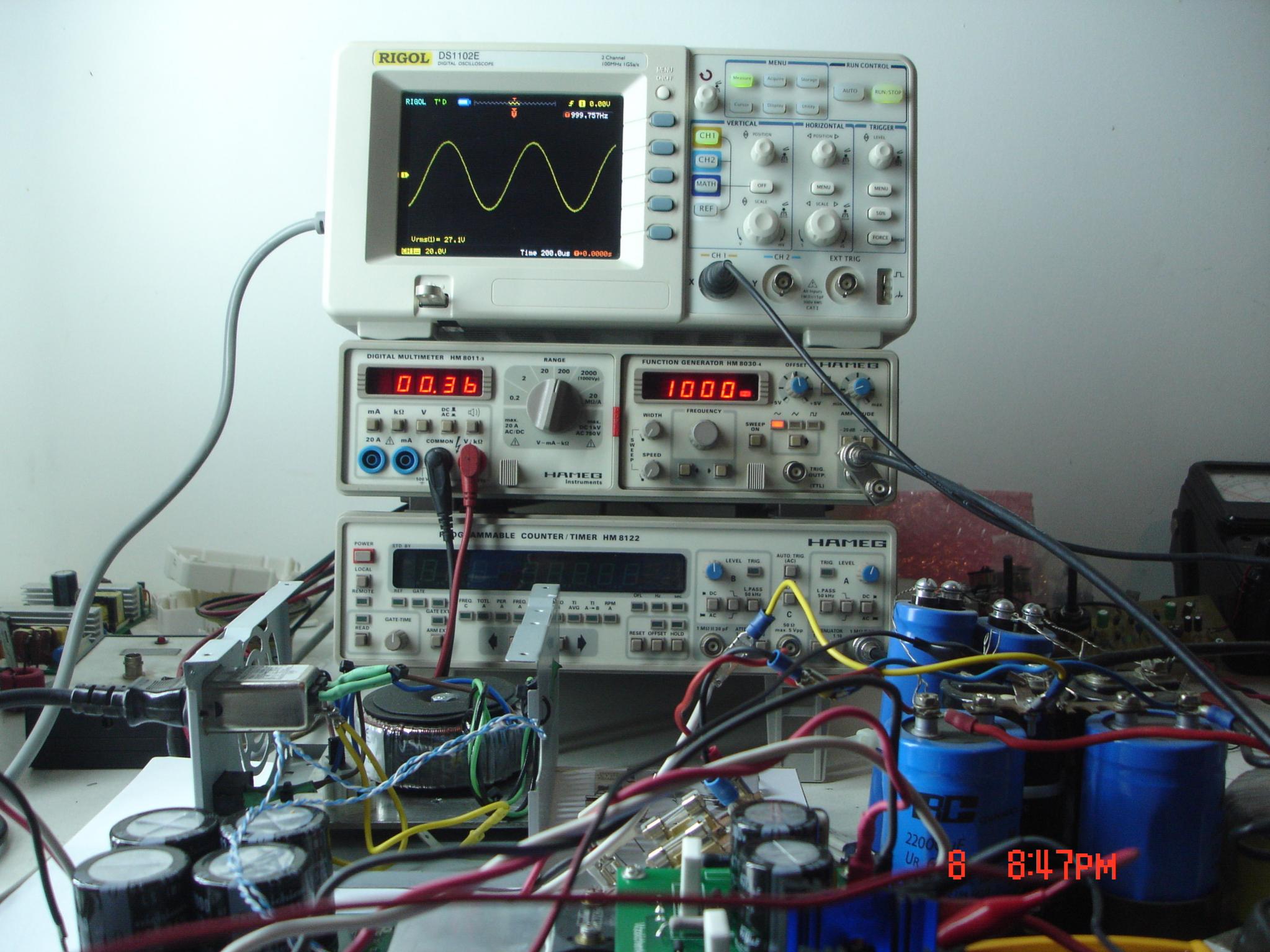

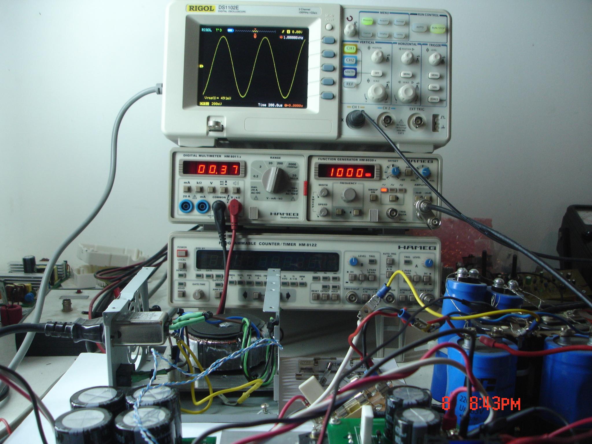

OK, high-precision 1KHz 😎
Ah, ok - more pictures are coming 🙂

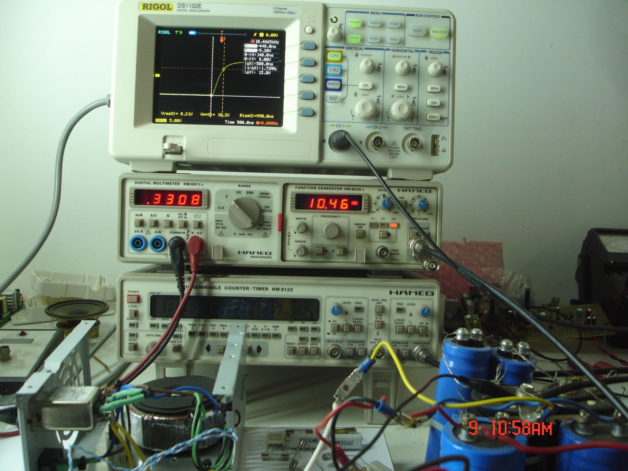

10 KHz looks as expected - compensated for having slightly rounded corners for more reliability in "mass production".
please wait the best is coming😉OK, high-precision 1KHz 😎
The picture before the last is low freq, using 3u3 bipolar as coupling capacitor when the last is direct coupling
