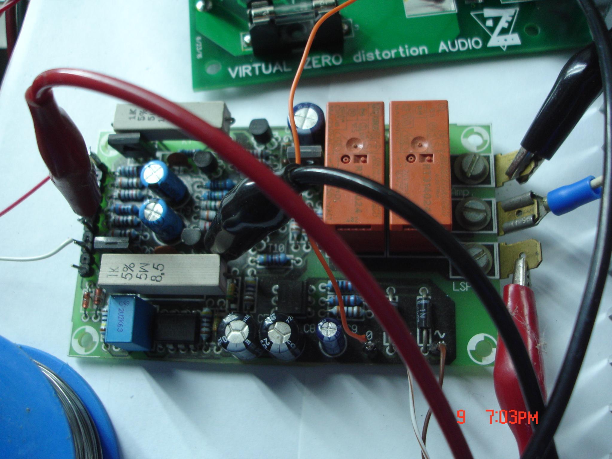

further test for d.c presence
A protection board(relay based)was added to see what happened.
This circuit publised in Elektor as a part of Crescendo Millennium.
To be more clear only the d.c protect option was connected.
This amplifier comes in protection mode before clipping occurs😡
This protection board activated with +4.5v d.c at least.

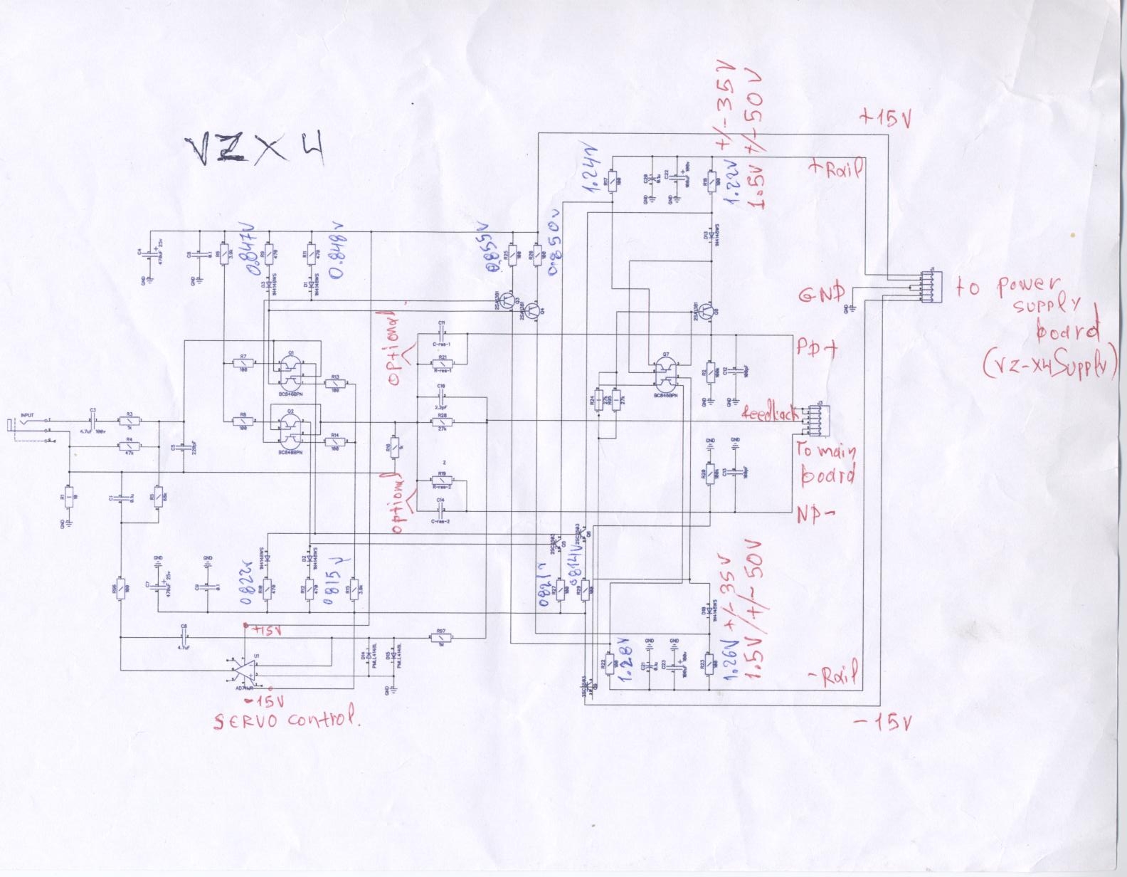

Some measurements
Have you got any other input boards assembled? We should figure out if the issue is just with the VZ-X4 or if it's with all the inputs.
I'm going to see if I can cobble enough parts together to get mine running for some further testing. I had some issues with an earlier board tripping DC protection intermittently with no explanation, my DC protection board had some overheating resistors on 75V rails at that point, so I assumed it was a false alarm. I had no issues with the modular boards at all.

Is this just with the X4 or did other IPS do the same?

Yes i have the VFA assemled.
Strange is that this was tested at +/-30v successfully without damaged speaker😕
Keep in mind that this low voltage(+/-30v) isn't enough for proper bias setting.
My first thought was that the loudspeaker was destroyed because of its low power, but this protection situation makes me worry..

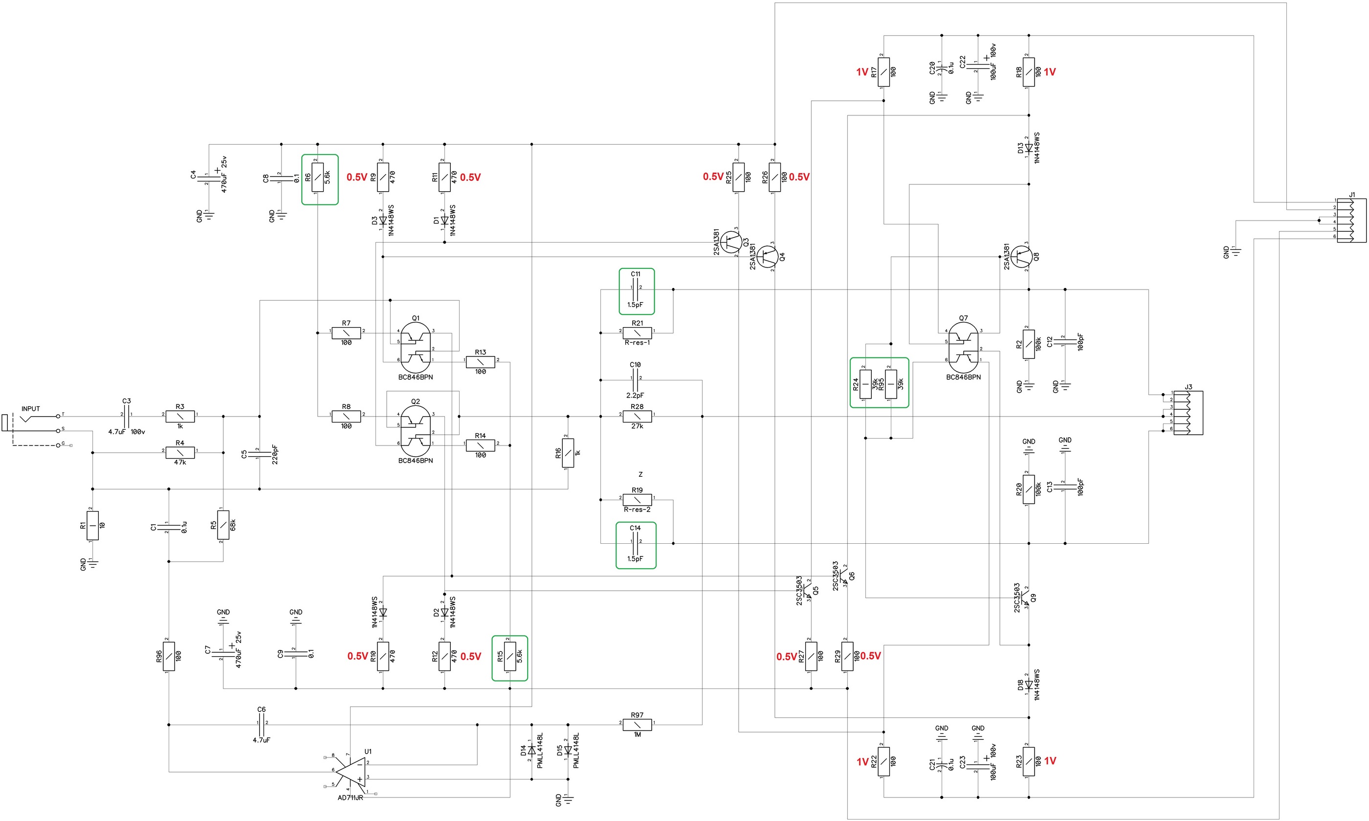

X4 update
Jeff, that's a good approach, Thimios - let's test the IPS board standalone with no external load.
By the way, attached is the updated schematic, running much cooler at lower currents. Changes are are marked by green frames, target voltages across the resistors are marked by red.
But even before implementing the changes - let's see the following:
Test close to clipping at 20KHz, measuring DC in 2 points:
1) IPS output (PD+, ND- and NFB are connected - this is the output);
2) Servo output (OpAmp output) - we need to know if the OpAmp output is reaching the rail (+ or - 15V).
Let's see what's happening. Depending on the result, I see at least two ways to solve the issue.
