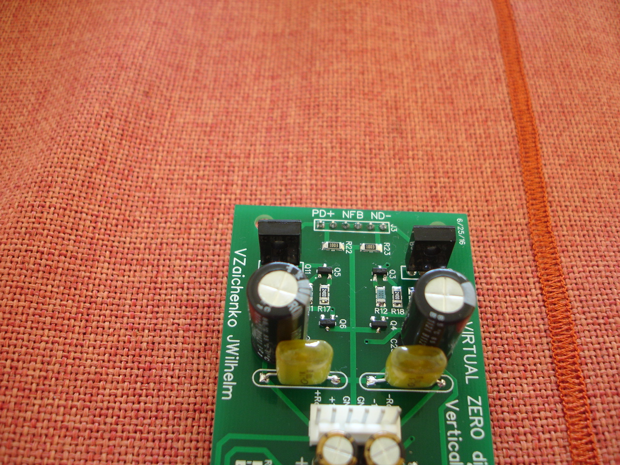

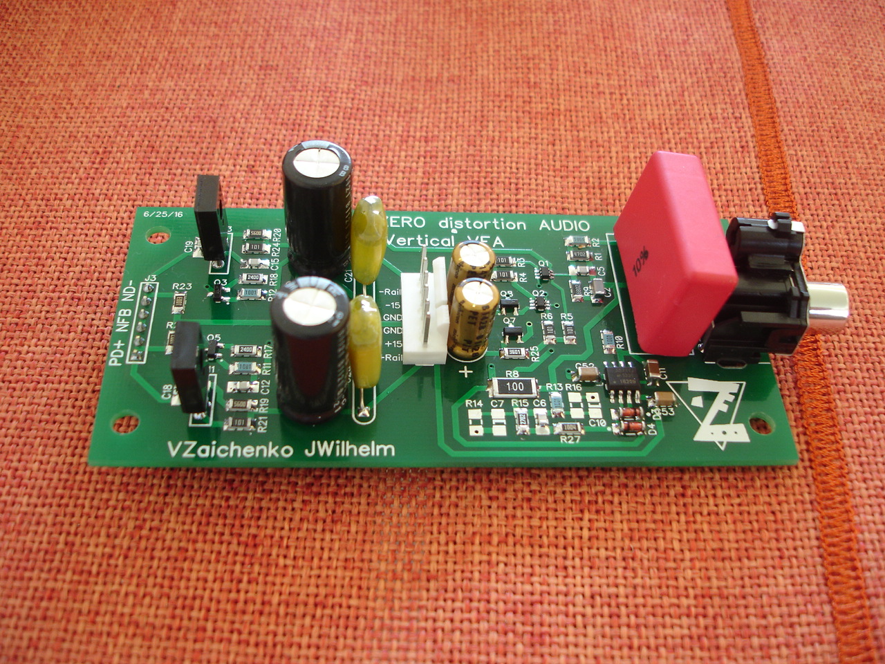

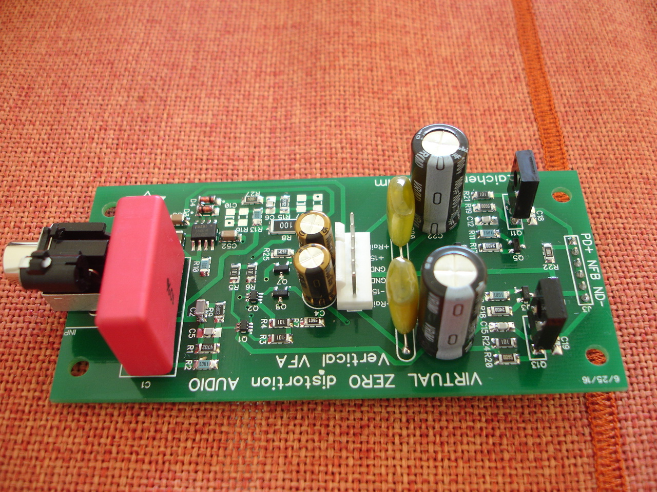

Small progress on power supply board (modifications are just for test).
I'm afraid that is time to desolder some of the power amplifier transistors🙁
I believe that these must be mounted on main heatsink.
To be more clear,Jef i see two points where you type +24v/-24v on power supply board.Is it right? To my point of view this points are connected to main power supply board.
Sorry don't take in account the second picture where the IPS just placed on the OUT.
Wrong direction!
