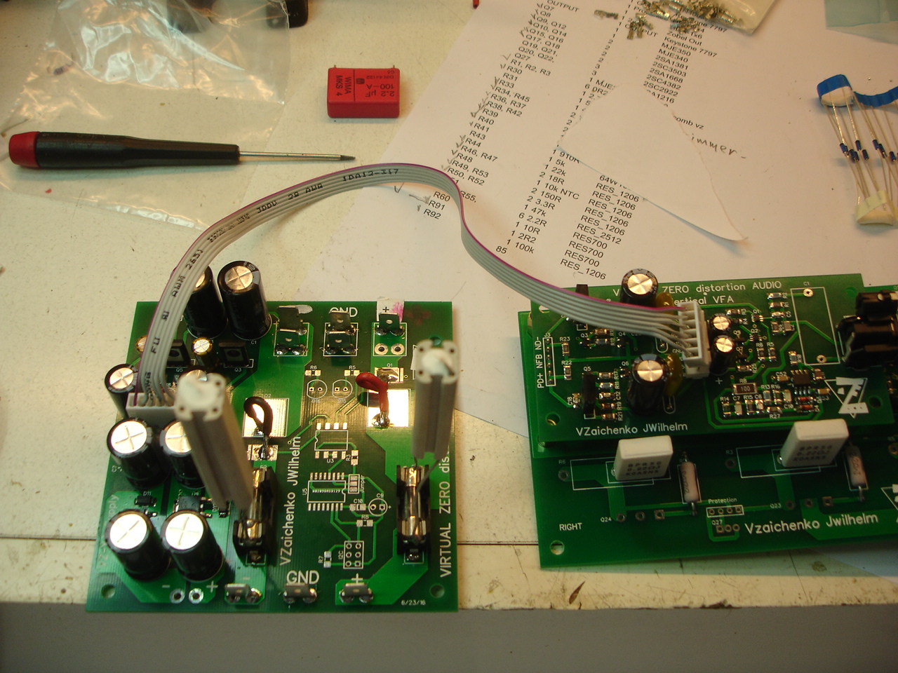

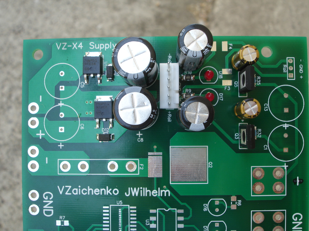

Small progress on power supply board (modifications are just for test).

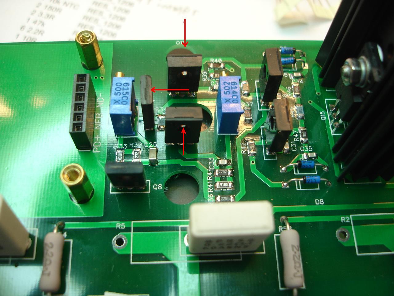

I'm afraid that is time to desolder some of the power amplifier transistors🙁
I believe that these must be mounted on main heatsink.

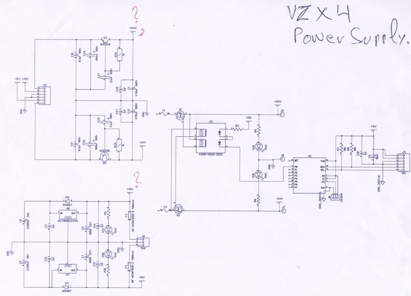

To be more clear,Jef i see two points where you type +24v/-24v on power supply board.Is it right? To my point of view this points are connected to main power supply board.

Yes those three transistors mount under the board on the heatsink.
The +/-24V markings are just netports for the rail voltages. The 24V number is just a place holder, not an actual voltage reading. You will see +24V marked in other places on the schematic. These are all connected without actually having a line drawn.

Is the rectifier board missing too?
