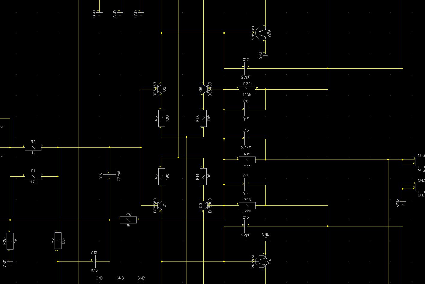

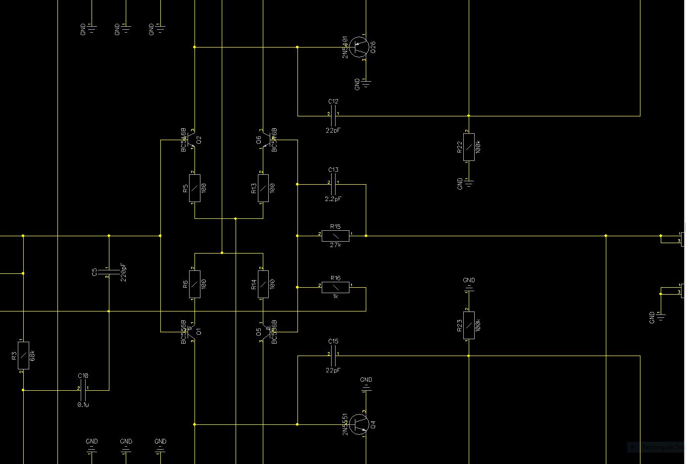

See the parts and the values for the normal (left) and normal (right) feedback options.
Try them both and see what you think. I'm interested to hear other's opinion on the nested feedback. Some testing numbers would be good for each option too!
Ok i will mount two 1p2 to this channel and leave the other channel empty according to second option for a try.

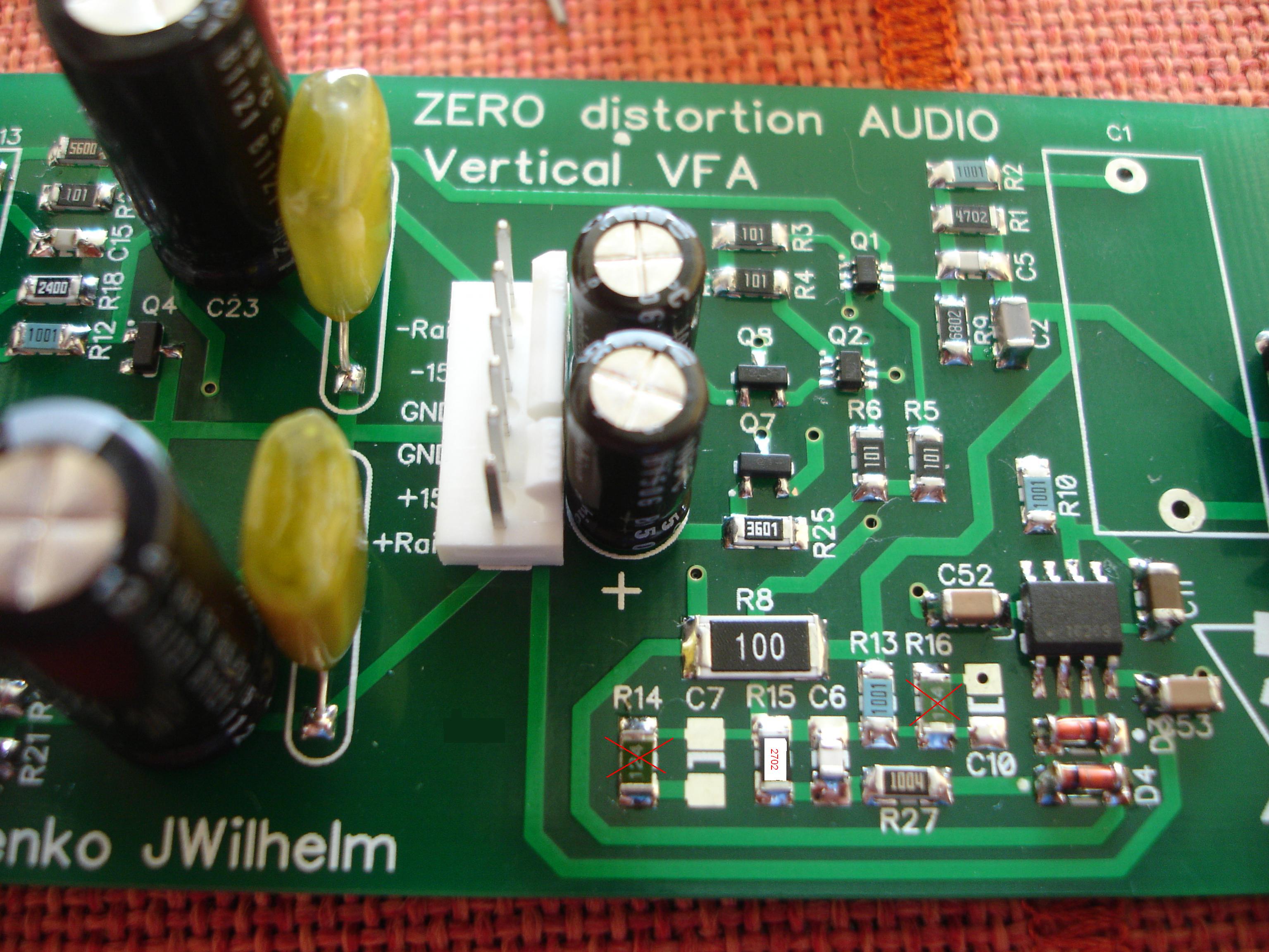

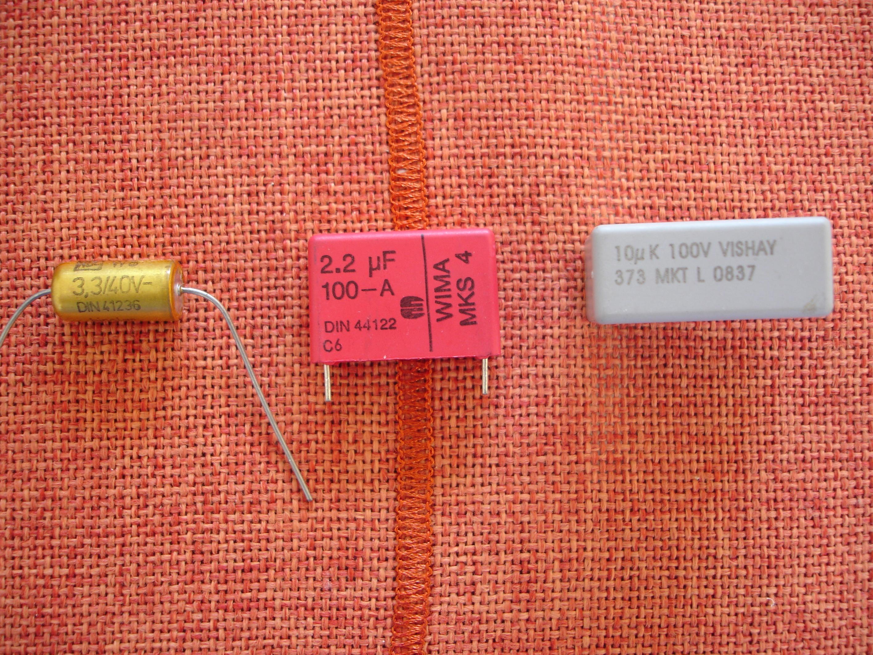

For d.c input blocker capacitor i have these, what is preferable to your opinion?
Unfortunately the 10uf don't feet well.

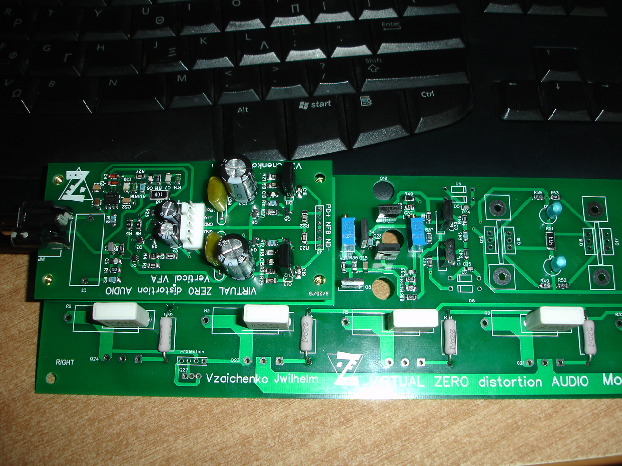

I want to go step by step so this IPS will be tested alone without OUT mounted.
Never i have done this in the past,but now using SMD this is necessary.😉
Any one of those should work. The bass might roll off a little early with 2.2uF though.
I made up a jumper to plug into the bottom of my board with 100R resistors from PD+ and ND- to NFB for testing. It works well.
Right. Just don't forget - in the 1-st case R15 = 27K, in the 2-nd case R15 = 47K.
Good tryk! I will do the same .
Yes Valery i don't forget this(i hope so):nownow:

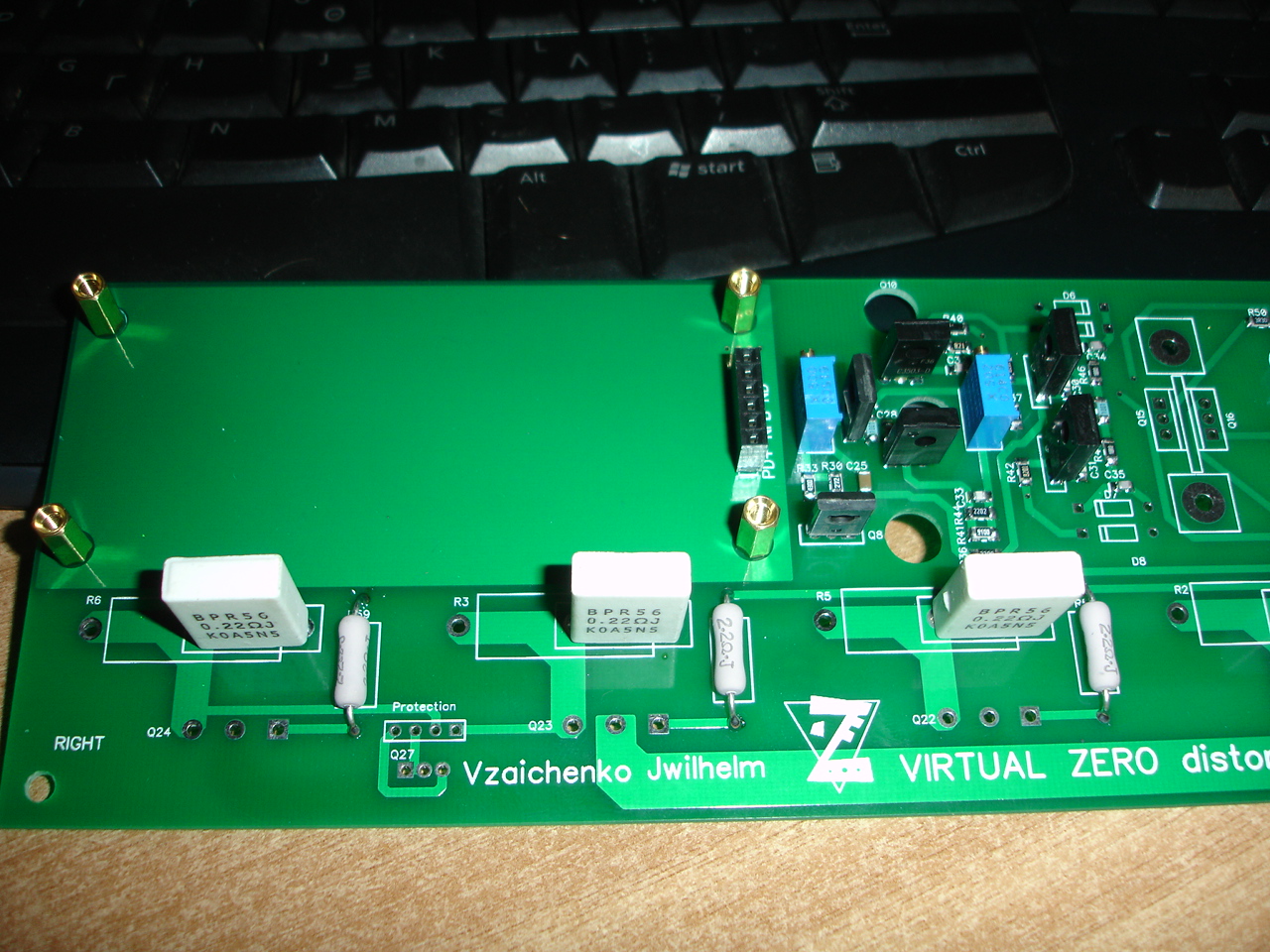

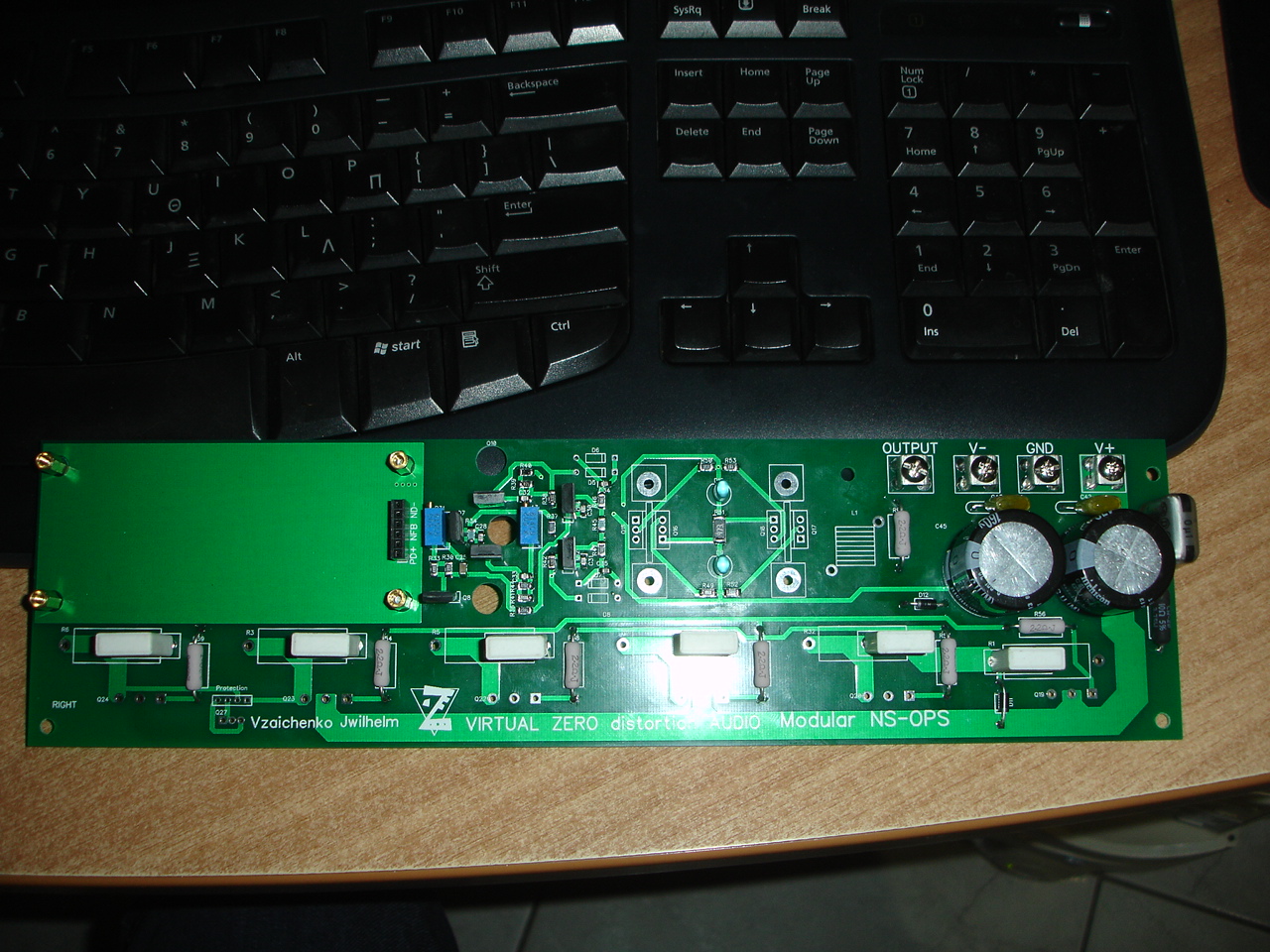

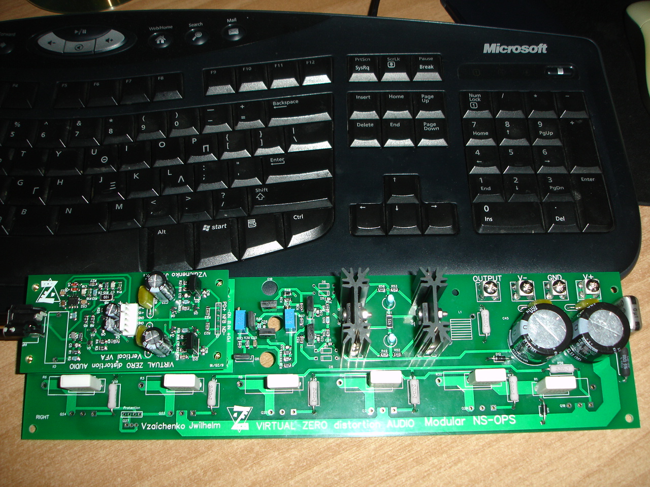

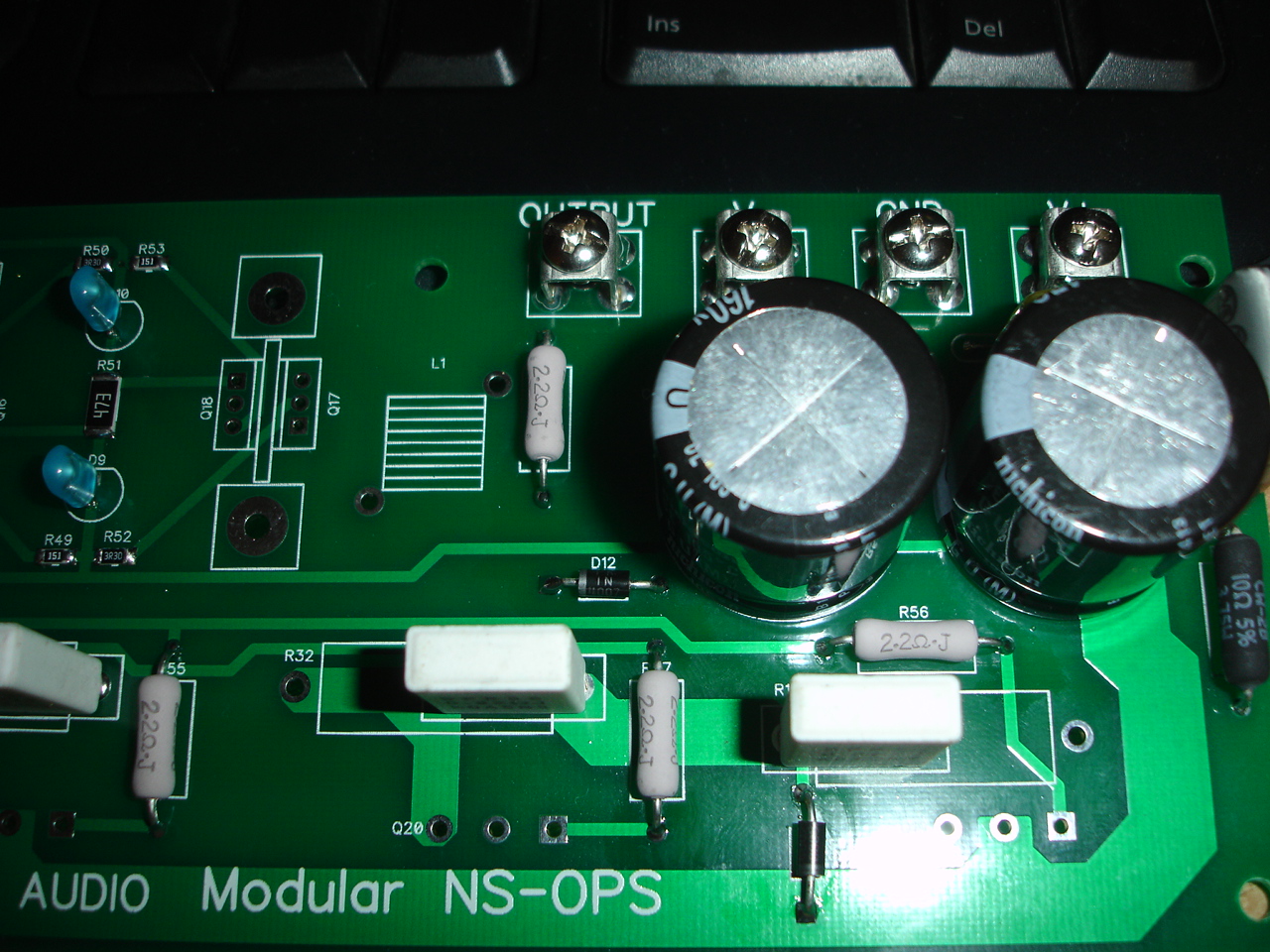

Some progress to power amplifier.
An easy to build power stage,clear, beautiful,i wish to play nice too!
This Monster will be alive soon😱

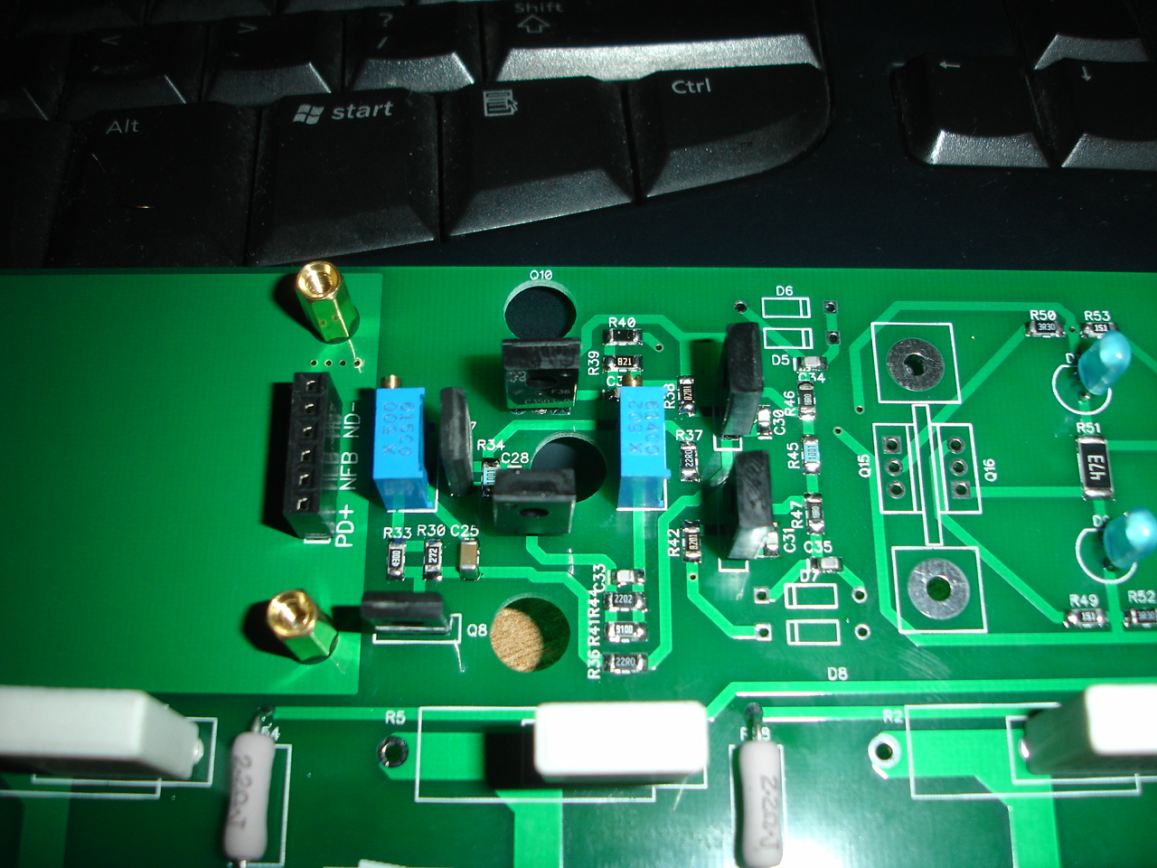

Looking around for the adjustment procedure (R31,R43).
Where i can find this adjustment procedure?
If you go to Index at the 1-st page and click "NS-OPS", you end up here:
Building instructions
Just note - clockwise / counter-clockwise directions are mentioned there, based on the trimmers orientation at my 1-st prototype version.
Anyway, set the bias spreader to the maximum R position, the clamping spreader trimmer - close to the middle R.
First - you set the bias with no signal. Then - set the clamping with signal.
