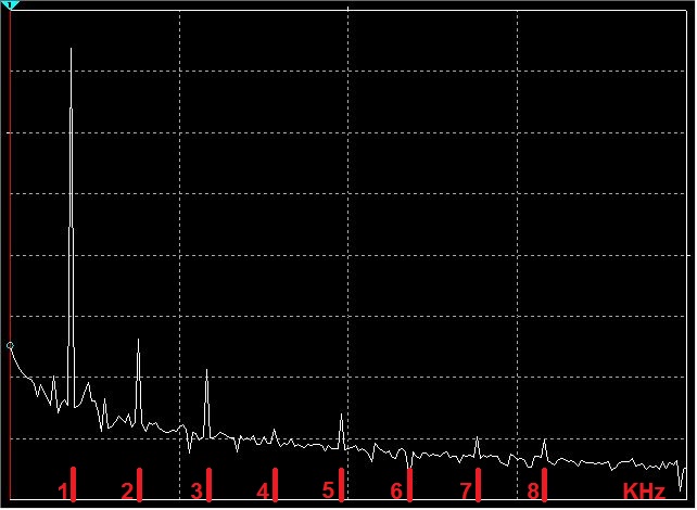

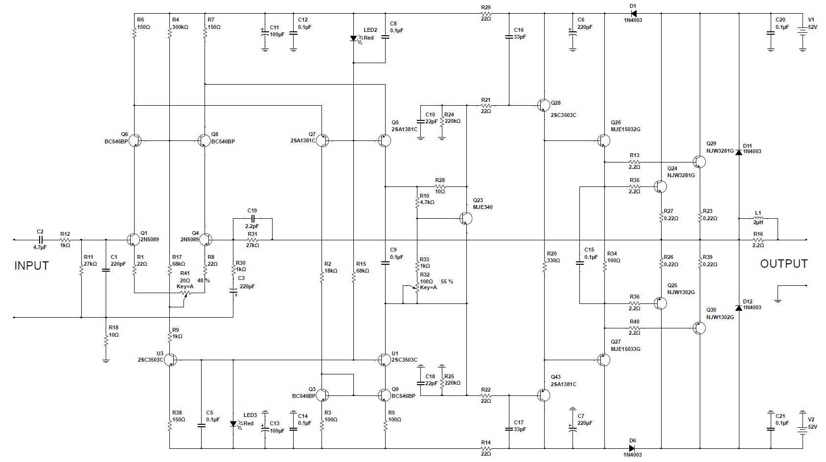

Following "Diagonal", here comes another relatively simple "current drive" design - I called it "Parallel".
Highly linear front-end, relatively low feedback loop gain (~35db), excellent stability margins, wide open loop bandwidth - hence low distortion distortion is almost constant within the audio frequency range (THD1 = 0.002%, THD20 = 0.003%).
Pretty nice harmonics profile (attached) - mostly 2 and 3 are in place.
It can be adapted to variety of rail voltages and also can be used with MOSFET output stage. Not live-tested yet.

Neat. That's a lot of transistors. 🙂
I have all but the MJE15033/32 drivers. Looks like a great neutral sounding setup. Very nice.
Yes, the full (not simplified) Diagonal front-end has got more transistors, than resistors 😀
This one - if you go for 1 pair of HexFETs - then you need only 2 drivers - you will have 4 transistors less immediately 😉
The layout can be very compact again.
That s reminiscent of an AD797, or a Luxman C02 preamp for a discrete version.
Luxman used this kind of topology ("parallel" current subtraction via common base cascade and current mirror at the bottom) with some variations in a number of amplifiers, but always having jFET-based LTP at the input. AD797 - never paid attention, but that's cool 😀

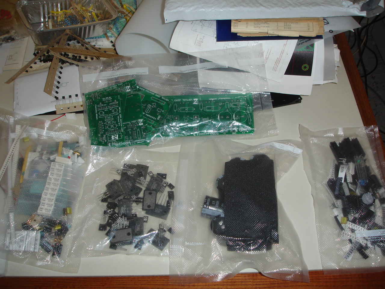

Yes of course,just a question.Cool, it has arrived! Now you have some work to do!😀
What are you using for smd solder?
Are you using solder paste or solder wire?
I've been using .015" solder wire lately. The paste is for reworking in an oven. Wash the boards with alcohol and apply a little liquid flux before starting. This really helps with SMD.
Ok!I've been using .015" solder wire lately. The paste is for reworking in an oven. Wash the boards with alcohol and apply a little liquid flux before starting. This really helps with SMD.
