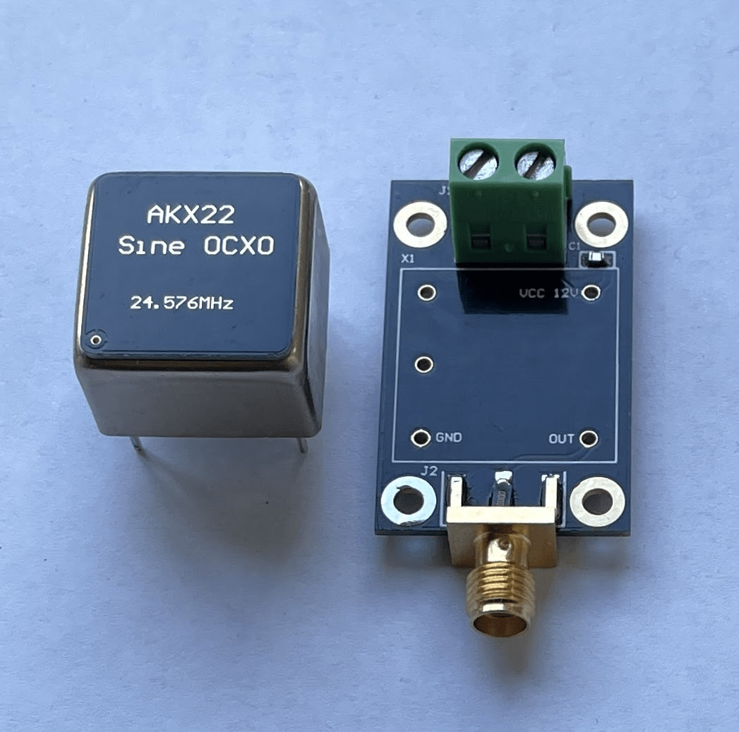

Should have been AKX-22 https://sites.google.com/site/ackodac/modules-and-kits/clocks-and-oscillators...you also mention an AX-22 clock...

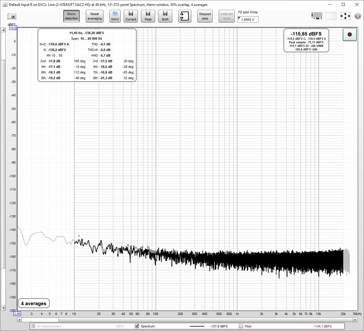

I have tested my board a bit more. I get exact same noise from both channels and analog part works without any noise (with 010101 pattern). So I suspect the noise is jitter coming from the clock doubler. Input to 74LVC2G86 has overshoot and output does not look clean. I'll probably add series termination resistors on both input and output to 74LVC2G86. BTW is it possible for 010101 pattern to work well even though clock doubler has jitter?That's just the point I was trying to make, that even though you use well-shielded connectors, you get a relatively high noise floor. Whatever the cause, it won't be the crosstalk issue I initially had with my flatcable. Apologies for mixing up the connectors.
After having looked at the specs of your ADC, I finally understand your test set up.No. As I said SNR measurements were made in DAC-to-ADC loopback in balanced mode.
I also tested with Marcel's trick (continuous 01010101... pattern). The resulting noisefloor (see below) is more or less the same as ADC's noisefloor. So nothing wrong with the analog part or the measurement setup. Problem is most probably in the digital circuit. I need to test that more.
Your ADC has dual channels and an amazingly high dynamic range, that’s why you can measure the S/N for a high level input signal without the need for using a LNA.

When I try Acko's clocks with Andrea's FIFO buffer, either I can let your dac generate the RTZ or I can configure the FIFO buffer to generate RTZ exactly on XO rising MCLK clock edges. Seems like it might be more precise to let the FIFO do it, or at least try it both ways. What do you think? What would be involved to try it?
I haven't a clue what the input signals of U28 look like, but Hans did have a look at the output of U28A on my prototype board, using a 470 ohm resistor, 50 ohm coax cable and 50 ohm termination at the input of his oscilloscope. It looked quite nice, actually, with a pulse width of about 8 ns, closer to the design target than I had expected. When there is a duty cycle error at the output of U29, which there normally is, you do get one somewhat longer clock cycle, one somewhat shorter clock cycle, one somewhat longer clock cycle, one somewhat shorter clock cycle and so on at the output of U28A. That is systematic jitter, but systematic jitter corresponding to tones at integer multiples of the sample rate, which are harmless.
The answer to your question is yes, even with jitter at frequency offsets that would normally be harmful. With a 010101... input pattern, the FIRDAC switches between the patterns 0001, 0010, 0100 and 1000, which all have the same average. Clock jitter then only displaces the switching spikes a bit, which hardly has any impact on the low-frequency content.
If the purpose is to find out how well or how poorly my DAC works, it seems logical to let my DAC generate the RTZ and the doubled clock.
I can't answer your question about how to hook up Andrea's FIFO buffer to my DAC, because I know nothing about Andrea's FIFO buffer. Is there a description somewhere about what output signals it produces in RTZ mode? What are the high and low levels?
